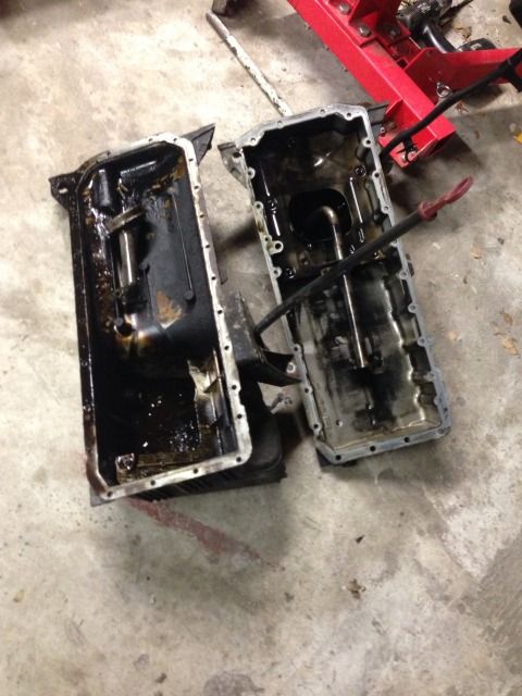

Saturday I lifted the engine with the hoist and put a load of chemical metal on the sump bt
hopped a load of waste oil into it and it started first pick of the key to my surprise!

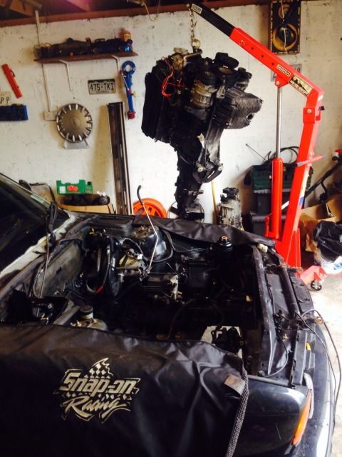

Sunday again I was out at it in the lovely weather and I got the engine and box out before I went to work. :happy)
Monday (today) I had the engine up on the engine stand after taking off the box off it. Took one of the manifolds off it and I'll bring that into college in the morning to have a crack welded in it. I also took the sump off the ending only to discover its got the deep end on the worng way so it will catch the subframe in my e34. I took a trip up into the rafters in the garage and came up trumps with an e34 sump and oil pickup off a car I scrapped last year. One of the lads was kind enough to take them off into work with him to the parts washer so I should have those back by the end of the week.

To do to the engine before fitting:
New gasket for oil pickup
new sump gasket
bit of a clean maybe bt

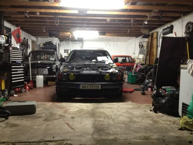

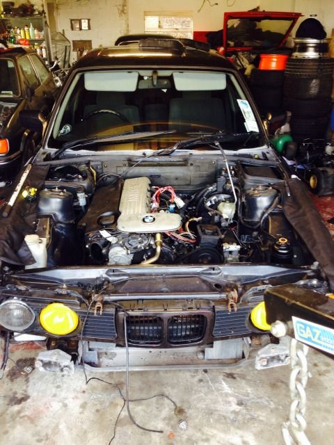

How it sat before I put it up in the air.

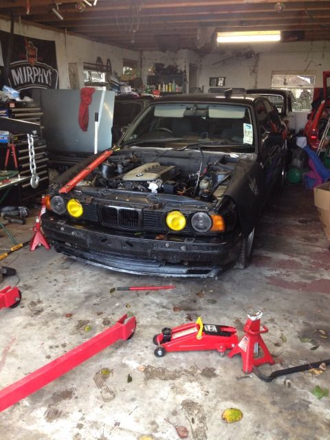

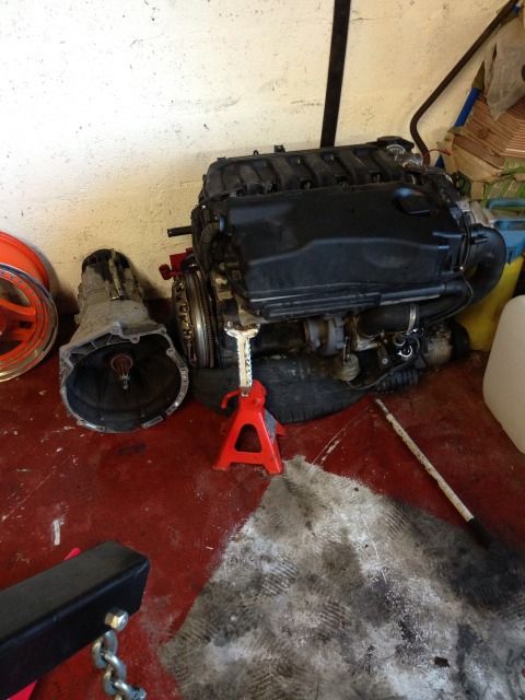

Just have the engine out here
Couple of the doner car which I'm breaking for parts (shameless plug!)

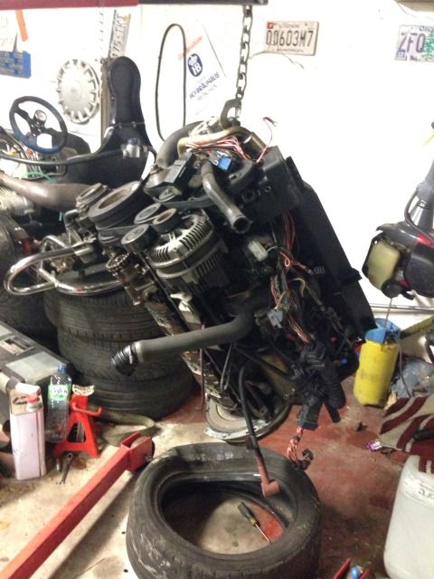

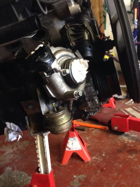

Heres the engine, none of the different oil pick as the photographer left early :ban:
Had to empty out the dirty oul torque converter :nuts)
This flywheels got to go aswell, I'll be putting on the one form my current engine then hoping my gearbox fits

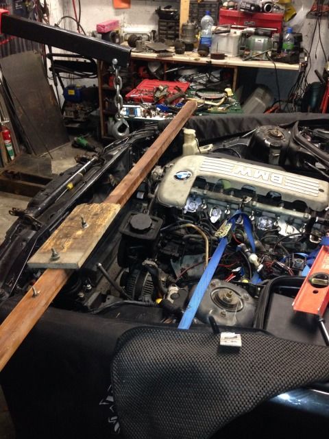

Its on r888's for the swap (rrfl:

I got the engine running, had tried to start it and it swung over but no joy. Chhecked for fuel and spark, did some breathing by the car to make sure there wasn't a vacuum
. Plugged it into diagnostics and the diagnostics wouldn't comunicate. Sat down drank some tea scratched my head then one of the lads says "Hoi is the ecu plugged in right". Checked the ecu it seemed to be in juist fine so I took it out and saw that I had put in the gearbox ecu from the doner car by mistake
. Looked for the 520i ecu, plugged it in and it fired up first go
happy days!
