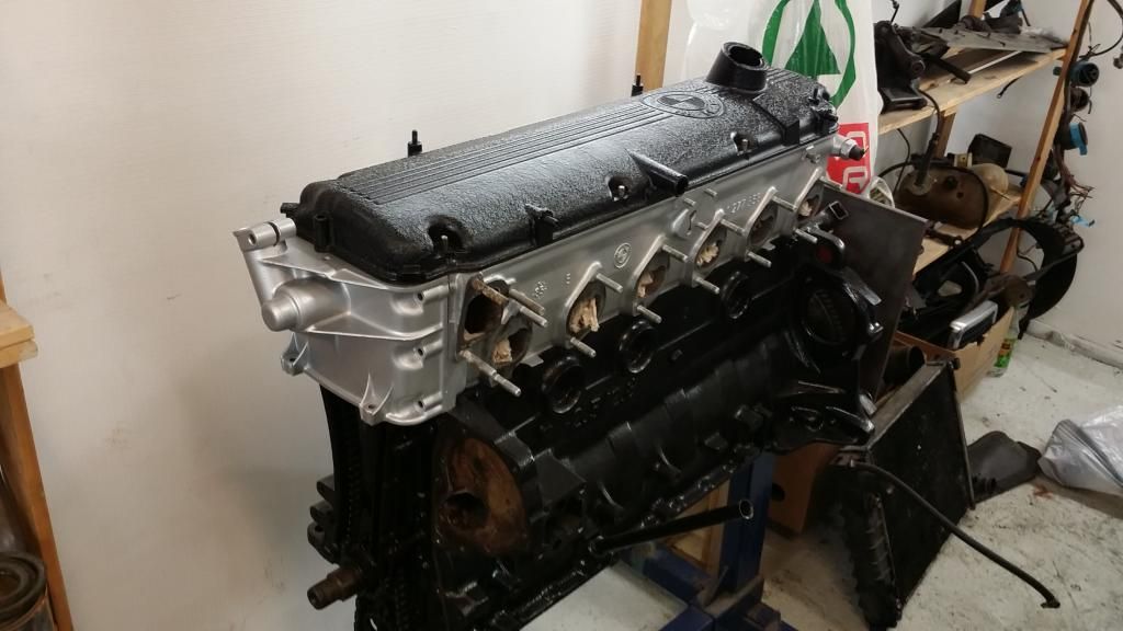

After some well appreciated help from my borther regarding the bondo and laying down the filler I'm now pretty close to being done with the engine room. I have now started on refurbishing the engine so the hole thing is starting to come together

Wrinkle paint Think it will look awesome after rubbing down and polishing the lines and BMW logo
Have started on rubbing down the filler and I'm hoping to paint it on wednesday
