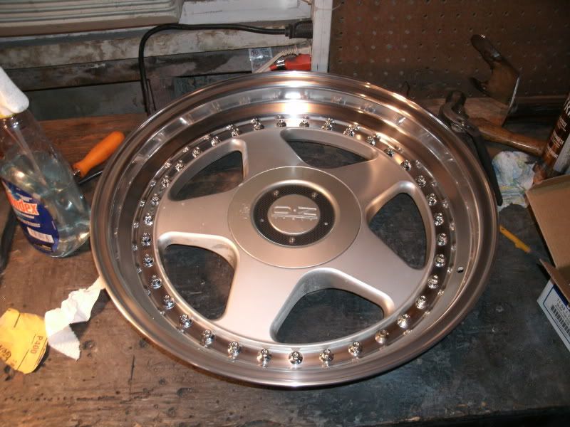

    continued with the OZ's today.

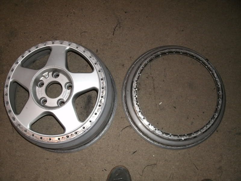

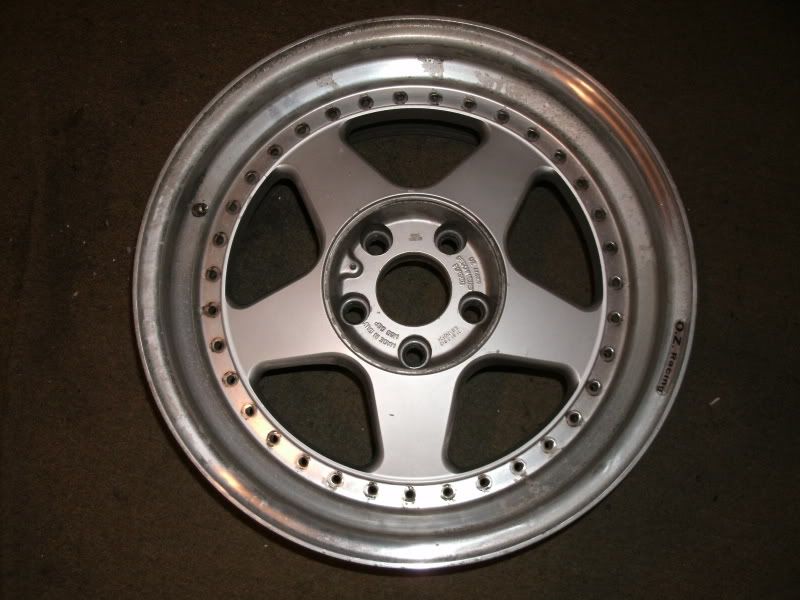

    a few weeks ago i took one of these apart:

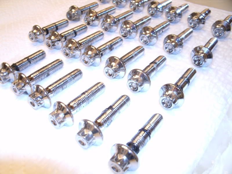

    took the bolts and gave them a proper cleaning
    to

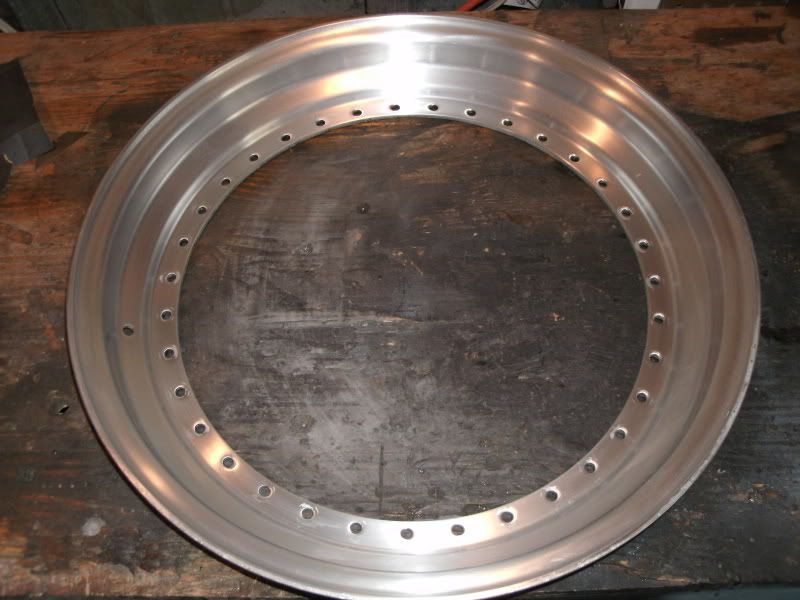

    today was time for the lips considering its raining out so i couldnt work on the car itself.
    after about an hour and a half of hand sanding i ended up with this
    its only at 400 grit so it has a long way till mirror polishing, but its getting there.

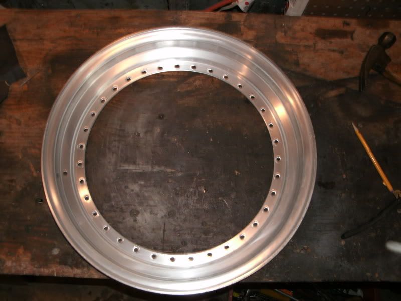

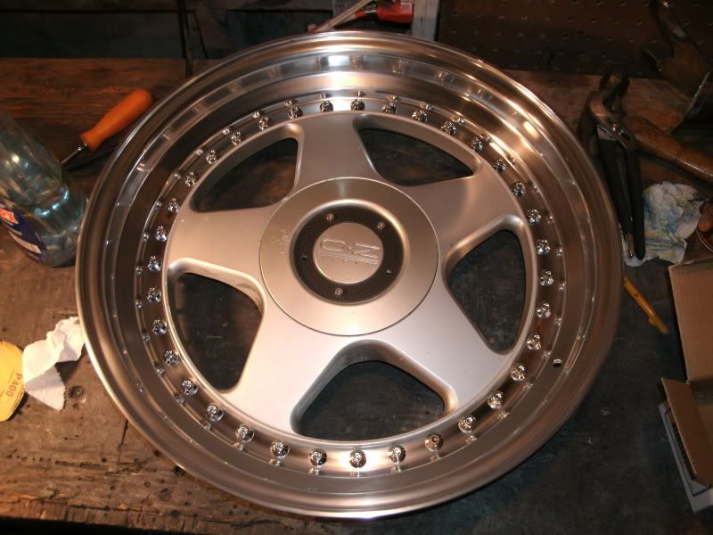

                            still raining all day so i did some work on the futura again
                            sanded to 1500 grit. then did some hand polishing, still needs work, but its getting closer. centers are a different silver due to them not bieng the correct year caps for these futuras. the centers and caps will be painted before they get bolted together.
