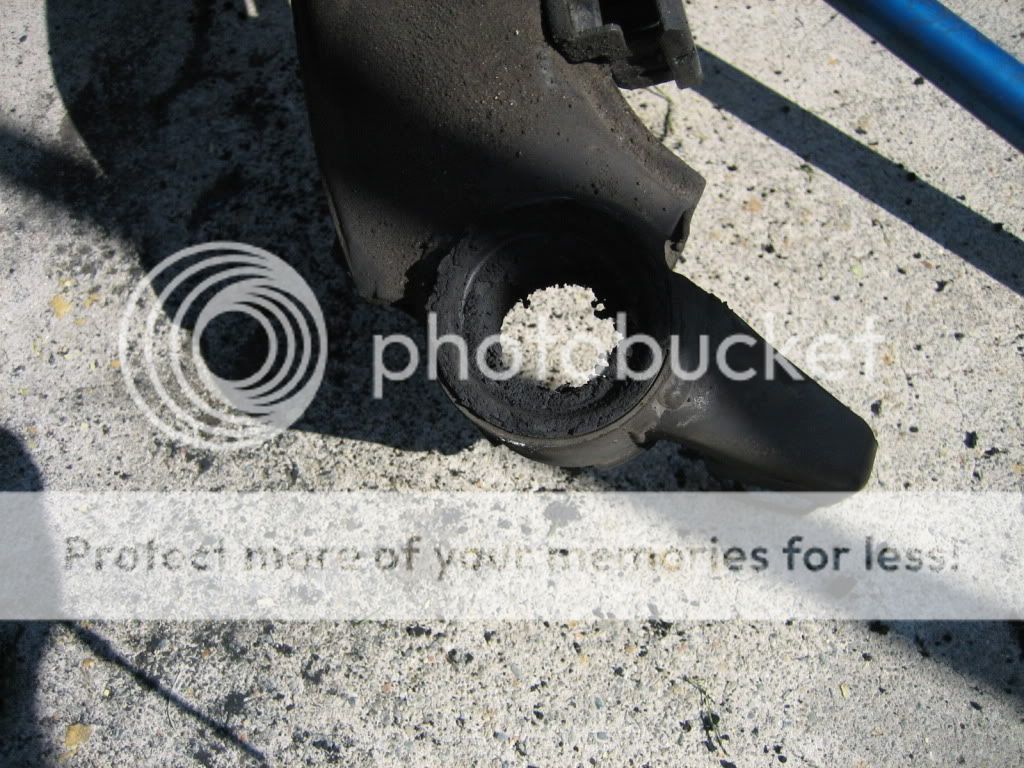

Some of the damage

We could not figure out the E-brake at all so I started on the RTABs. Once I figured out how to knock em out, it wasn't too bad.
New bushing in

The most useful tools of the bushing project were the torch, the dead blow hammer and the big ass flat head screw driver.
Josh came and popped the E-brake for me and then it was on. Pulled the whole assembly from under the car, pulled the subframe from the trailing arms, control arms and the diff.
Then started burning the bushings
Then the same hammer method as used on the RTABs
Here's some shots of the bushing bullshit.

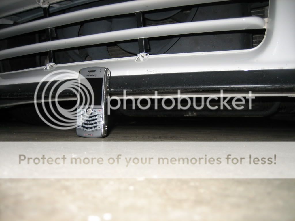

And here are some of the temporary ride height. More to come at a later date.
These are probably out of order and I know its not as low as some of the others to surface on the SW coils but I'm not into low for the sake of low. I'm working on dialing everything in right and then I will post full pics.Last edited by SeanDub; 10-05-2010, 10:02 AM.
