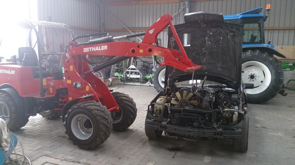

Suddenly the temperatures started rising and there was big cloud of mist. So I stopped and we towed the car to inspect what went wrong:
So nothing serious. The fan just hit the radiator and broke it. I need the change it electrical one, so that would not happen again.
