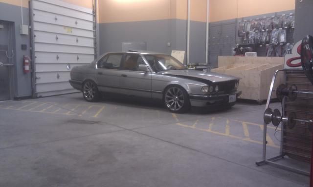

    My dads e32 in the background for a reference of the stock height
    Found a lip at the junkers that I could make fit on, and only cost me $10

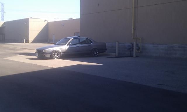

      Finally, the car was looking to be road worthy soon!

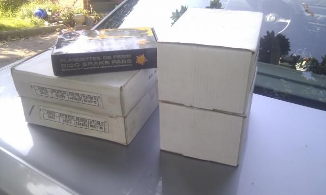

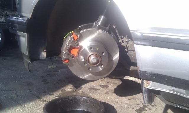

      Wanted to get some new brakes since the old ones were...well old

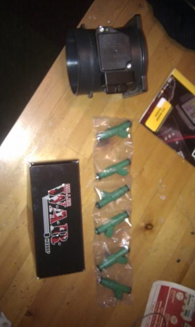

      Now, that i have the turbo system built and exhaust all done, i needed a tuning system.
      Figured i would get the Miller Performance turbo tune (Worst decision ever!)

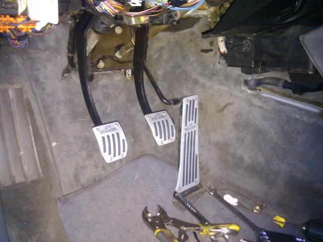

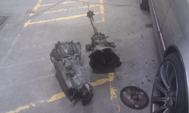

        The automatic transmission decided it only had first gear...So time to swap in a manual
        Pedals going in
        Automatic out, manual going in!

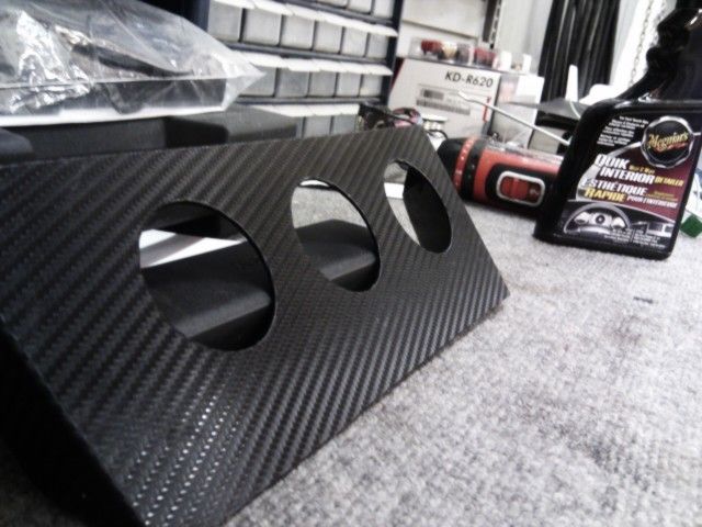

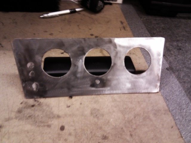

        Also made a gauge holder to go in the shifter area

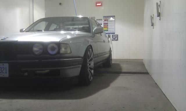

        Swapped in some black interior
        Took it for a much needed bath to celebrate!

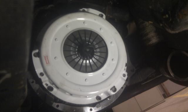

        Sadly, the stock clutch didn't hold when i got into some decent boost...so i ordered a stage 3 clutch and got a lightened single mass flywheel.
        Flywheel and clutch installed

            New 255 fuel pump
            Finished with the swap and was running alright.... (did i mention that miller system sucked?)

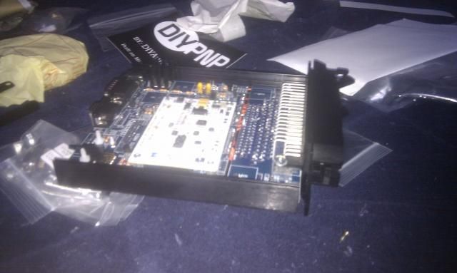

            Remember than tuning system i *****?

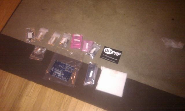

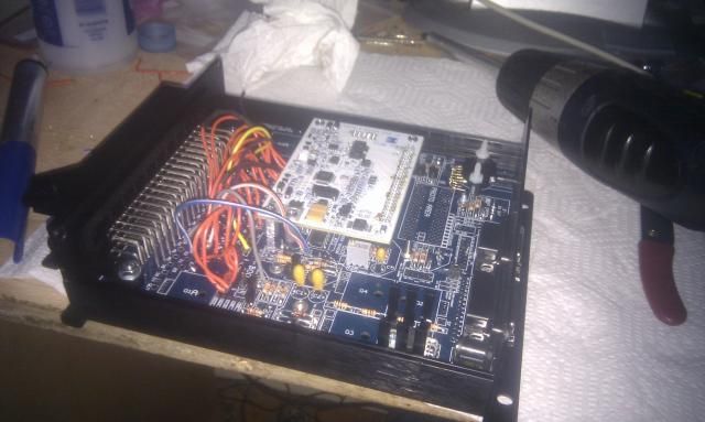

            Well i ordered something to replace that, DIYPNP megasquirt
            Spent a couple hours soldering up everything

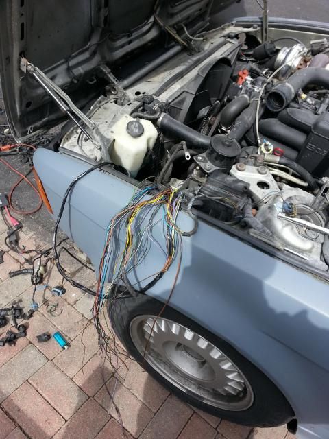

            Cleaned up the engine harness and extended some wires

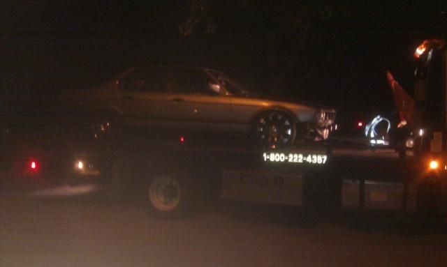

            Another tow truck picture

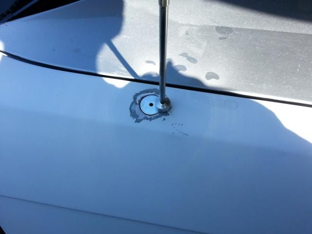

            Shaved the stupid antenna that was put in randomly

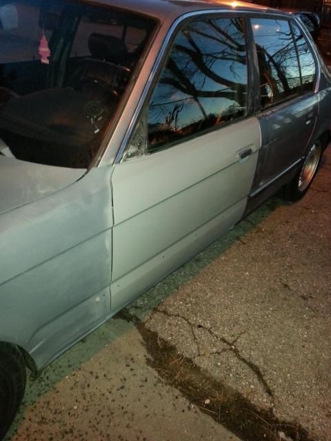

            Drivers door down to bare metal
            Primed
            Rear door down to bare metal. found some dents that were filled with bondo... banged them out for now.
