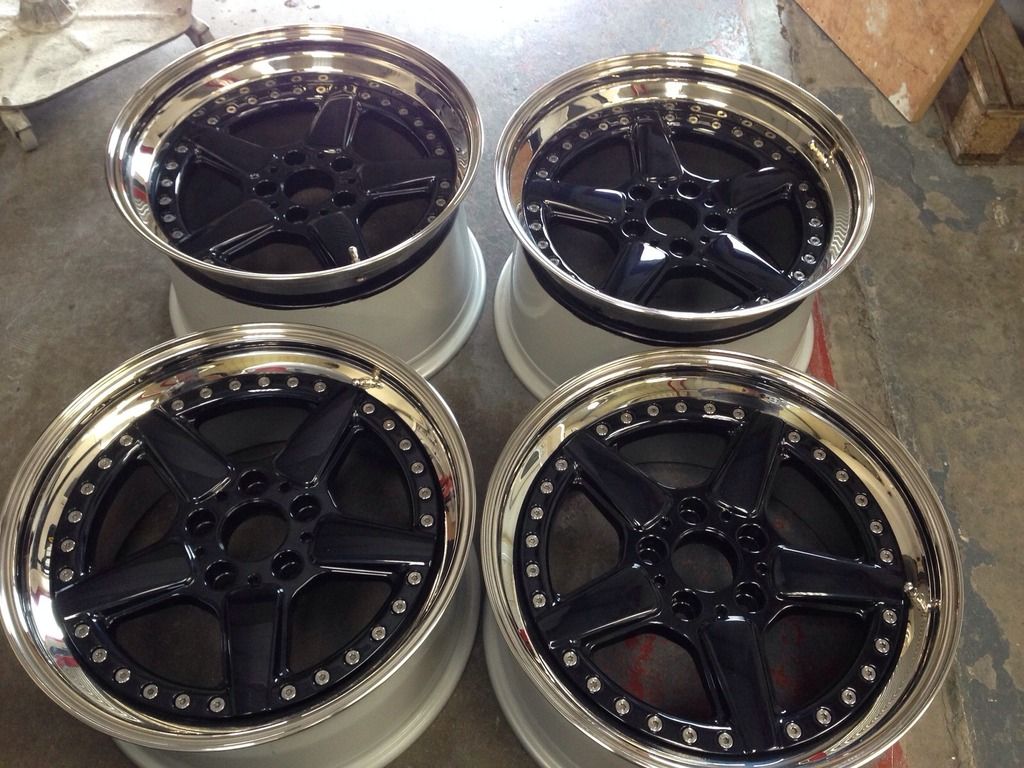

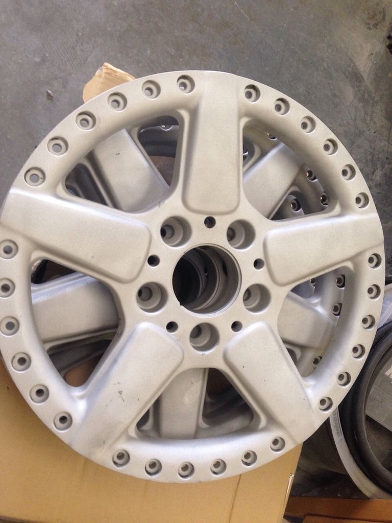

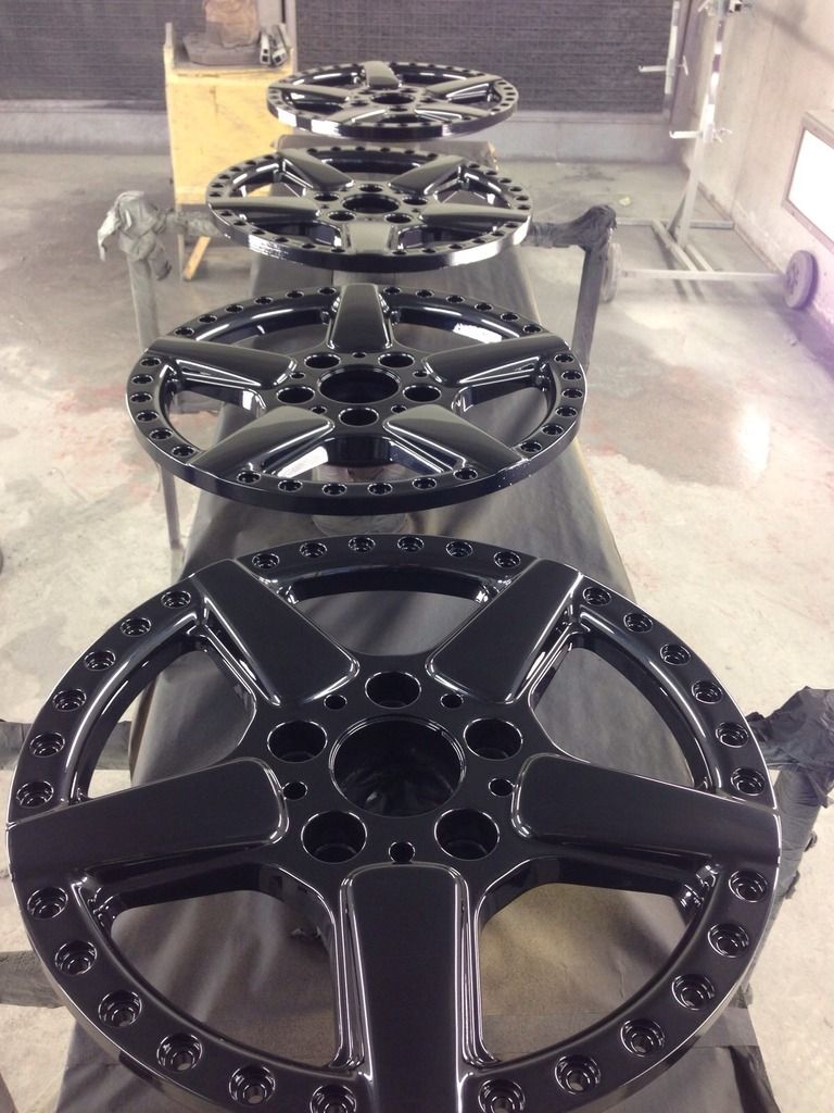

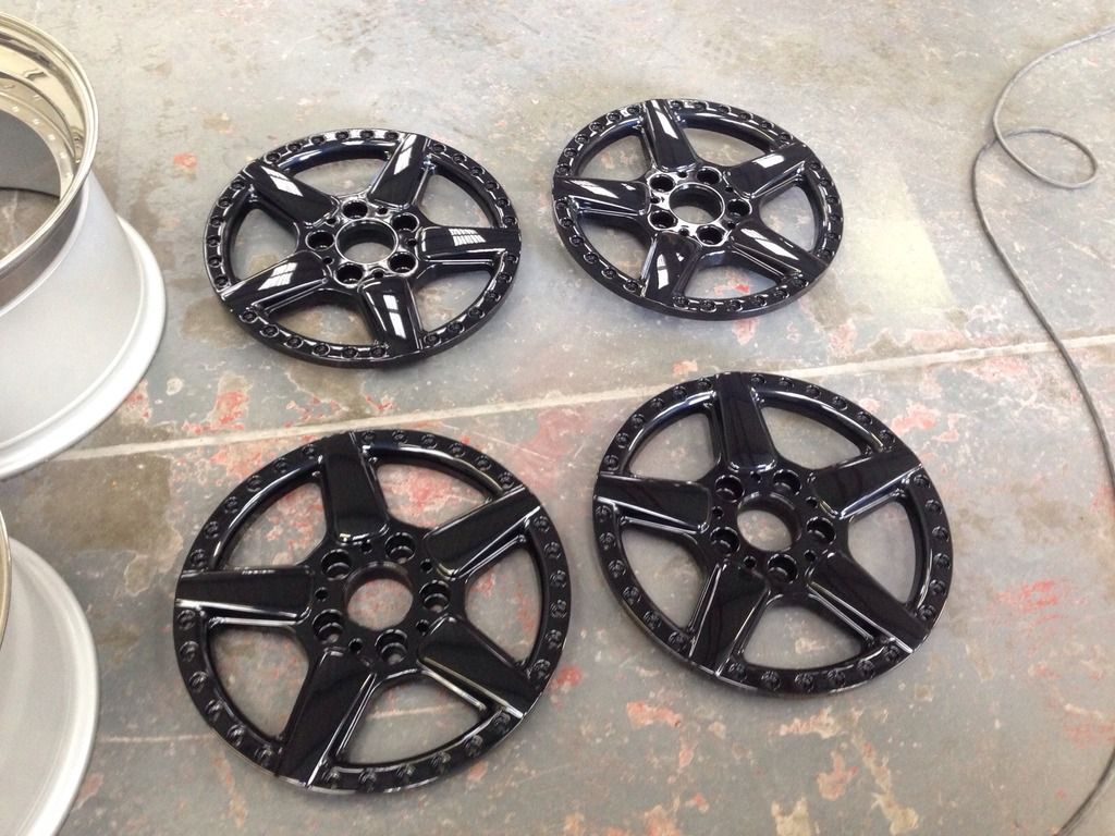

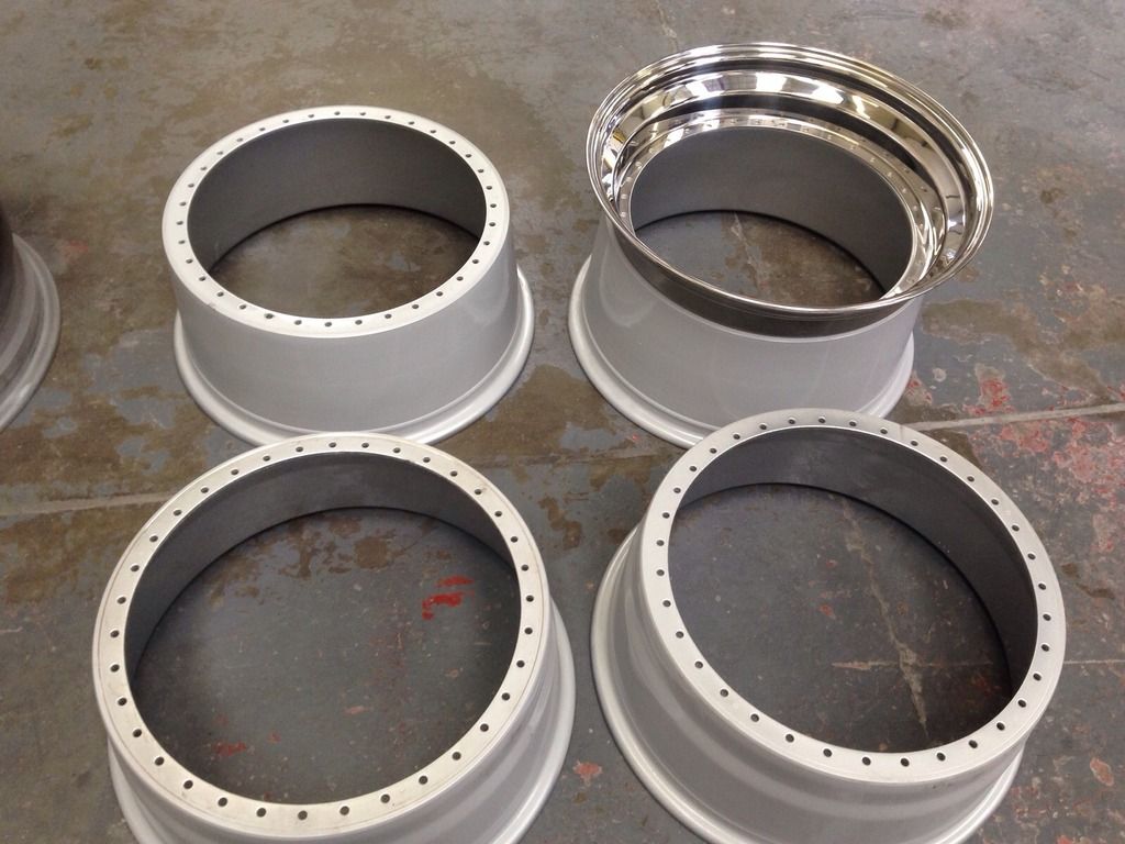

      Just a little update on a few finishing touches. Now that the summer is in full swing the wheels have been refurbed and built up ready to go on.
      They were sand blasted and coated with anti corrosion primer and then paint primer and then lastly Gloss carbon black. The barrels were powder coated silver. The Dishes are Radinox ones which are not aluminum, but a super strength stainless steel I believe. You won't believe the abuse these dishes can take.
      Can't wait to get them on. Big thanks to Dips at CustomCars for helping me out with all the work.
      ACS Type II Split Rims - (Rears 10.75j et 45, Front 9.25J et 38)
      Before Pics:
      After:
      Thanks for Looking.

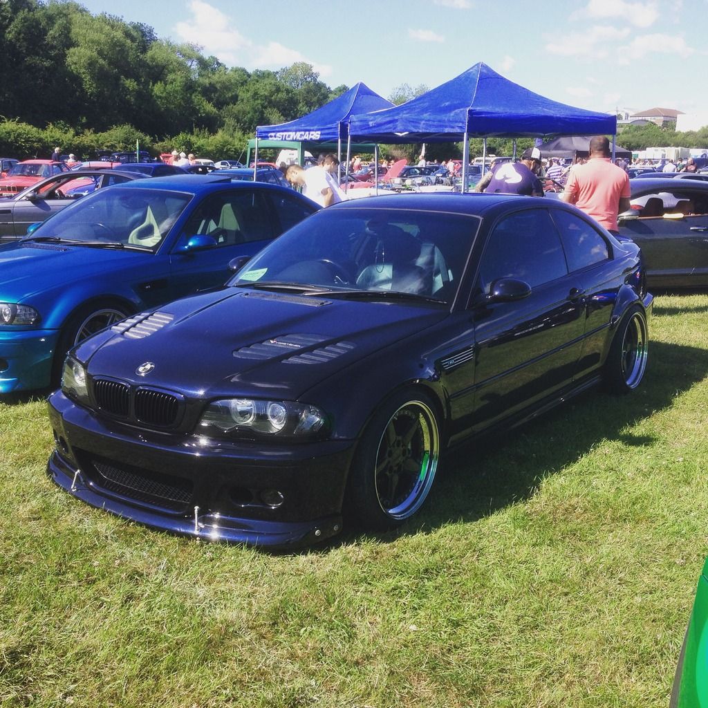

        A couple of Pics from Uxbridge Auto Show this weekend where I was on the CustomCars Stand:
