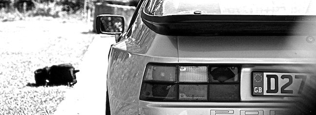

Got a few photos yesterday whilst the weather was nice and also fitted porsche badges to the wheels
