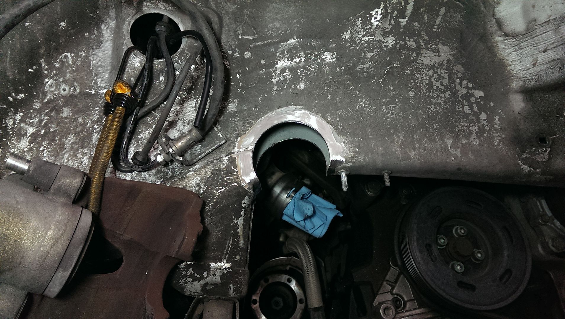

                          Here's a few pics of my latest C notch. It was on a mk4 gti. Pretty standard other then I tig everything now that i have my thermal arc 186.
                          Notched and sitting perfect!
                          check out my instagram: @partsscore you'll like it, trust me!
