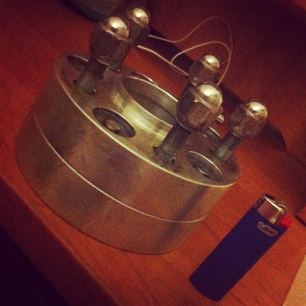

                            Little mini update, rolled my front fenders so I wouldn't rub like a cunt with the spacers,
                            the unmolested fender needed many massages, many. however, the done dickered' fender
                            didnt need much because I already hammered the shit fuck out of it now to long ago!
                            Ths vehicle isn't going to be super duper pooper scooper low, but it does need much more
                            low. drift cars need to be able to hit full lock yeahknow!
                            However two of the reasons I went with spacers in the front are as follows; when my hubs
                            are modified the spacers will help my wheel from kissing my LCA, however they will still
                            need to be notched and with the spacers and the size/offset of these rims they will nearly
                            be in the same position as the rims I am going to purchase, allowing for some planning
                            ahead!
                            Anywhore, that is all for now folks!
