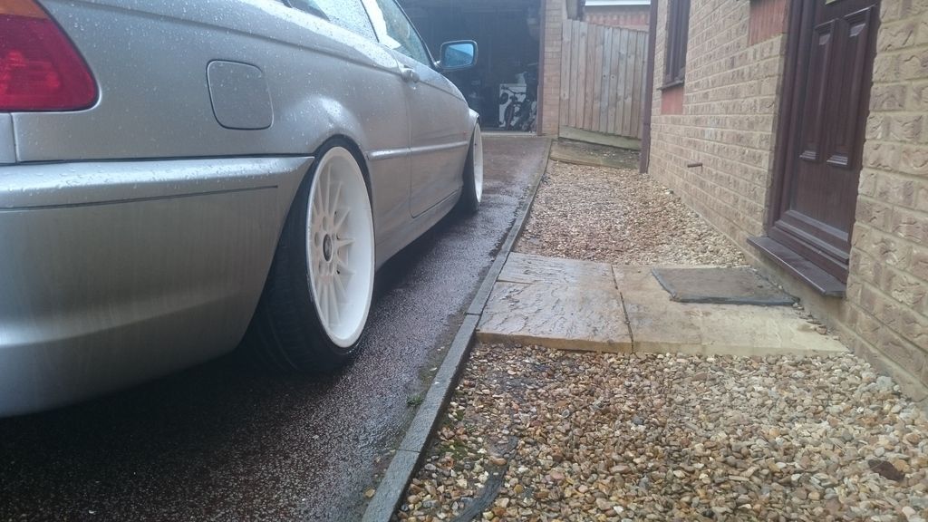

                        215 40 18 tyres on rear now. Spacers off and rear Lowered tucking 9j et22 rears with zero rubbing. Pics from Santa pod weekender

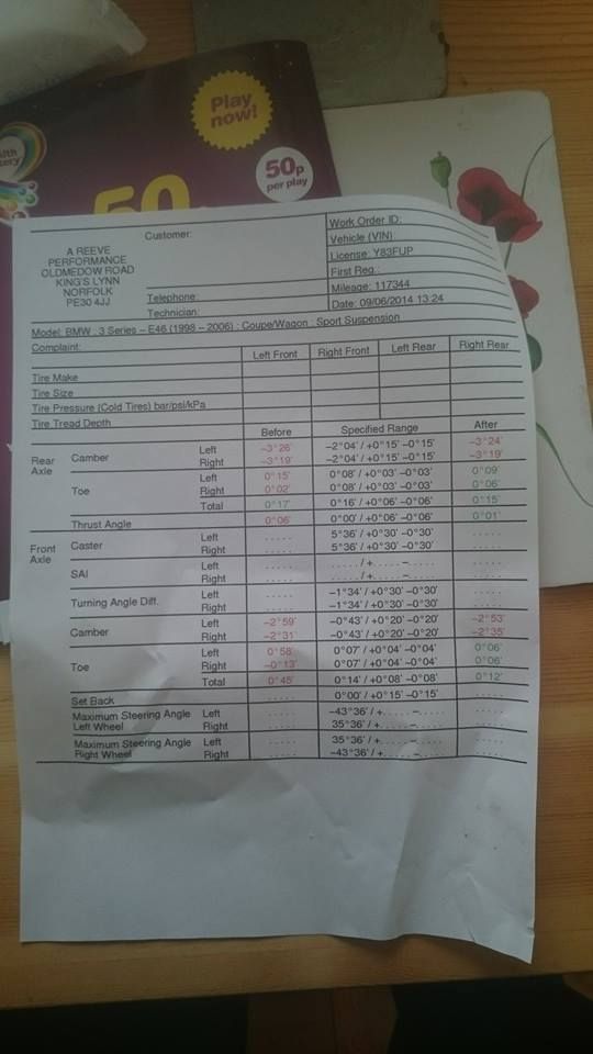

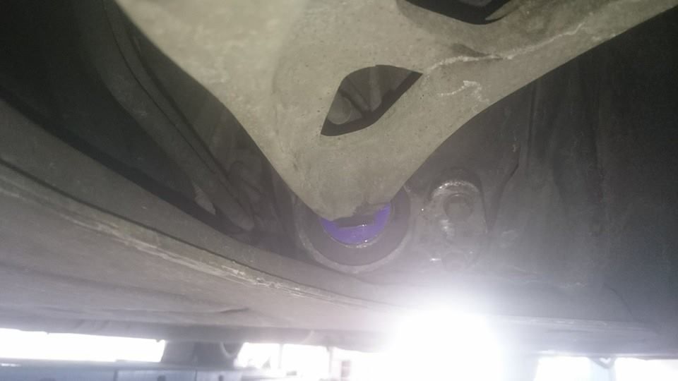

                              Well it's fixed and hunter alignment done. Absolutely amazing transformation in how it drives and corners like a different car. so happy with it as I've pretty much given up on it ever making me happy but I think it's what I needed to appreciate it more. Can't thank the guys at Reeve Motor SportPerformance enough for sorting it and next stop.... Mot

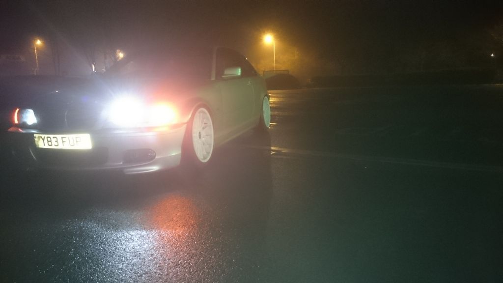

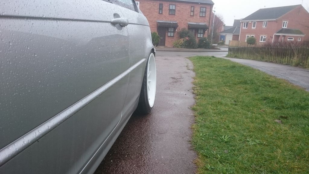

                                Been a while since ive updated this so here goes..Mot went well and recently has had a hunter alignment which has dramatically improved the cars handling.lost the yellow main beams and fitted new led sidelights and us indicator mod done.
                                Style 32s are now white and 13 mm spacers added up front and 15 mm lower at the front and 10mm rear is lower.front camber is neg 2.5 and rear set at neg 3.5.future plans include more lows and maybe 9 j fronts and complete car color change
                                took some pics straight after i finished the rims and proper pics after its respray will come.Been super busy recently work wise and my health was suffering but im all good now and hopefully the build will step up a gear
