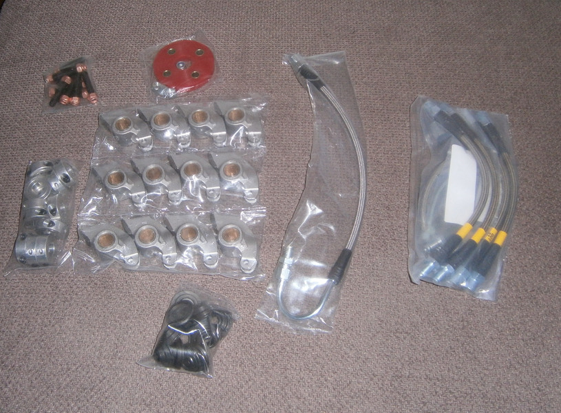

Shiny new race car parts!

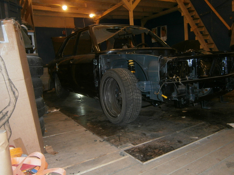

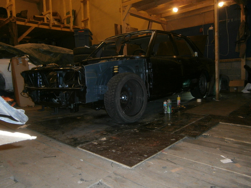

The car is back on wheels, first time since last august!!
Had to put the front wheels on backwards, otherwise the wheels would have hit the front struts..

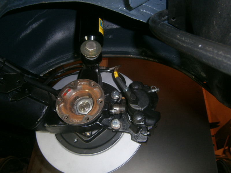

The E34 rear ABS-sensor fitted after modifying the brackets:

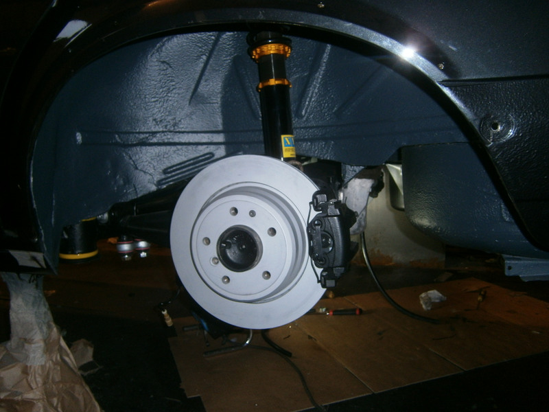

Rear axle missing only sway bar and drive shafts:

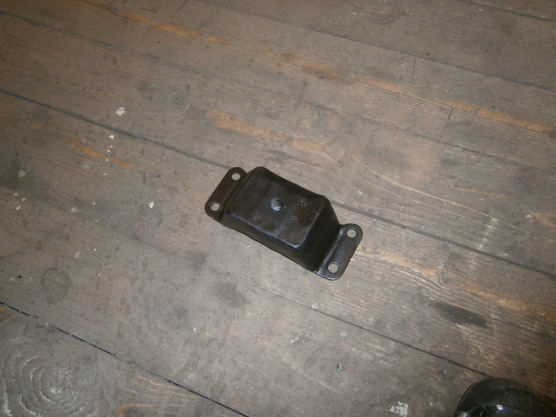

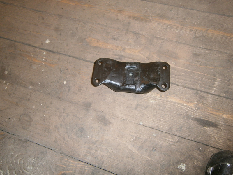

Upgraded diff mount, all "empty" spots have been filled with rubber:

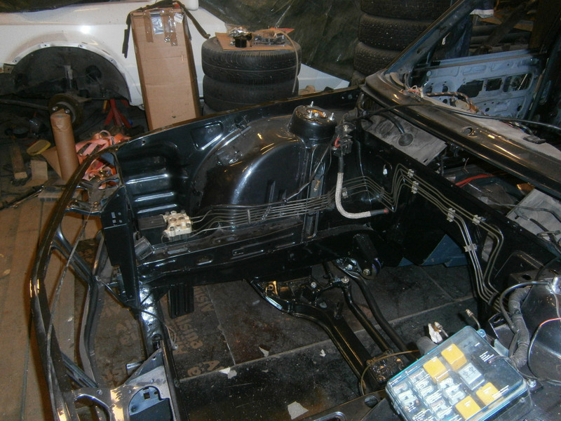

ABS-unit and front brake pipes on their place:

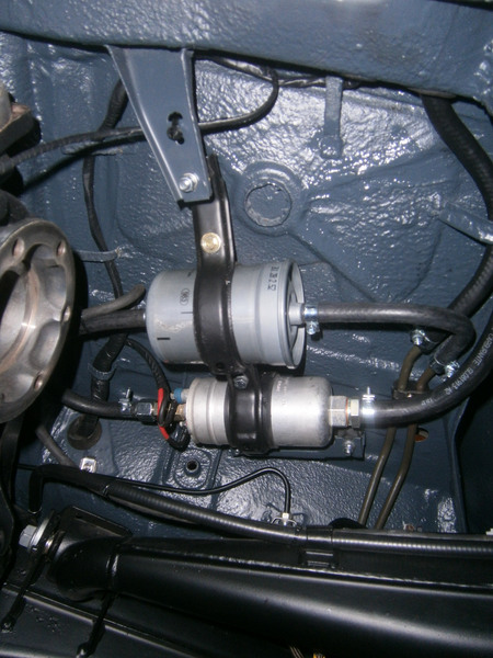

Fuel system ready at the rear:
