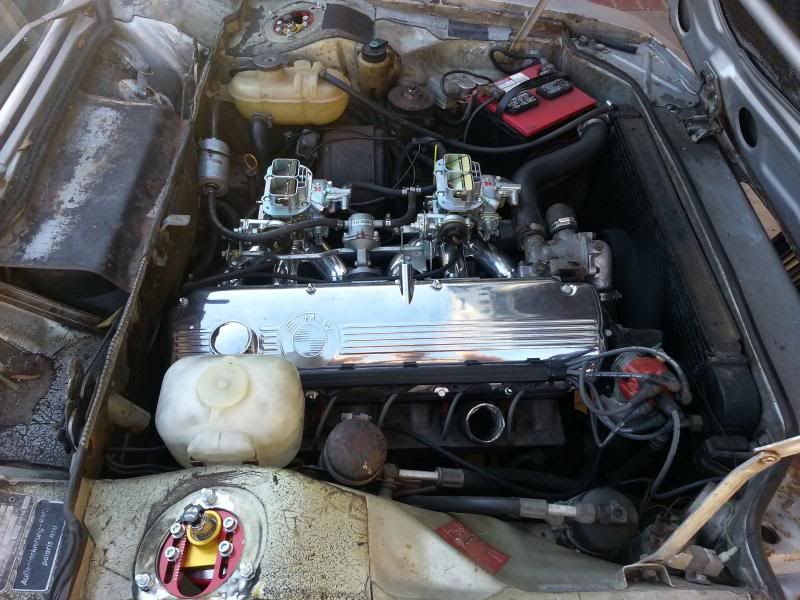

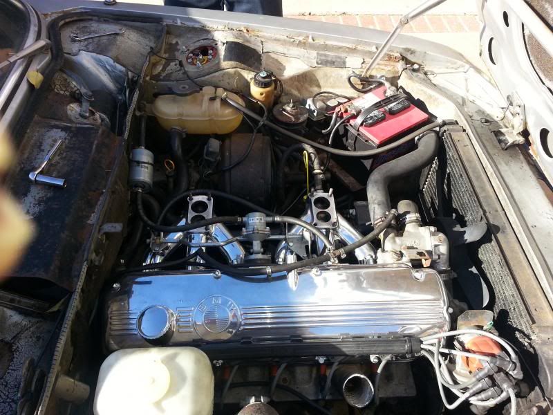

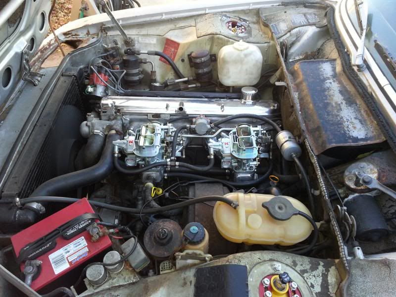

      Ok, time for a small update. A while back I had rebuilt a pair of Webers but they were starting to become more and more temperamental. They had sprung a vacuum leak at the throttle shafts. So I pulled them off again and installed the Pegasus Weber throttle shaft bearing "upgrade". It turns out the throttle shaft bushing bores were excessively worn out and it still had a vacuum leak at that area so I decided, fuck it... time to order new Webers. Installed the Webers today and got them dialed in!

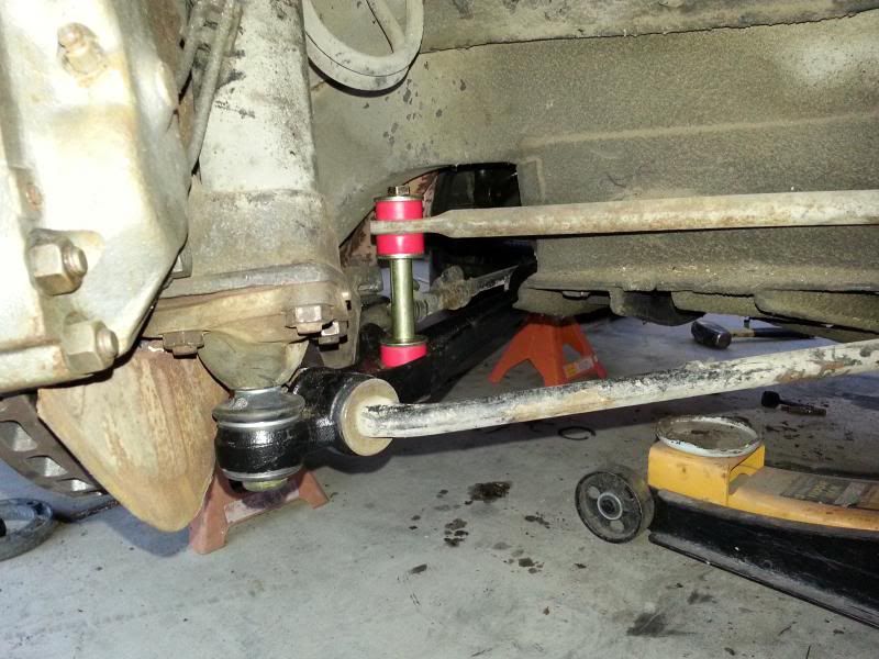

      Also installed new lower control arms and sway bar end links:

          • #20
            Loving the webers! 45 dcoe?
            • #21
              1973 BMW 3.0cs
              No, these are 32/36 DGEV's.

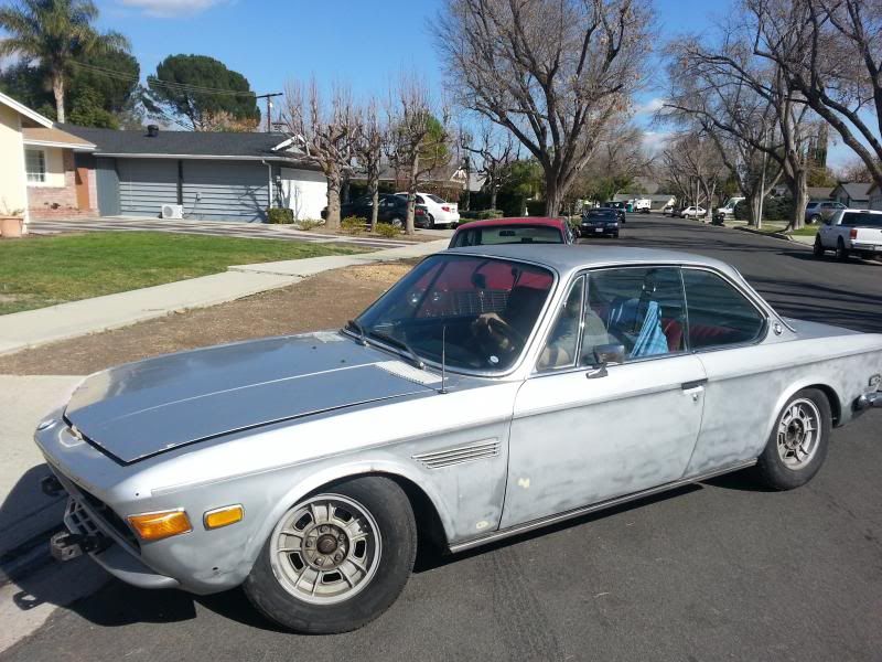

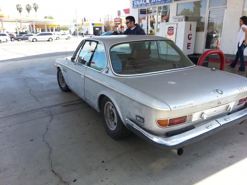

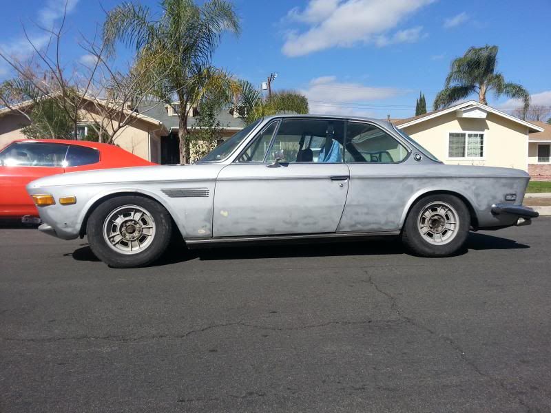

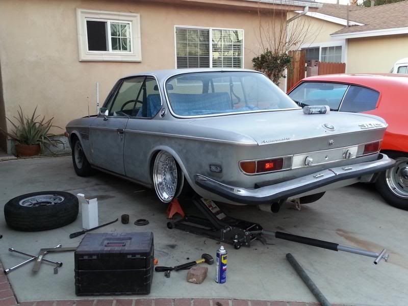

                  Time for an update. I finally finished going through the entire brake system, rebuilt all 4 calipers, new hoses, rotors an pads. Today was a big day for me, as I was finally able to place it back down on the ground and see how she sits. Even more importantly, I got to drive it!!! Ridin' dirty with no tags or license plates, so I couldn't go very far, but I drove it like I stole it! At the gas station and that's my brother cleaning the windshield...
                  How it sits:
                  Angling it into the driveway...
                  Teaser Pic, test fitting the 16" BBS wheels. Currently waiting on my step up lips an barrels to 18" from Spinfab. I can't wait!
