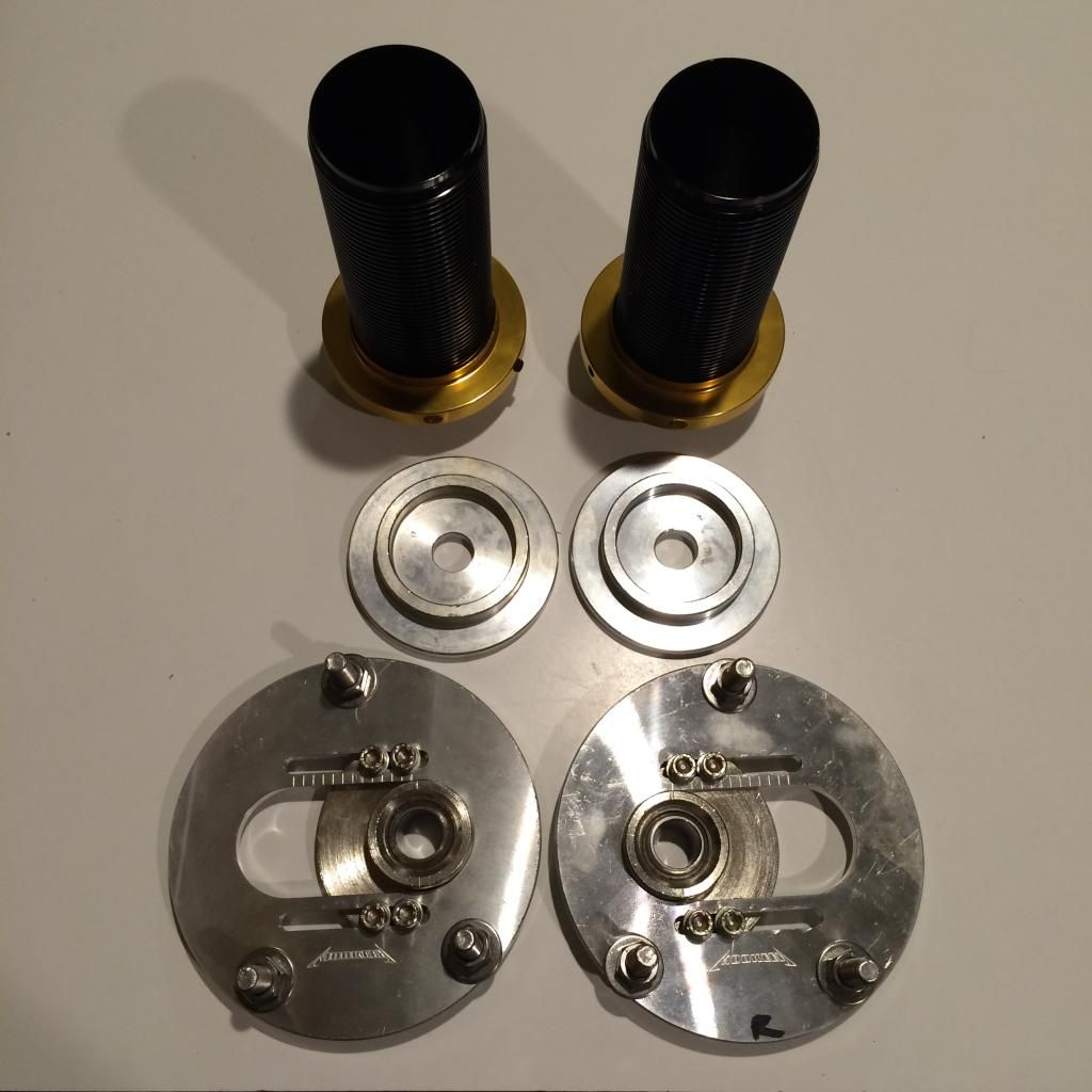

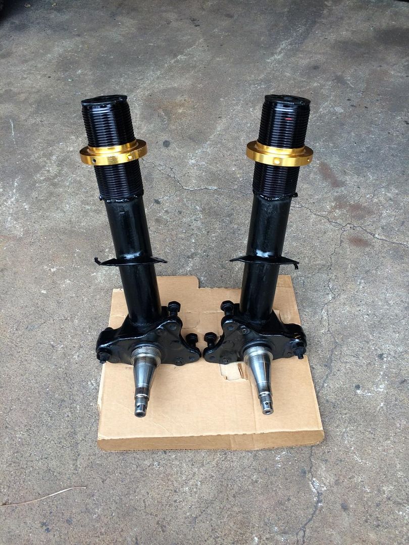

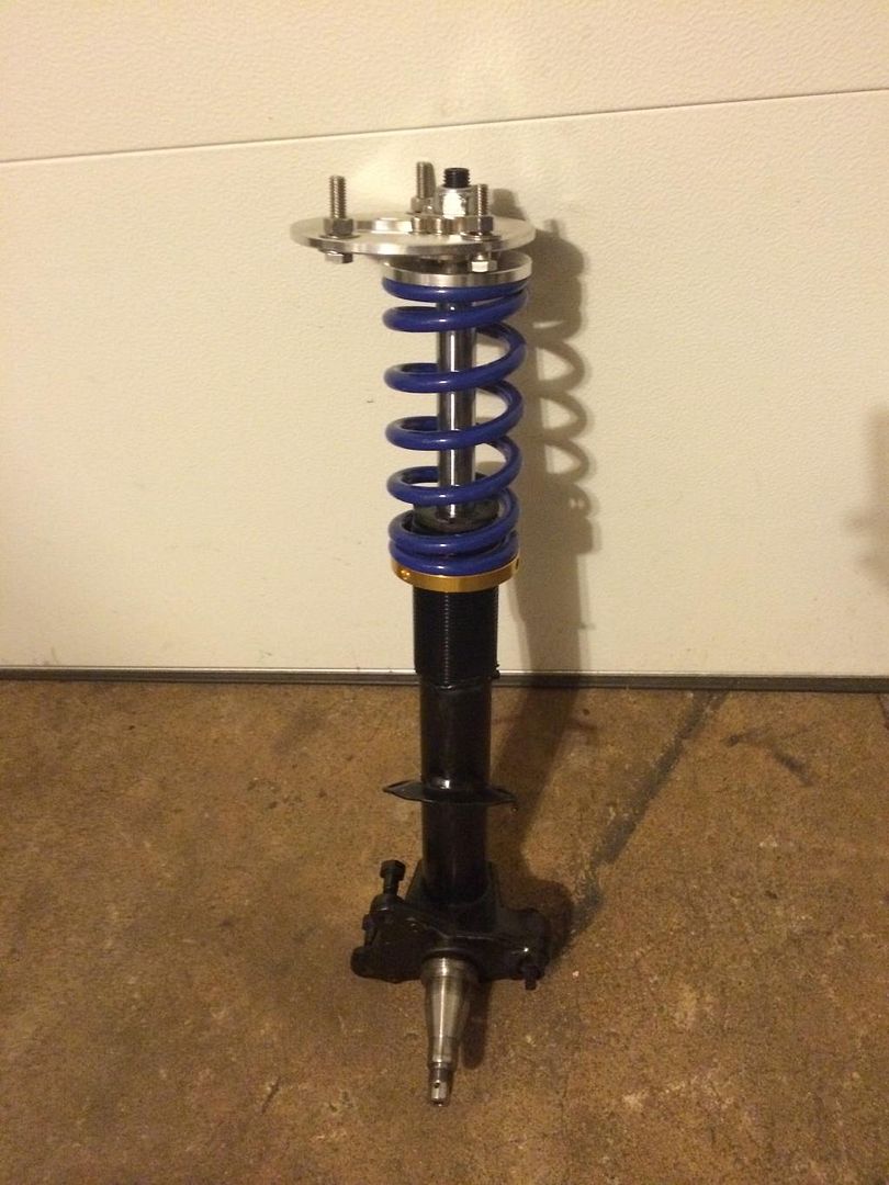

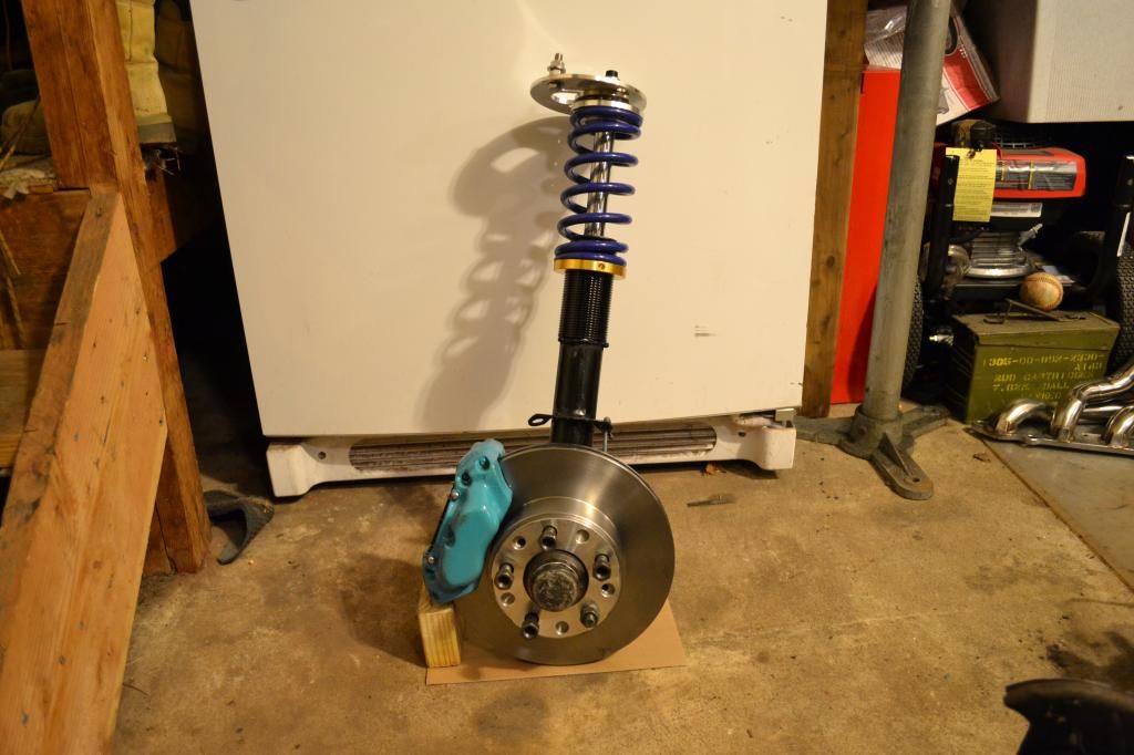

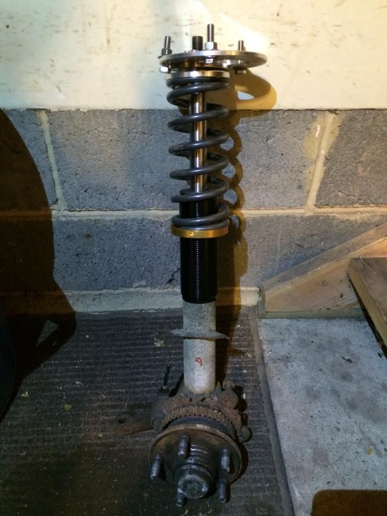

Got everything I need to build my short strut coilovers. Sleeves/perches, seats, camber plates, my neighbor has my 450# springs, and struts for a cutlass that members from turbobricks have used in the past with success.

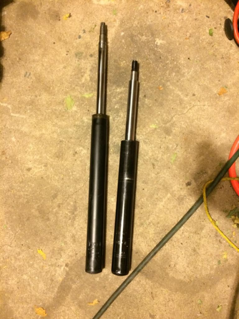

Factory vs cutlass short strut
Just have to shorten and reweld the housings which I should be able to do soon.
