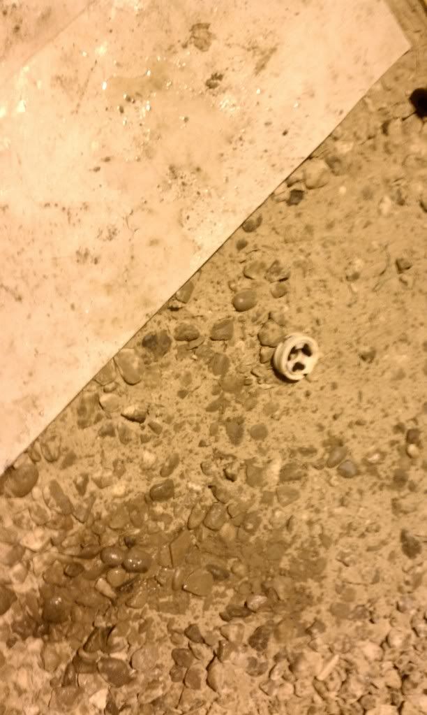

Unfortunately she still ran like shat and misfired constantly. I chased every wire under the hood, testing and comparing to my ancient CIS "trouble shooting" books I had come across. Nothing. Nothing was wrong.... All of the sensors are working WTF. Finally, I decided to swap the ECU (because, well, who doesn't have a couple spare ECU's for an ancient car laying around?) And fucking TAADDAAAA it ran like a motherfucker. Turns out the ECU was full of water. FUCKING H2O
(that came out of the ECU...)
So. She runs. Good, I might add...

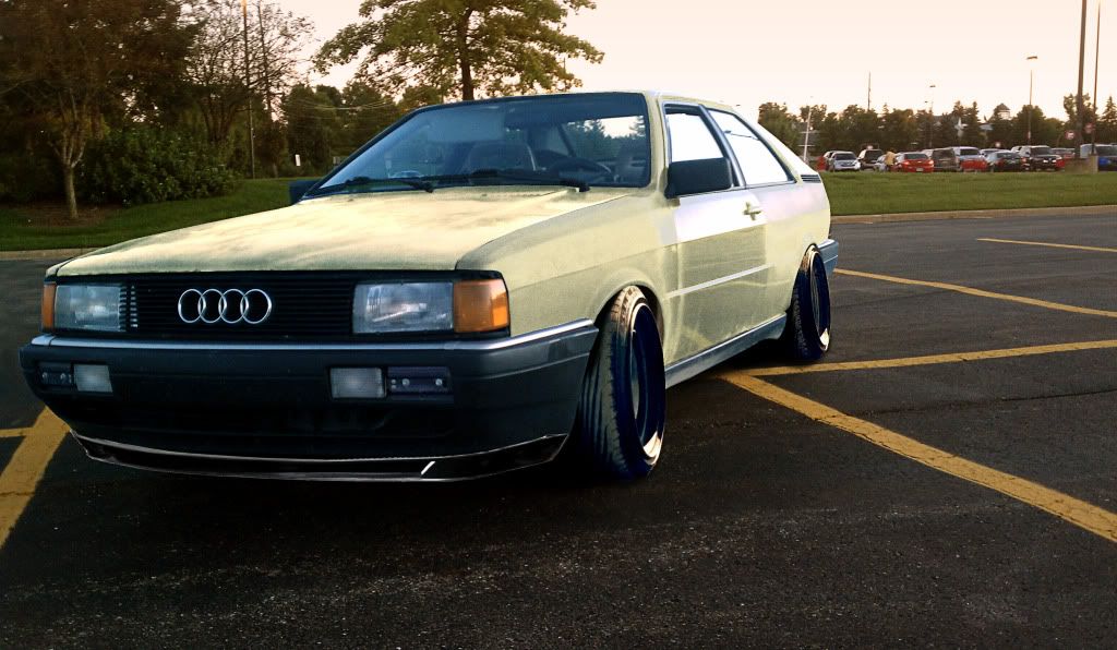

As you can see, I had some inspiration. I knew where Deloris had to be. I photochopped this together as a rough guide :
AND planning began. How exactly do you lower a 28 year old car with one piece strut/knuckle assembly's and no (real) aftermarket support. Let's be honest, I'm not lowering a Civic (no offense)
I decided to go with B2 Audi 80 struts, knuckles, hubs, and CV's (outer, to be specific). And for brakes, I went with B5 A4 calipers and rotors. However, this still doesn't resolve the low portion. Up front, I went for some Koni Yellows, A1 Racing sleeves, and 6" Ground Control springs. Out back. They are actually MK3 Golf B+G coilovers, cranked all the way up with Weitec springs. Umm, a bunch of other parts from 034... I don't know.. a lot of things. I can get more specific if anyone really cares. Or is even reading this... Does anyone actually read anymore?
