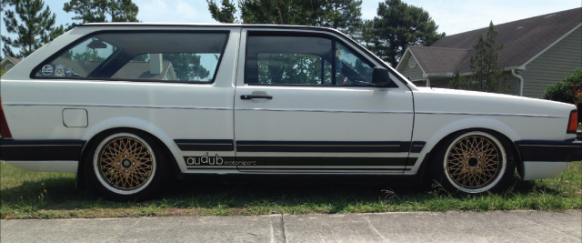

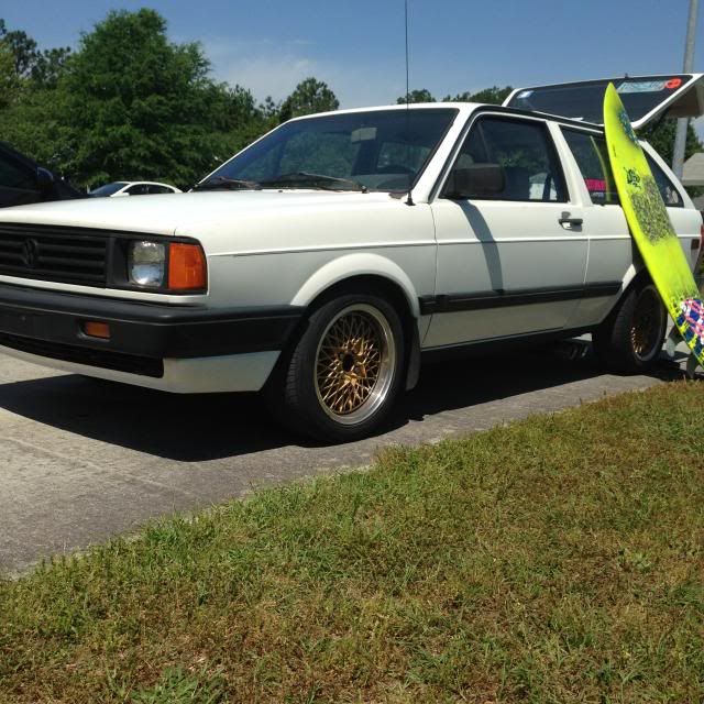

Finally got the same size tires all around

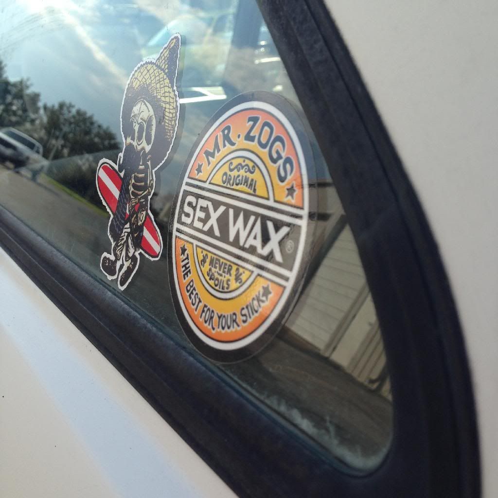

Getting the sticker out of my system while its a summer cruiser

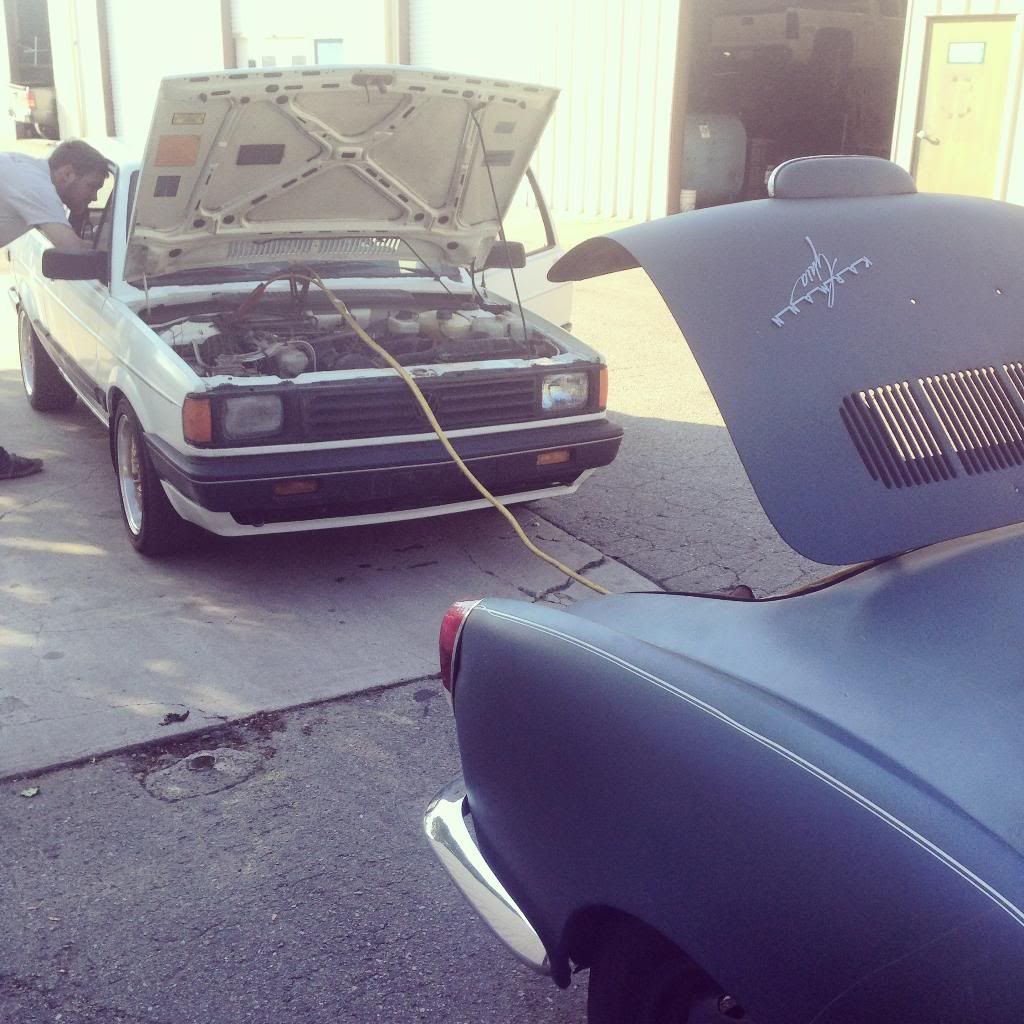

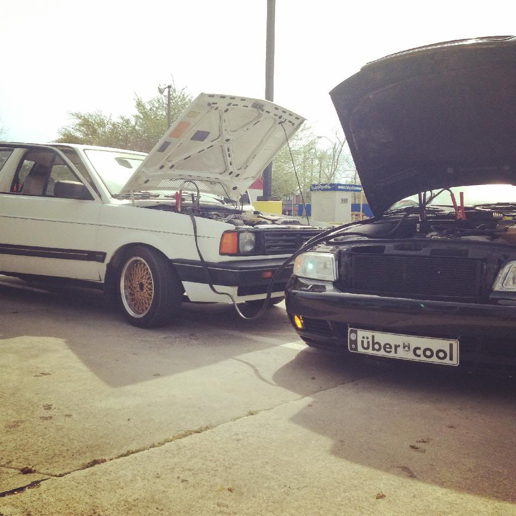

Failed Inspection.. and the tech ran the battery down trying to get her started.. she can be a finicky bitch.. Ghia to the rescue

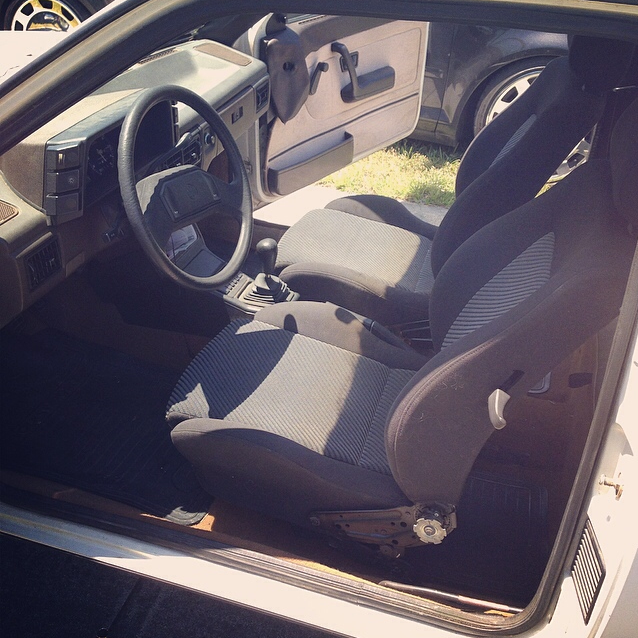

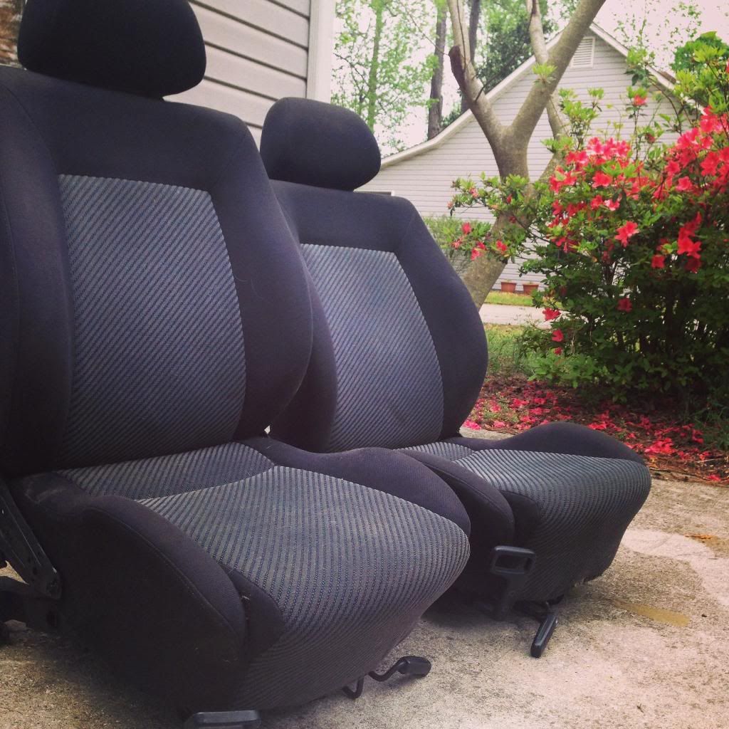

Missed out on a set of MK2 Recaro's in the picknpull.. so I got a set of Jetta Coupe seats instead (the fox ones suck, look great but have no bolster and are filled with rocks)

MK2 Jetta coupe seats installed with a little persuasion
I'm pretty sure the fox seats had some gnarly mold going on in them somewhere..

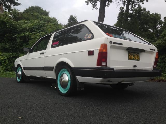

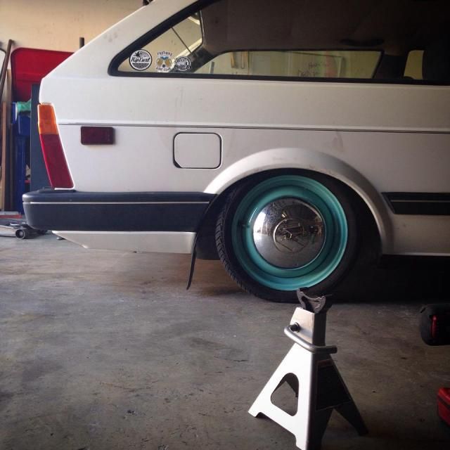

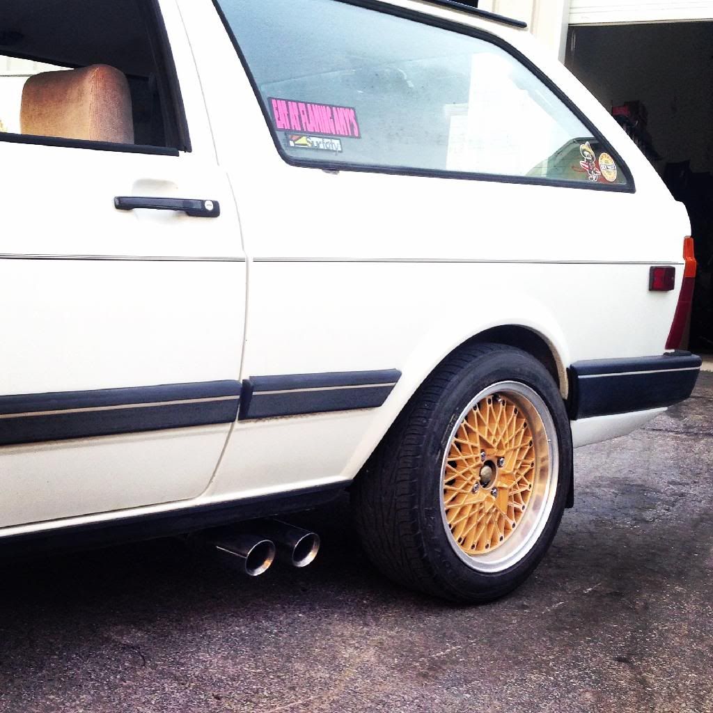

I picked up a set of coil over sleeves for an early 90's civic and put the rears on.
I still need to cut, weld and flip the front strut housings to put the front sleeves on.
I'll need to relocate the exhaust to a proper rear exit exhaust because the tips are too close to the ground to go any lower..
I'm planning on doing a scirocco type exhaust
Since the factory struts are blown I need new shocks.. according to the interwebs, mk1 rabbit struts are 2" shorter than the fox struts... so I'll be getting those to help me get closer to terra firma.. currently the rear is wound all the way down and the shock is fully compressed so it rides like poo..

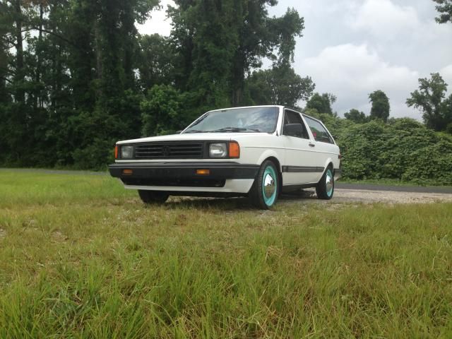

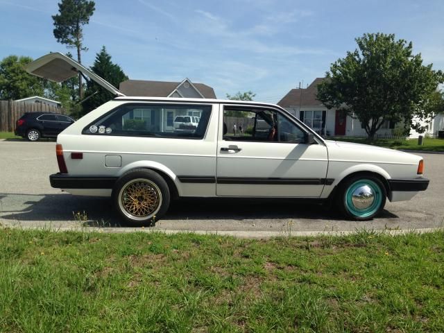

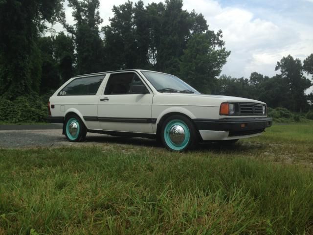

I also am running my friends bus wheels for the moment being..
They look rad, but I'm not sold on them.. I don't feel like they fit the fox's body lines very well.. but do fit the surf wagon theme
(there is a 2" difference between the OG sans and the bus wheels, 195/50/15 vs 165/45/15)
