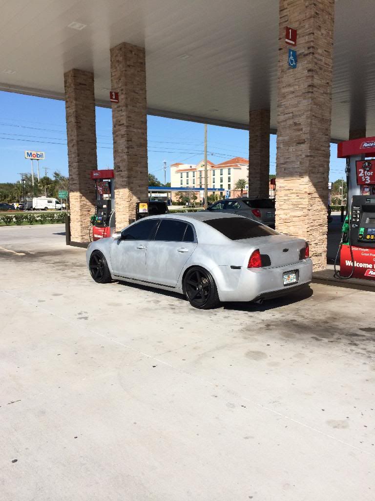

    got my new adapters to help clear my calipers up front!

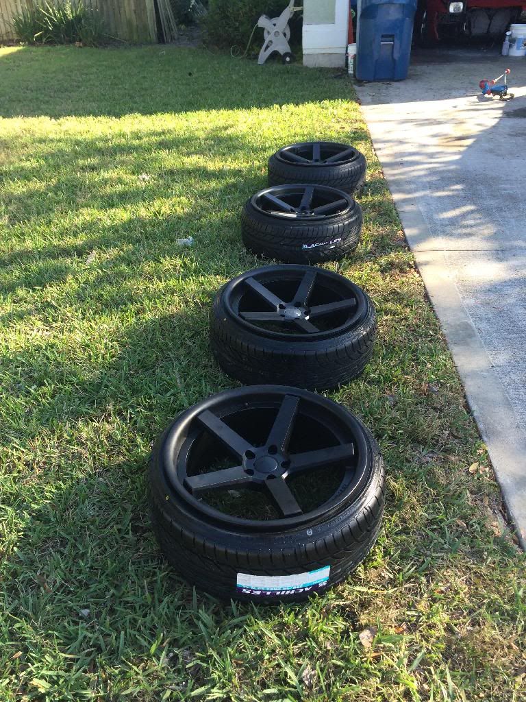

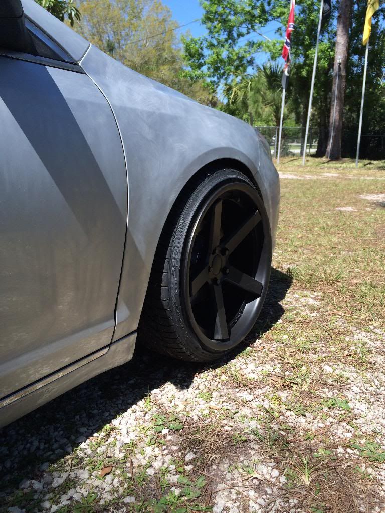

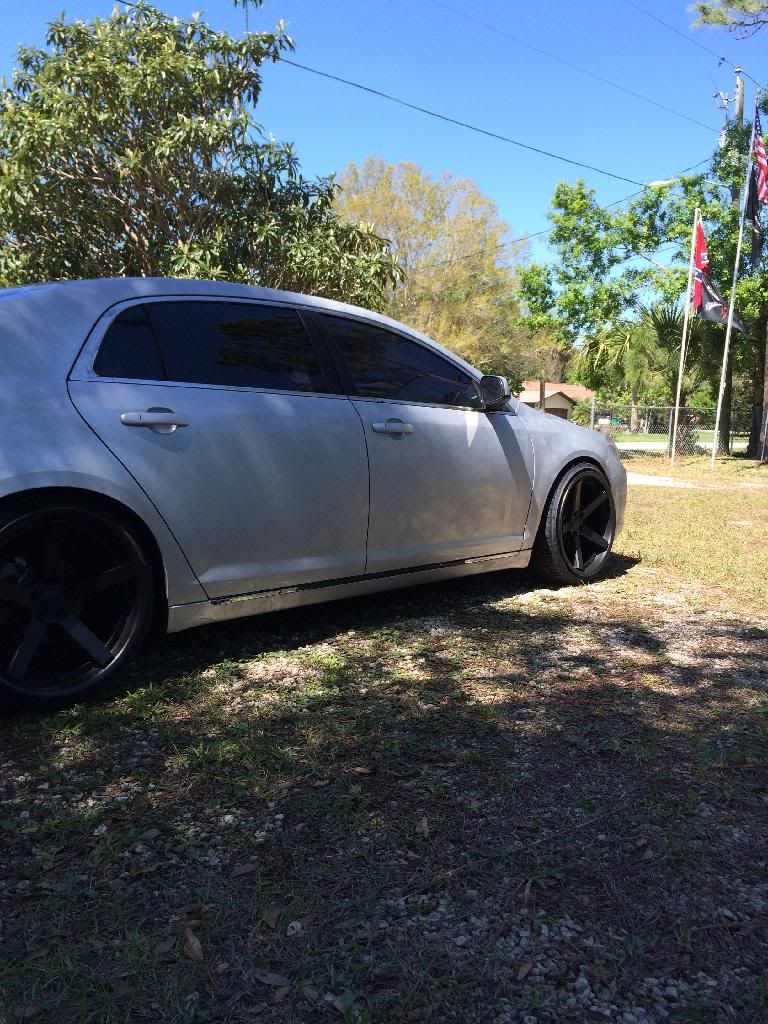

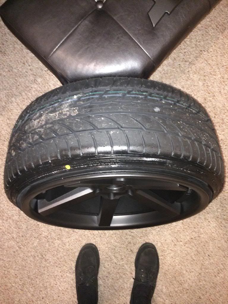

    Started dipping them Matte black to go with my new paint scheme I'll be finishing within the next couple of weeks leading up to Spring Break Nationals in Daytona Beach March 22-23rd. I am siked
    Here is the look
    Stance Sc-5 with Achilles Atr sport 225/35/20 rubber
    20x10 +35 offset

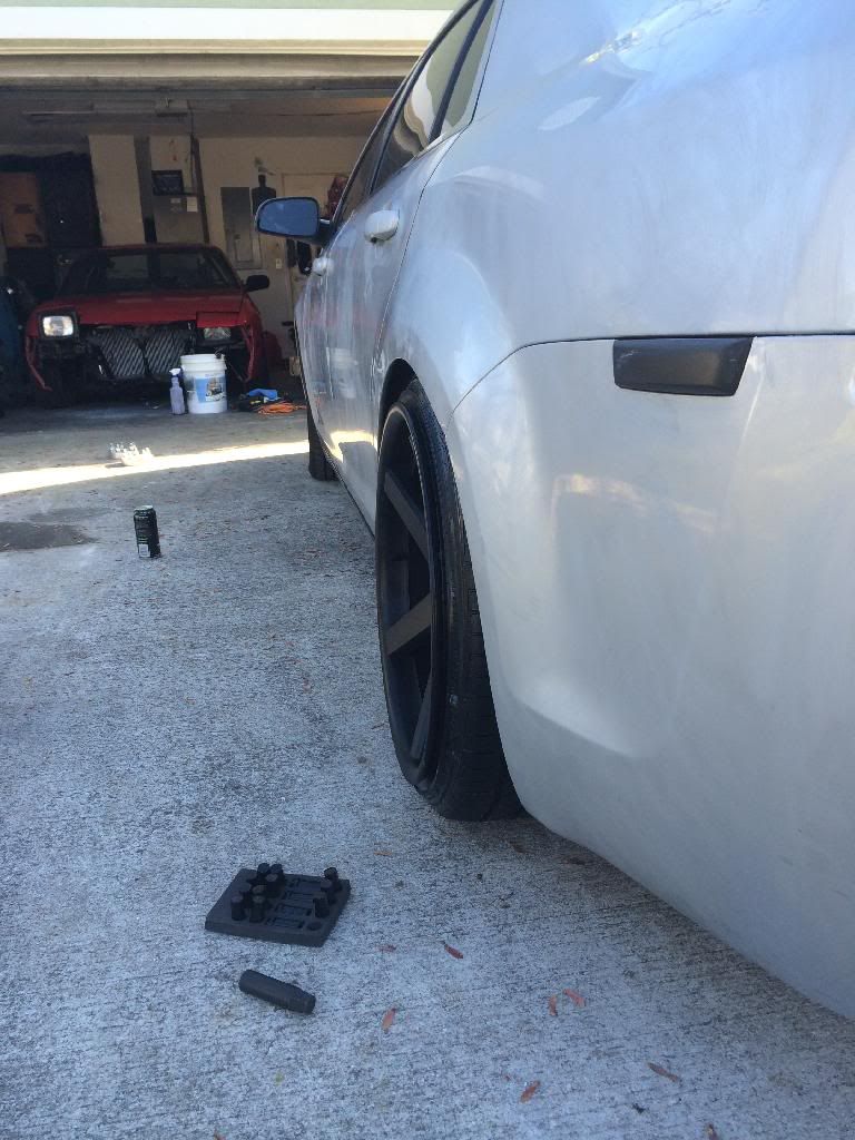

    Sooo got my wheels test mounted tonight and the back fit (will still prob get some 5mm spacers. The front hit my calipers so I have to get adapters that extend with studs bcz 8mm is the biggest spacer I can use with stock studs. Malibus ftl lol
    20x10 all around soon!
