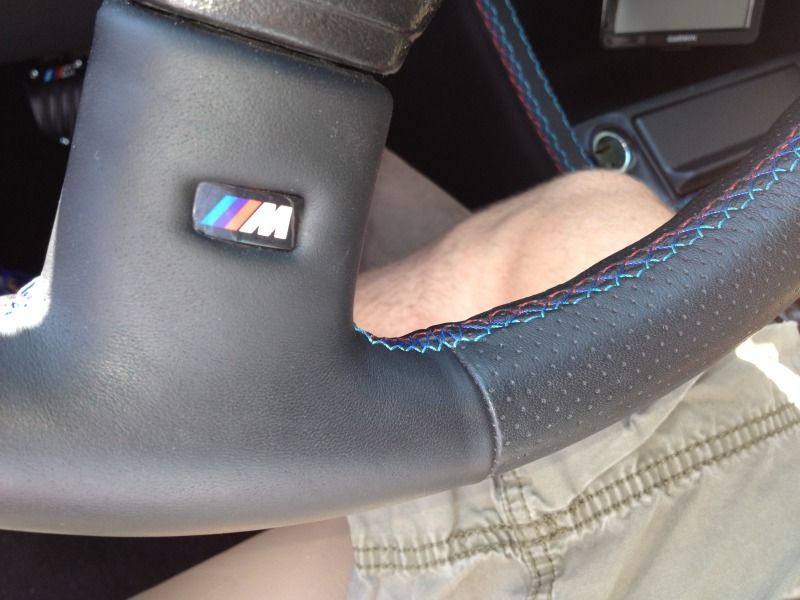

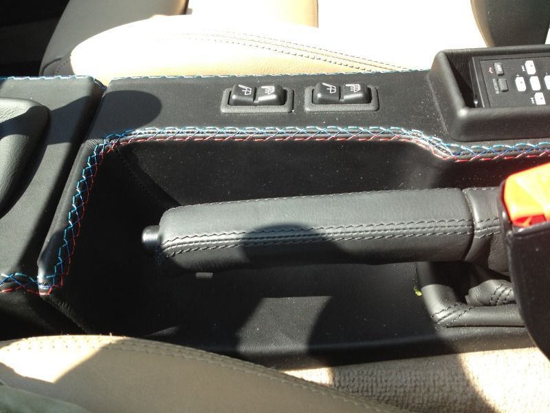

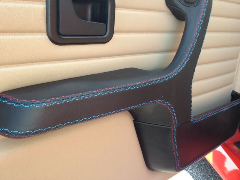

                      Just the console arm rests map pockets and steering wheel. Shift boot and handbrake were BMW parts. Kind of want to have the door and rear panels finished off eventually and possibly the dash. Seats were in almost new conditions. New wheels are possible but I have two cars needing clutches and one that I might have painted this winter and I do like my ACS.

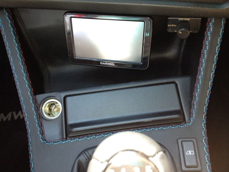

                        I think we have the same one piece knob/boot. Does yours light up? If so did you connect it to the cigarette lighter? I'm hesitant to start cutting wires under there but it'd be nice to have a light up knob.
                        Livery Wheel | Facebook | Instagram
                        E30 M3 Build Thread
                        • #57
                          I did connect it to the lighter.
