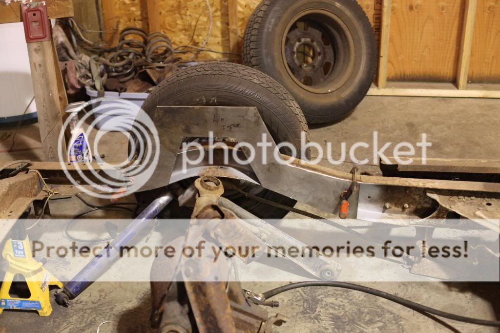

    So I after finally get this thing back onto the wheels I have been able to start figuring out ride hight.
    So thats about what I figure ride hight will be. Should be able to lay the side steps on the ground once aired out. Might have to get some drop spindles for the front to achieve that though.
    Started working on the frame notches for the rear. Took sooo long to cut them all out and probably 15 cutting disks. But I was able to get them cut out and tacked onto the frame.
    You can see that the centre of the notch is further back then the center of the original frame hump. The rear wheels were to far forward in the wheel wells from factory so I had to move the axle back about an inch. Hopefully get it all welded up tomorrow and then I can start figuring out bag mounts and the 4 link. Should be fun!

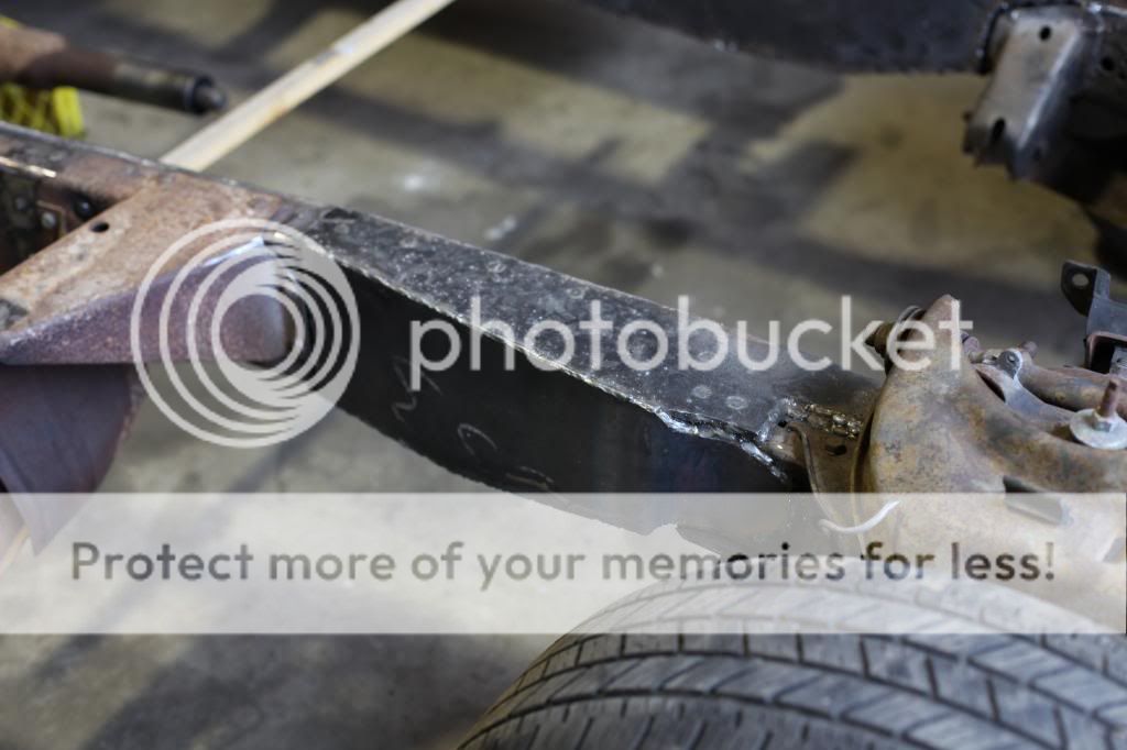

    So I finally got the chassis back on to its wheels. I was still having troubles with my MIG welder. It was being super inconsistent. The weld was bubbling up into a little mountain. Then it would kind of boil. Looked like lava rock. It would also weld like there was no gas. I was getting very frustrated and wasting a lot of time grinding down welds to redo them. After lots of fiddling around with no success, I went and to talked to the guy were I buy all my supplies to see what he had to say. He didn't really have any help for me ,but after chatting for a while I decided to buy a new roll of wire as what I had in the welder was the cheapest you could buy. So the guy at the store gave me half off on some really good quality wire and I rushed to the shop and installed it. It now welds waaaaayyy better! I made a few more adjustments to other settings but I am 90% sure there was some containments on my old roll of wire.
    So I am super happy with that. I just have to go back and redo some a few more sections but I will wait until I'm finishing up the frame to do that.
    So its back down on the wheels. The whole chassis is much stiffer and it doesn't even have the trans crossmember in it yet. Very happy with the results. Now tomorrow I have to go talk to the shop that is going to do the inspection and see if they are all good with it. Then on to the 4 link.
