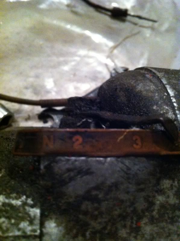

    Then rear primary cover was removed which exposed hardware to remove engine and gearbox.. First to go was gearbox. Uncovering dirt exposed this brass plaque showing what gear has been selected.
    it's stuck in 4th right meow.
