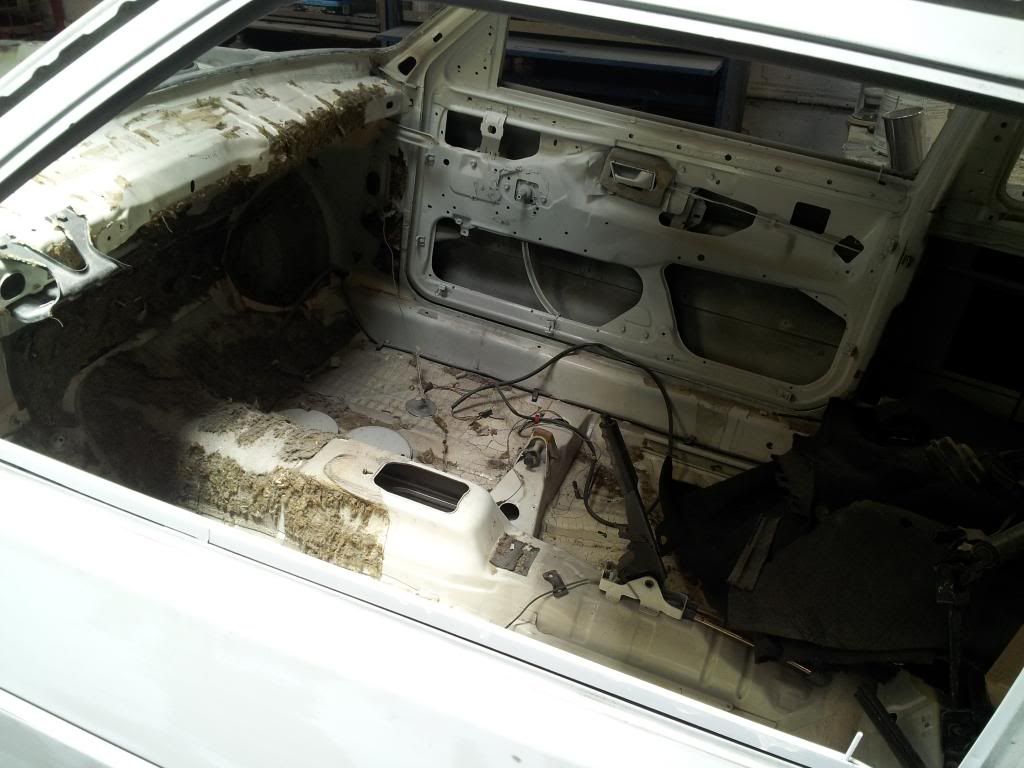

    We went ahead and removed everything under the hood and the interior because originally we were going to change the color, but the white grew on us so we decided to keep it.

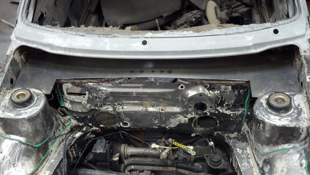

    Got under the hood, to start cleaning it up and it soon got out of control...

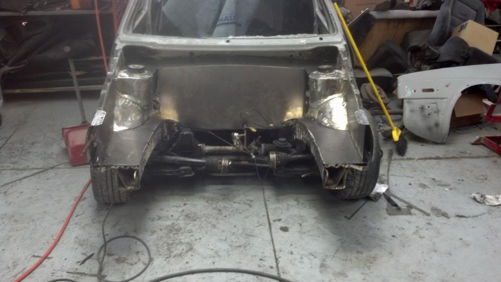

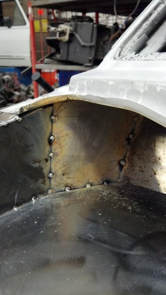

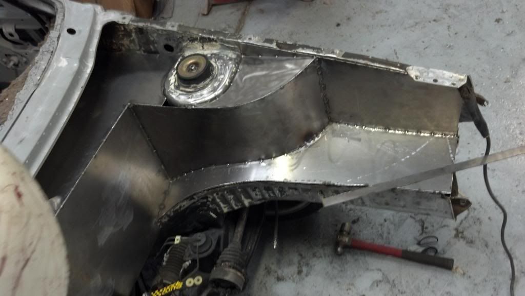

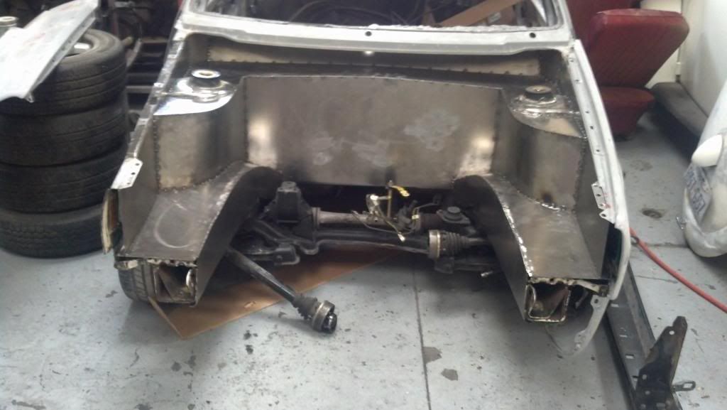

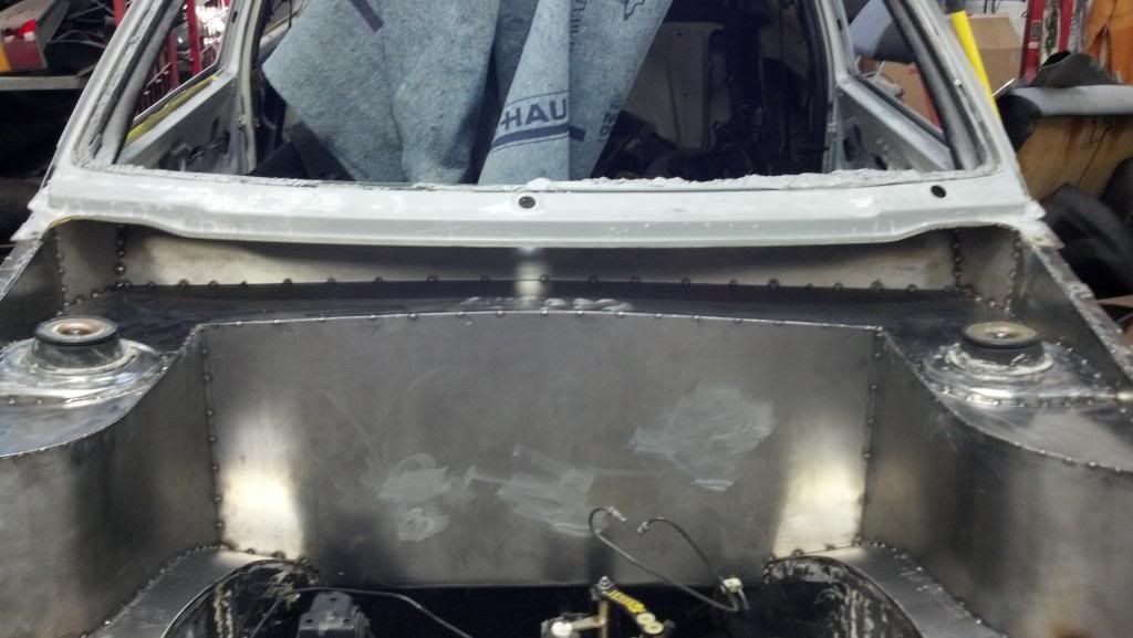

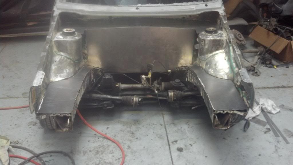

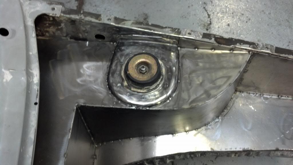

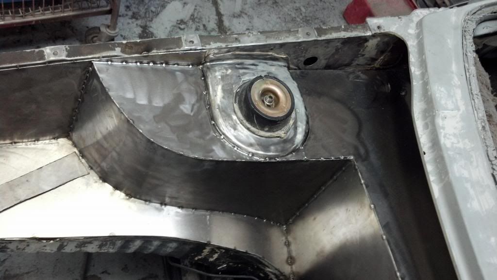

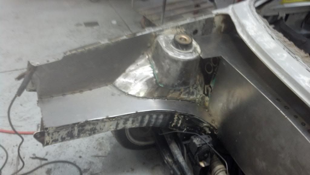

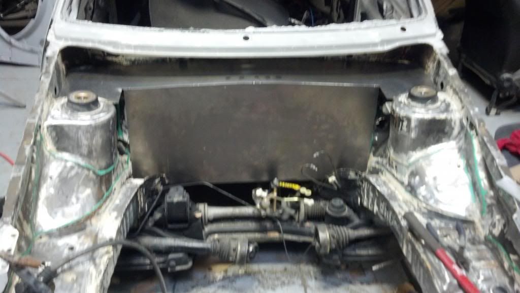

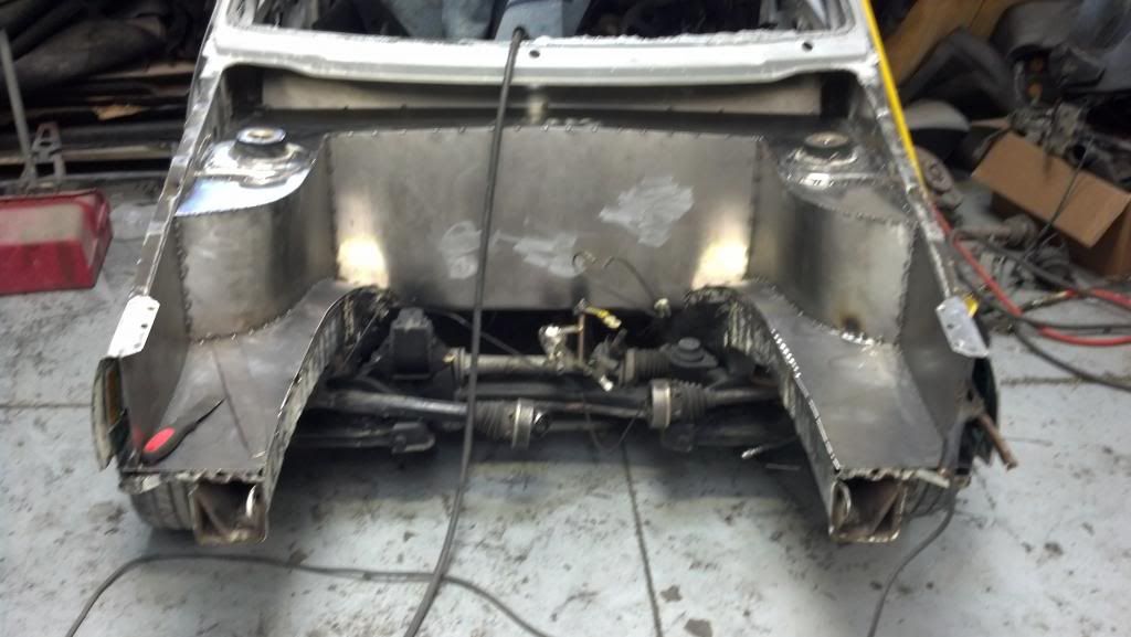

    Removed the raintray, and made a panel to smooth it out. Some people call this shaving the bay, we call it melting metal art.
    Firewall plate
    Chassis leg plates
    Inner Fender plates
    Looking better already

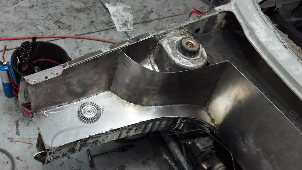

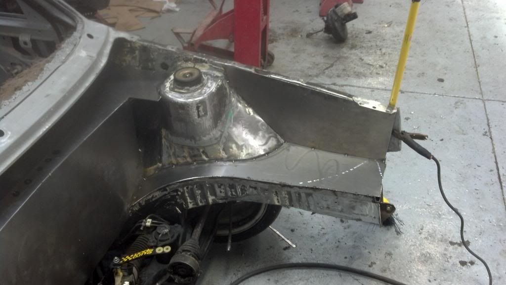

    Making a strut tower cover/box/idunno/coolantbottle thingie
    Other side
    We don't know what we're gonna put in there so no holes have been cut out.

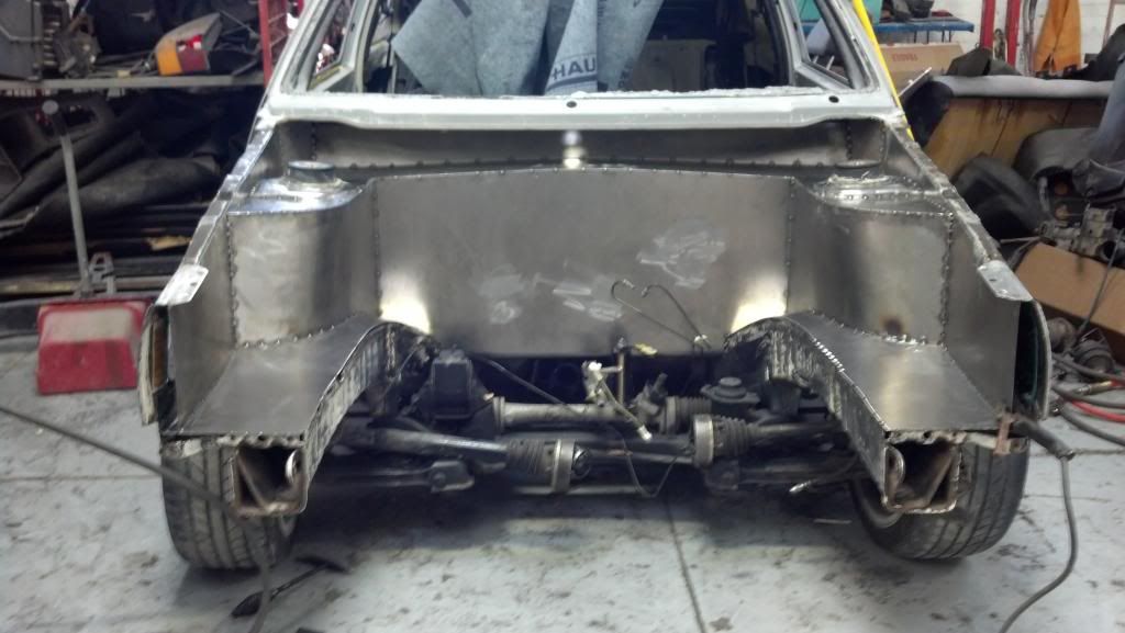

    Made some panels for the raintray area to finish it off
    As it sits now

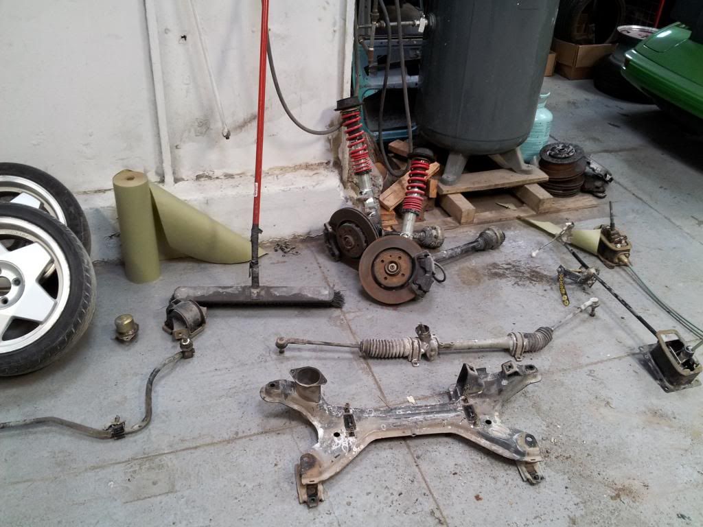

    Then we removed the front suspension, engine cradle, pretty much everything to get stitch welded and powdercoated.

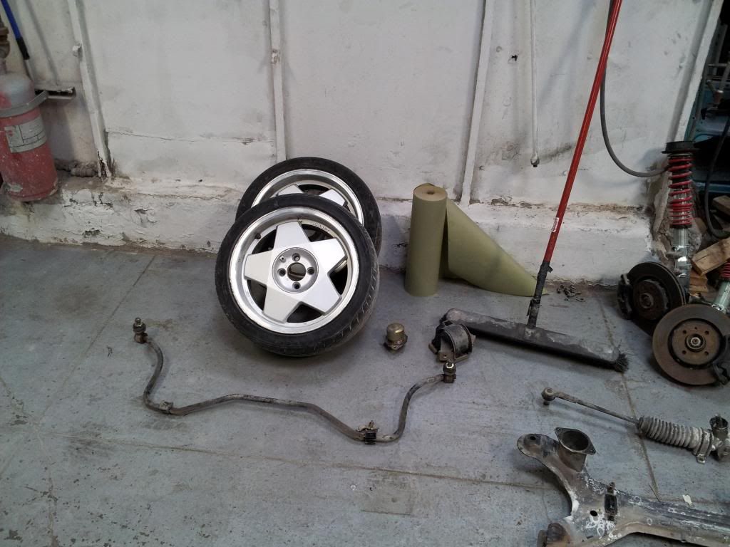

    and if you were wondering what wheels we had on it... Borbet Type A's 16x7.5 and 16x9 staggered set. Wheels might change though.
    If you can believe it, these are our shop rollers, which means we use these for 4x100 cars when they get a flat to roll around with lol.

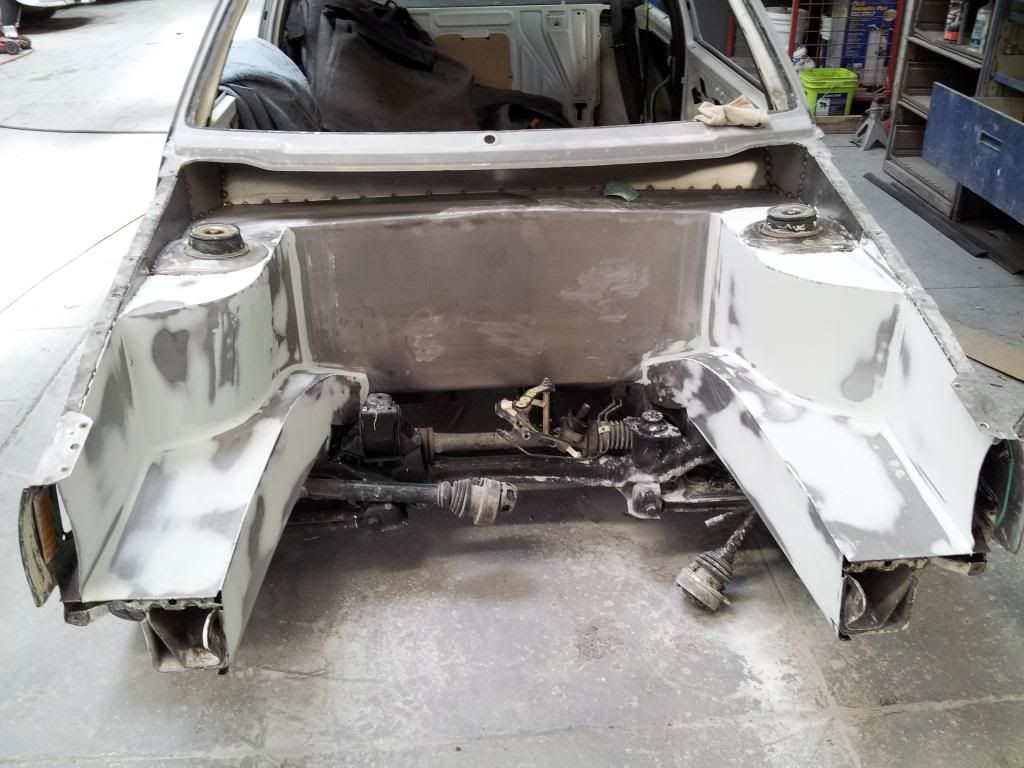

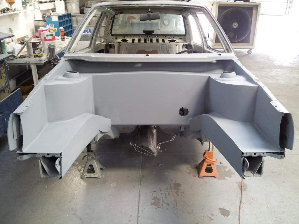

      Finished metal work.

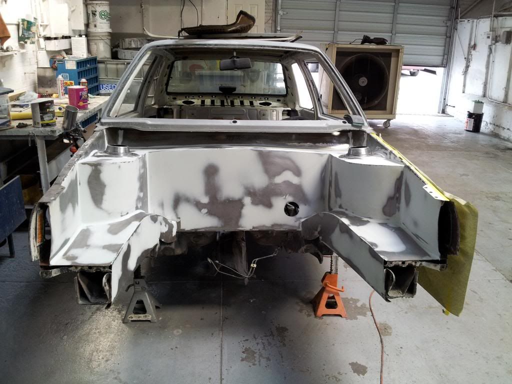

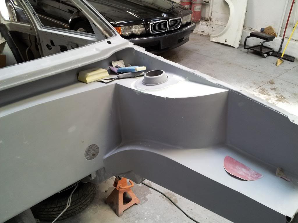

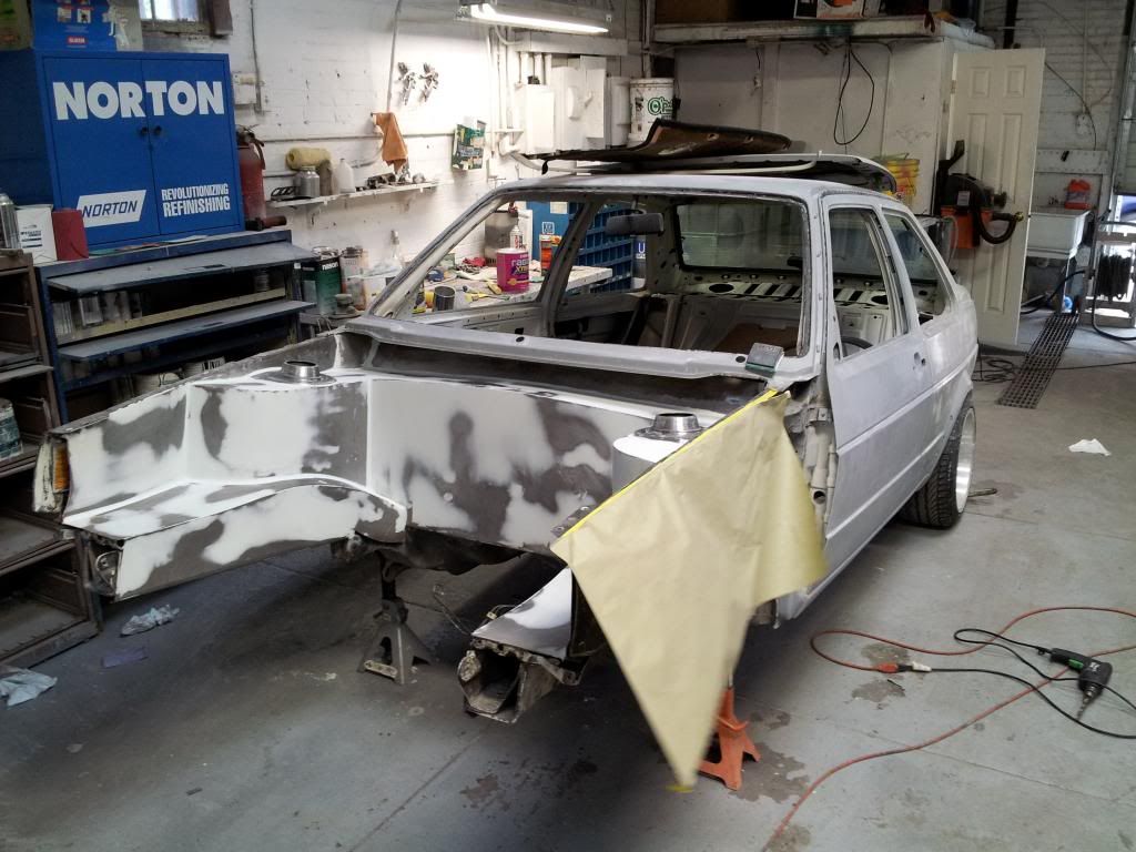

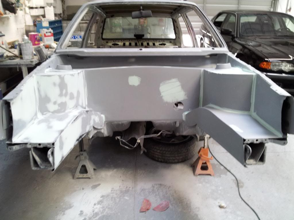

      Started on bodywork in the bay.

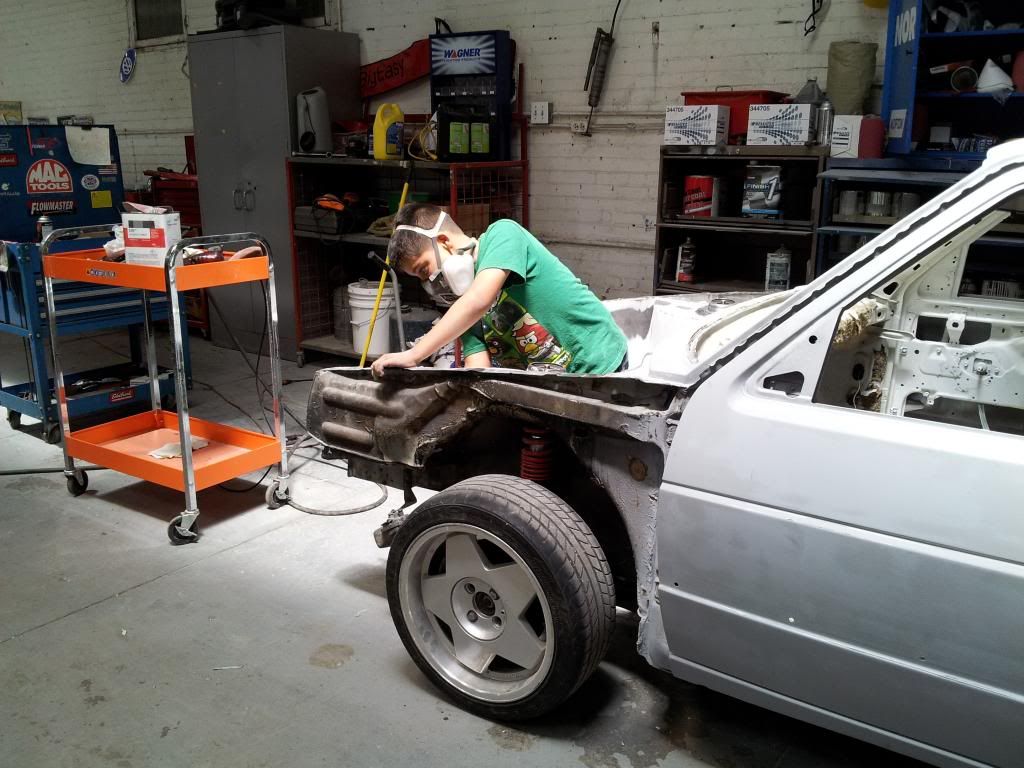

      Breaking some child labor laws...
      No child was made to work, he is just there for illustrative purposes...

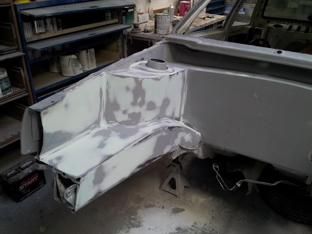

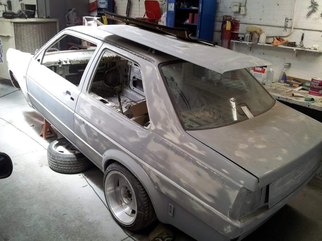

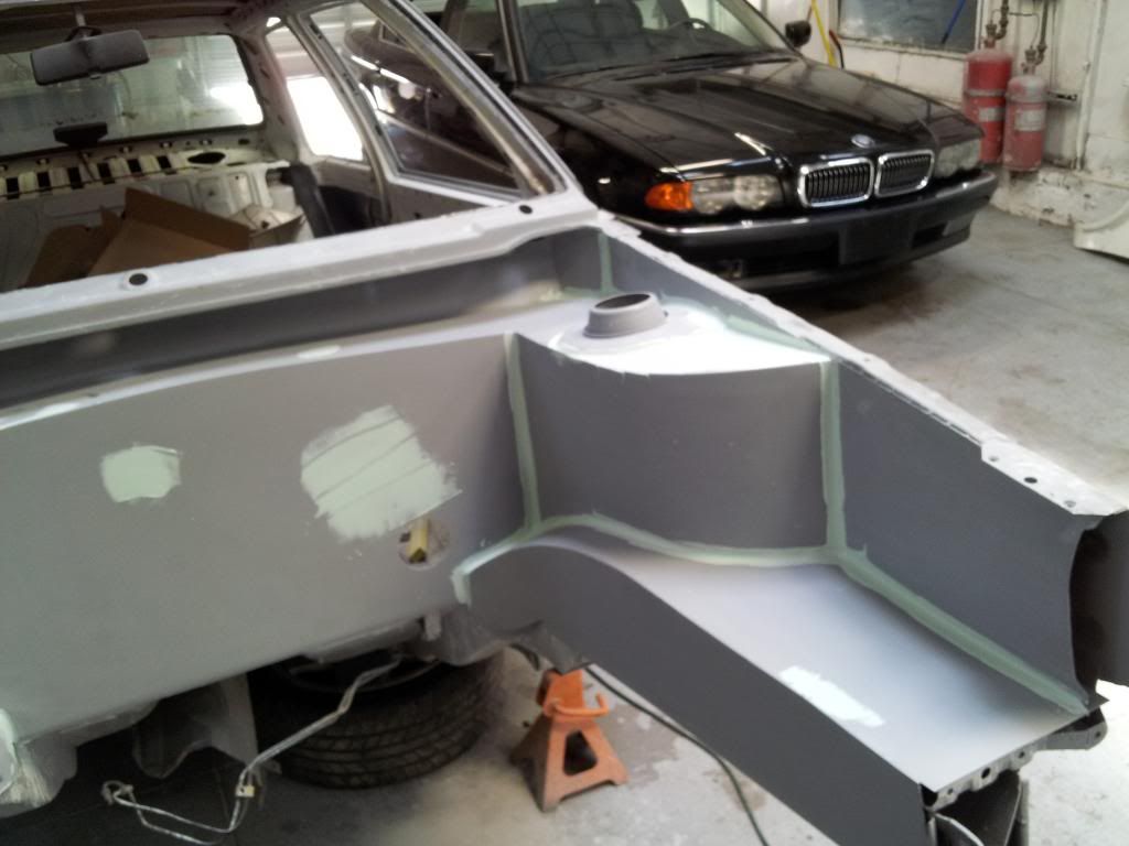

      Dry blocking done
      First round of 2K primer
      Will be blocking it some more then some polyester finishing putty before doing the final primer. Will keep updating.

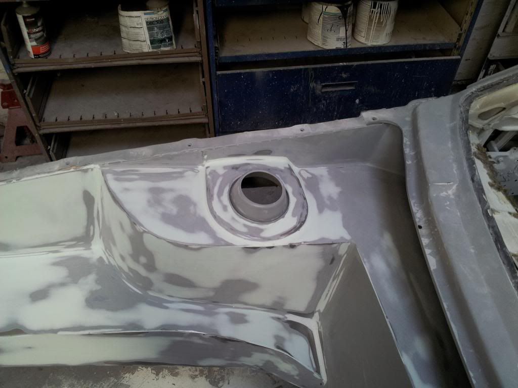

                  Nothing big to report, just some polyester finishing putty work. This is a shop project so most of our time is spent working on customer cars, so this has to take a backseat. I like to spend some time on it each day though if I can.
                  Some pics;
                  Before putty
                  After putty

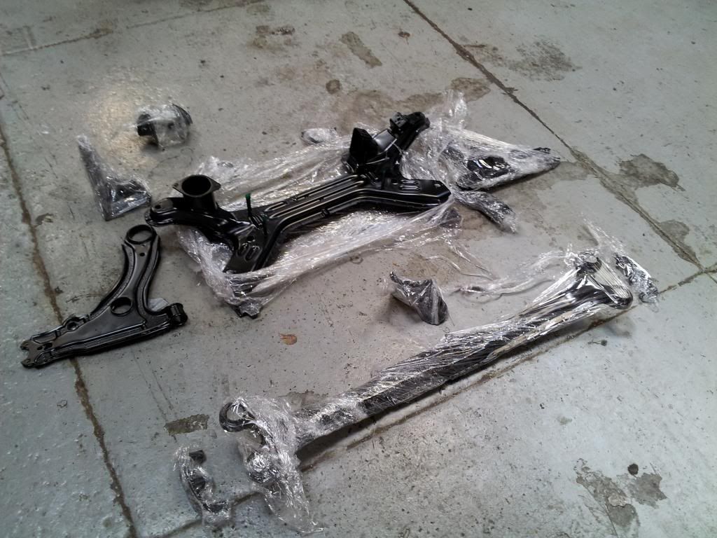

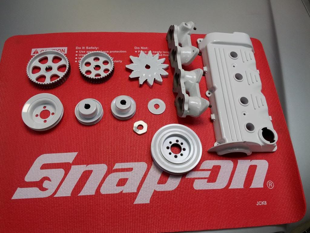

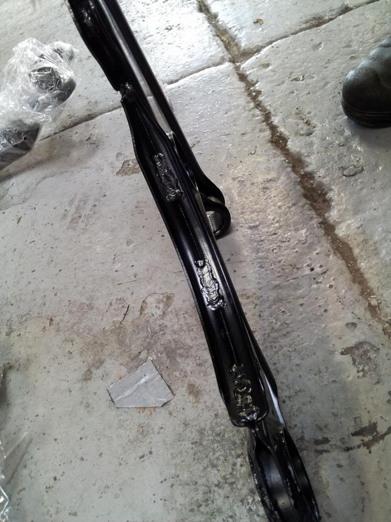

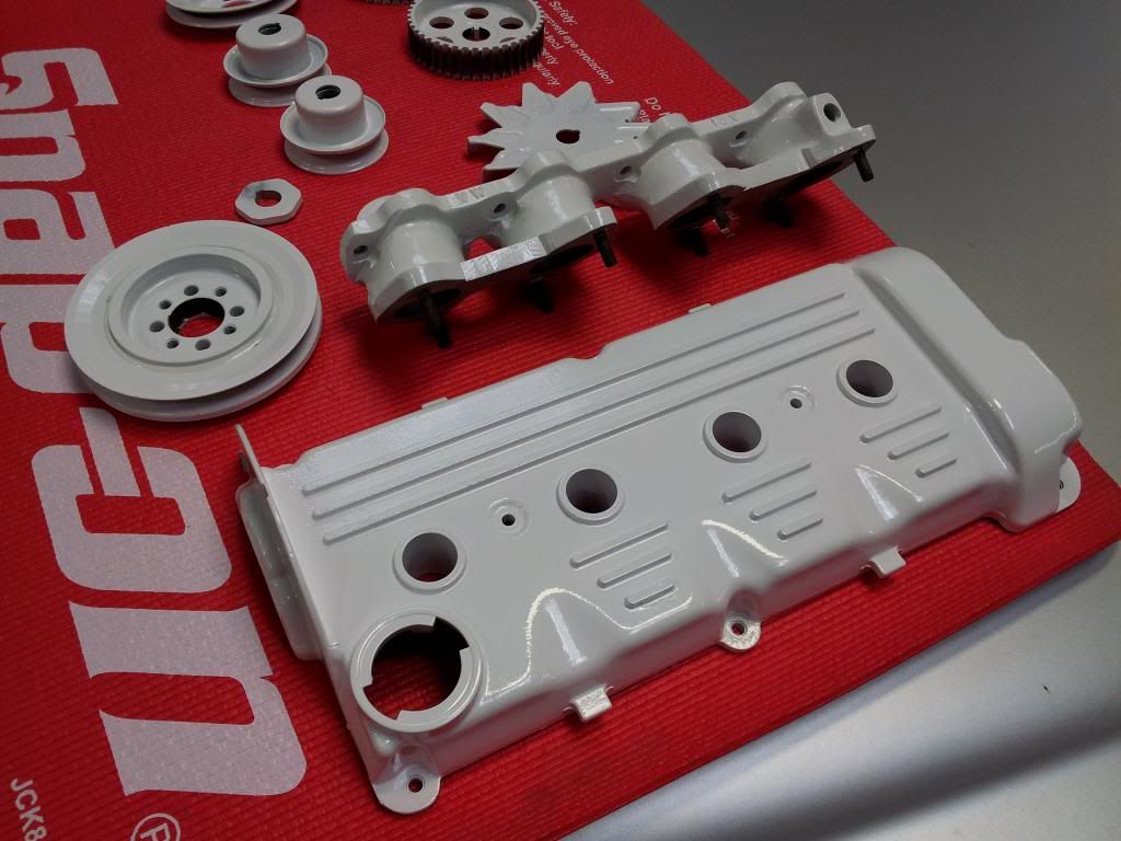

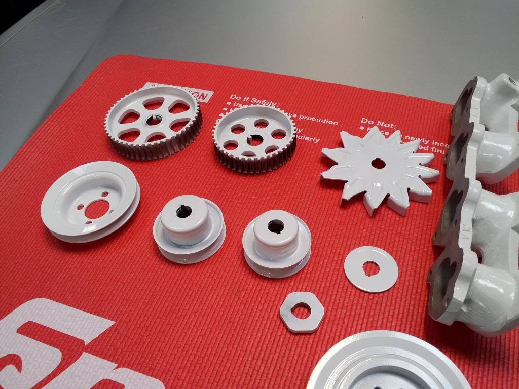

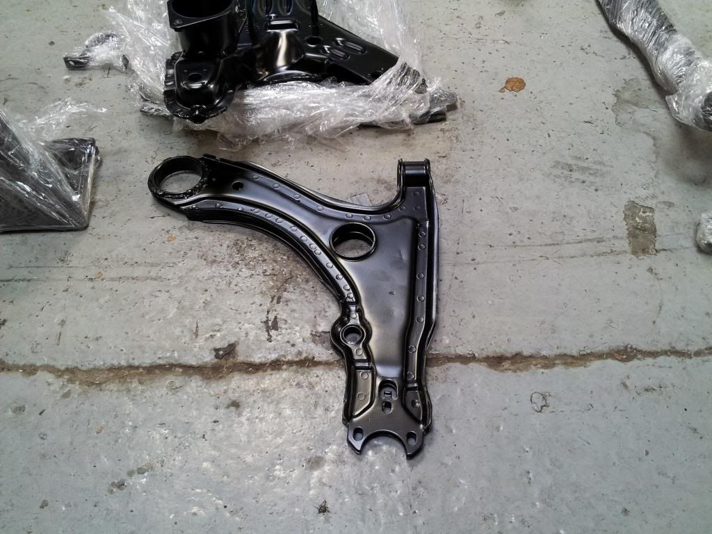

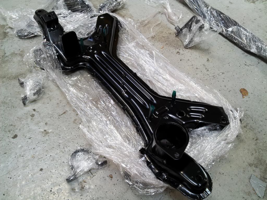

                    Got some stuff back from powdercoat. Suspension and engine stuffs.
                    some pulleys, gears and various washers
                    valve cover, carb intake
                    suspension stuffs
                    nice and semi gloss
                    stitch welded and seam welded
                    Waiting on suspension bushes from prothane so we can assemble the suspension and make it a roller again.
