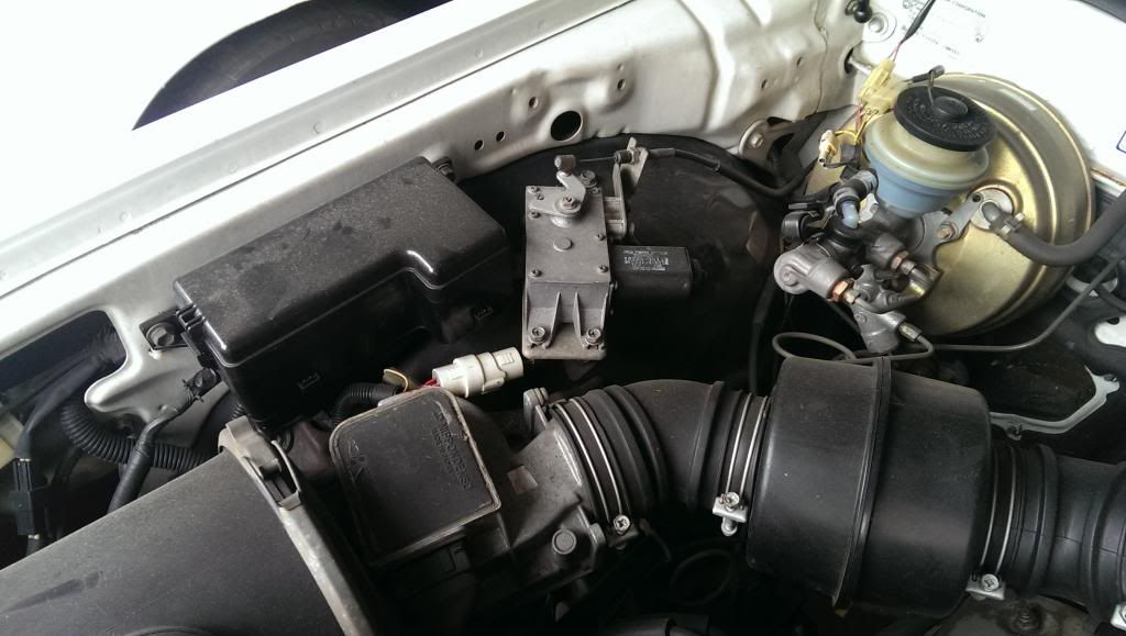

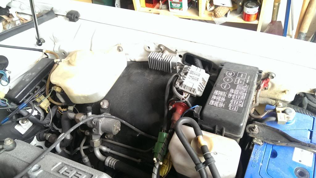

                              • Well I haven't been twiddling my thumbs all this time.
                                Well actually I have, coz I went away for 1 week, but after I did try and do some work on the Crown.
                                I've been trying to figure out how I should proceed with modifying the front end and what needs to be done to have the wheels fit.

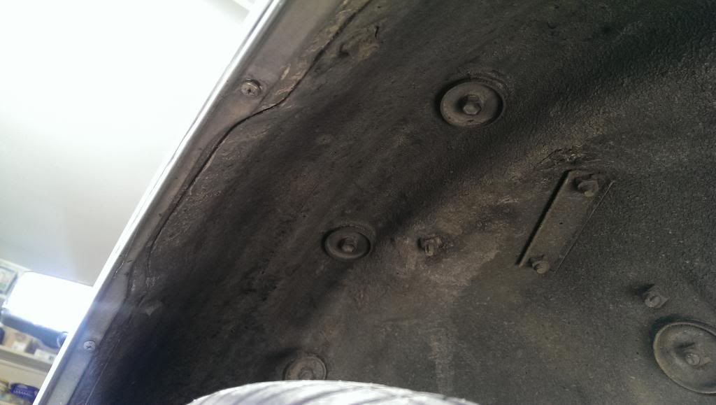

                                The car is a ladder frame chassis and as such most of the parts on this car are bolt on. Including the inner tubs on the front.
                                But these tubs are not plastic, they are metal and have a lot of stuff bolt onto them.
                                The problem is, the area where the tubs meet the fenders will get in the way of going low and flaring the guards.
                                So I've been investigating a few options.
                                Option 1:
                                Remove the tubs completely and run air tubs.
                                The issue with this is that there are a lot of things that mount to the tubs, so this will need to be cleaned up/relocated or new brackets made.
                                The also means that the engine bay will get filthy really quickly as all the dirt will be flying in.
                                Option 2:
                                Cut out the section where the inner tub meets the fender, but leave the section that continues to the engine bay.
                                This solution should give enough clearance to flare the guards and lower the car without scrubbing.
                                It will also stop dirt from coming into the engine bay unlike air tubs and will also let me leave most of the engine bay untouched.
                                Option 3:
                                Unbolt the fender from the inner tub where they join and flare the fender to suit the wheels.
                                Then massage the inner tub with a hammer to clearance for wheels and lows.
                                This should let me retain and almost stock appearance for when trying to clear defects, but one that would probably take the most panel beating work.

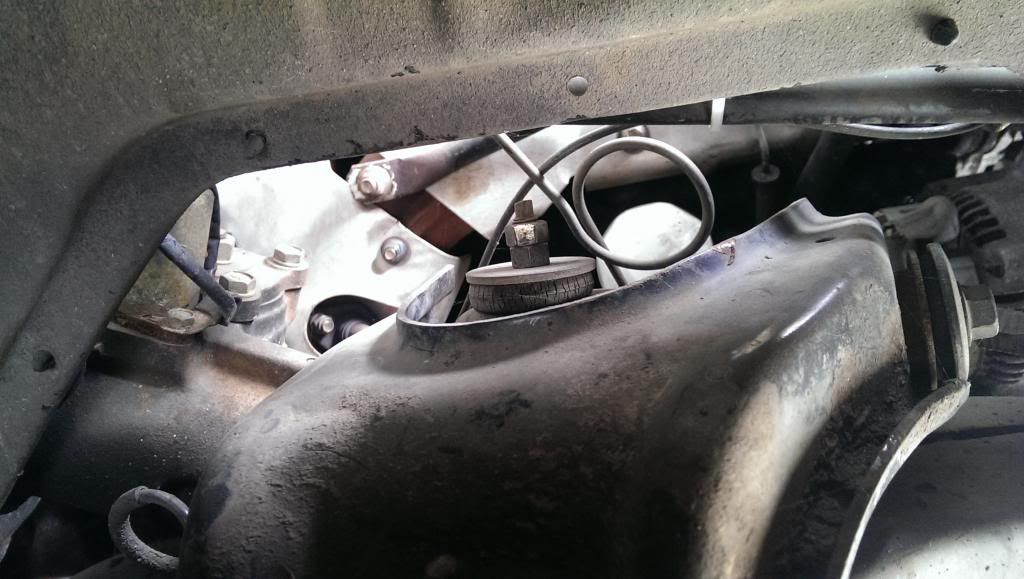

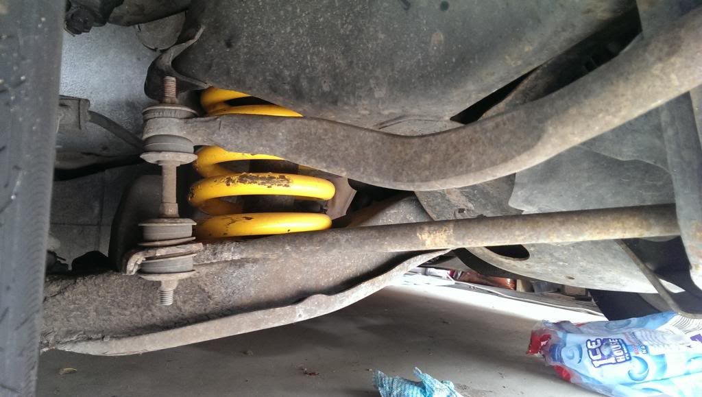

                                I've also been investigating what kind of coilovers I should order.
                                The spring and shock mount is about half way on the lower arm, which means that there is a lot more leverage at that point, about double.
                                So I think I will need to up the spring rates I was planning to order. Now I'm not sure if I should be ordering 40kg or 60kg spring rates...
                                Also the shock is really short, so the whole coilover assembly would have to be tiny...
                                The exact length I will need to figure out once I drop the suspension out and can fit a ruler in there.

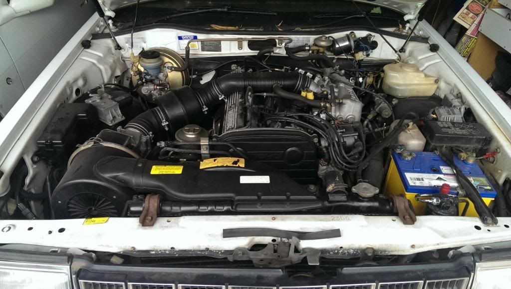

                                To tidy up the look of the engine bay I think I'll just respray the valve covers as most of the paint has flaked off with age. Just factory wrinkle black with brushed fins

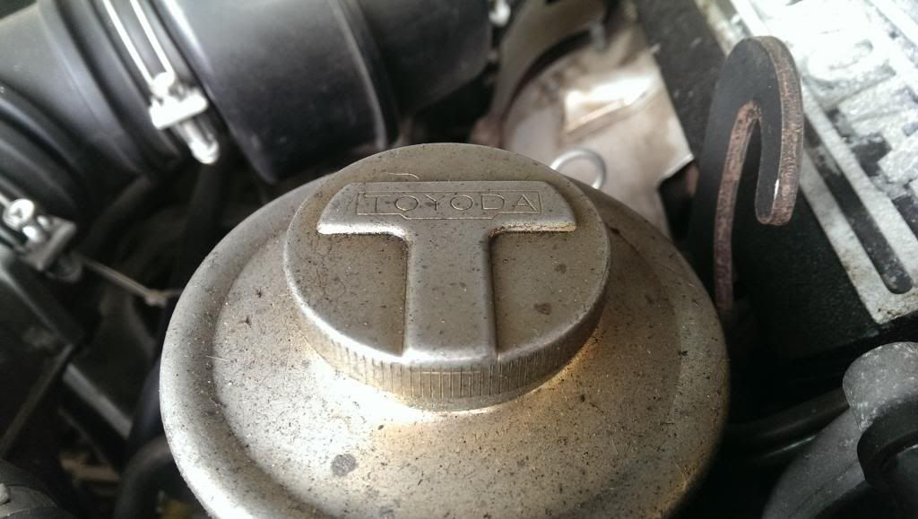

                                Oh and apparently its a TOYODA
