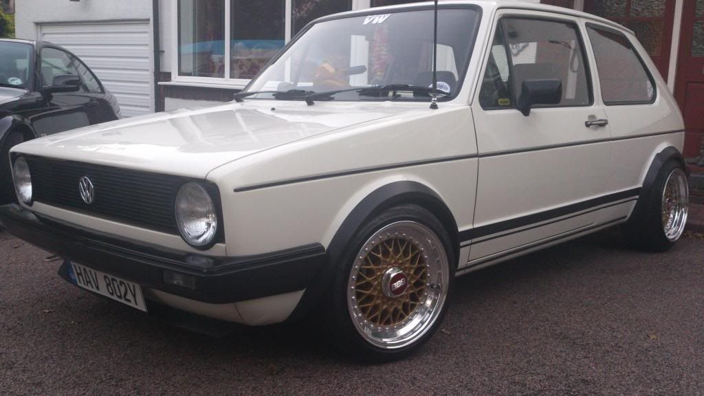

My first car - 1983 Mk1 Golf
  • mk1poloboy
    replied
    this one
    DSC_8848 by lukeherbert1, on Flickr

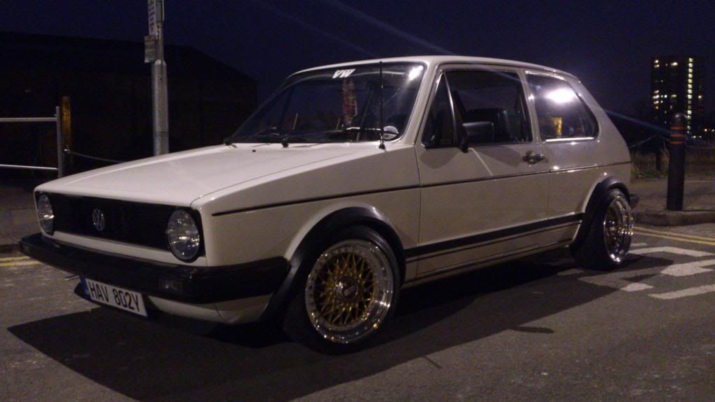

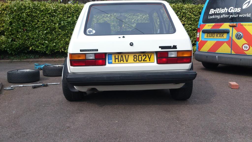

    I took her for MOT, and she passed with no advisories on the old wheels!
    As soon as i got her home, that was it, new wheels being fitted and the coilovers being wound down!
    I was rather pleased with the results!
    Mid fit

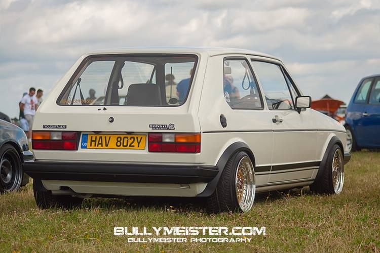

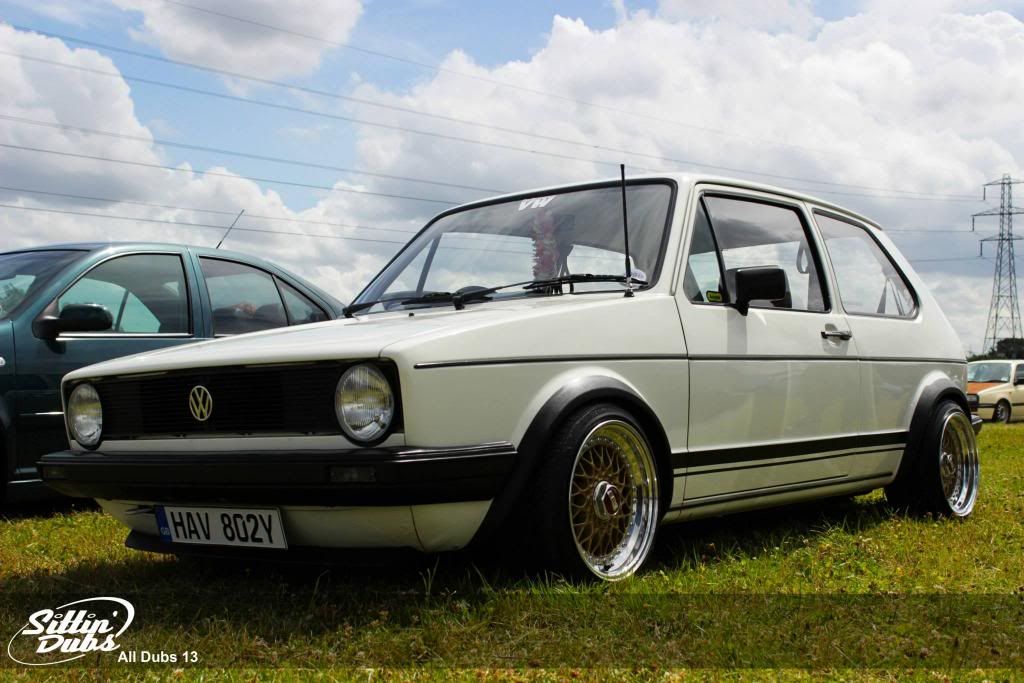

    Heres a few photos other people have taken at a couple of shows!
    Check out Bullymeister photography on facebook! https://www.facebook.com/bullymeiste...graphy?fref=ts

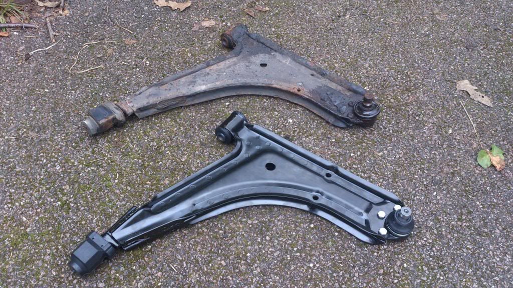

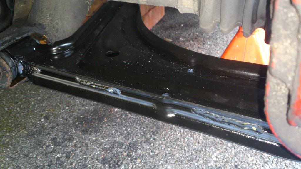

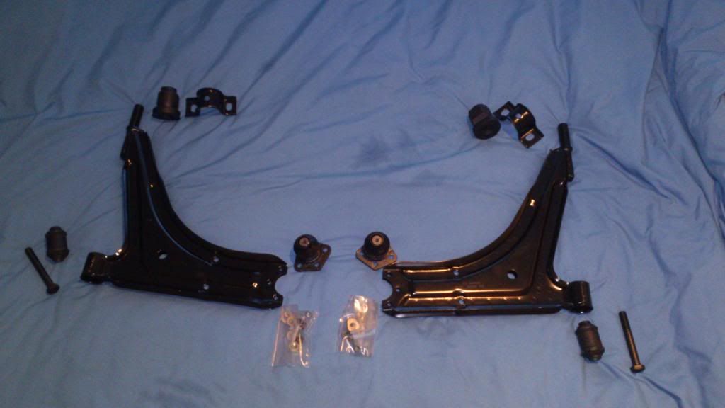

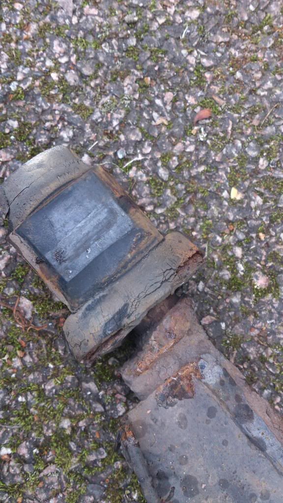

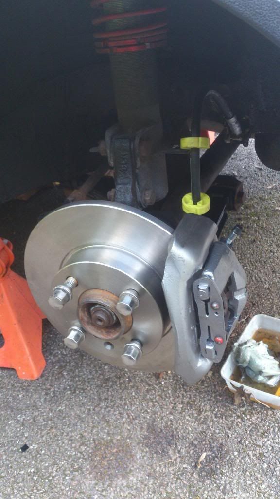

    I set about changing the lower arms, bushes and ball joints, and i think it was fair to say that the old ones were at the very end of their life!
    New ones fitted

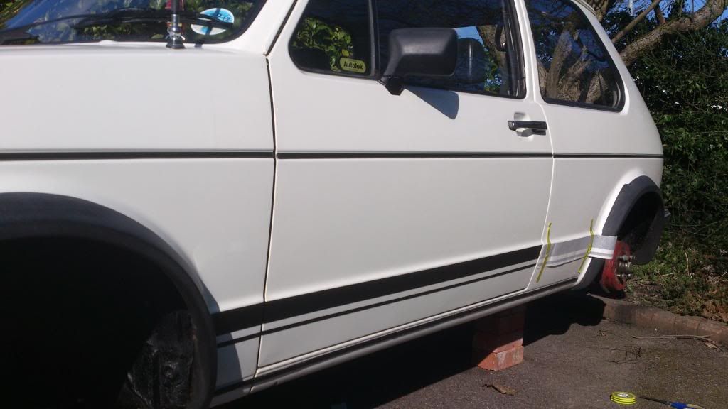

    I put some GTI side stripes on that i bought from http://volkswagenstickers.co.uk/ - they make all their stickers to the original specs, and to the best quality i have seen.

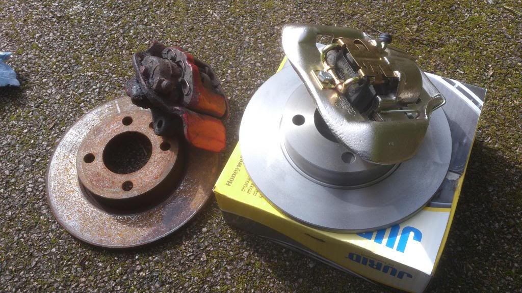

    I went to change the front brake callipers for recondition new ones - but i could not get the same callipers as my existing ones so i ordered the other type of calliper that was also originally fitted to the car. I was not very keen on them but they would do the job.
    I started to swap the calliper, disk, flexy hoses, and pads on the one side, and was unable to thread the flexy hose into the calliper... strange? After a bit of thinking i discovered that for some reason, the new callipers had been tapped with a left hand thread?
    I took them back to the car spares place i had them from, played my face as im sure most of you would have done, and decided to send my existing ones of to be reconditioned. That way i knew they would be the correct ones!
    Once i got them back, then fitted on like a dream!
    Old vs wrong calliper!
    My own reconditioned callipers all fitted with no problems.
    I did position the flexy hoses correctly afterwards with the protectors etc.

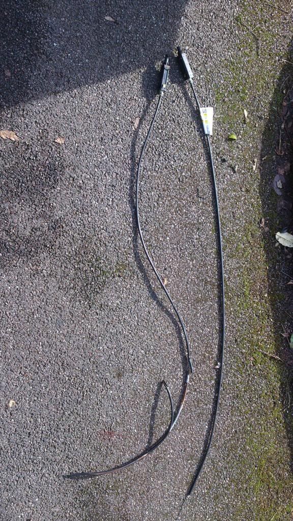

    New original VW choke cable - special order from germany! Almost £100 for a bloody cable!

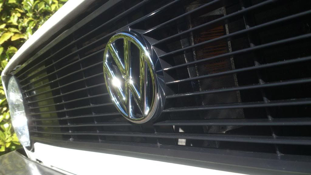

    The new badge fitted! Look at that shine!

    I took her off the road over the winter to start picking away at the list of things i wanted to do to her to make me a little more happy!

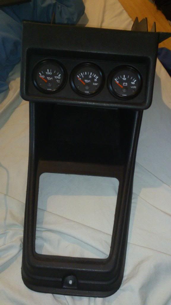

    I started to collect a few parts!
    Mint condition center console with mint condition vdo dials.
    New lower arms, bushes and ball joints

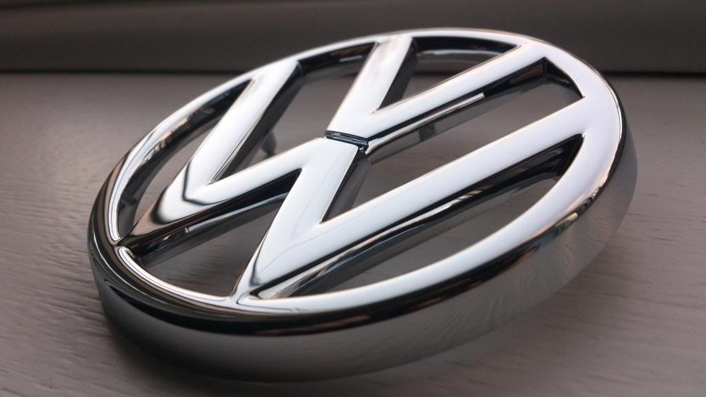

    A genuine VW badge, unused and was in the original bag!

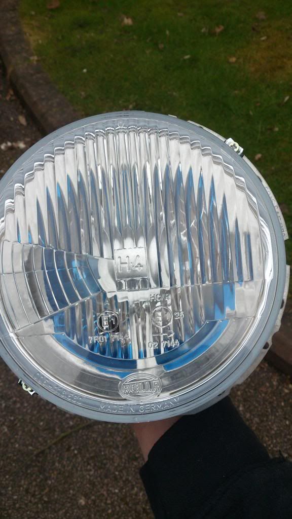

    Brand new Hella headlights
    And a few other bits and bobs to tidy her up!

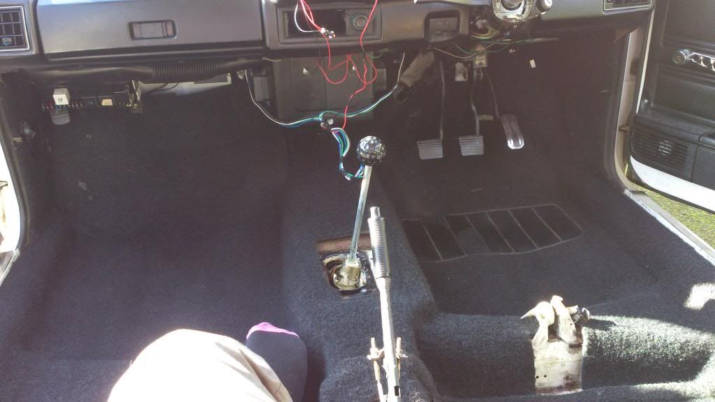

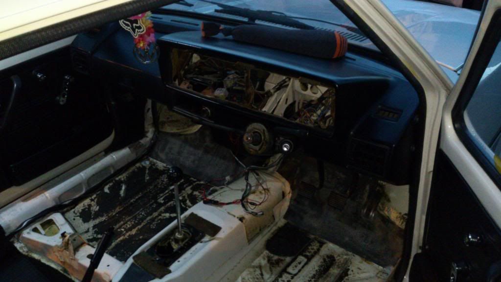

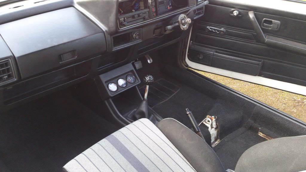

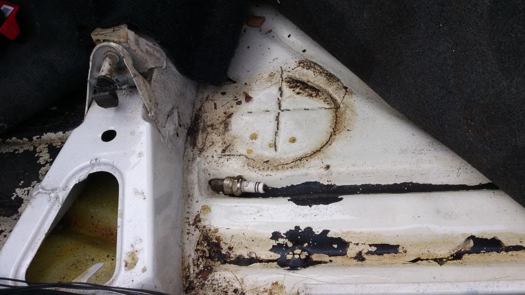

    I stripped the insides out! And while doing so, i found an old spark plug under the carpet? What on earth was that doing there? Atleast i had solved a rattle!
    Fitted new dash lights as all of mine had blown!
    Refitted the carpet as the mupet that had owned the car before me had never fitted the carpet correctly! I also sorted out some of the wiring at this stage and tidied it up!
    Not looking to shabby. Much better than it looked before!

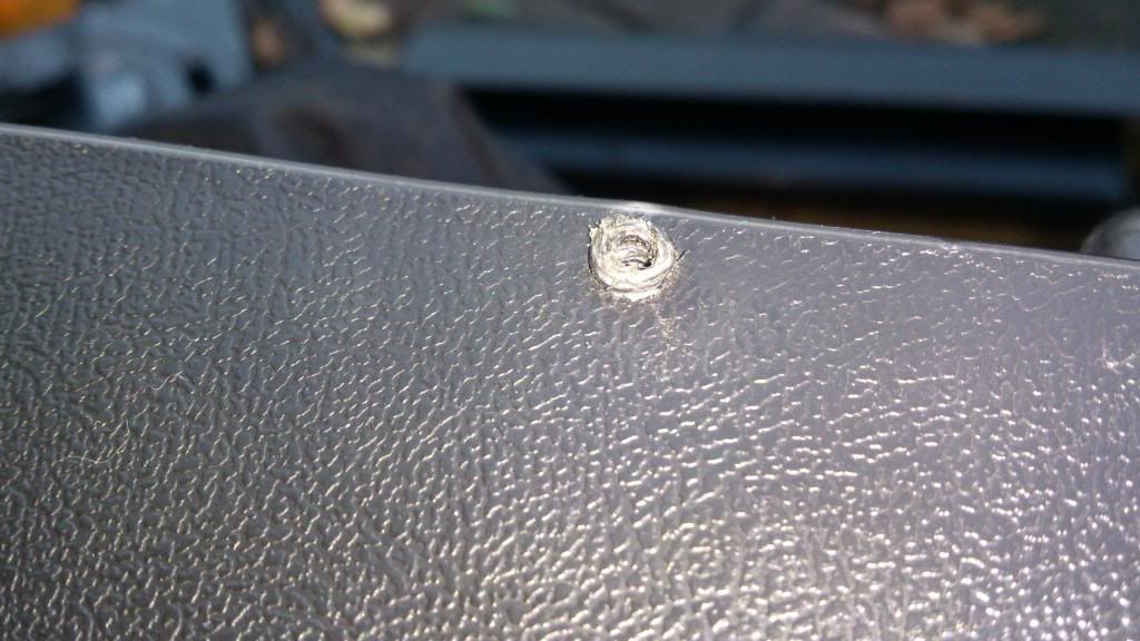

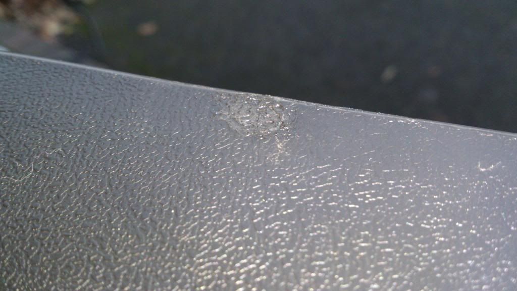

    On the lower dash/undertrays, i bought some decent second hand ones, but i was not told they had several holes in them, which would have drove me crazy knowing they were there!
    So i had a play with a soldering iron, melted the plastic back into the hole, and tried to recreate as much of the texture pattern as possible with the soldering iron. I didn't think the outcome was too bad!
    Before
    After
