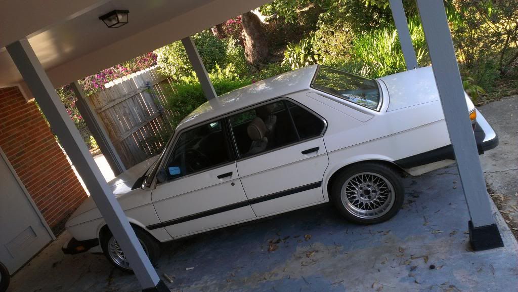

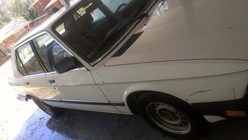

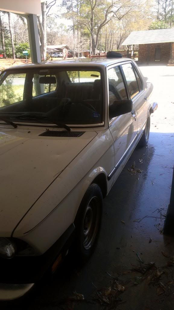

    OK, maybe its not fluffy but its was dirty when a rope was looped through the tow hoop and pulled to its salvation a mere several houses up.
    it is a 1 family owned, two owner car that has 87k miles and at time of last title transfer in 2001 had 56k. alpine white on cardinal red with 5 speed mated to a m30b34 and lsd diff. the car has never left columbus GA till now. this is my journey to get car back on road, to savannah and looking lookin like it should with up sized wheels, lipo to certain front and rear parts, and a general rebuild of everything. white fluff, as i deemed her had all her orginal keys and also all the original window stickers and invoice etc from when car was bought back in 86'
    look, you can see where its sat on google imagines.

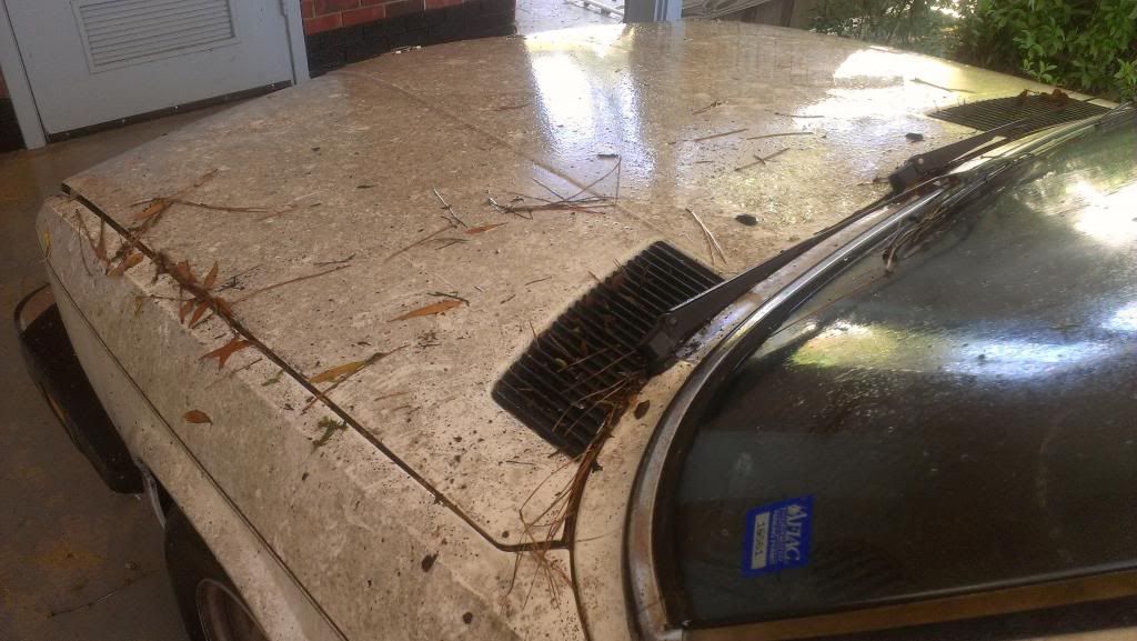

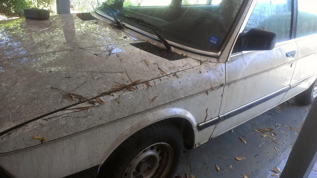

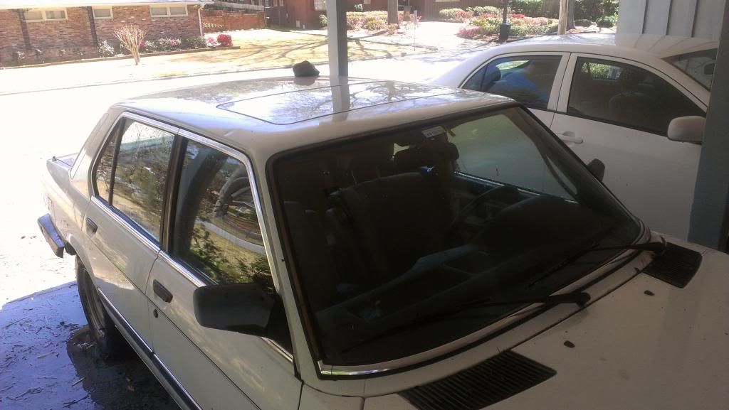

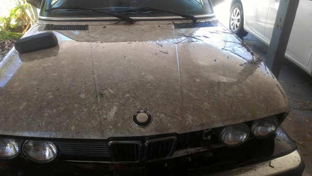

    i pulled it to my house because i did not want to start the car in its current sitting condition plus it was missing a battery. so a look over and refreshing was a must. but before i did even that, i need to see what the car even looked like under the earthly growth that had begun. its a real shame that a tree branch had fallen on the hood, cause the car is as straight as a arrow and no rust.
    when i was in savannah, and by neighbor called me about the car, i thought the car was bronzeit in memory and this is why

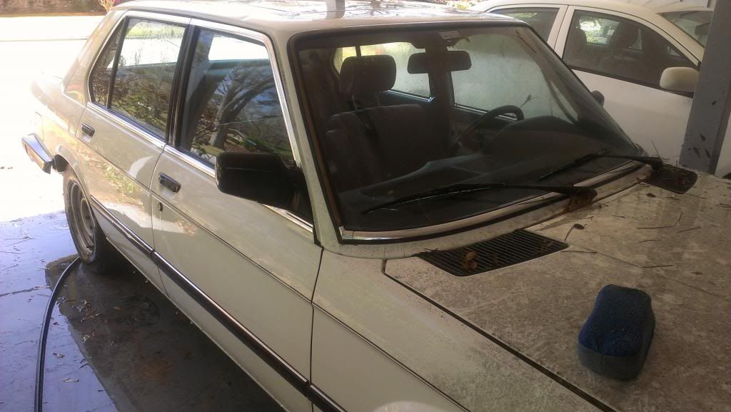

    and the scrubbing commences

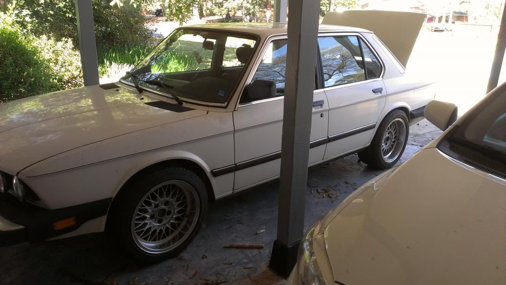

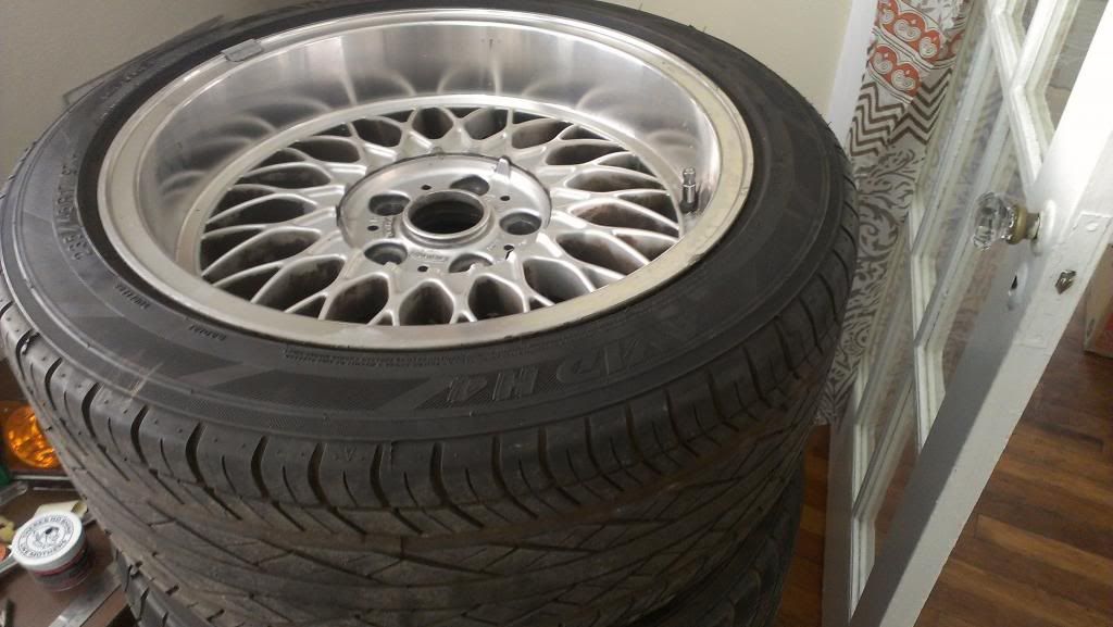

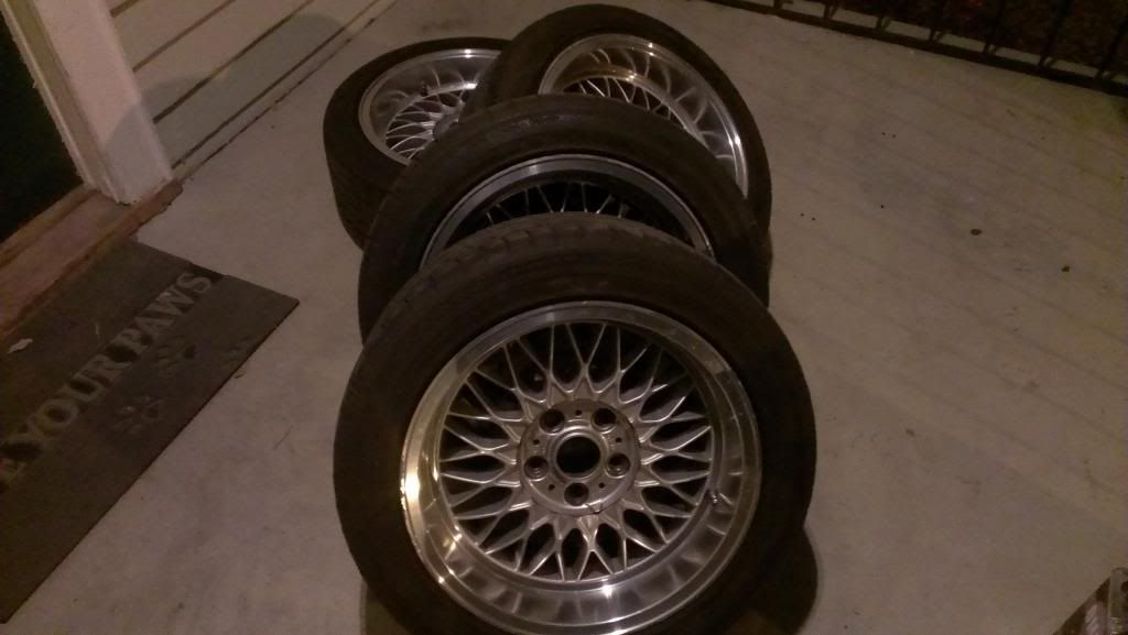

    so looking around for wheels i uncovered these in altanta. having my tires on my m3 beyond cambered out and maybe having 40 semi-safe miles, i enlisted my buddie who was coming to visit for weekend bring them. i still at this point hadn't even been home to pick up the car, and i knew that if i was gonna get it back to savannah, i at least need tires. so i arranged for my dad to meet me at the exit 27 when my friend went back home to Atalanta via interstate 16 with rims of course.
    FISTABULE FENDER GAP!

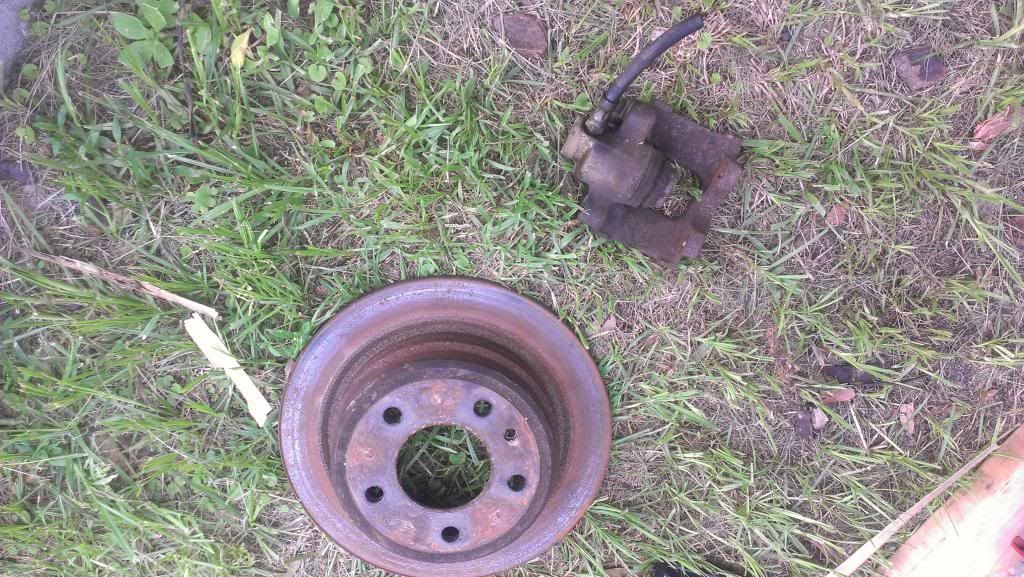

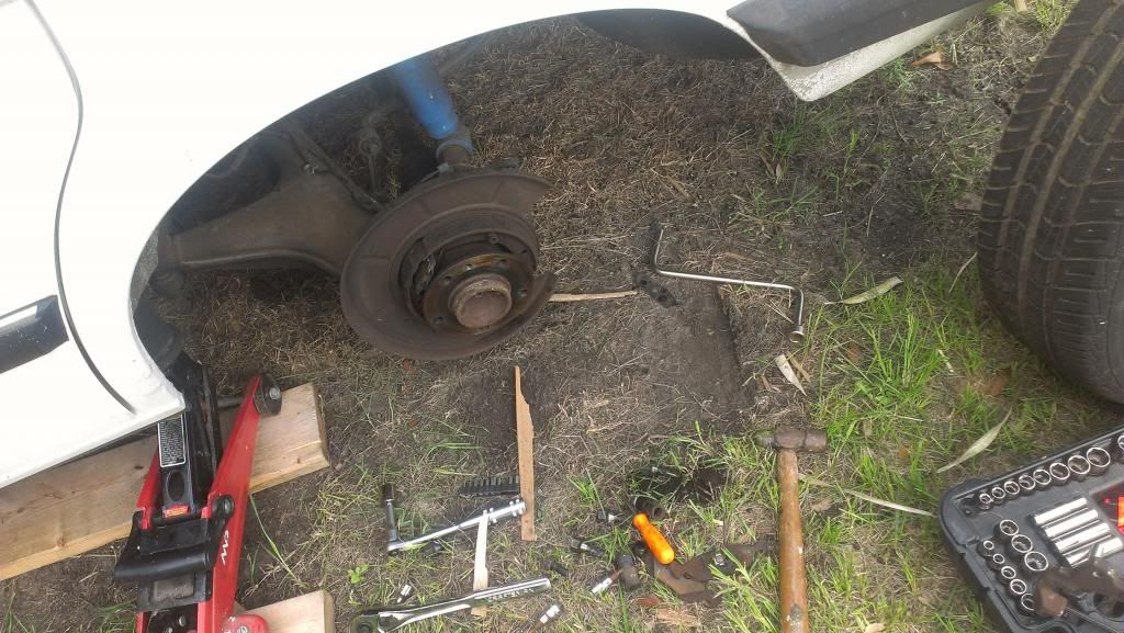

        removed the rear driver side brakes. the brake line were cracked so some ss lines will go in place
        having a problem with how the rear arm drops cause the blown suspension. need that suspension

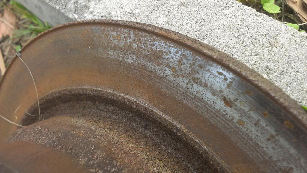

        i think the rotor is shot

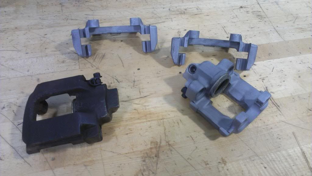

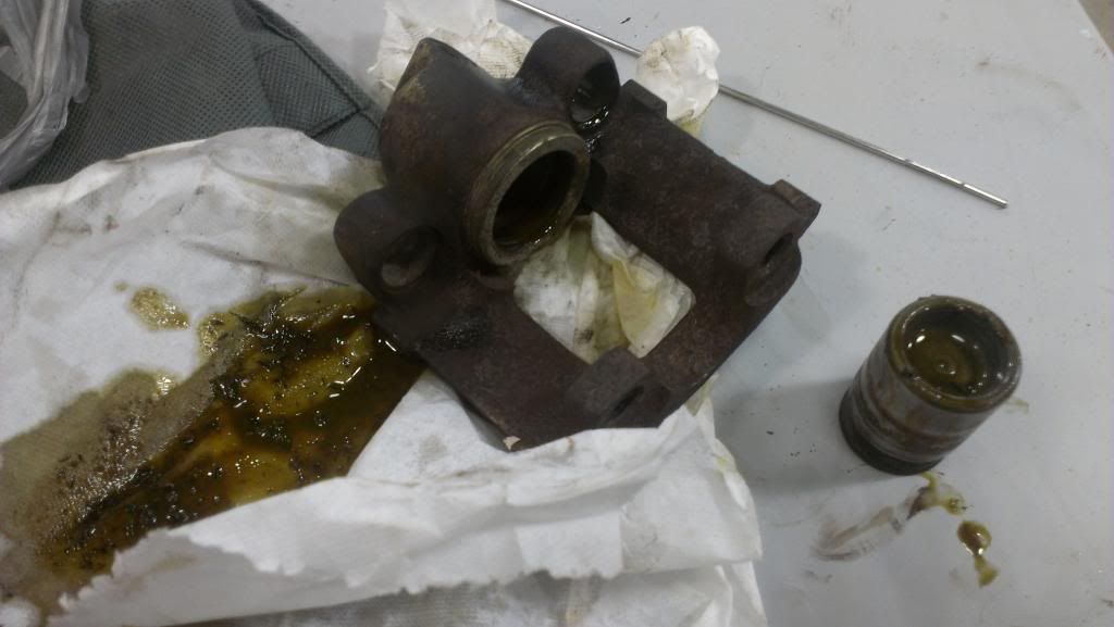

        and here is the problem caliper, look at that muck

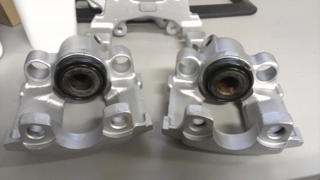

        after some taping off and media blasting i was left with this

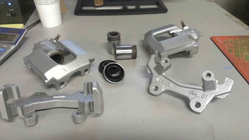

        more taping off, some caliper paint, polish of the pistons and rebuild new rebuild kit. things looking new

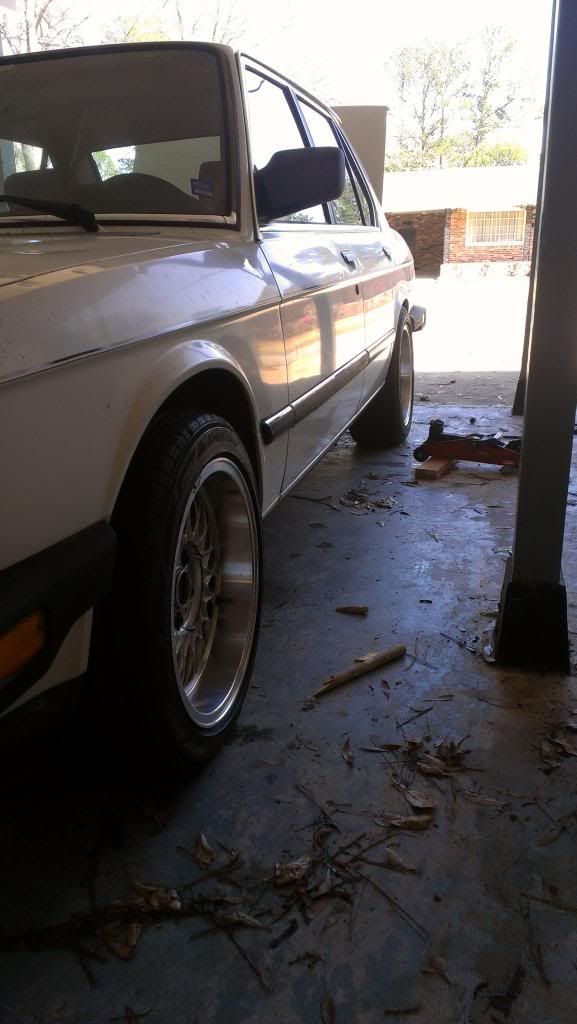

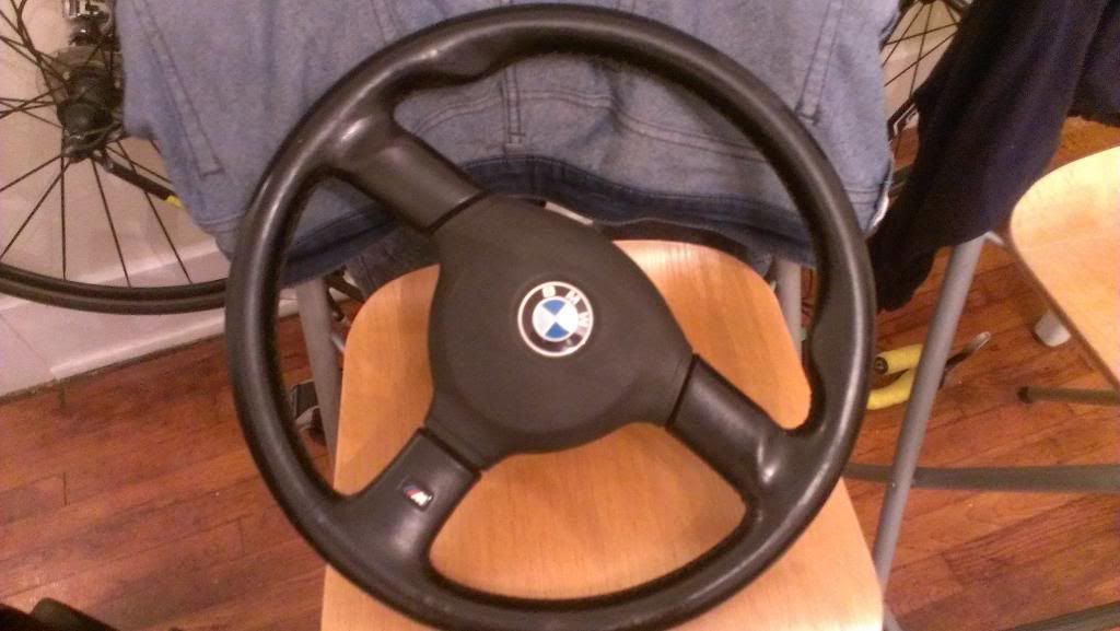

        so a new wheel came in for it
        and on the car it went. leather has a couple of marks, but overwise its in good shape

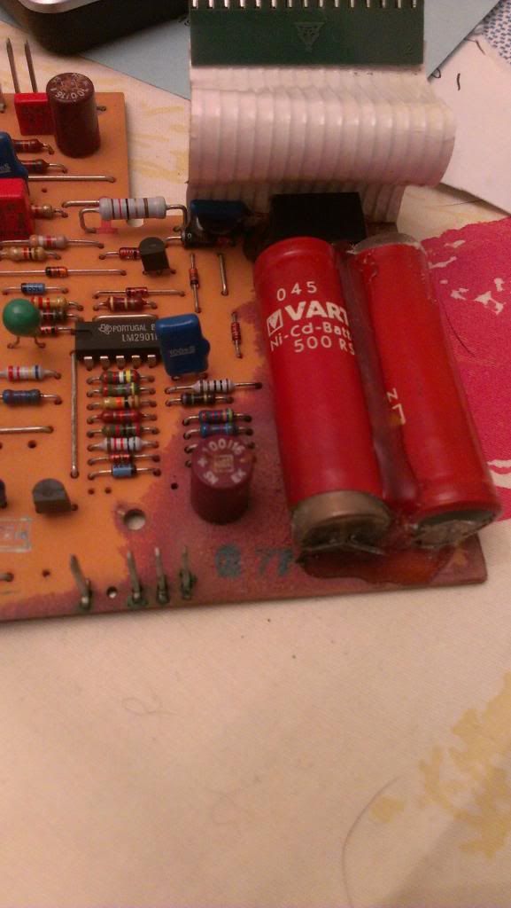

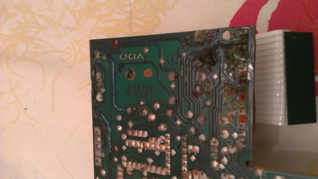

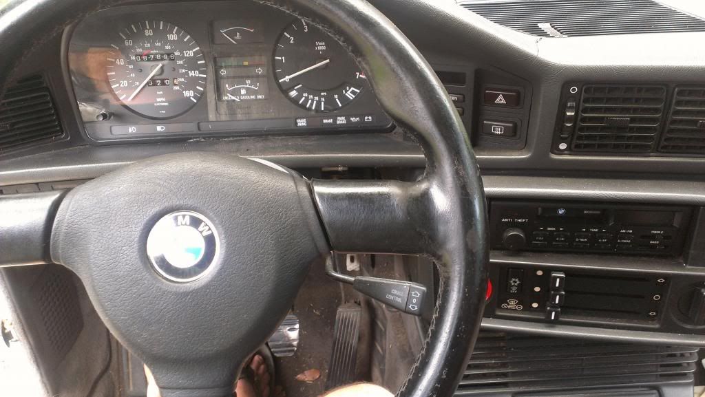

        so the cluster was acting up so i knew i needed most likly a new si board. when i pulled mine out i was shocked to find the damaged that the batteries had done over the years. a new baord was needed and not just batteries. so i bought for 185$, a new program-logic batter-less board

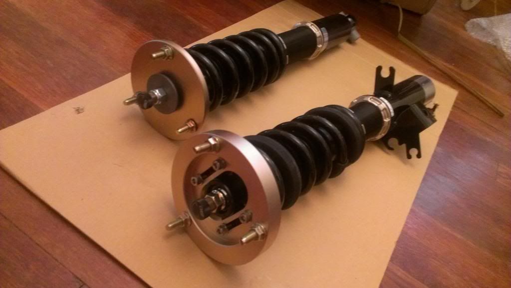

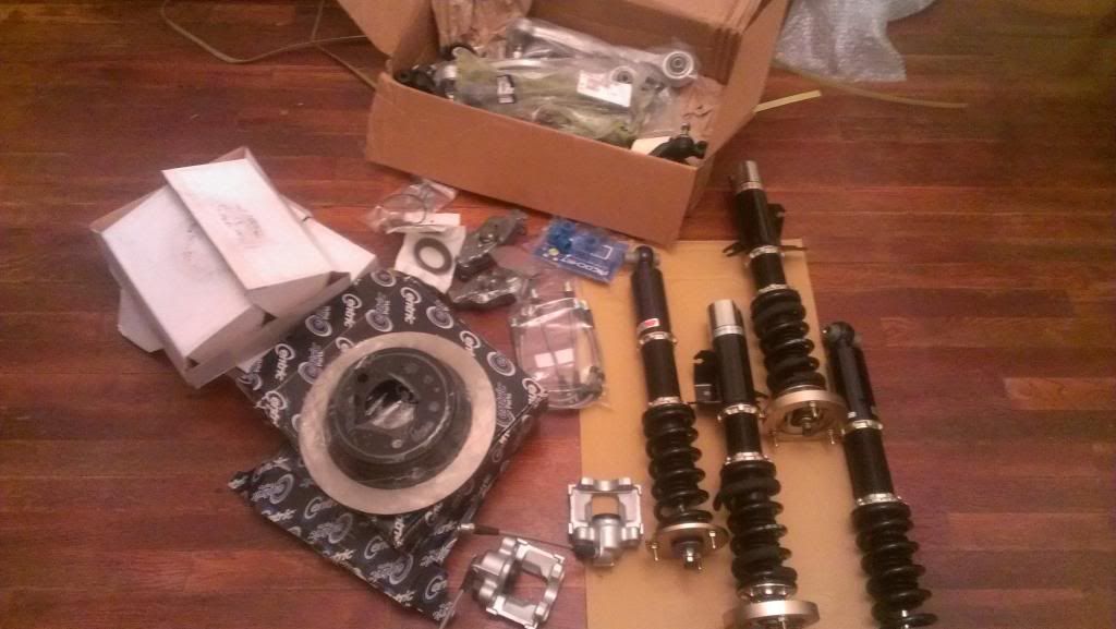

                coilovers come in tomorrow after 3 weeks of waiting for them! also have full new suspension bushings to install and all the new brake parts still. i forgot to buy the caliper guide bushings so now i gotta wait for that before the nice shinny calipers and rotors go on

                          Who did you buy the coilovers from?
                          I'm hanging to get stuck into my e28
                            there bc coilovers for the e28. if you want a set, pm me
