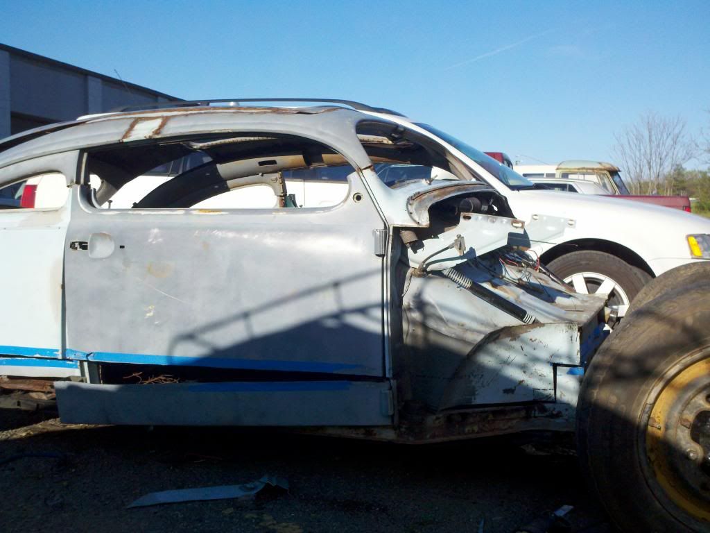

      This is how she sat for at least the last 2 years. Neglected and maybe about 1/3 finished.

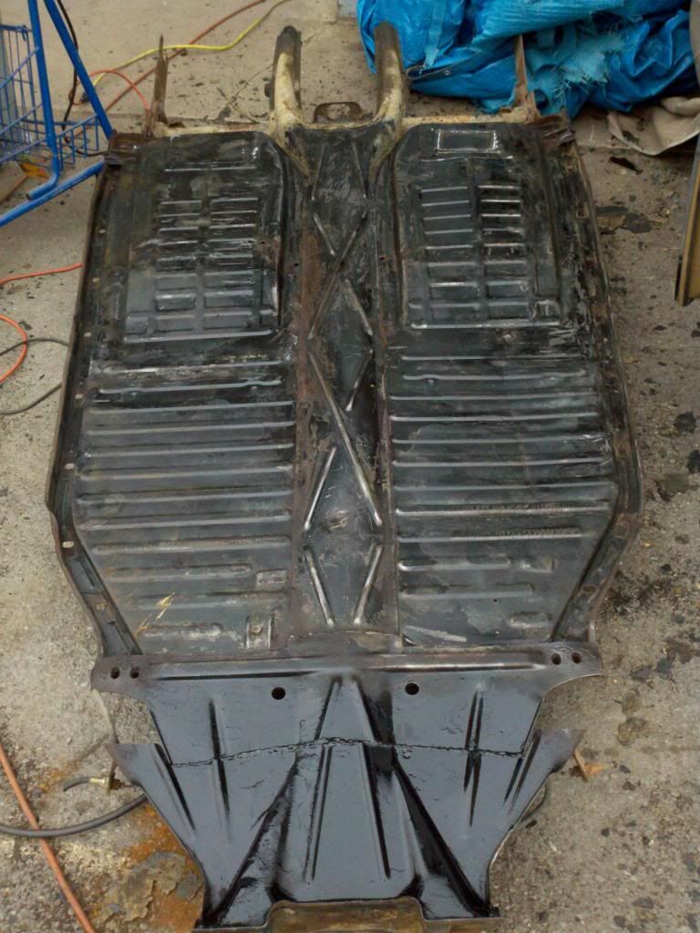

      I got a chassis from a customer car that had been abandoned for a good 3 years, and the customer had no interest in keeping it, so we filed on the title, and I got the chassis. The rag top section also came from the same car.

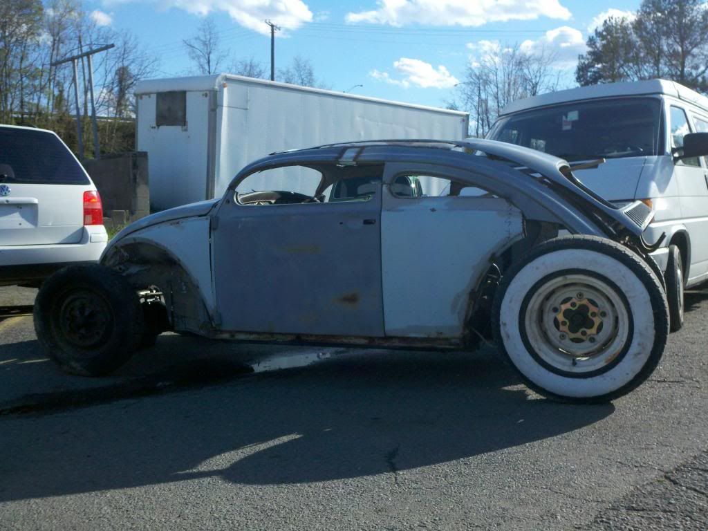

      I started the roof chop first, and got it tacked together and then took the body off and started on the chassis.

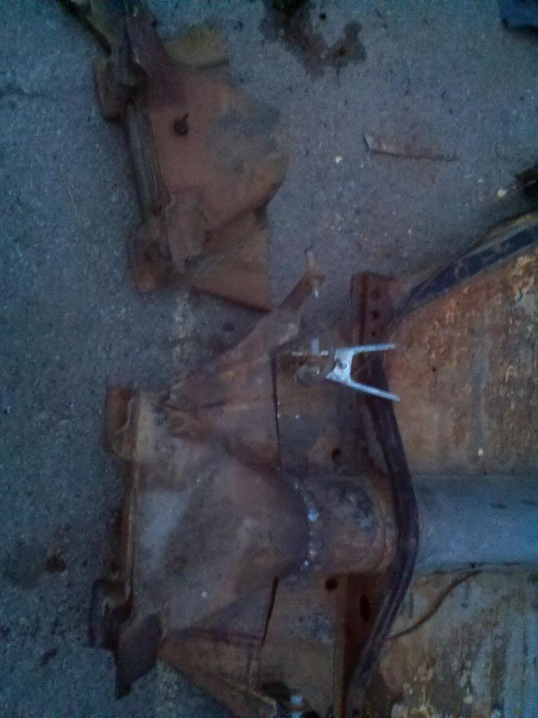

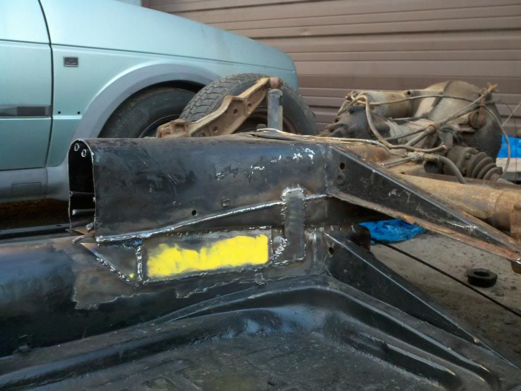

      I had to swap the bulkheads where the beam mounts up because I had bought a beam extension for a ball joint front end, and the chassis I ended up with was a king pin front end (the kingpin chassis was just in far better shape overall).
      This beam extension is one of the few pieces that I bought and didn't try and make myself. For $200 it was well worth the time and headache saved. Not to mention the guy that makes these has made a bunch of them and has pretty much worked out all of the kinks.

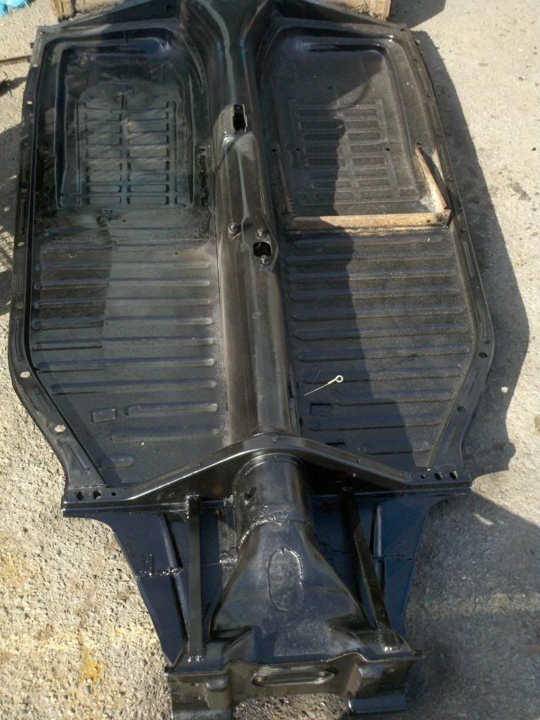

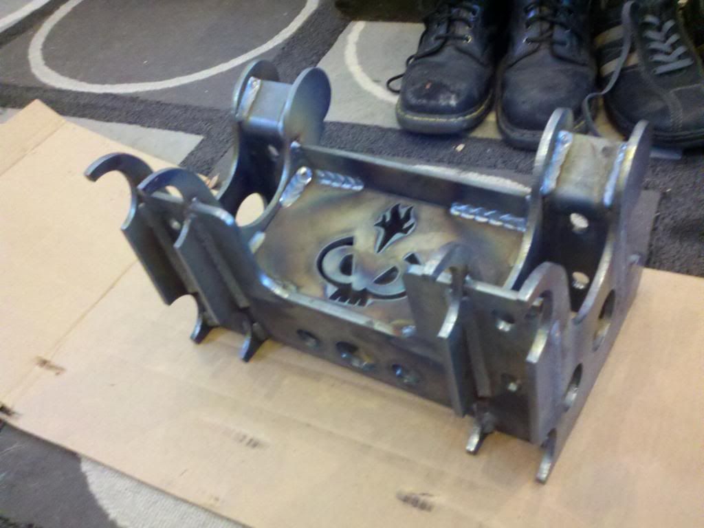

      After the bulkhead was swapped I cleaned up the chassis top and bottom and sprayed it with chassis paint. You can also see that I added some bracing to the bulkhead. Some guys build a whole cage for the thing, saying that the beam extension puts "SSSOOOOOOO MUCH extra stress on the front end due to leverage". Maybe. But I'm not racing the thing, or taking it off any jumps, and honestly, any extra leverage I feel is negated by the fact that the car now weighs half of what it did as a stock beetle.

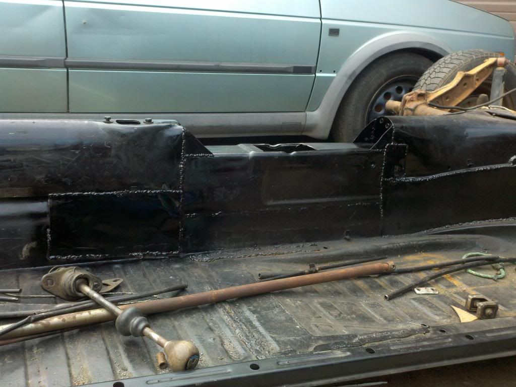

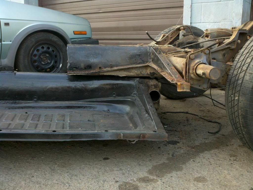

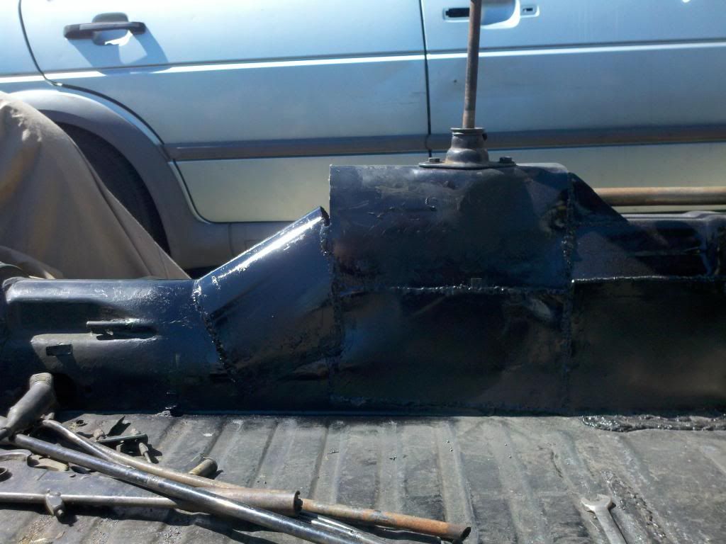

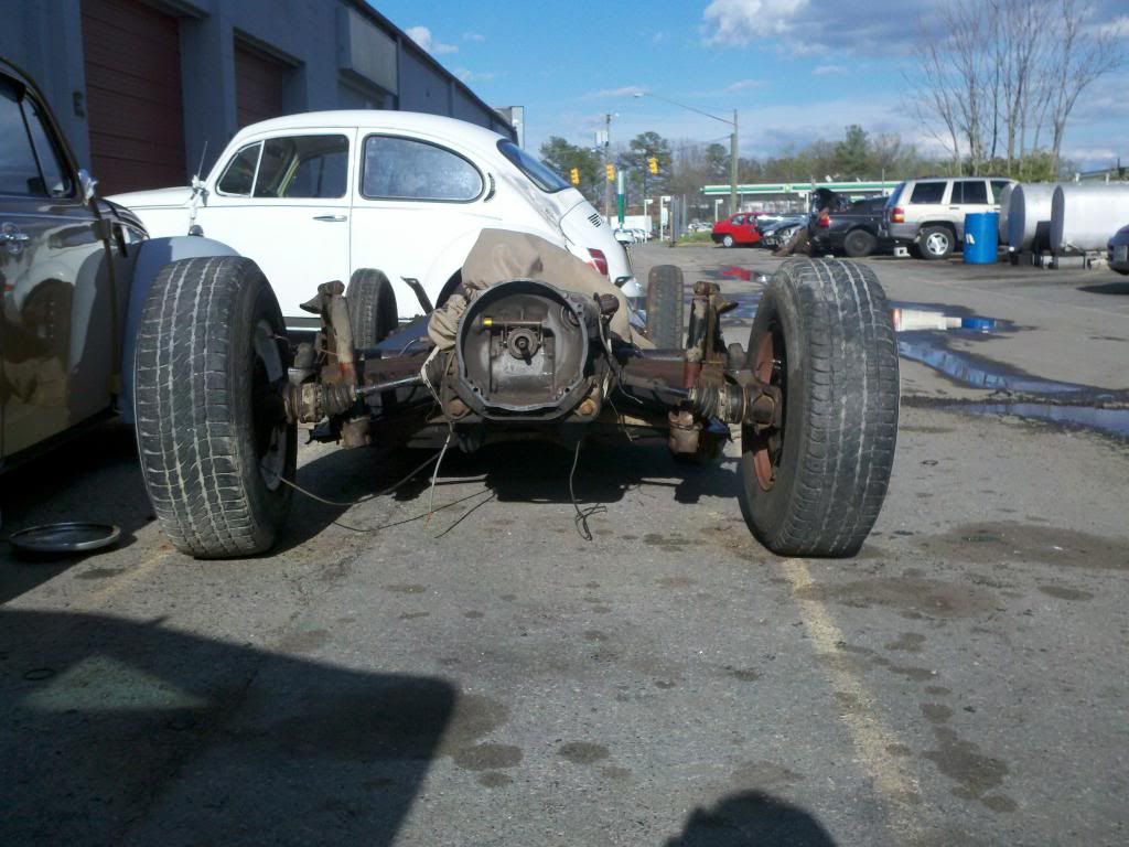

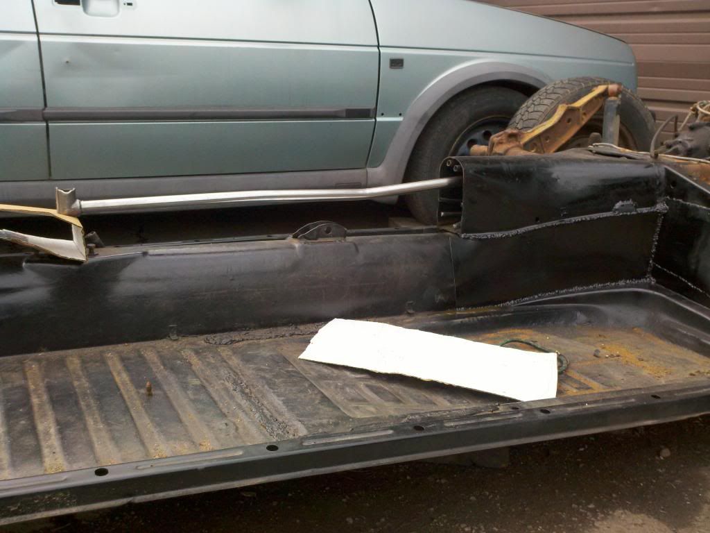

      In order to run the around 30" tires I wanted to on the rear, I needed to drastically change where the suspension sat. The easiest thing to do is to cut the rear of the chassis off and just move it up. I've seen it done a few ways, and for the raise I needed this seemed to be the easiest and most obvious solution:
      Just sit that f*cker right on top of the tunnel. Now, the only real way this is possible is to have two chassis to cut up. So, the rear on top of the tunnel is from the original 1970 chassis that I scrapped. After I measured every possible way I could imagine to try and make sure the rear was straight, I welded it on. And then I added some 1/8" plate steel and welded some more.

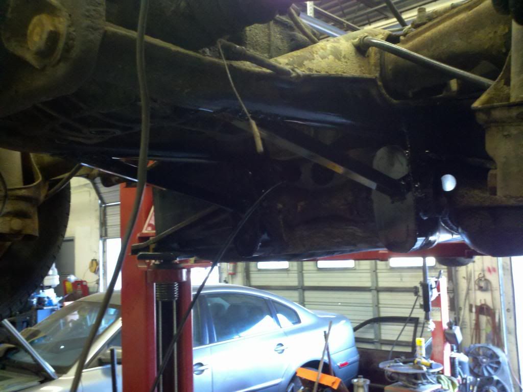

      I also put it up on the lift to see if it would fall apart. And then I added some more bracing. Just because.
      I then rolled it outside and put some 8" wide widened stock steelies with 235/75 15 tires on the back to see what it would look like.
      Not too bad. A little high, but the pan is a lot lower to the ground now, which is perfect!
      I started fishing off the tunnel raise. modifying the clutch and throttle tubes to run through the raised rear section and also adding height to the tunnel so the shift rod could lay level and everything would work as it should.

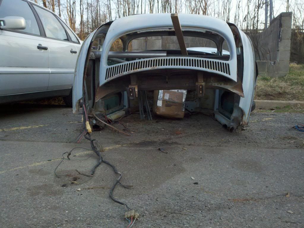

      Next it was time to plop the body back on and see what we had going on.
      It looked like ass.
      The body is too tall. WWAAYY too tall. It looks stupid. Never mind the chassis sitting way off the ground even though the body is dropped 5" front and 7" rear (factoring in the tire size in the rear, the rear is actually only lowered about 4.5").
      I got out the measuring tape and the sawzall. about an hour later:
      4" gone from the body. A lot better. Way less boat looking, and honestly, I would have gone 6", but at 4" my feet already barely fit in the front of the thing, and I'm not trying to have to lay down to drive the car. It is already going to be uncomfortable. I'm not trying to make it miserable.
      Oh, here she is from behind after the section:
