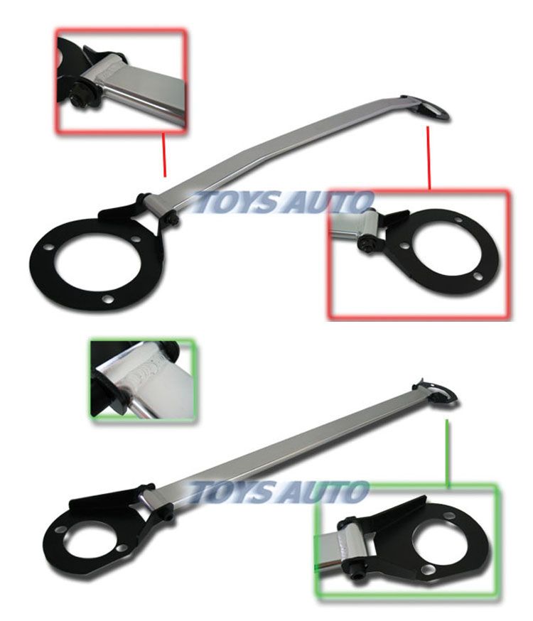

Also bought strut tower braces f&r. Super cheap but good enough. I think im gonna need to make a new billet front bar to clear the LS motor anyways so whocares.
