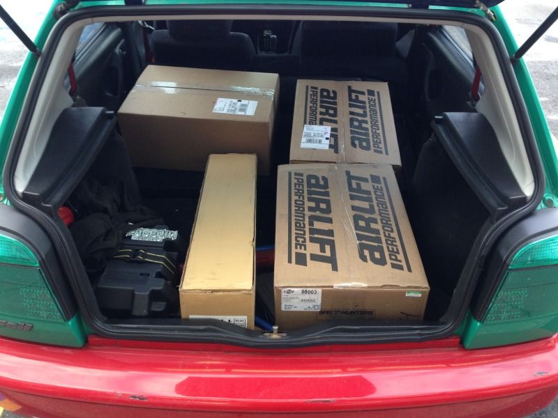

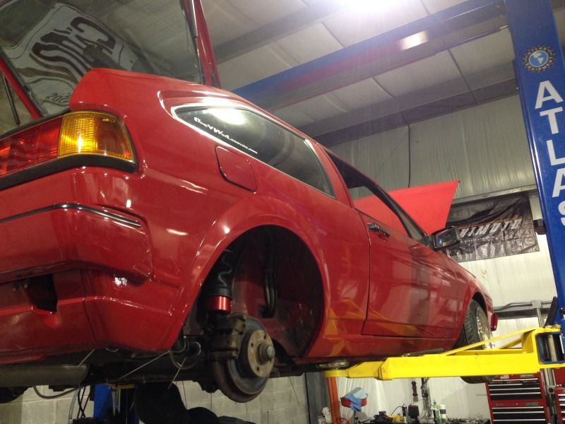

With the help of two awesome friends and their shop with a lift, we got the air installed in about 5 hours. They had done installs before so that helped with where to run the lines, where to splice into the power, etc.
Everything went together like it should. I love this kit already.

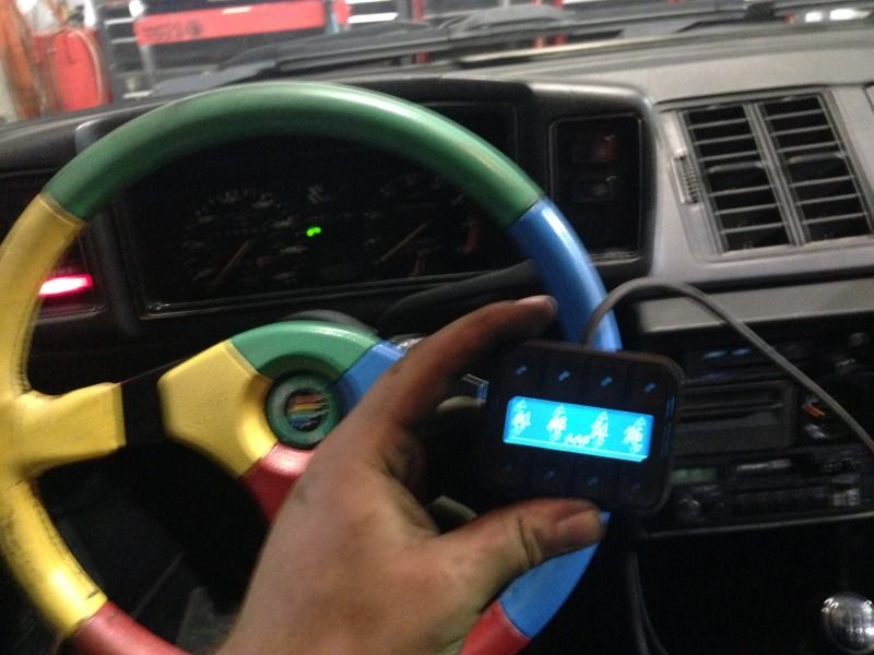

Yes blurry whatever. Apparently I can change the backlit color

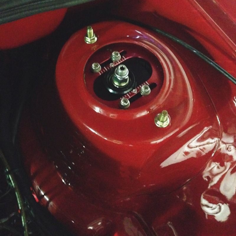

These Performance series top hats look SO GOOD in my bay.

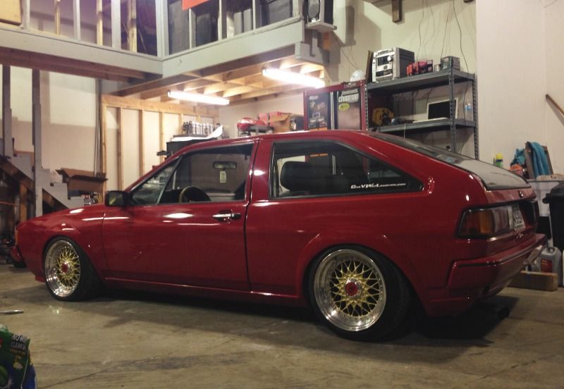

So there's no actual trunk setup yet. I'm tacking that when I make a whole false floor/rear seat delete soon. But it works like it should and makes psh psh noises.

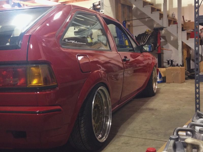

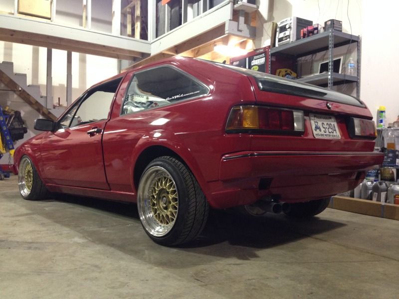

It's not as low as it should be. I knew from the beginning that I would need another frame notch on the driver side. The fronts are currently held up by the tires hitting the fenders and lack of camber. I adjusted the top hats all the way in but it's still not enough. For some reason the front struts don't have much negative adjustability at the bottom. The OE eccentric bolts (which usually control front camber) don't seem to work with these struts.
The rears aren't quite sitting on tire yet. The shock height is adjustable on these and default is rather high. I spun them up in the rear as much as I could but the air fitting into the strut gets in the way of spinning up the housing any more. If I get a couple 90 degree fittings that will give me the clearance I need to further shorten the entire strut.

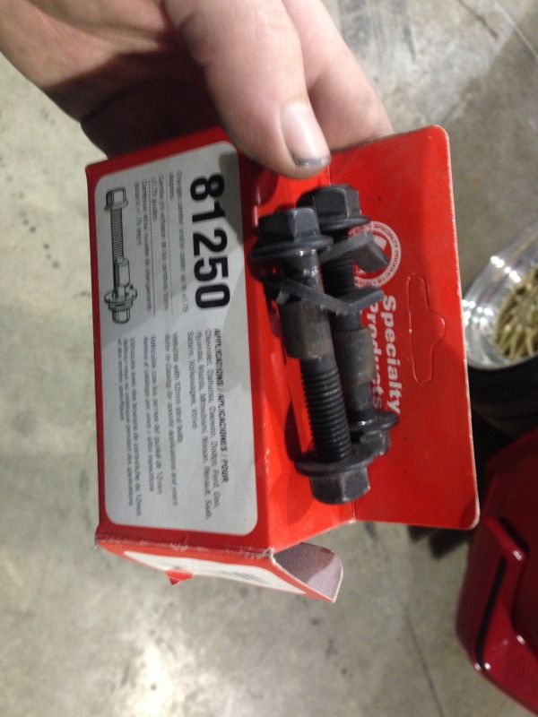

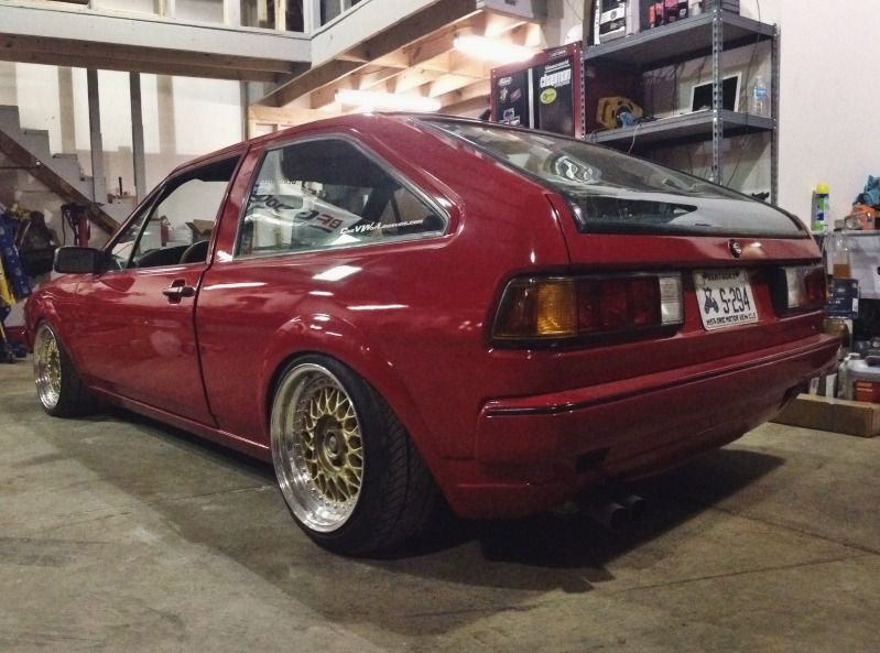

I went back yesterday to dial it in more and install camber bolts in the front struts.

I had to go back to school and leave the car in the capable hands of my friend Will. He owns a shop local to me and he's going to check out the clutch slip situation. I'm pretty sure it's a leaky rear main. He's also going to do my driver side frame notch until I come home next month for my spring break. Until then I've got another set of wheels to build for my Golf!

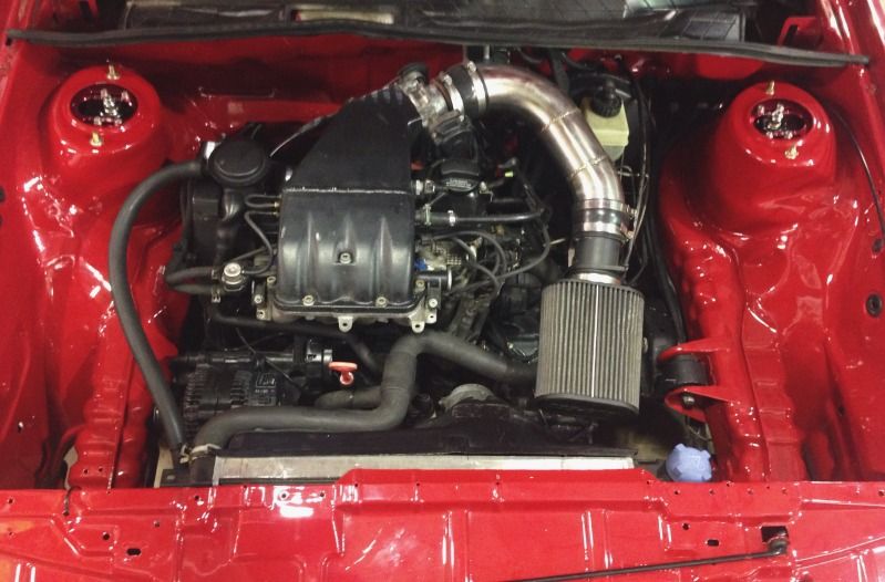

Man, you weren't lying when you said that engine didn't look good. Personally i think gold similar to the wheels would look great and create a nice theme for the car.[CENTER][url=http://www.stanceworks.com/forums/showthread.php?t=66924][color=red]e28 build thread[/color] [/url]
