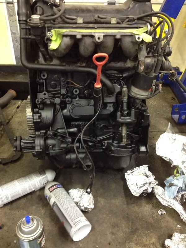

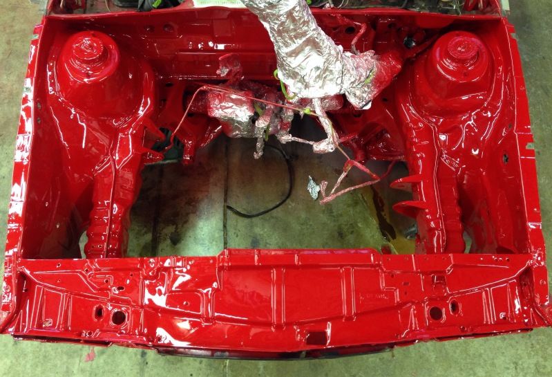

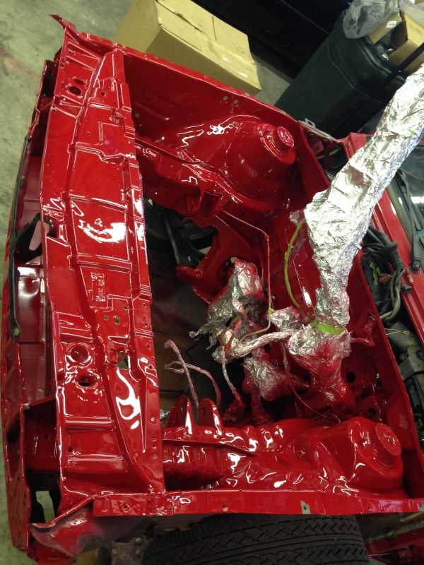

This past weekend I went home with the intent of completely finishing the bay. The weather was going to be good enough for paint to work so I went for it.

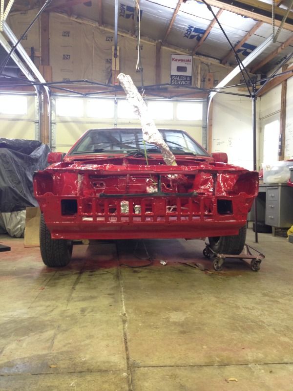

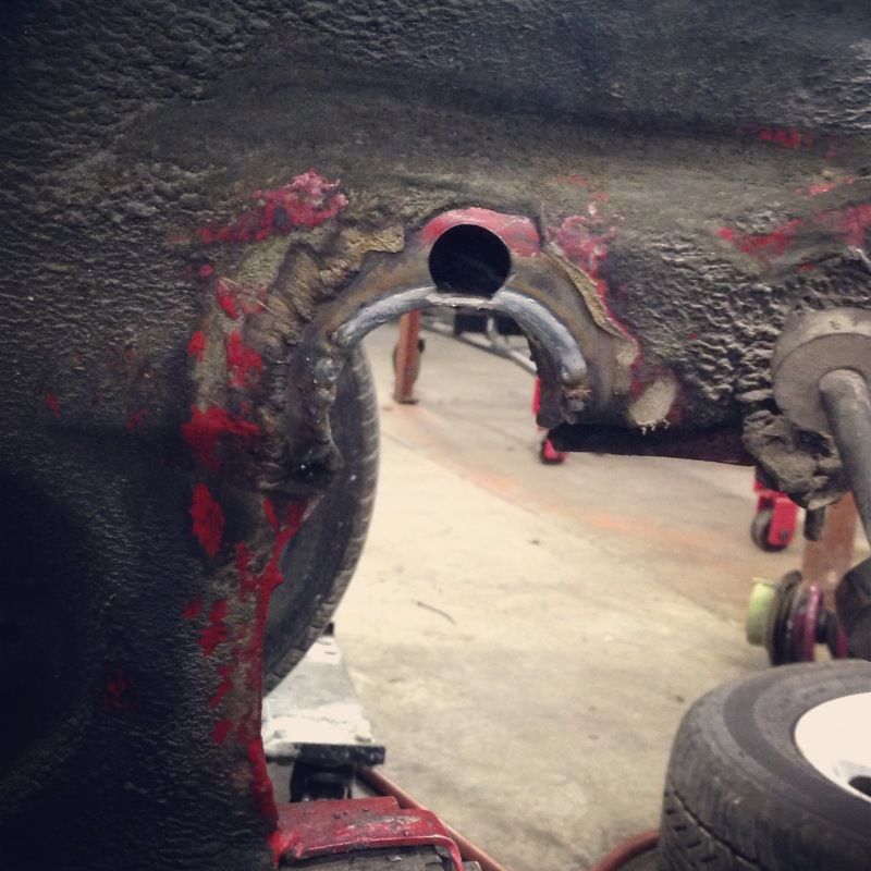

I got back Thursday evening. Showed up to my friend Chris finishing up the passenger side axle frame notch.

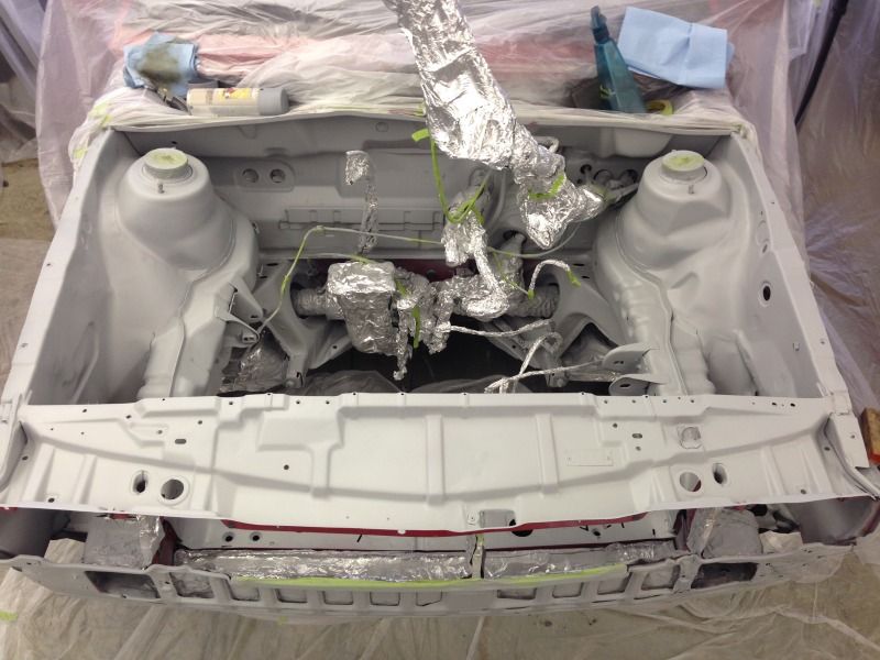

After that it was undercoated and I got to work on prepping the bay for high build primer.

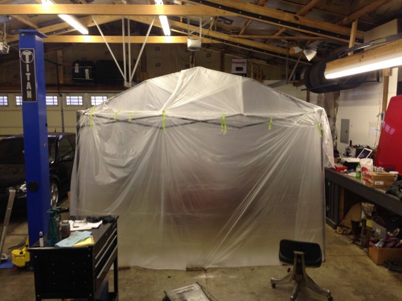

Masked off everything and wrapped larger things in foil. Scuffed everything and wiped it down with mineral spirits.

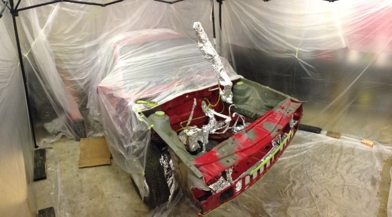

Build this awesome booth out of my mom's Easy-Up frame and lots of plastic sheeting. This thing worked great and kept dust out and fumes in (this was done in a small shop with people trying to work on stuff at the same time).

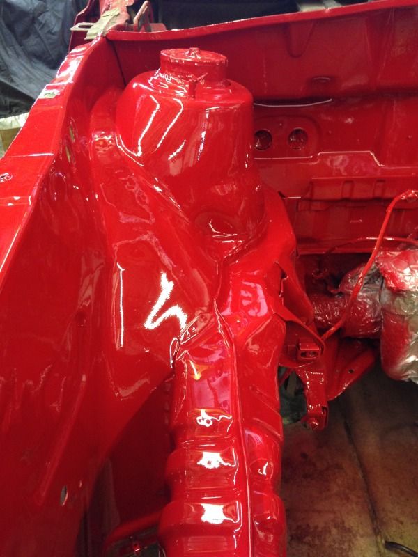

2 coats of high build. Just used basic stuff out of a spray can. Came out pretty well.
Then I painted it. I've never done painting on this scale before. Learned a wealth about painting and took my time with it as best I could. After all I was trying to do everything in 3 days.
Went ahead and did the front end as well. The body shop that painted my car painted the lower valence section but nothing above that so I took care of it. Matches great too.
Used 3 coats of Tornado Red base and 4 coats of clear. Here's how it came out the day after I finished and tore down the booth.

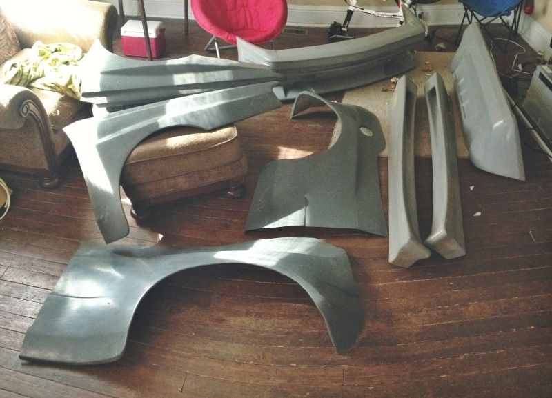

reallllll big package comes tomorrow. 120 pounds of 80's goodness

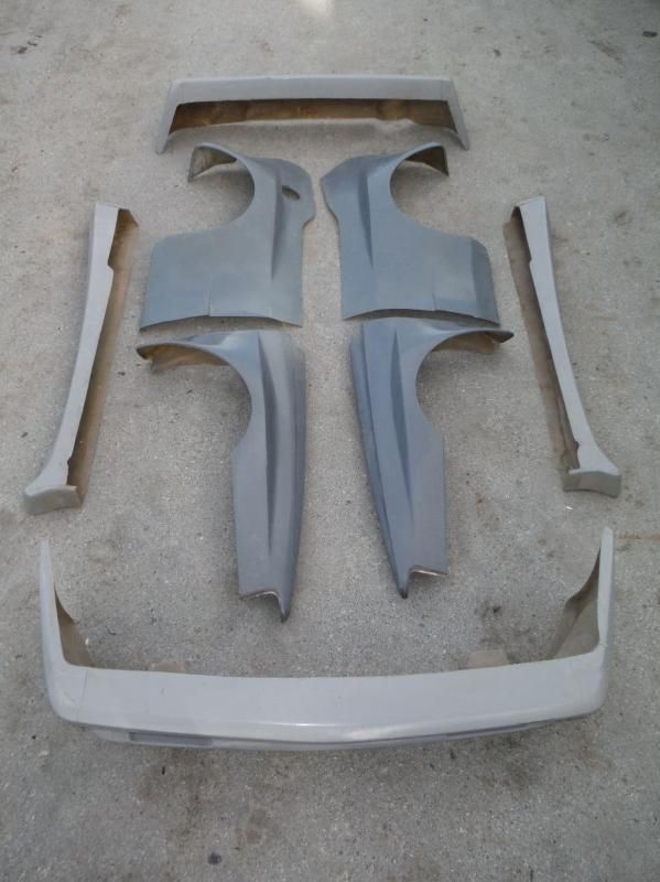

So a couple weeks ago I pulled the trigger on this...

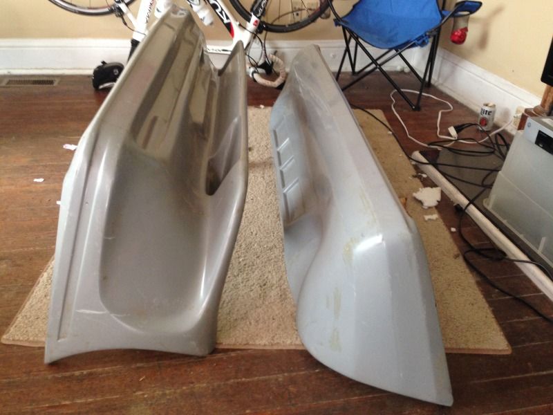

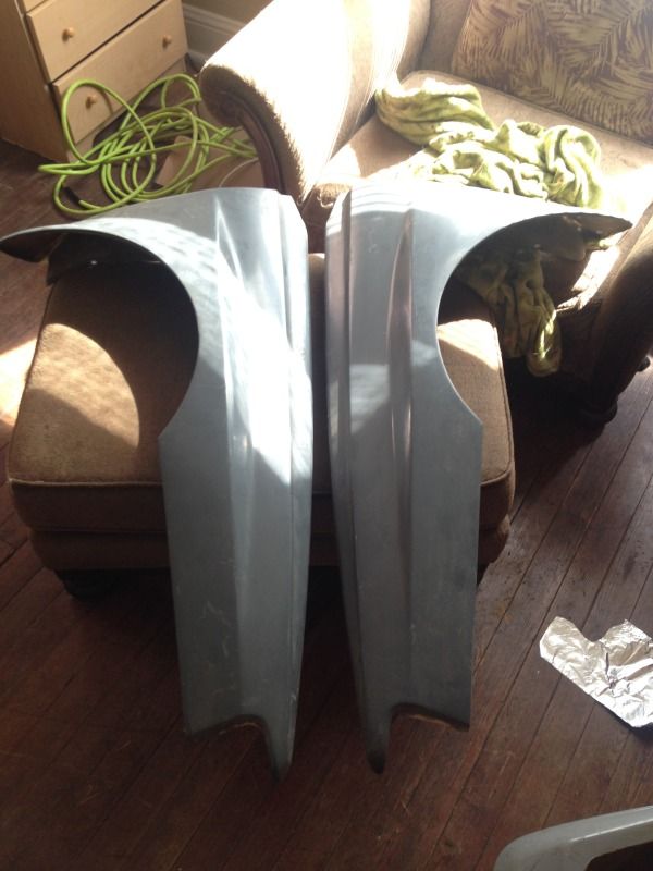

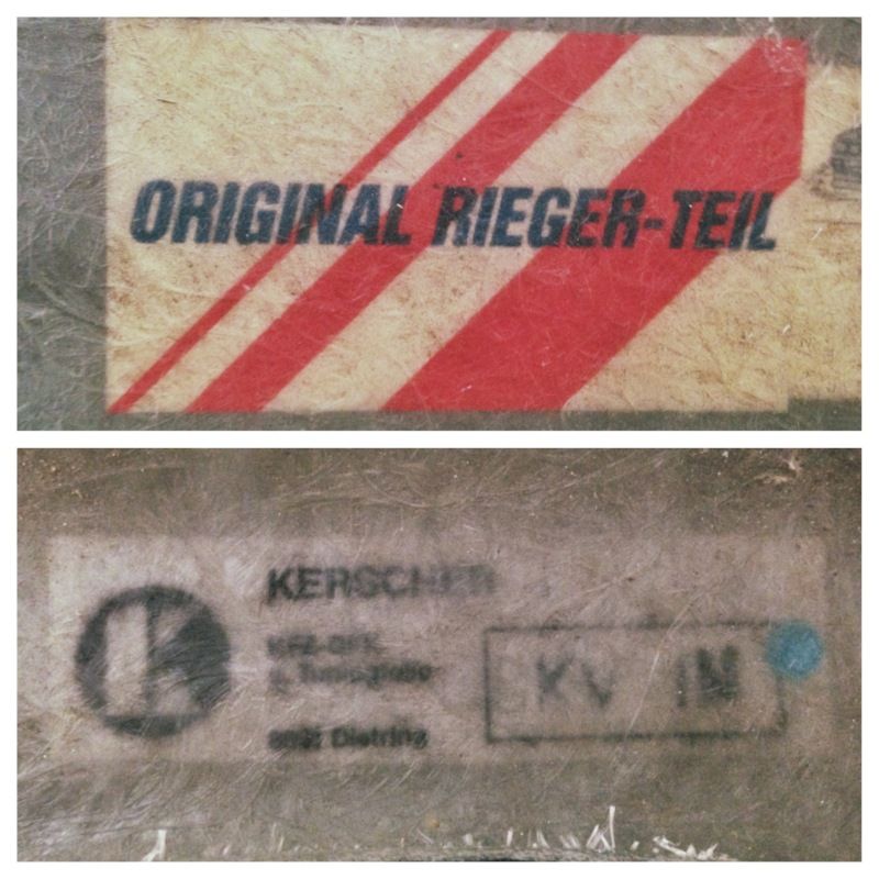

It showed up on Tuesday from California. NOS full widebody. Both bumpers/side skirts are made by Rieger and the front fenders/rear quarters are made by Kerscher.
Couldn't get the box through my front door.
So much box flared 80's sex. This kind of stuff is completely unobtainable nowadays, especially in the US, so I had to jump on the opportunity. I doubt I'll be putting this on the red car since it just got painted and it wouldn't look right with the look I went for with it. We'll see what happens though.
