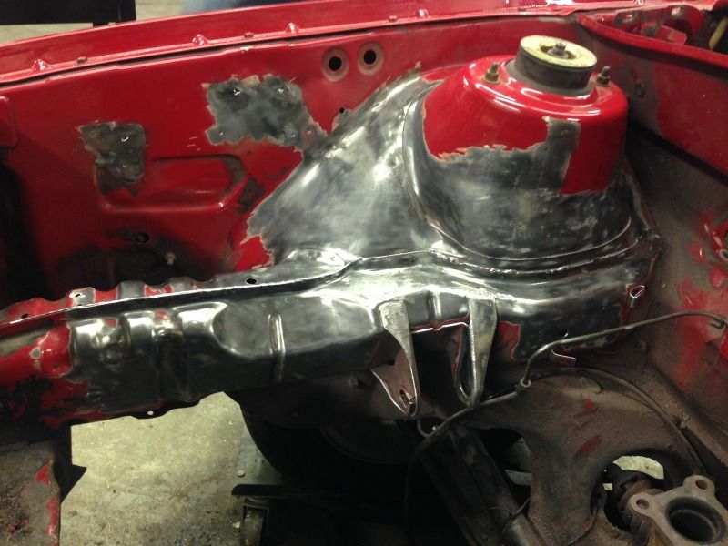

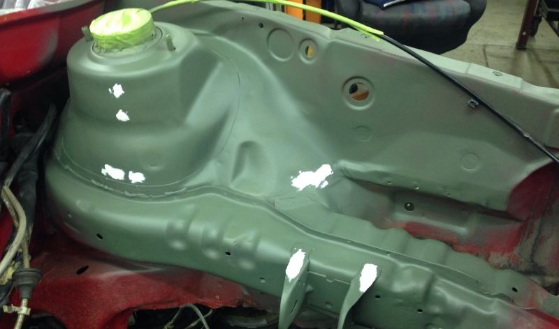

    Brake booster/master cylinder came out and more seam sealer came out. Passenger side about ready for paint. I picked up a quart of base T-red, reducer, and clear. Spraying it myself along with the top of the core support.

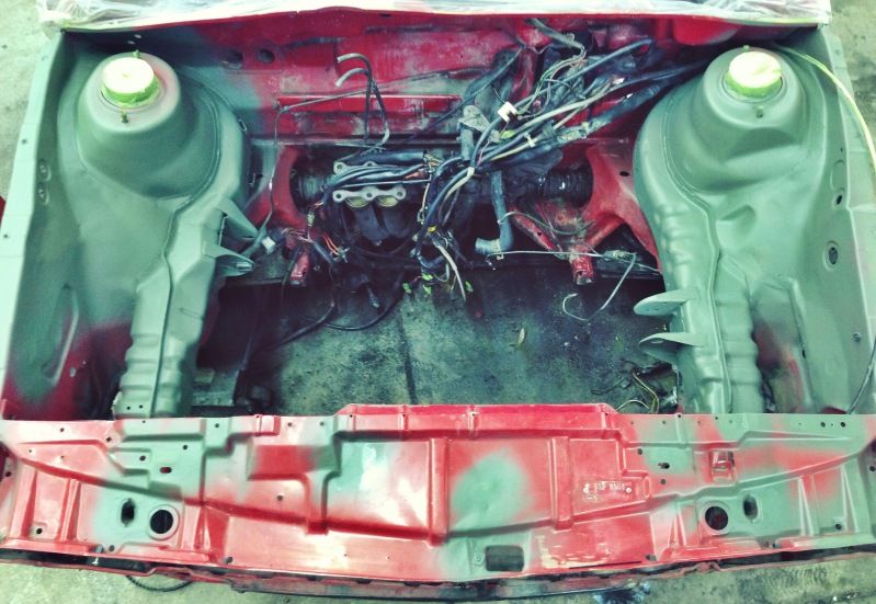

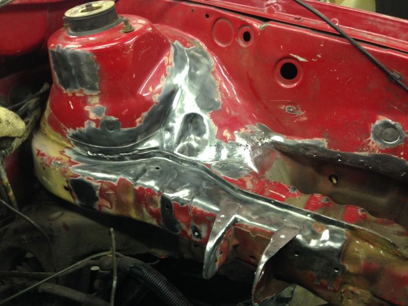

      • All the seam sealer on the rails and towers is gone! Took forever to get behind the towers but well worth it in my opinion. I'm leaving the seam sealer on the frame horns and areas under the frame rails.
        There are a few spots I'm welding up, but they're very miniscule. As for larger holes I would like to use some OEM looking rubber plugs, I really like that look for some reason.
        Then clean everything very thoroughly, make new fuel lines, and loop the PS. Then I think I should be ready for paint. I plan on using no filler, I like the indents from the spot welds and that overall raw look on Mk1 bays A LOT.

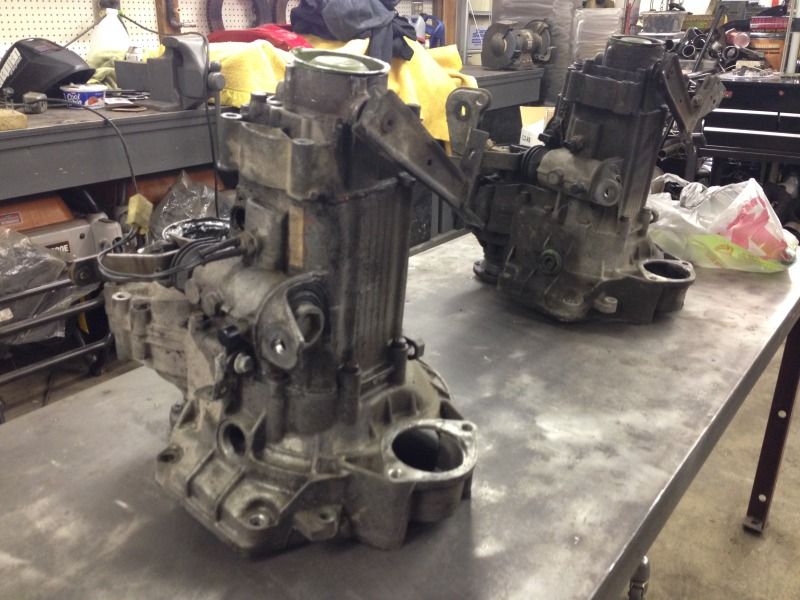

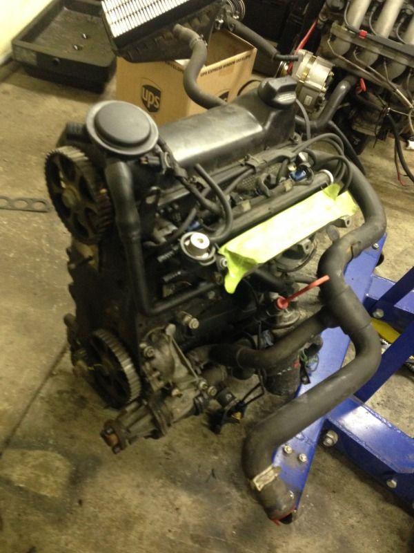

              ABA is stripped down for the most part. Doing timing service.
              Also got the trans off both engines and preparing for the 5th gear swap into the 16V trans.

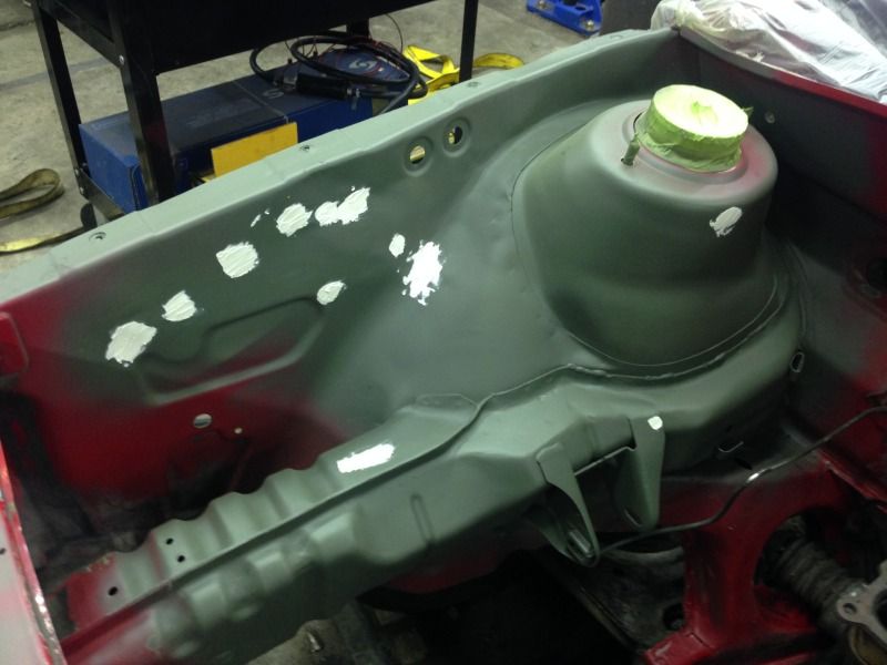

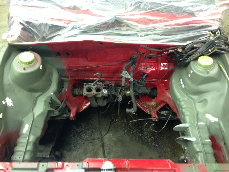

              Most stuff cleaned and smoothed. I'm trying to get it as smooth as possible without any filler. I got it pretty nice and hit it with self etching primer on all the bare spots, as well as areas on the core support.
              Of course it's not perfect so a few spots of glaze should do the trick.
              The brake booster is also in primer now and looks awesome.

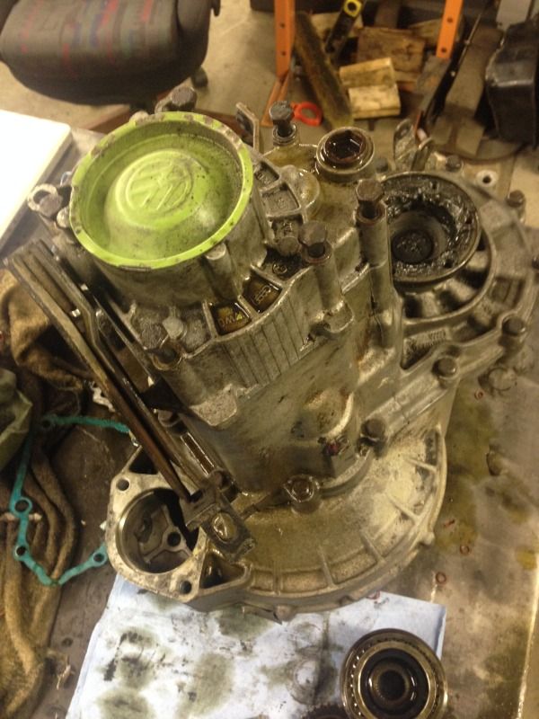

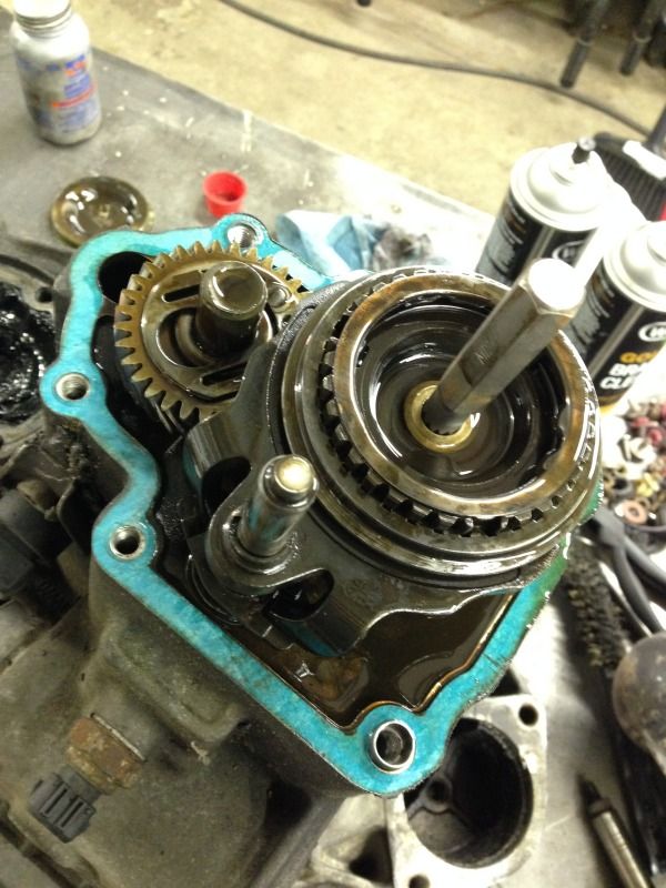

                Today though was a bit better (10 degrees wooo!) so I stopped by. Wasn't sure what I was going to do but decided to tackle the 5th gear swap. It went pretty smoothly for having never done it before. The brokevw.com DIY was great. I got the 16V trans with the mk3 8v 5th gear installed and 99% back together. All that I need is a new 5th gear end cap gasket and it's 100% done. I'm hoping I did everything right! Pretty sure I did, all the gears seem to engage when I use the linkage by hand.
                Digging into the Mk3 trans.
                Didn't take any pics during the whole thing because I was pretty much covered in trans fluid. Here is the Mk3 8V 5th gear setup on the 16V trans.
                Cap installed (bolts not tight yet though, still gotta get that gasket)
                That''s all for today but it was a big undertaking for me and a learning experience. Would definitely feel comfortable doing that again

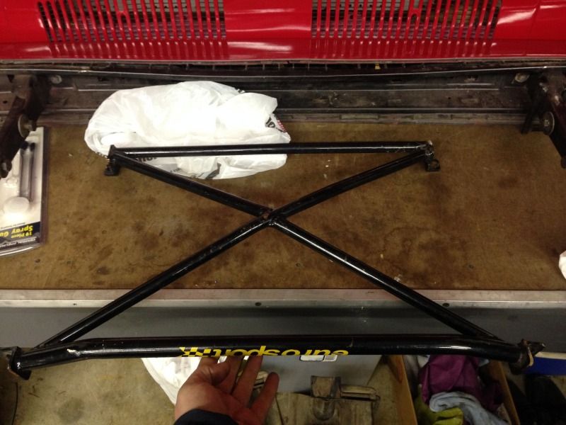

                In other news I've realized I can't use the Eurosport 4 point subframe brace because it hangs down too low and I plan on being pretty low on coilovers. I'll have to come up with another solution that doesn't hang down too much. Maybe a slightly modified stock kbar... Not sure yet.
