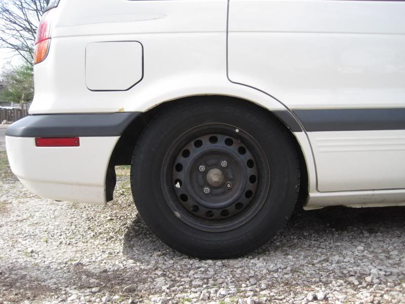

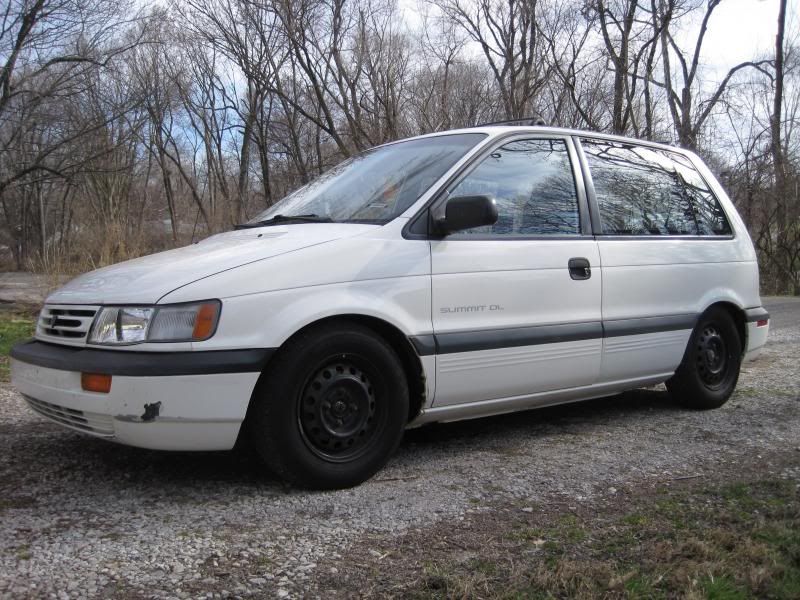

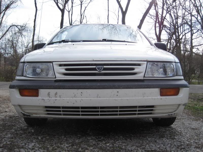

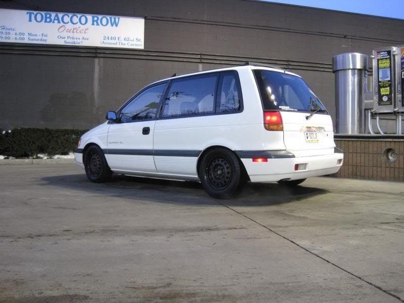

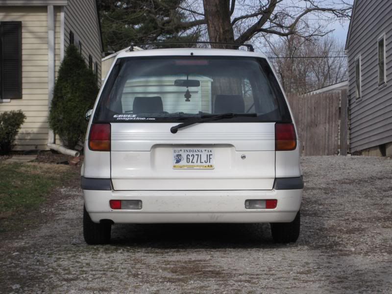

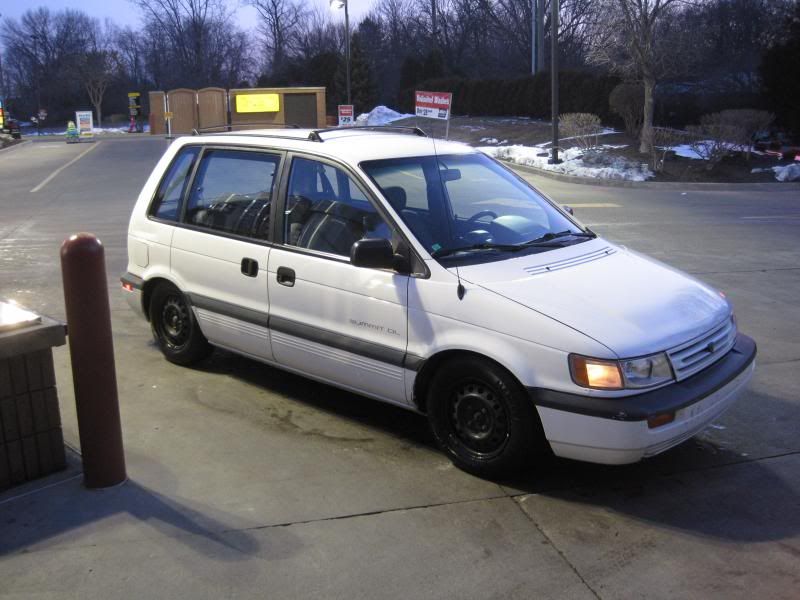

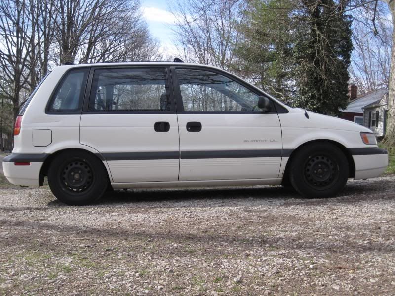

Here are some photos showing how the car sits completely aired out. It's driveable like this, but it rides like absolute shit. I want to be able to comfortably drive with the front at this height or a hair lower.
The rear is pretty much at it's limit. I may swap in some shorter shocks for comfort, but there isn't much space left to go any lower. I might be able to get another .5" out of it.

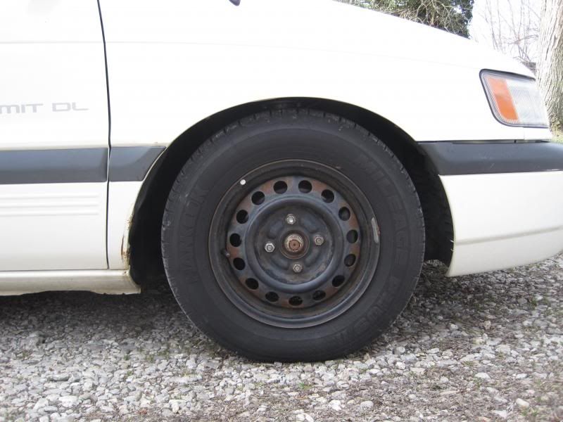

The front struts bottom out with 30 lbs in the bags, and that leaves me with about .75" of fender gap over the front tires. The front struts I used were Monroe OESpectrum part number 71892, which have a total length of 10.875" when completely collapsed.
I found an alternate strut from Gabriel that will fit my car: Part number G55586. This strut has a collapsed length of 9.67", which is more than inch shorter than my current struts. These Gabriel struts can be had for ~$30 each.
My other option is to use Lancer coilovers. Obviously, this is the more expensive option. I would be able get added adjust-ability, and be able to go much lower. If I spend the money to go this route, I might have to sell the air ride. I'd like to be able to do both.
