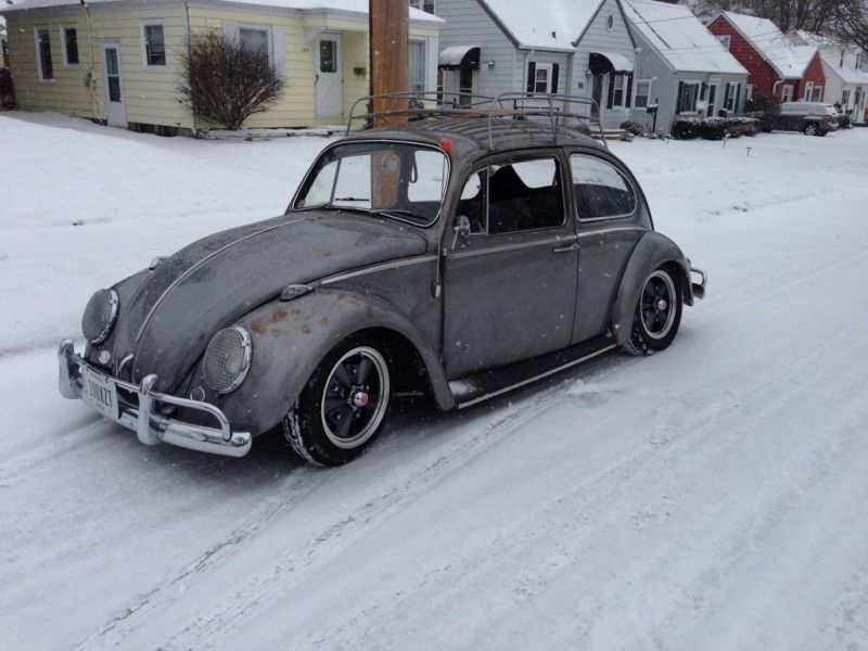

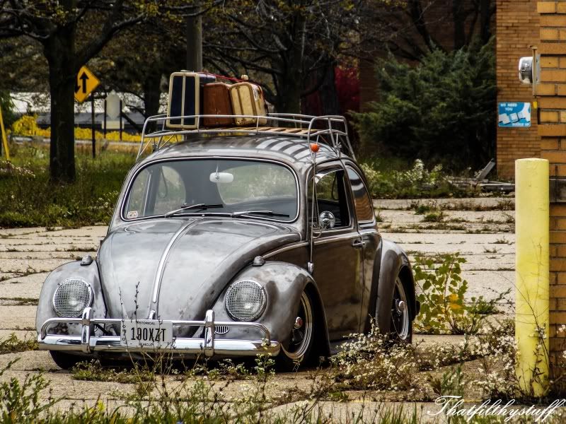

So i picked this up not to long ago from my brother who has owned the car for the past 5 or so years......
1966 Beetle
1600dp
Freeway Flyer
6in KCW Beam
KCW bump steer kit
cb spindles
Flipped tie rods
Down 1.5 splines in the rear w/ notched spring plates
Roof Rack
Empi 5 ribs with 135's and 165's
Rad 70's diamond pleat interior
Stripped to bare metal w/ clear over it

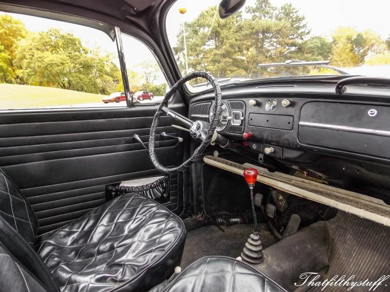

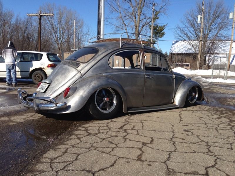

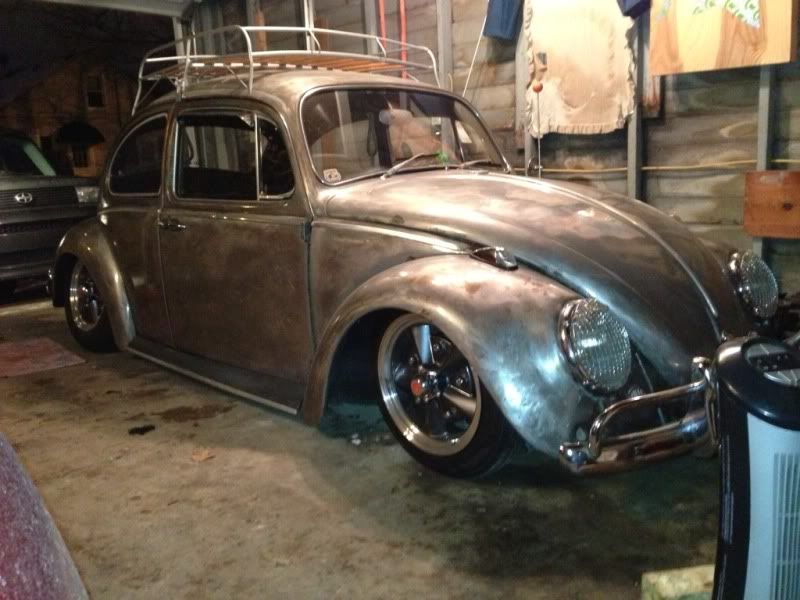

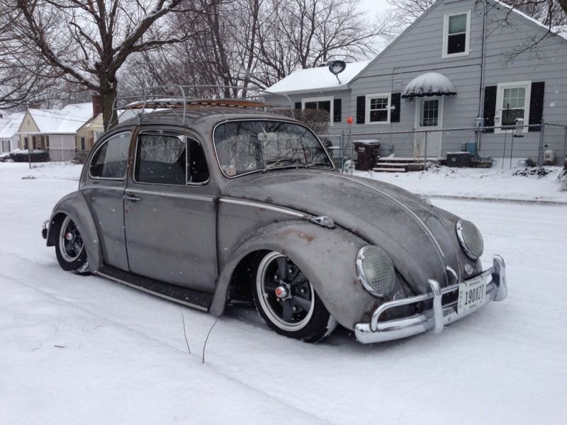

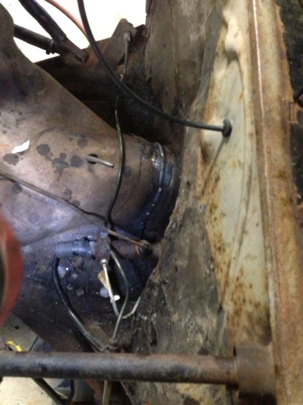

These are photos from how it was when i got it
In these photos the botom adjuster is out

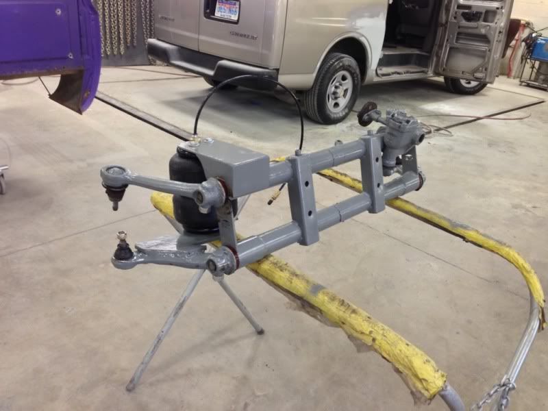

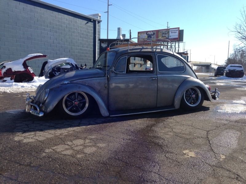

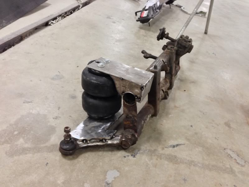

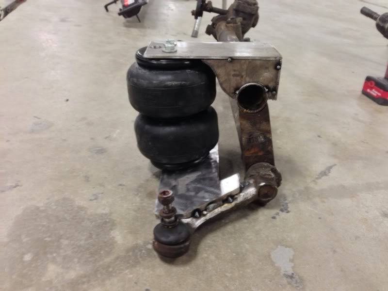

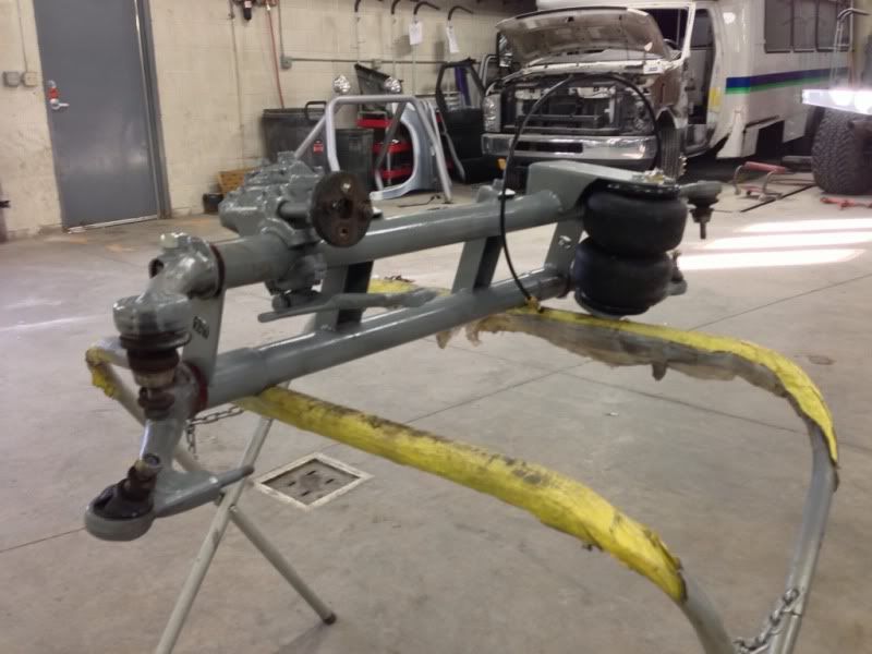

So my first winter project (i thought) was going to be take out the front suspension and detail it..........well my detail project turned into a fab project and this is what i ended up with....

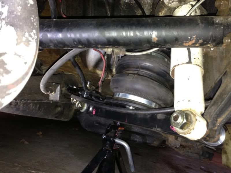

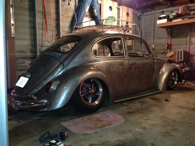

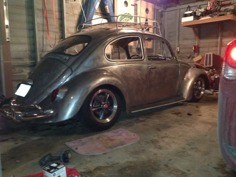

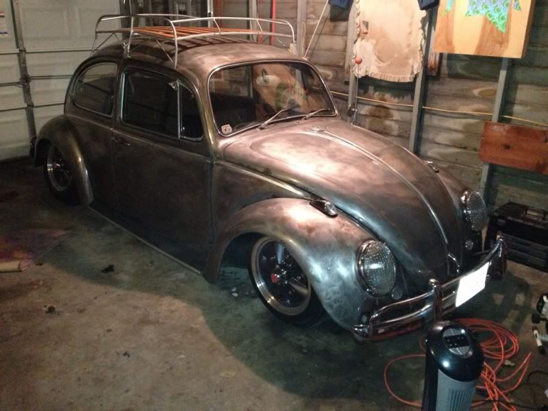

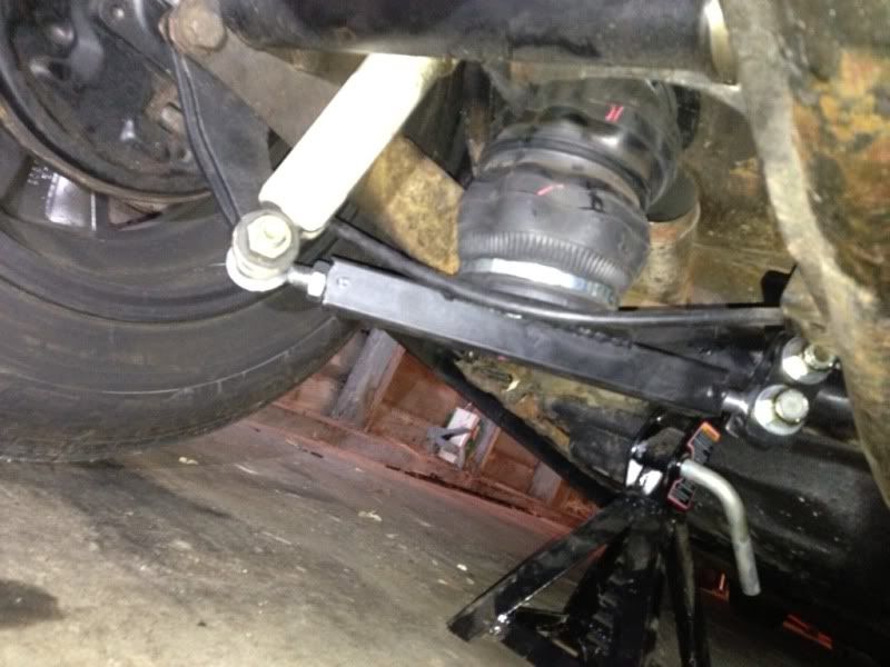

So the front is done, and i was going to leave it as that, and just lower the rear another spline, that went out the window when i got a good deal on 2 more bags so i bagged the rear also. I made my own set up, but it is very similar to the Airkewld kit. I dont have any pictures of the setup its self yet, but i should get some tonight. Now i just need to get some real air management........

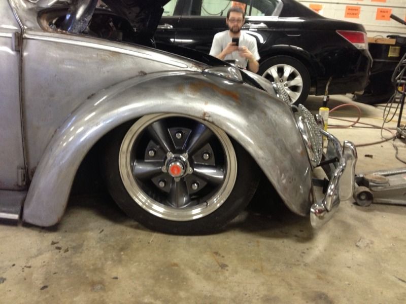

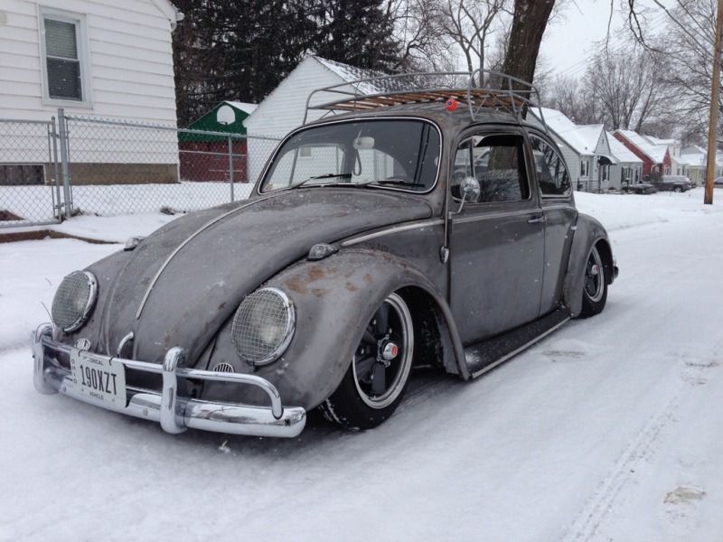

This is all the way down right now, the rear will go another inch once i notch the spring plates some more tonight...
