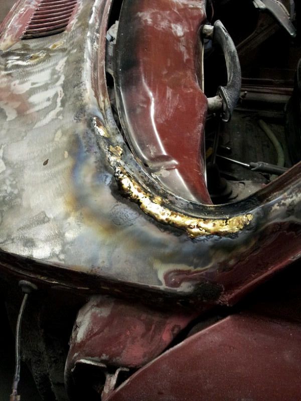

    So far most of the holes have been filled/closed up either with brazing or cut out and fllled with a metal plate.

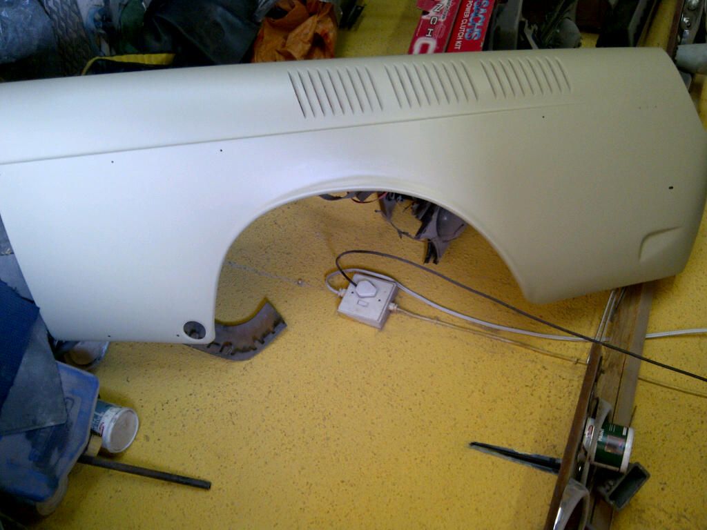

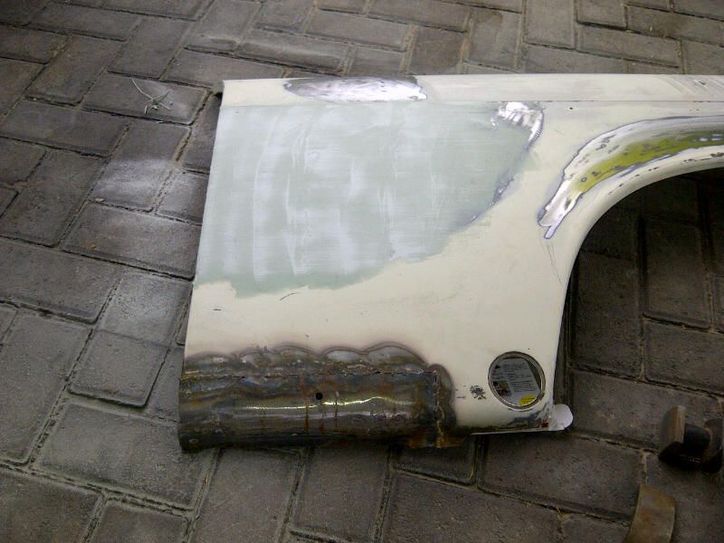

    the new rear fender we bought,denst were being removed and was being prepped for paint

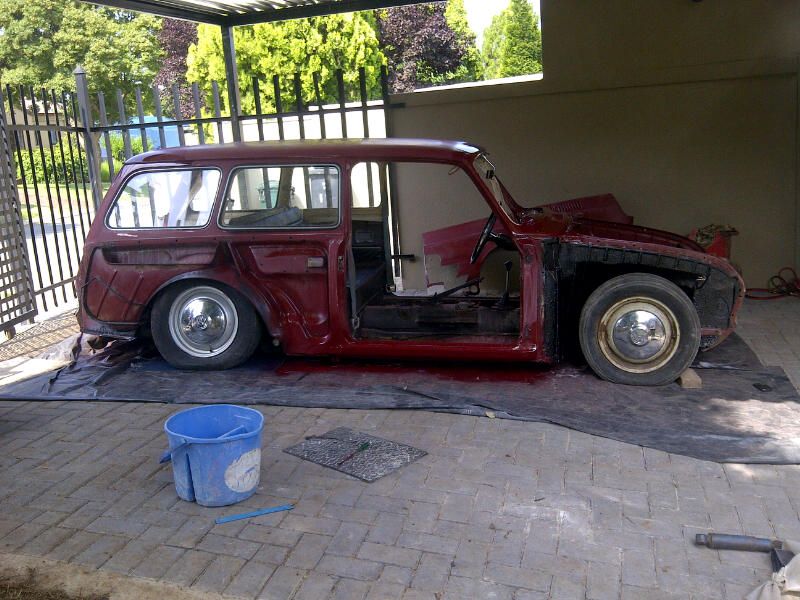

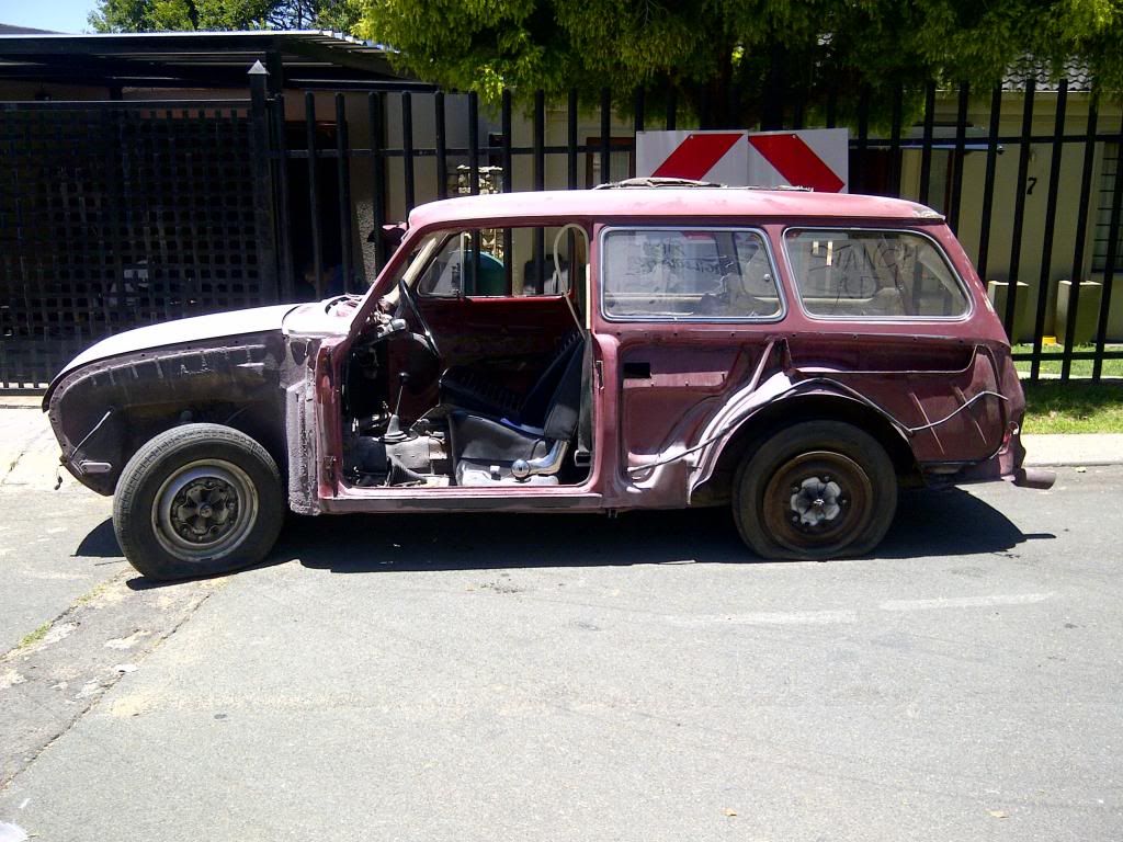

    Car all stripped

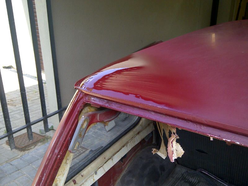

    the panel that we saved,a piece was cut out and a new plate was welded in,holes were also brazed. the panel beater was very good and did a good job

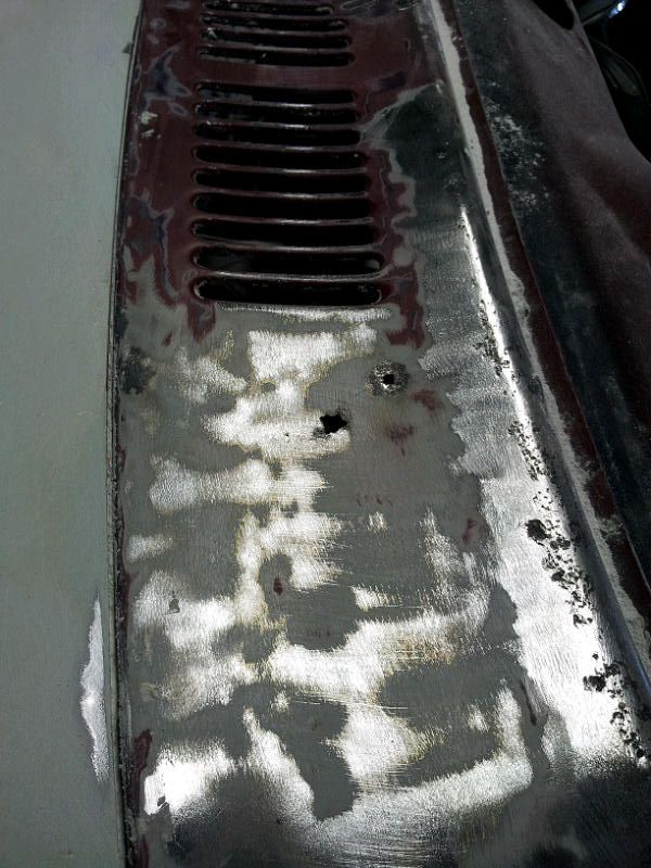

          Their were holes just below the windscreen
          got them all brazzed*/filled up

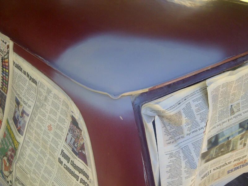

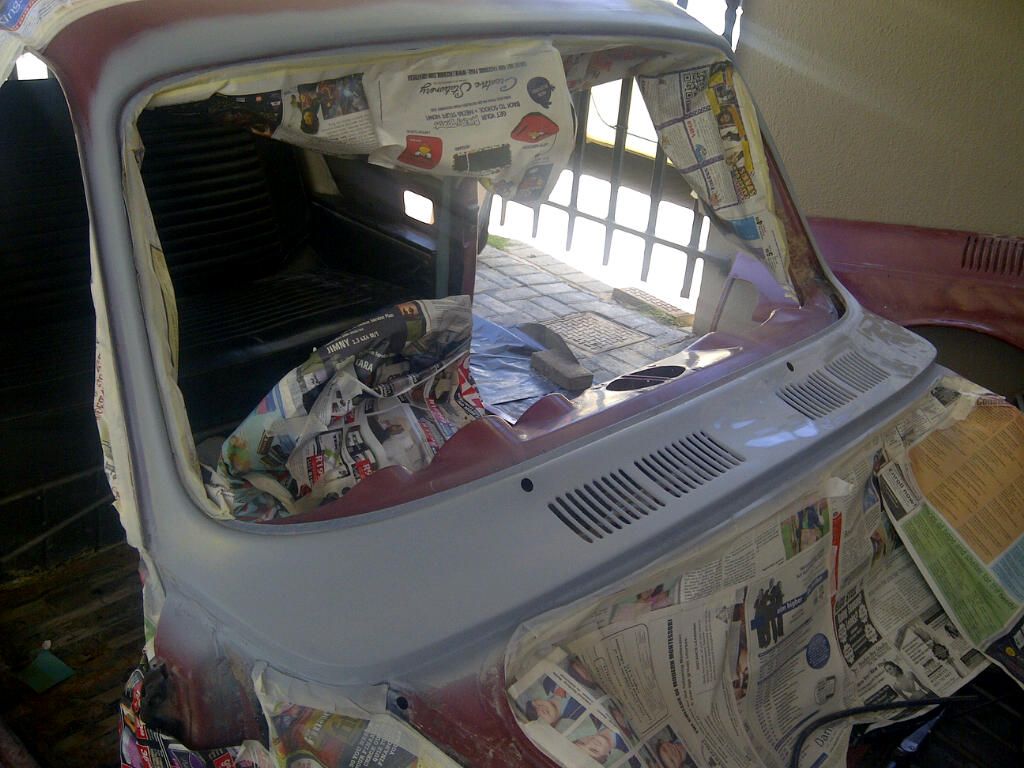

          grinded down, thin layer of body filler to smooth it out abit and primered
          other area that was filled ad primered

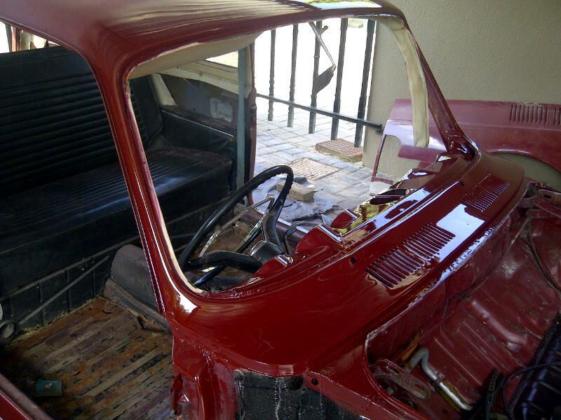

          painted
          new fender that was patched up abit and prepared for spray

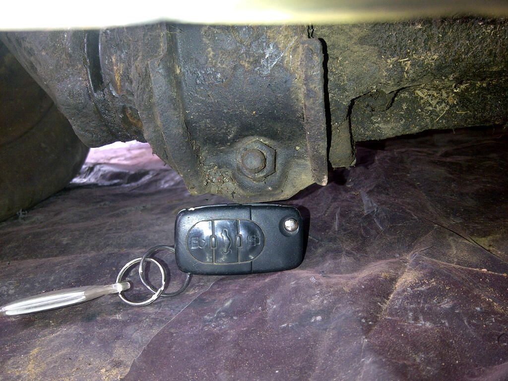

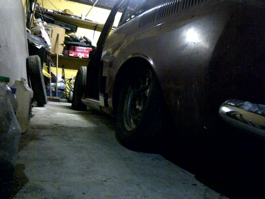

          Lowered the car on Saterday
          before
          after
          front clearance
