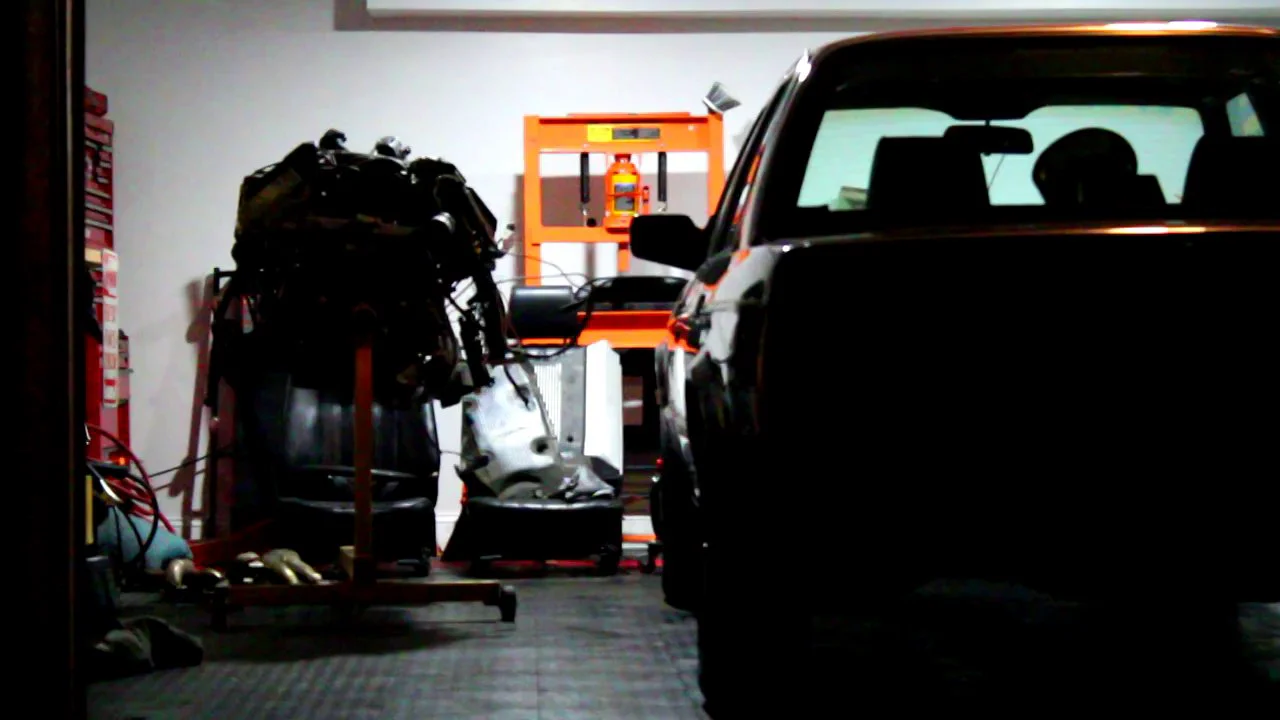

          Update: March 29th
          Nothing new, just shot a short video of my garage to test out my new camera.
          Just a quick shoot of my garage and the current E30 M60 swap in progress. Song: Architecture In Helsinki - One Heavy February
