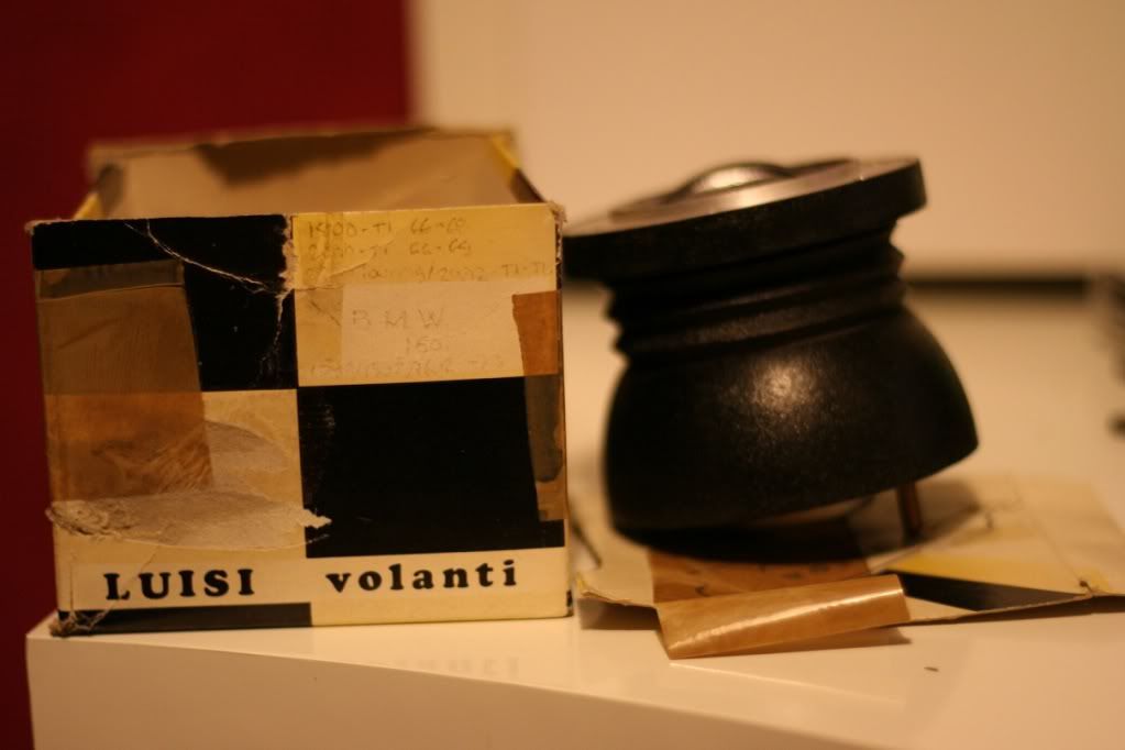

                    Bought some steering wheel hub. Genuine NOS part from 70-80´s (last one in Finland)

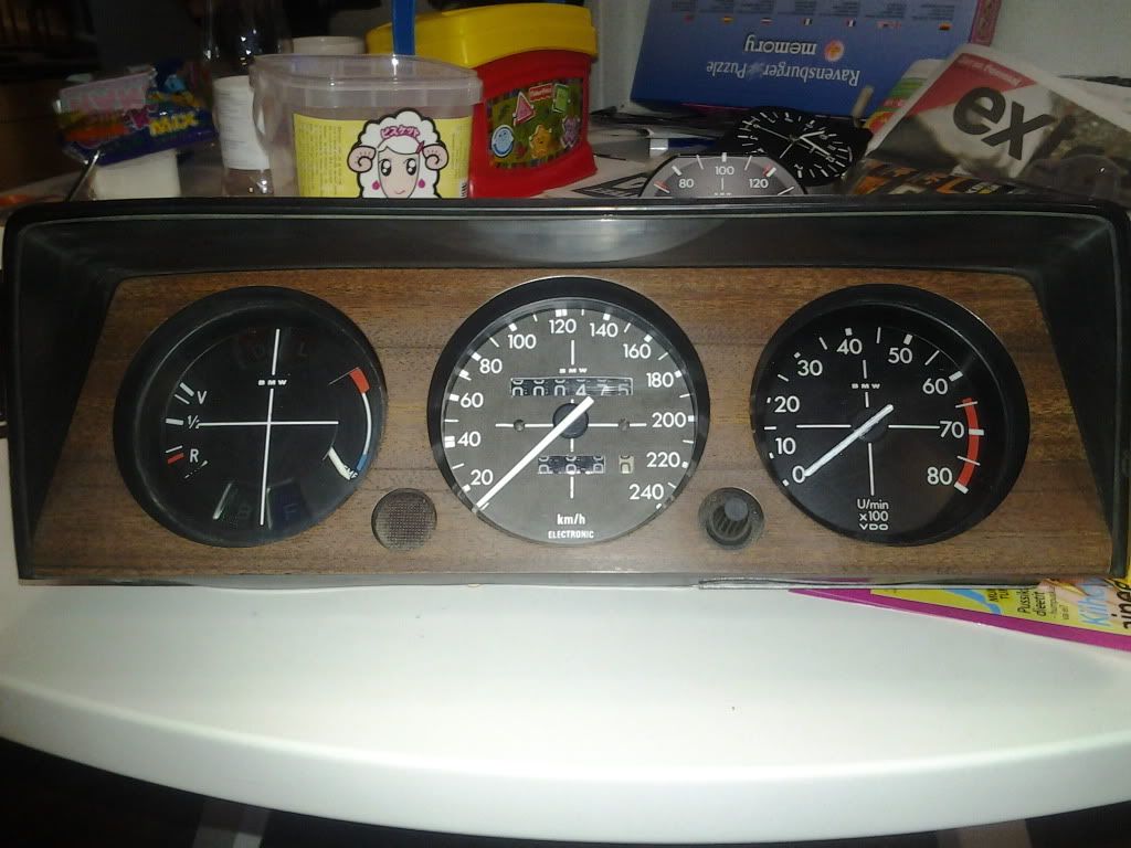

                    I have E28 535 gearbox, so there is no place for speedo cable.
                    I am going to use E30 LSD differential, and there is a trigger and sensor for electric speedo.
                    So, the solution already exists---> Let´s fit E30 electric speedo to the 02 instrument cluster
                    Prototype of matching speedo dial face, clock replaced by a original tachometer

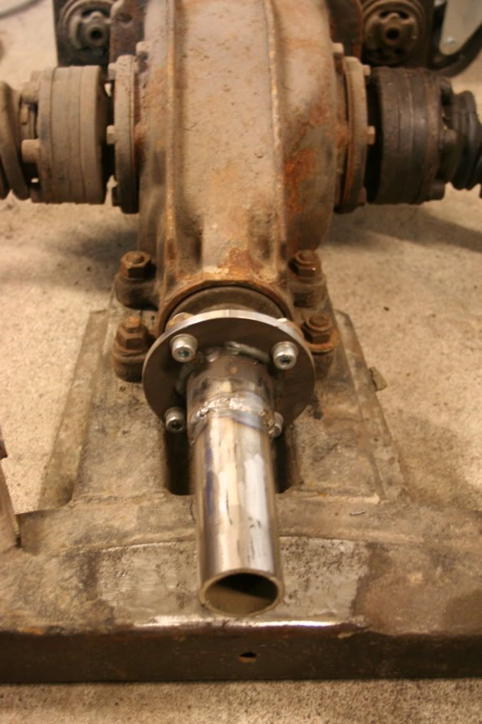

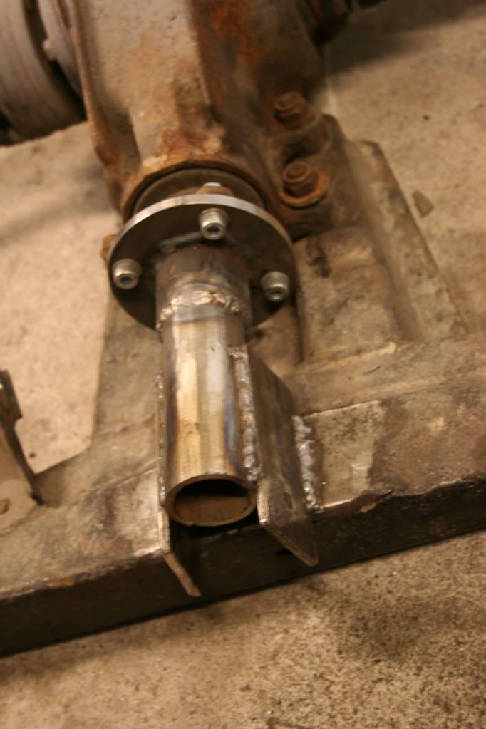

                    Fitting of E30 diff

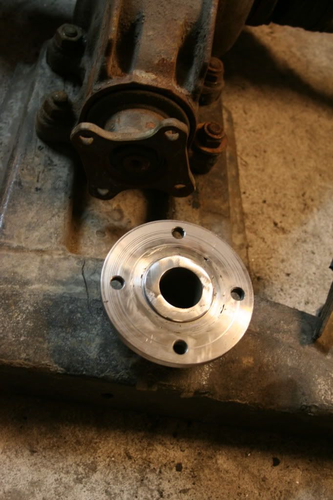

                    Turned some adapter flange. Fits directly to the pinion flange
                    Bolt on
                    Extension..
                    ..cutted to the proper length

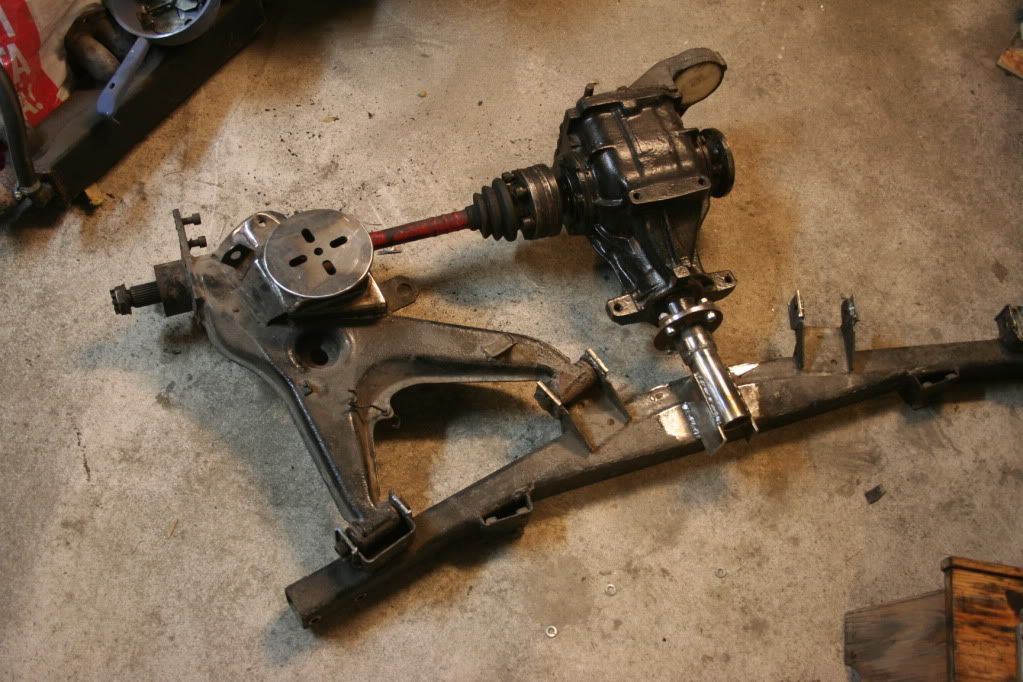

                    Jigged to the subframe
                    Remove the lump
                    Remove original brackets, and bolt the new lump to the jig
                    E21 falf shafts fits perfectly

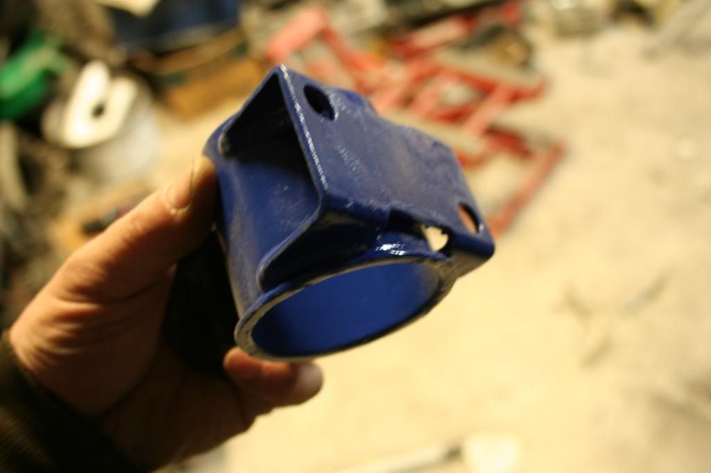

                    Finally, manufacturing new bracket points around the lump (Still under construction, because i am waiting some parts from the lasercutting company)

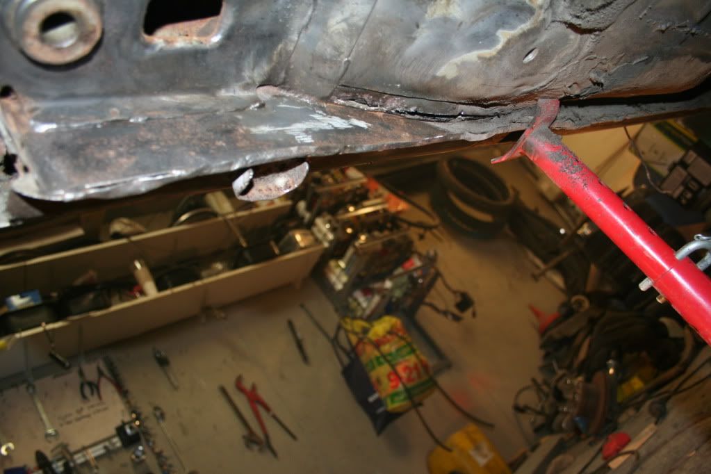

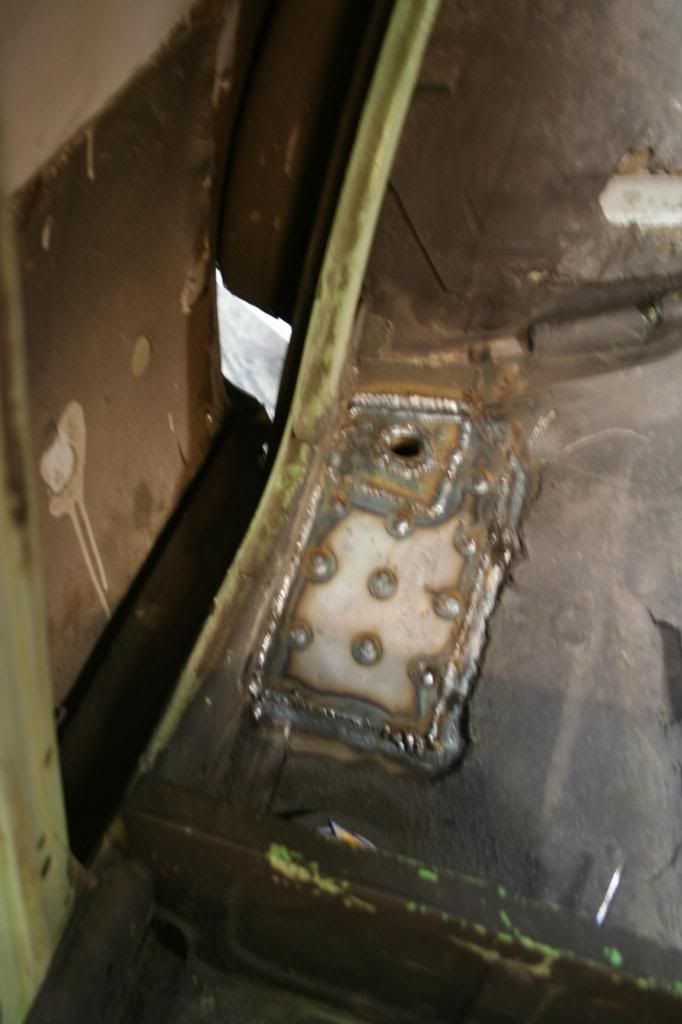

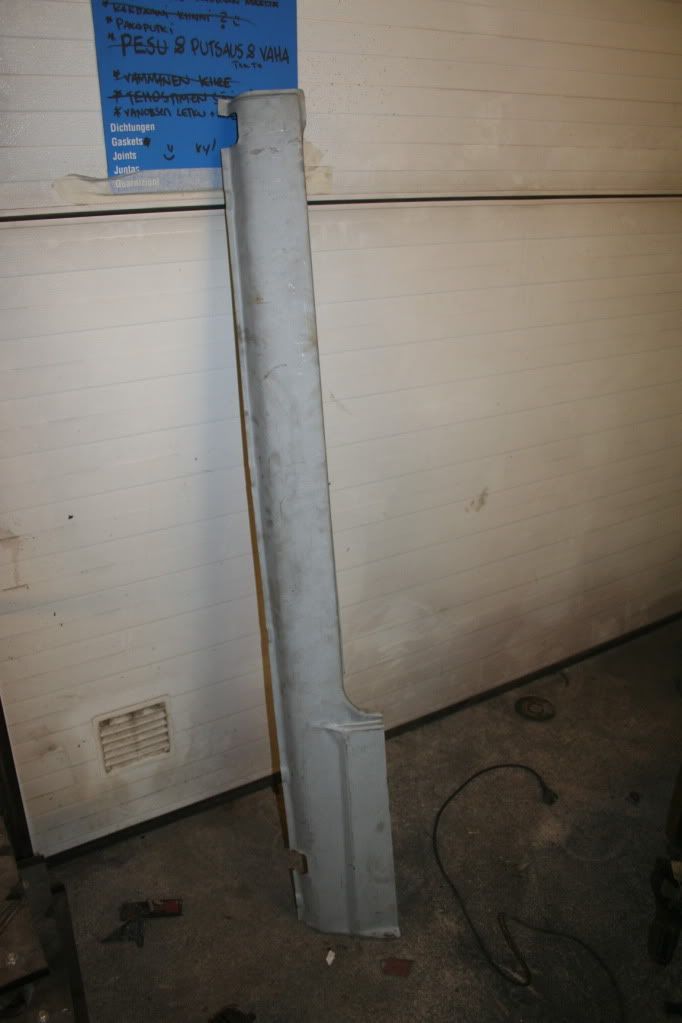

                          Minor weldings
                          Same process to the both sides. (new sills, subframe mounts etc.)

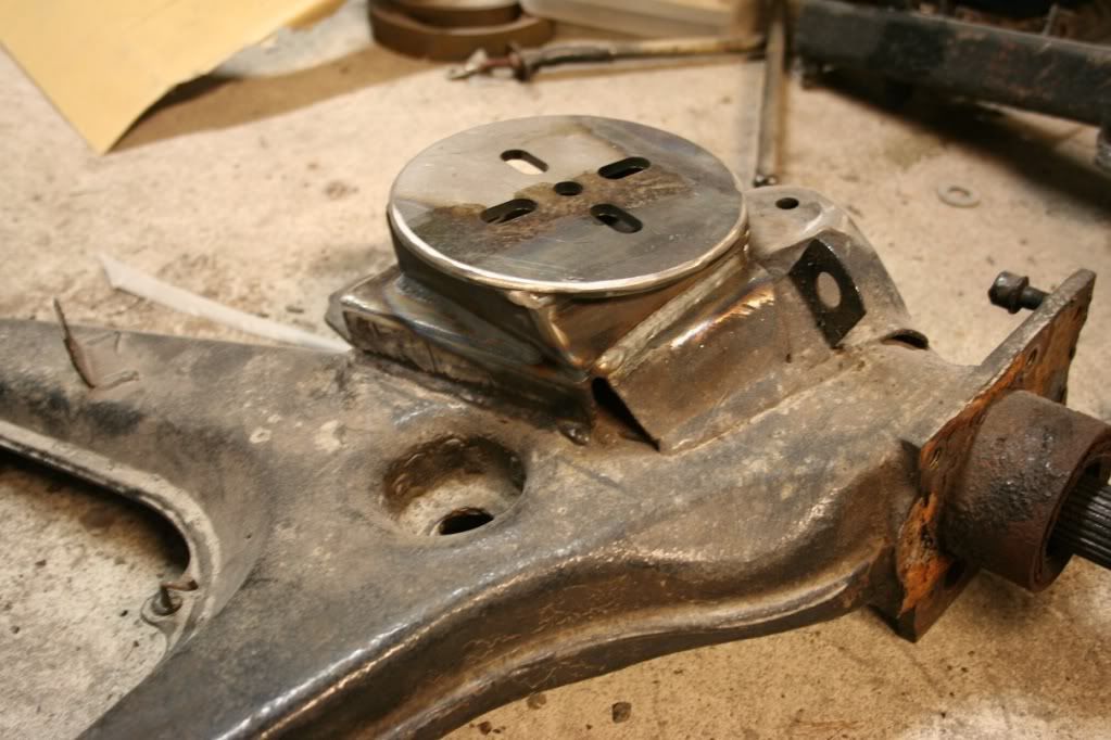

                          Modified E36 diff cover, to fit E30 diff. (LSD of course)
                          02-series rear subframe bushing cover, modified for shortened E30 bushing.

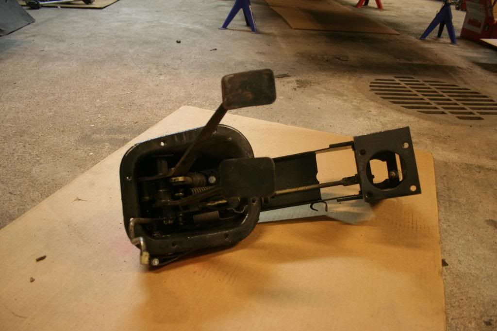

                          Original pedal box raised up to life (welded, sandblasted, painted and re-assembled)

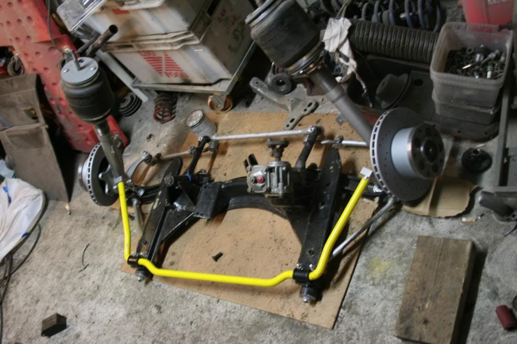

                          02 rear axle with E21 driveshafts and trailing arms, 20mm sway bar. Powerflex/Superflex bushings. (subframe modified to E30 diff)
                          Zimmermann brake discs and some other parts.
                          Front axle. 22mm sway bar. Powerflex/Superflex bushings...
                          ..and Volvo 4-pot calipers.
