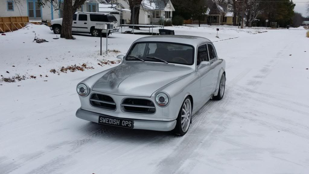

Here are some more pictures of some of the daily use of Volvo X, and I must say that I am tired of the ice we have had over the last week, eventhough the car looks right at home in it.. LOL I have had a lot of guys ask me how I can drive the car in weather conditions like this, but they do not understand that this car was built to be a daily driver, and that is no matter the weather condition.. I am finding that the car is harder to keep clean than I thought this color would be, but it really isn't anything that several car wash visits a week wont take care of.. LOL
