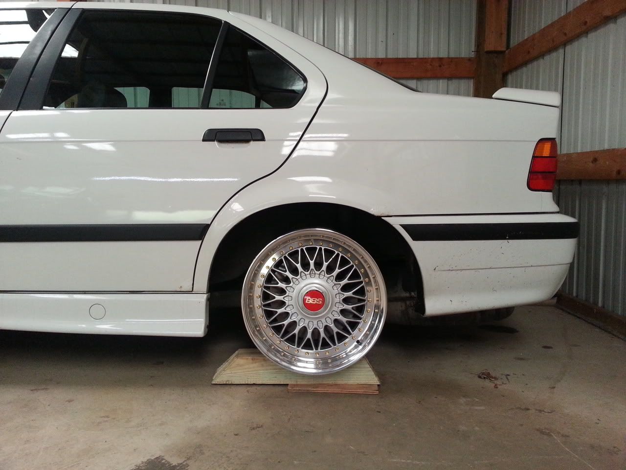

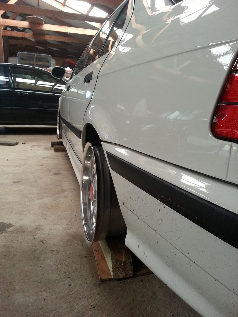

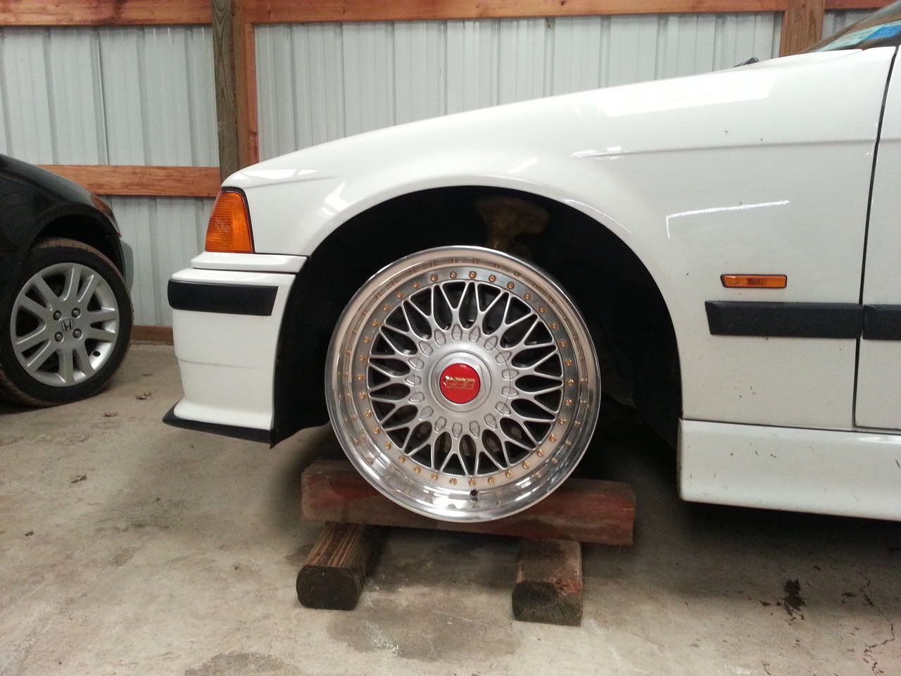

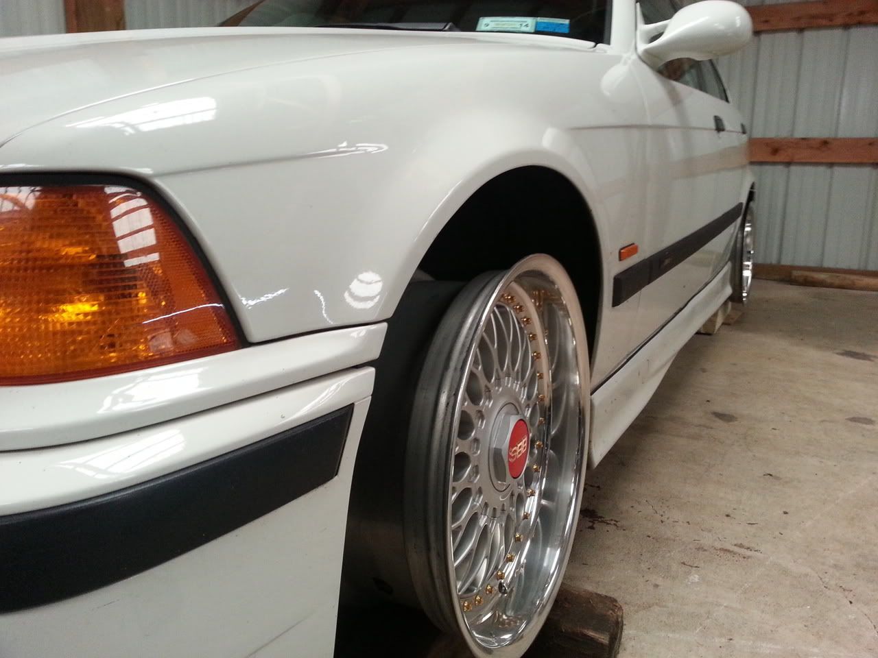

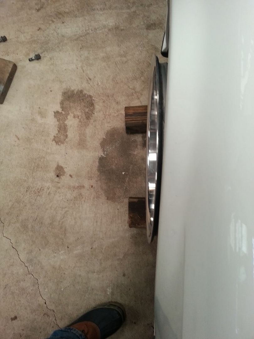

            I had a few spare hours on Saturday while my wife-to-be was trying on
            wedding dresses, so my father-in-law and I went to test fit my Style 5's for shits and giggles.
            The rear should tuck up higher to the body line, as I didn't have it evenly blocked out back. Lack of lumber = no bueno
            The front didn't look bad. I took a moment to realize my front end alignment is
            Overall: I am satisfied, and I'll probably rock these for a little while.

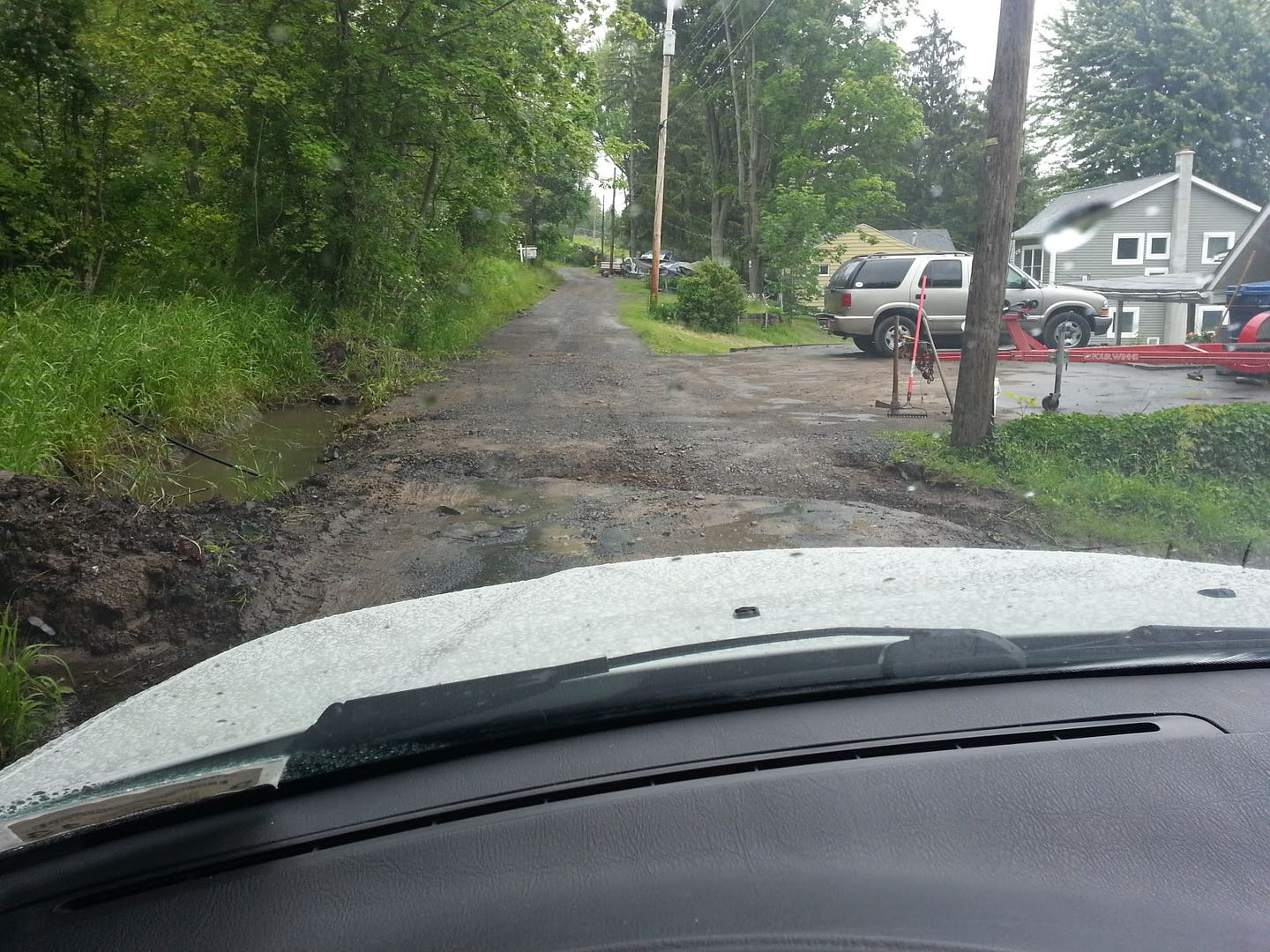

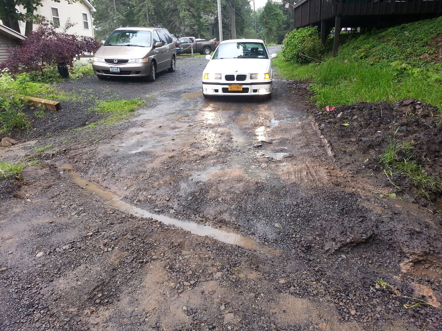

              Drove it to my parent's cottage in Wolcott, and was promptly met with the fucking Rio Grande river crossing the access road. The pictures do it no justice whatsoever. It was about a foot and a half deep by two feet wide. Somehow I 3-wheeled it across without gouging the underside of the car.

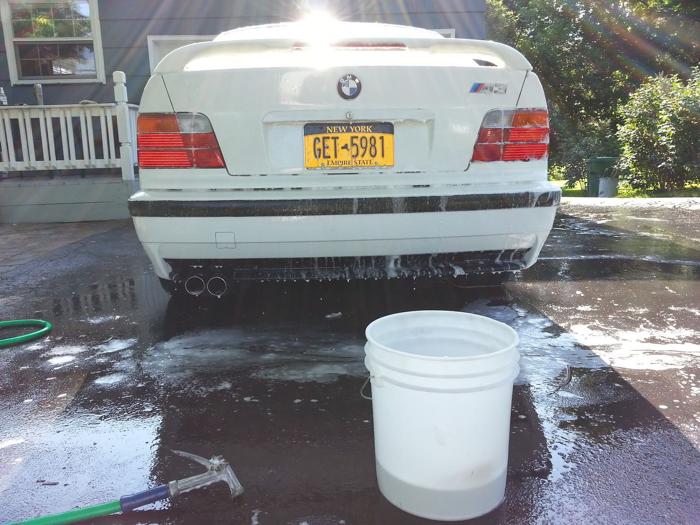

              After that misadventure, it earned a bath when I got home.

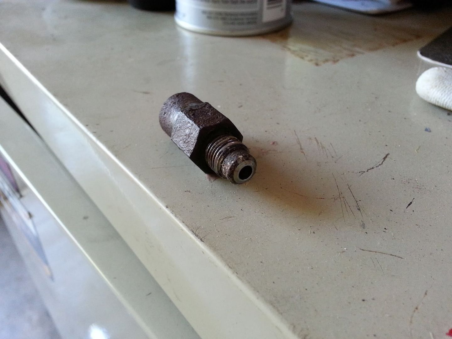

              I also deleted this little annoyance from my clutch hardline. It's the "Fat Americans Can't Drive A Manual Transmission Properly So Lets Add A Delay Valve" ...thing.
              I don't know who's bright idea this piece of shit was.

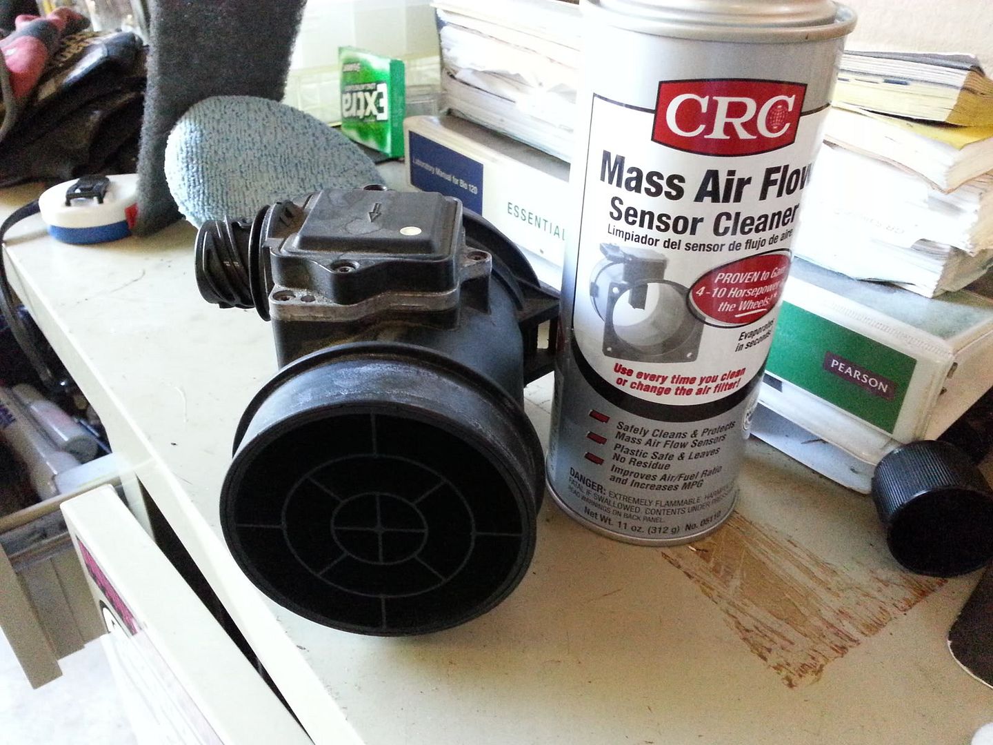

              Then I ripped apart my induction facilities and cleaned my MAF and checked my intake boot for tears (read: a reason to delete the ASC). After removing a few magical pixies and dead dragons from my air filter, I gave everything a good cleaning. If you own an E36 and have not done this, get off your ass and go do it right now.
              After deleting the CDV and cleaning the MAF, the car drove like a totally different animal. It was much more responsive, precise, and I could do siqq driftz without worrying about trashing my clutch.

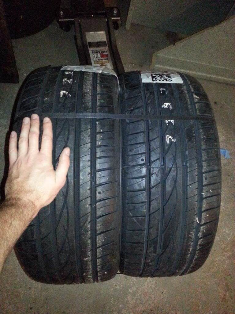

              And then I realized I'm due for an inspection this month, and my rear tires are down to the wearbars.
              Enter: some less-trashed 215/45R17's on my Style 5's for temporary rear shoes.
              They aren't pretty, they rub a tad, and nothing matches. But hopefully it's enough to get a new inspection sticker. :

                      How long did it take you to do the CDV delete? I'm debating doing it to mine.
                            Not long, I like to dillydattle though. It took me about two hours from start to finish- my lines were a little on the crusty side so getting them apart was a cock. A word of advice: make sure you can crack the bleeder loose before taking anything else apart, or you're fucked.
                            I got both sides of the CDV loose, then slowly removed both sides until I could get them both off at the same time- you lose less fluid that way. If you don't, this is what happens.
                            Make sure you buy the proper brake fluid!

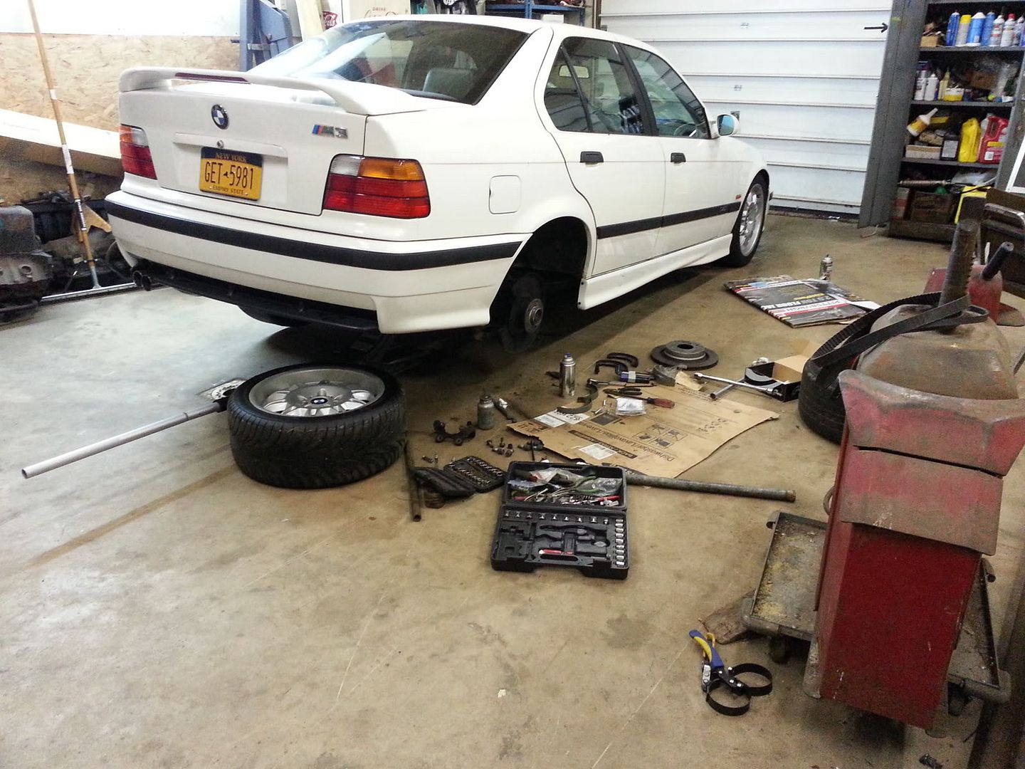

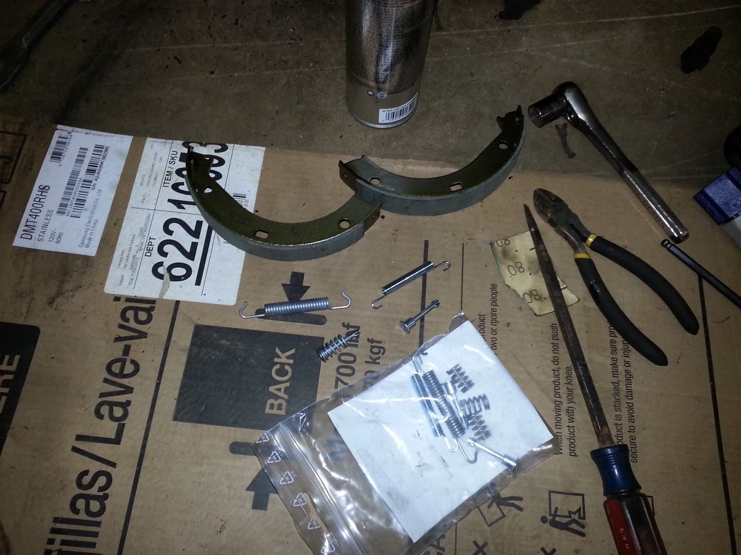

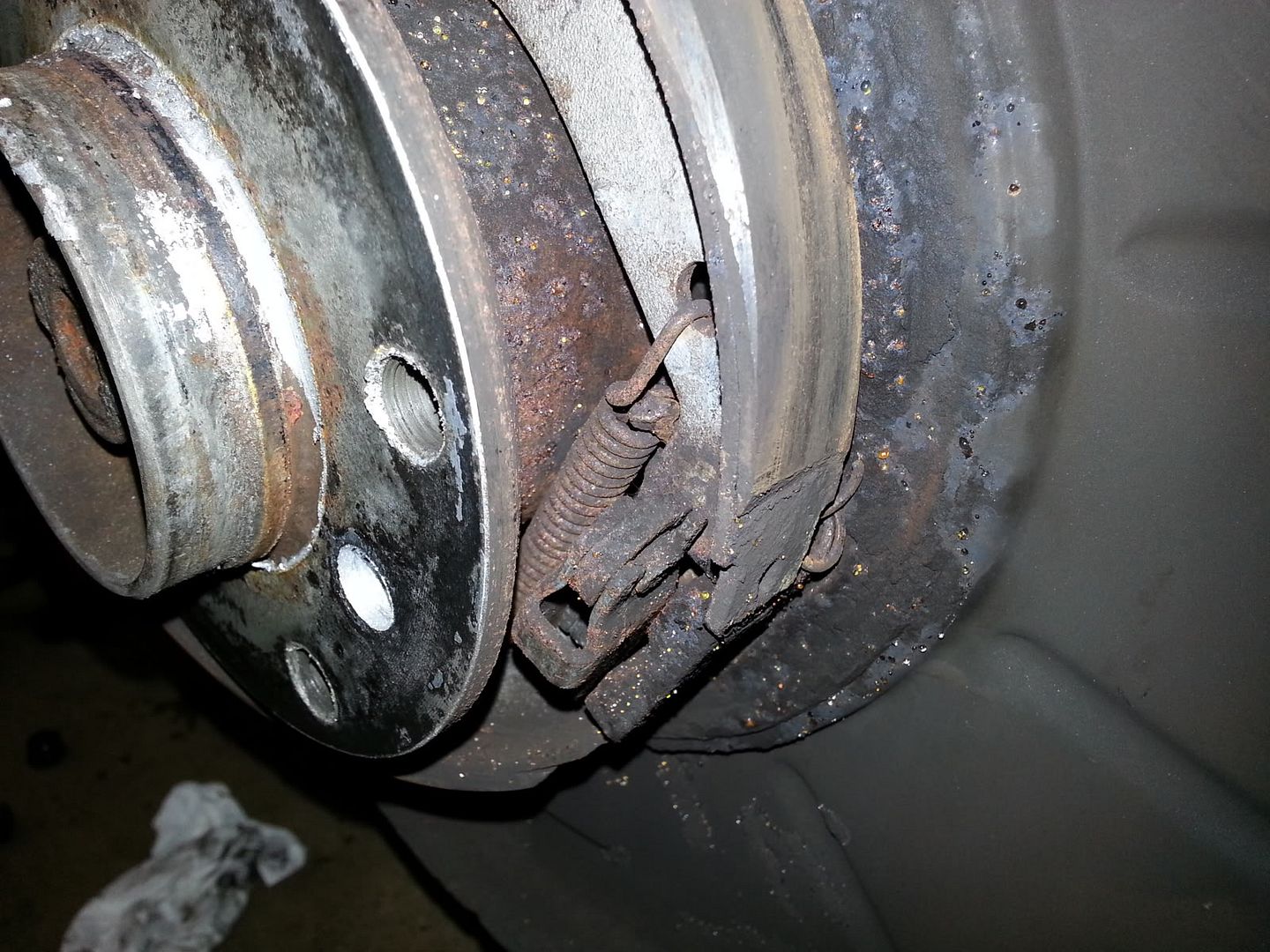

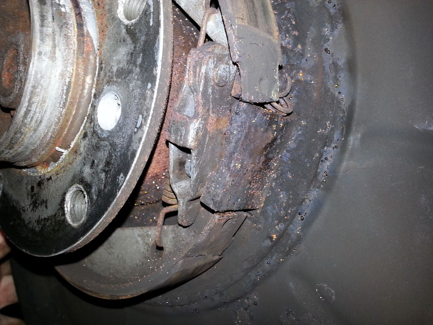

                              4th of July weekend, my ebrake had finally just shit the bed. They decided to stick 3 minutes after leaving home, for a 30-minute drive to work on the weekend.
                              I knew there was something wrong with the rear shoes, but never really took the time to figure out out. And boy, was I sorry I waited so long.
                              You can see the broken springs that were just rolling around inside the disc for two days.
                              Enter, all new hardware and shoes.

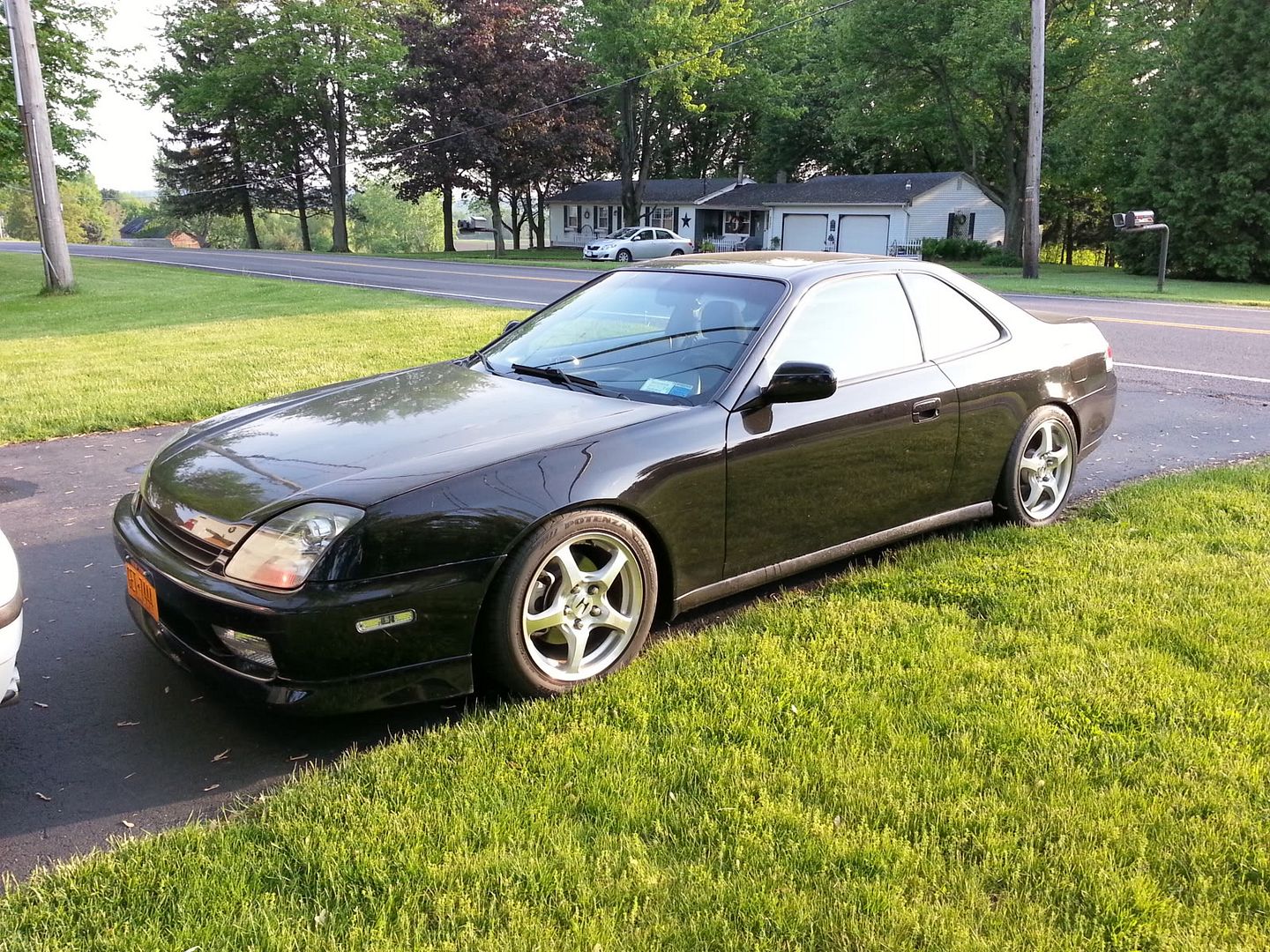

                              So, while that was torn apart, I drove my Prelude around town, and was generally displeased with the weather on the 4th of July. We drove through a fucking monsoon in a car with an intake pipe 4" off the ground.

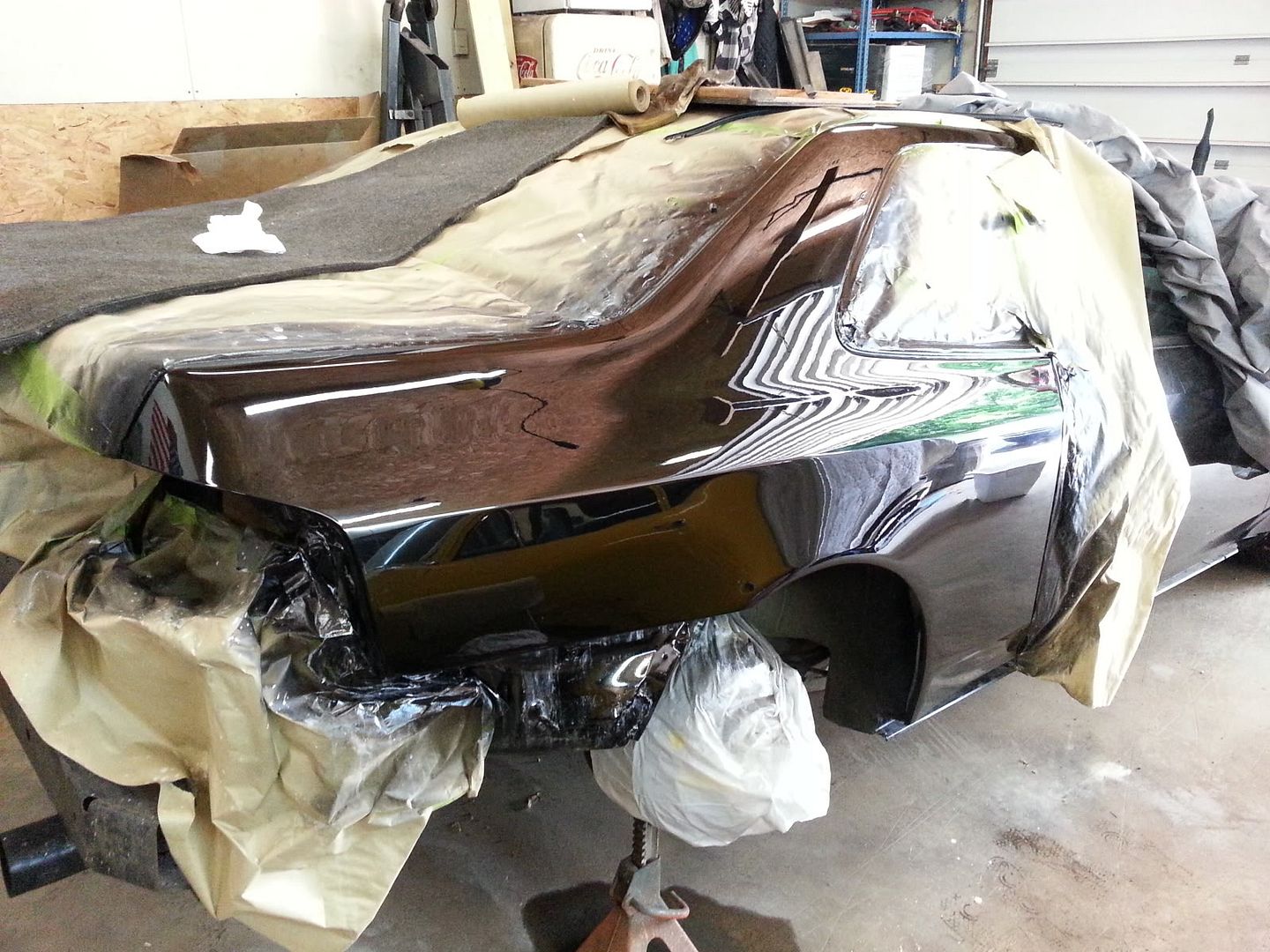

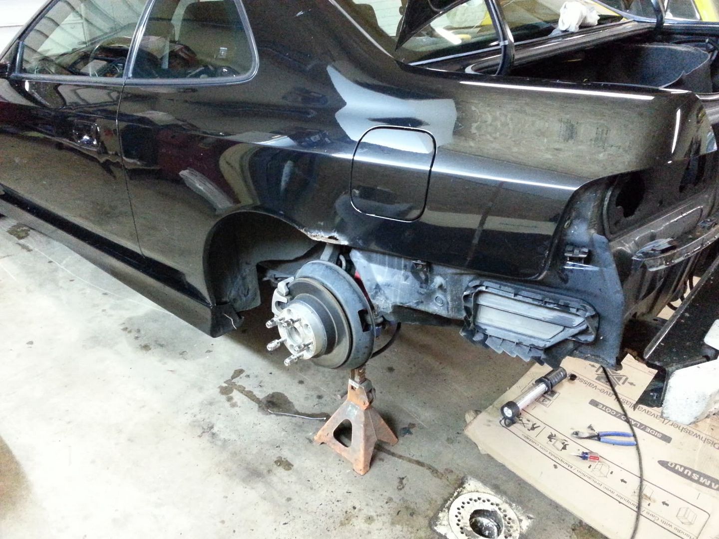

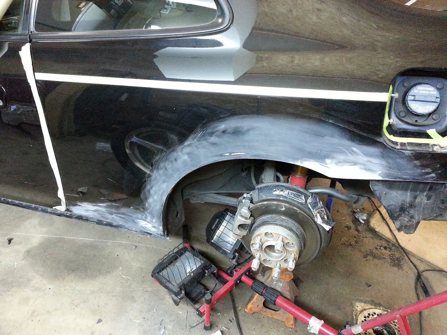

                              Shortly after, the Prelude went under the knife. I decided to tackle the rust that was forming on the quarters and paint it the right way.
                              I knew I was fucked as soon as I started on the driver's side quarter.
                              I tried getting it all painted in a week (which was a stupid move) so I could put the car in a local Japanese car show. Our good friend andybob made the 4-hour pilgrimage to go to the show and hang out. Sadly, my slutbag Honda didn't cooperate, so I did the next best thing: I drove a BMW to a JDM car show.
                              Then I got back to work on the Prelude, after leaving the car show for the first time without a trophy.
                              I threw my Works on for good measure. It sucked that I didn't have the car done in time, but I was glad that I took my time and did the bodywork right.

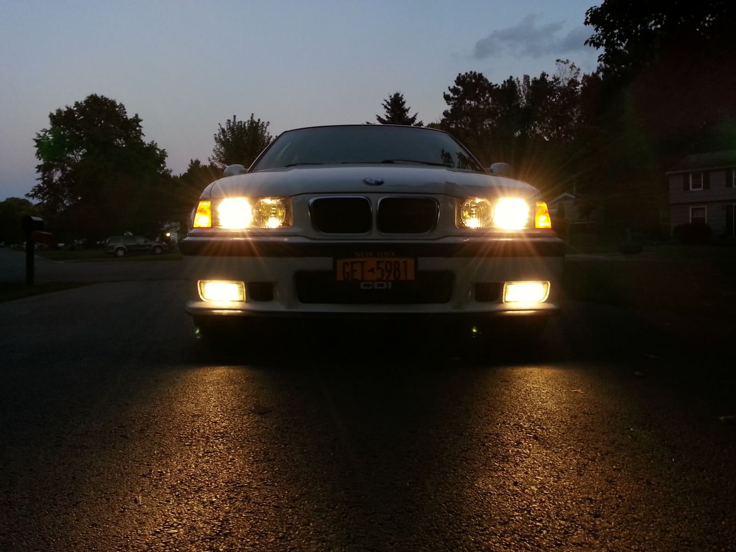

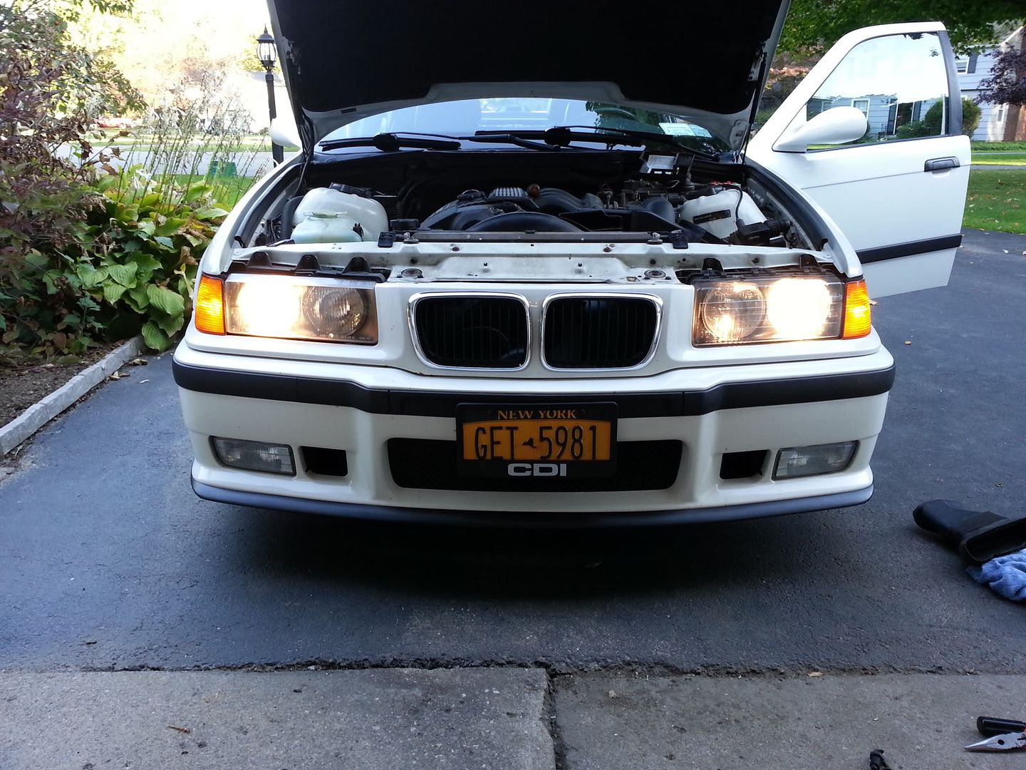

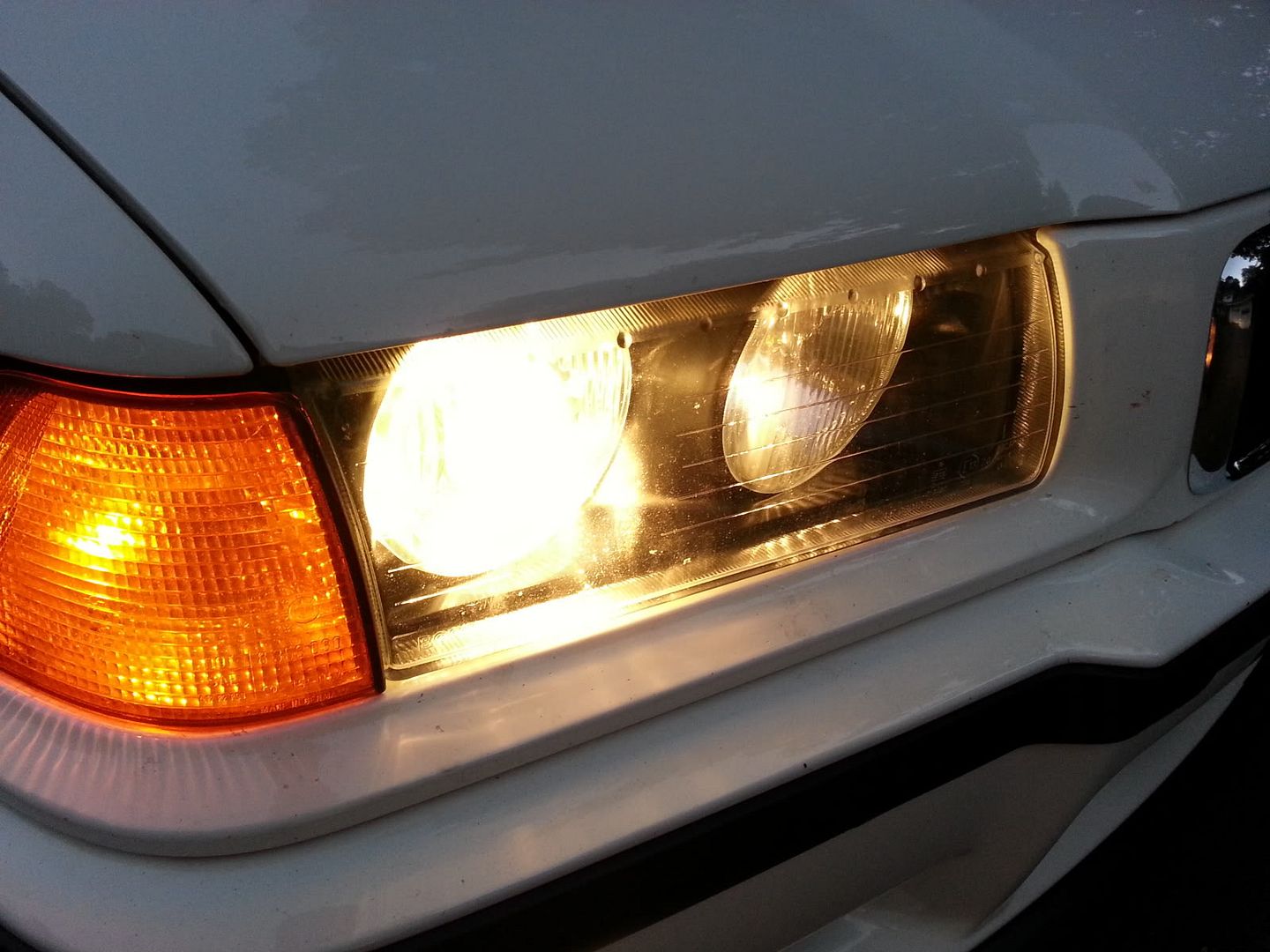

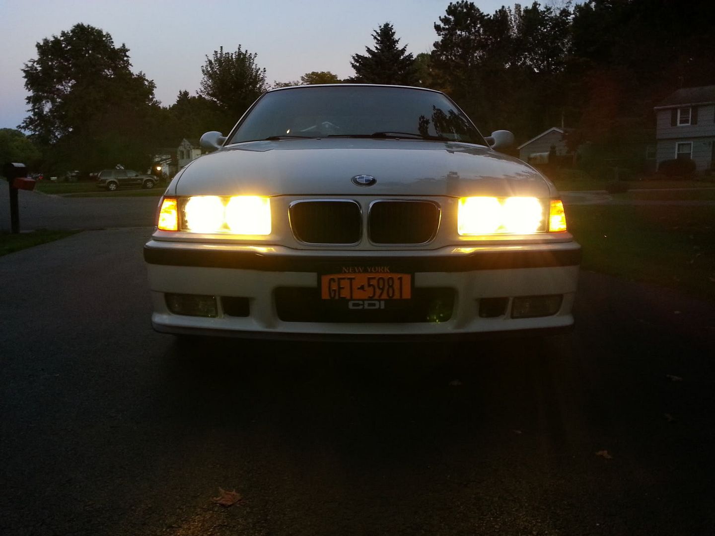

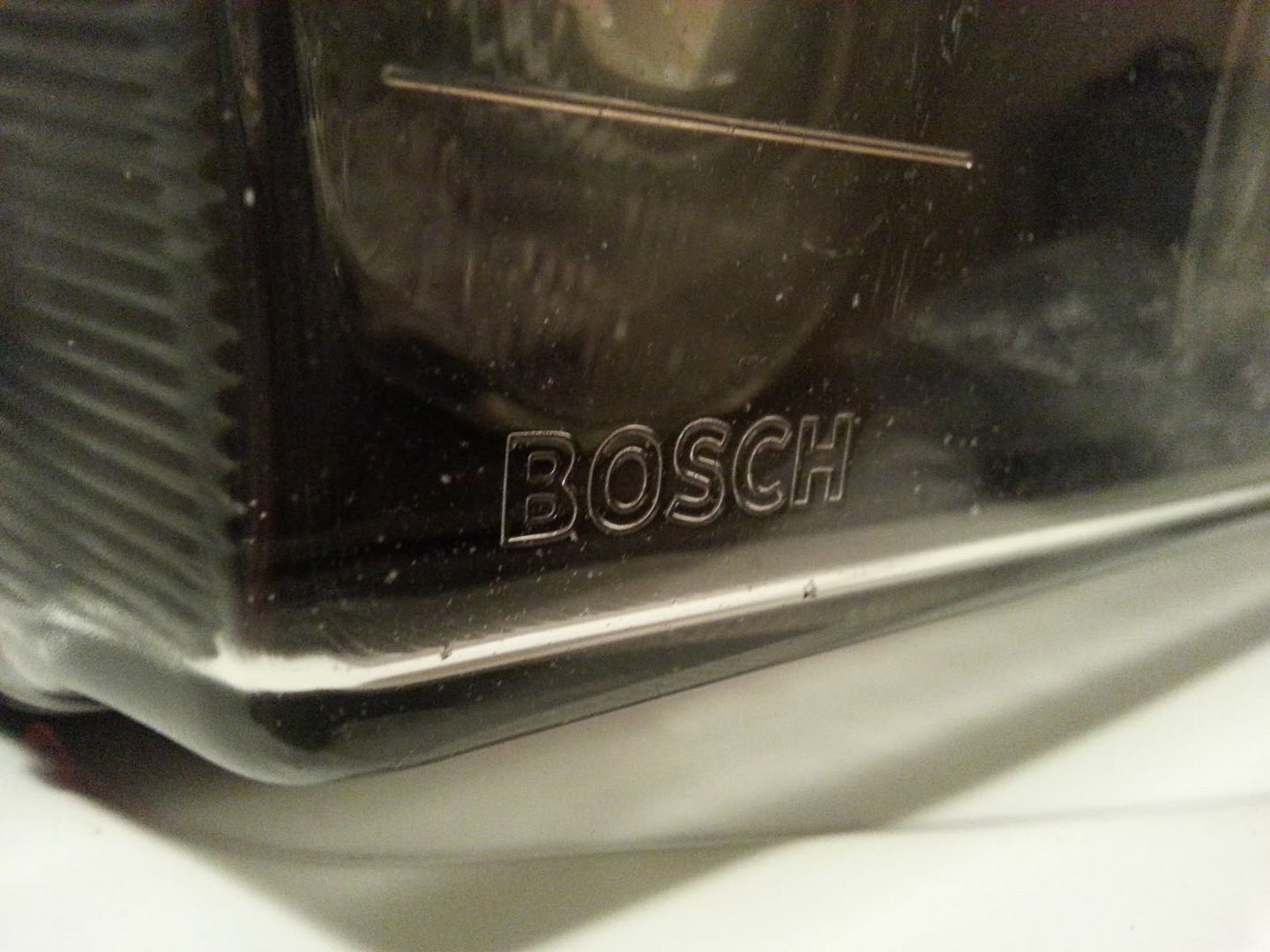

                              As soon as we got back, I ripped open a package from Kitty that contained what I was thinking about all week long- my European Bosch ellipsoid headlights and clear lens tail lights.
                              This was not an easy task, because there was a massive temptation to go buy GTA5 as well.
                              I had to make a wiring harness for both headlights at work (lol) to get them to plug in- no splicing for this guy.
                              And then I put everything on and fapped furiously.
                              Old on the left, new on the right.
                              I had to use two Noyka Hyper Yellow bulbs in my high beams, I didn't have any other H1 bulbs at the time. But I kind of like them that way.
