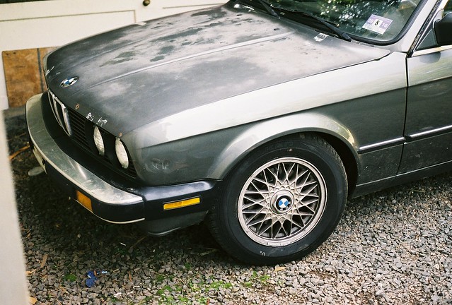

                      Received and promptly got rid of an 84 380sl
                      The e34 was sold about a year after the last post
                      Bought an 89 Accord Lxi to make it through last winter, which was scrapped after the exhaust fell off and the engine started knocking.
                      Got an 87 325is which is my current daily/giant money pit.
                      FH020020
                      And I picked up an 82 Yamaha XS 400 Heritage Special to have fun with
                      IMG_3047
