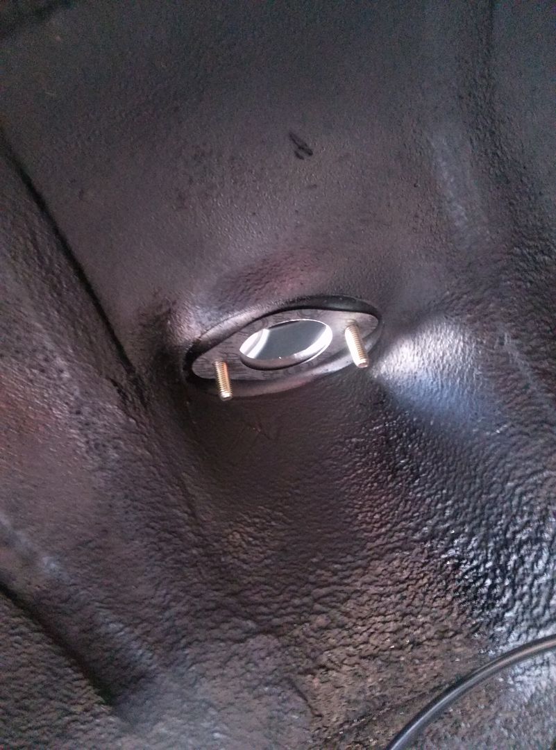

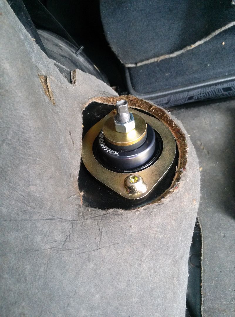

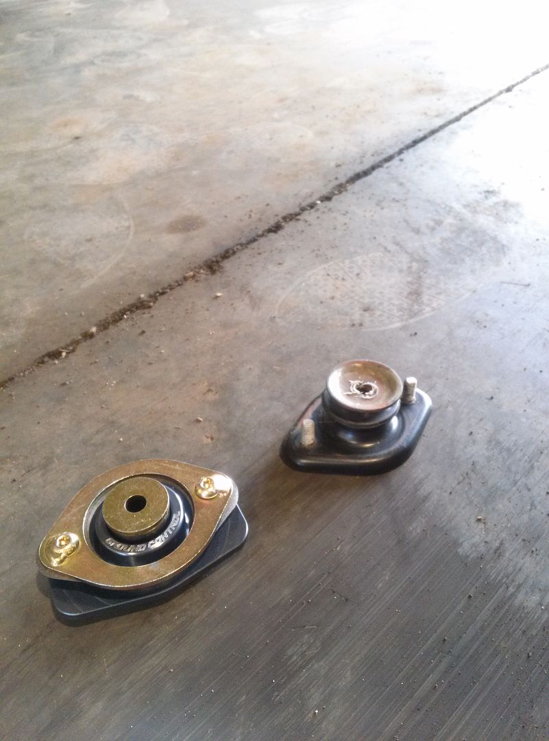

I found a great condition black carpet that should be shipped out today. I have also been contemplating buying aftermarket rear strut mounts since my e46 m3 vert mounts don't look like they held up too well. I was looking at either choosing Rogue Engineering mounts of the Ground Control mounts. I ended up opting for the Ground Control mounts because they are poly and seemed to be made a little beefier. Those should be shipping out today as well=)
