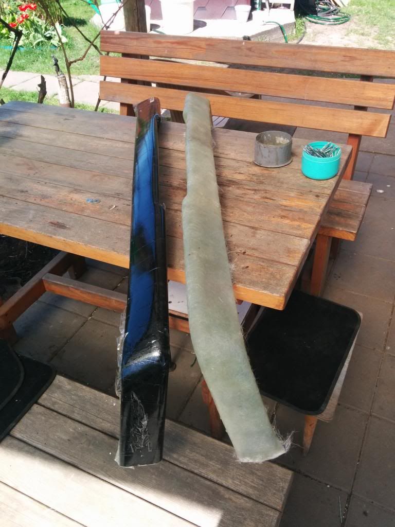

        Found a solution for my sideskirts rsting issue!
        Here it is:
        No, not the cat, and not even the bike! E30 Touring sideskirts
        Theyre plastic, and ima fabricate em to fit me. Gotta cut out the steel ones and do some crazy shit

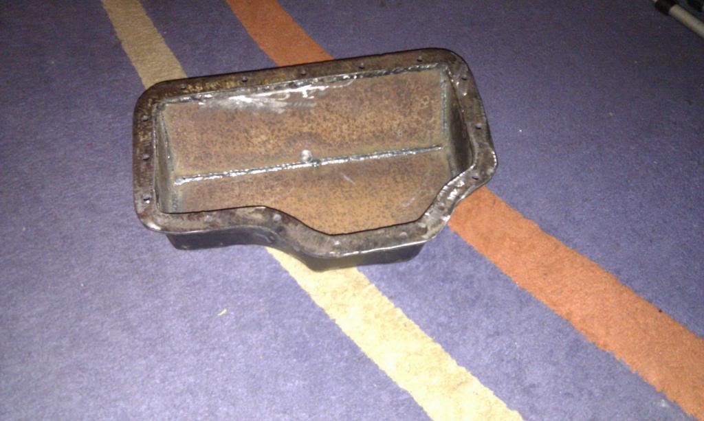

          Got tired of the aluminium sump, so had this made
          Steel! Much much better now. Gotta do some anti-rust things to it and install it tomorrow.

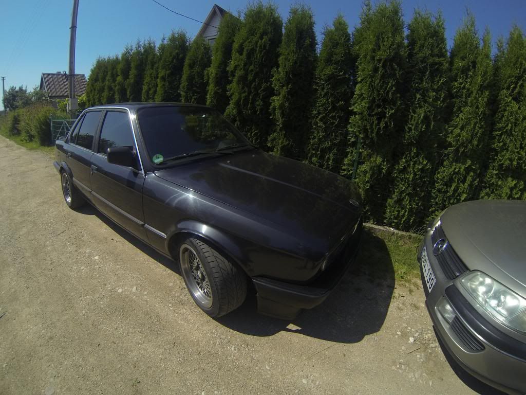

          Also heres one of the latest shots of my car:

              And installed the oil pan. Although i had to modify it a little more, since the alu one was a little lower at the place where the oil pump is located, and mine wasnt, so cut, and weld that piece 1cm lower. Fits perfect.

                              Also, on a side note - for those having low sump problems i have a little advice. Make yourself a steel sump - that thing literally saved me a dozen of times.
