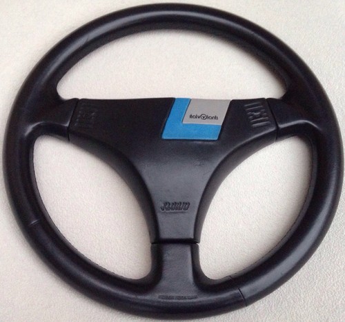

I really want both of these! I love everything Italvolanti. If they're still for sale in a few weeks I'll probably scoop up the red one because I have a matching advertisement framed on my wall.
