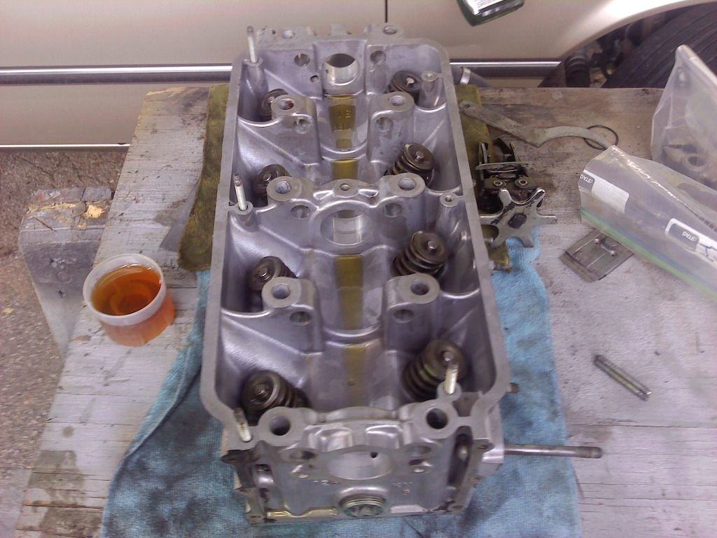

looks awesome, now just dont be a dumbass like me and put the spring retainers in backwards lol
Dear Darla, I **** your stinkin' guts.
Is that even possible?Originally posted by 323ijoe View Postlooks awesome, now just dont be a dumbass like me and put the spring retainers in backwards lol
ThanksOriginally posted by Nuts View PostGreat progress bud.
Yeah just took a break. Had some pizza straight off of the combustion chamber. The carbon kinda gave it a char-broiled taste.Originally posted by willis View PostThat's a good ass clean ass lookin' head. I would eat off of it.
I'm suprised they even held the retainer down being upside down like that. But I got all mine in without issue. Besides that I managed to lose one for about 45 minutes only to find it under the spring it belonged to.Originally posted by 323ijoe View PostYup, the diagram on realoem and in my book I was following both showed the recessed side on the retainer facing the rocker, however that is not how it goes, I learned the hard way

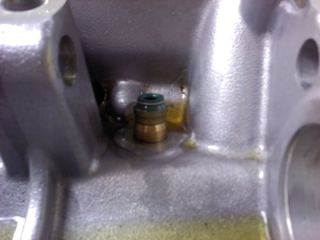

These should hold the oil where it belongs a little better than the crumbly ones

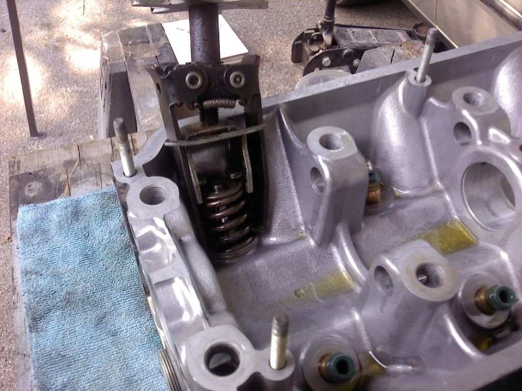

springs going back in!

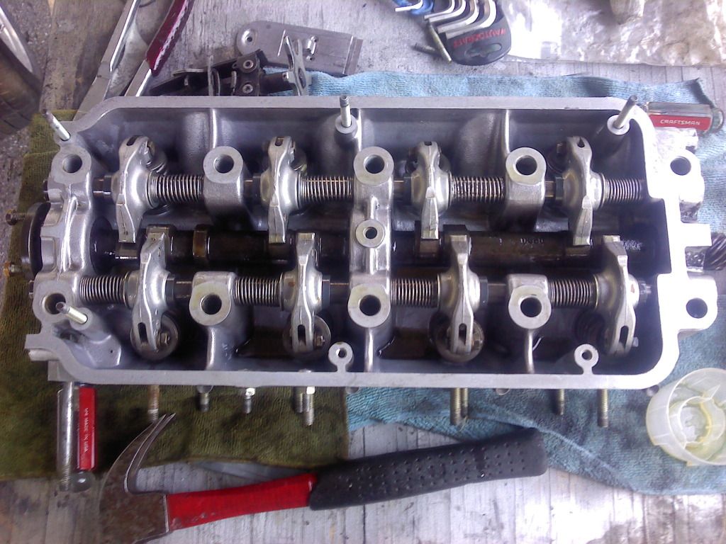

And all done. Another time-eater involved me putting one of the rocker shafts in backwards... but I didn't notice until it was completely installed. These heads are a little tricky at first, but once you get the hang of it they're not so bad.
Now I just have to adjust the valves and I can move on to the block. Sorry if these engine updates are boring... I swear it's going to get good soon.

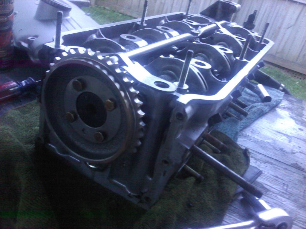

The head is done. Valve clearances are all in spec, cam gear is on, sprayer bar is in. Pretty happy with the results considering the only new parts are the valve guide seals and the cam gear. The valve seats looked great and it had very little carbon buildup throughout. Minimal wear on the cam and rockers. Should do just fine.
Tomorrow, I tackle the block. Then it's all downhillish from there.
