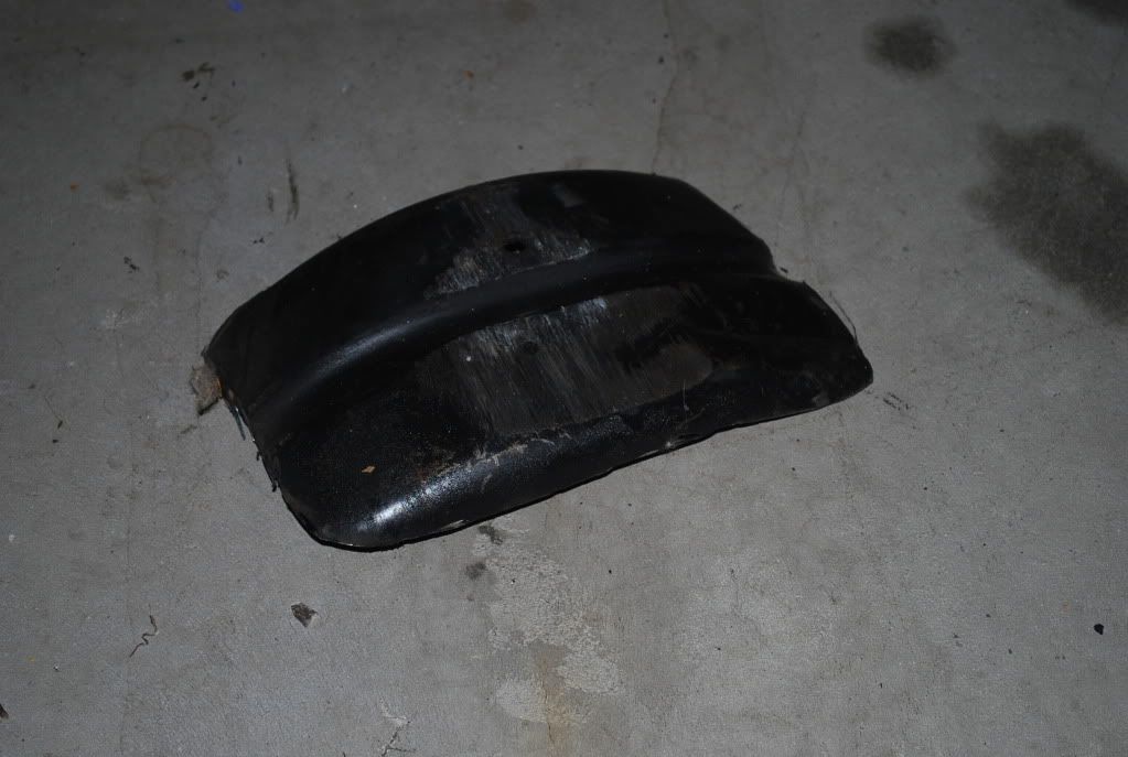

    i found it! i wanted to make sure there was room to go lower before pulling the subframe. so i pulled a wheel off and it turns out the ground isn't the only thing holding up my front end.
    gosh darn control arm is hitting the sub frame. maybe tomorrow i'll notch it and see where it goes from there. if anyone wants to play along at home currently 8" from fender lip to center of hub.

  • bobbyjones
    replied
    Originally posted by V8Finny View Post
    The crossmember is mounted on rubber mounts. If they are newish, you're at max height. I would imagine the half inch you desire could be achieved with some custom urethane mounts a half inch shorter???
    Playing with the steel is opening a hornet's nest....
    Will the sump then be the lowest point? (It IS on my 6.3s!!!!!)
    i didn't think about changing the subframe mounts to something shorter, the sump was the lowest part i raised the motor up about an inch, with my plans for the subframe, the sub frame will still sit lower then the sump is.
    i just want to remove the bottom of that c section and weld in a flat piece, i don't think it's going to cause any problems, but i do somewhat agree that there isn't much more room to get lower, the control arm eccentrics are currently just over a half inch. if i can get them on the ground i would be ecstatic.
