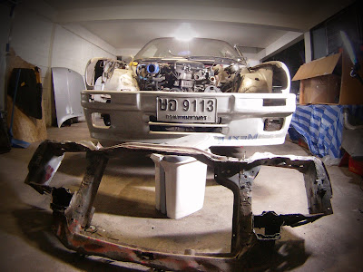

New year is throwing a wrench in my gears at the moment, tried to get my DOM tubing today but nobody seems terribly motivated to make that happen before the weekend... Oh thailand
putting a bit of metal back into her, (still waiting on DOM)
