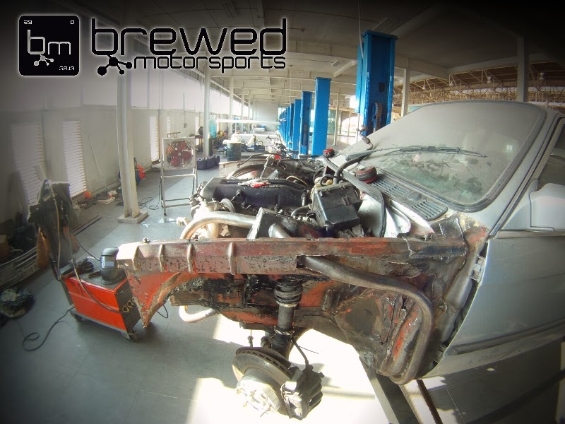

    More metal...
    Front strut towers
    Tubes to front frame rail
    Tubes to lower frame rail under drivers/passengers feet. *still need to add gussets to a few places on these*
    Repair/re-enforce/replace frame rails
    Added "sub frame connectors (these basically run wheel to wheel (front to back) along the pinch welds and have a few cross bars) *will be incorporating trans mount and drive shaft hoop in the cross bars*
    Sheet metal patch/re-enforcement **as you can see in the pictures rear of the front wheel wells still need some sheet metallove**
