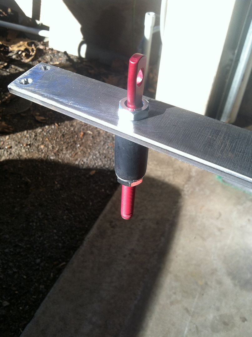

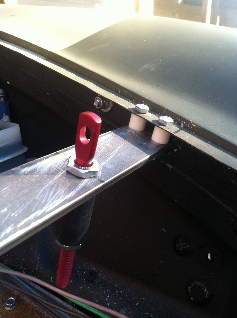

        • So i need to get the hood mounted but without the steel latch area i dont feel comfortable using the fiberglass bumper. Since there is no place to attach anything this is my home brew set up i have come up with . I put it near the outer edges where its much more stable. i need to get some taller bushings as the pins still sit to high. also i bolted the hood down briefly and temps went up a bit. it gets pretty hot under hood so im doing some bolt on louvers.
