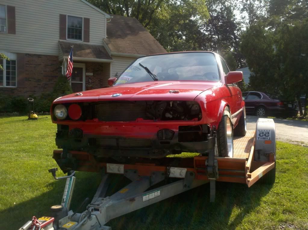

                            • got her home today!
