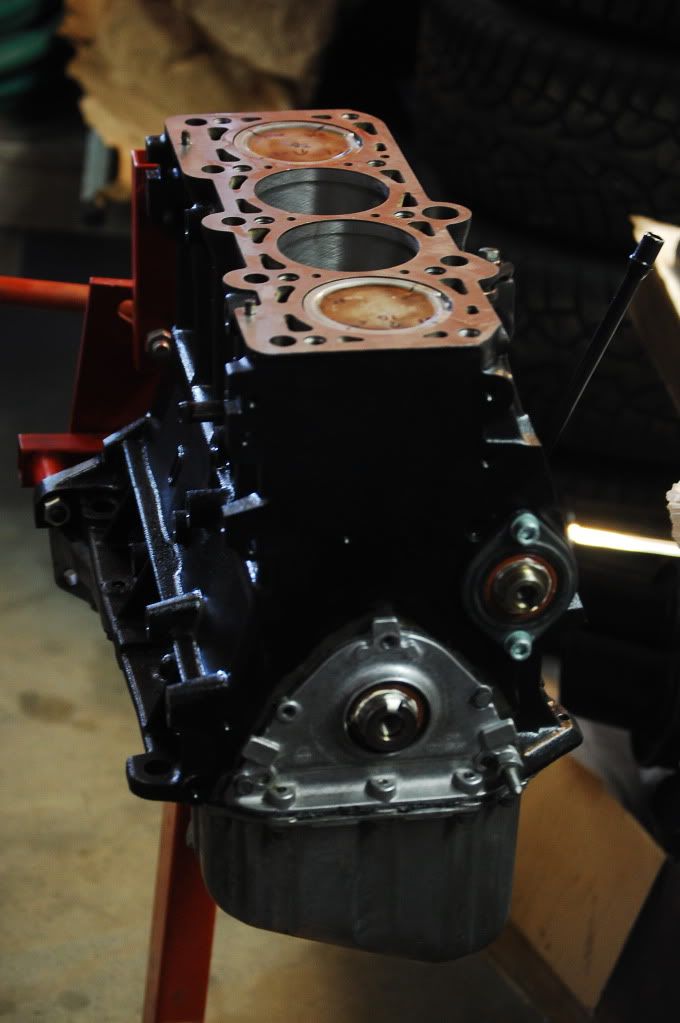

    Block:
    Bored 82.5mm
    JE Forged 82.5mm Pistons 9.25:1
    Scat Rods
    ARP Main Studs
    034 Coated Main Bearings

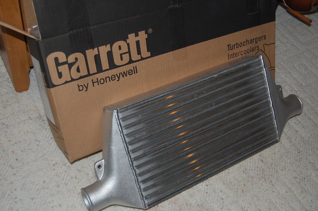

    Garrett GT3076r /.63
    Garrett 600hp Intercooler

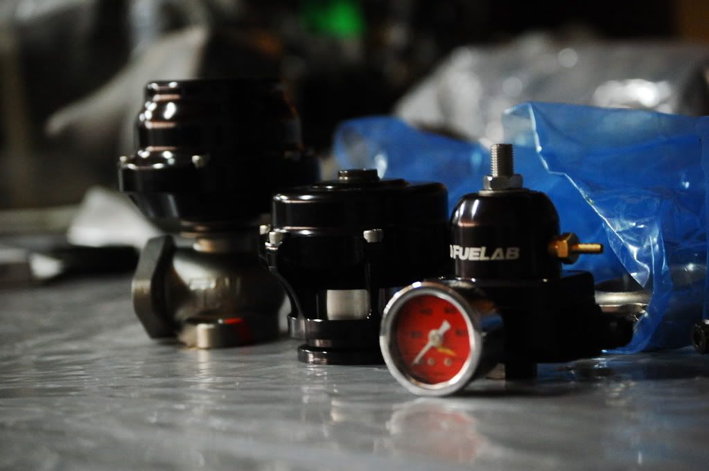

    Fuel:
    E85 tuned by Full Blown Motorsports
    Bosch 044 Drop In Pump
    Bosch 1000cc EV-14 Injectors
    Fuel Lab AFPR
    034 Fuel Rail
    -6 AN Fuel Lines

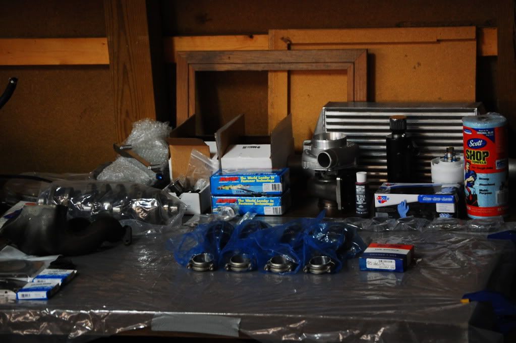

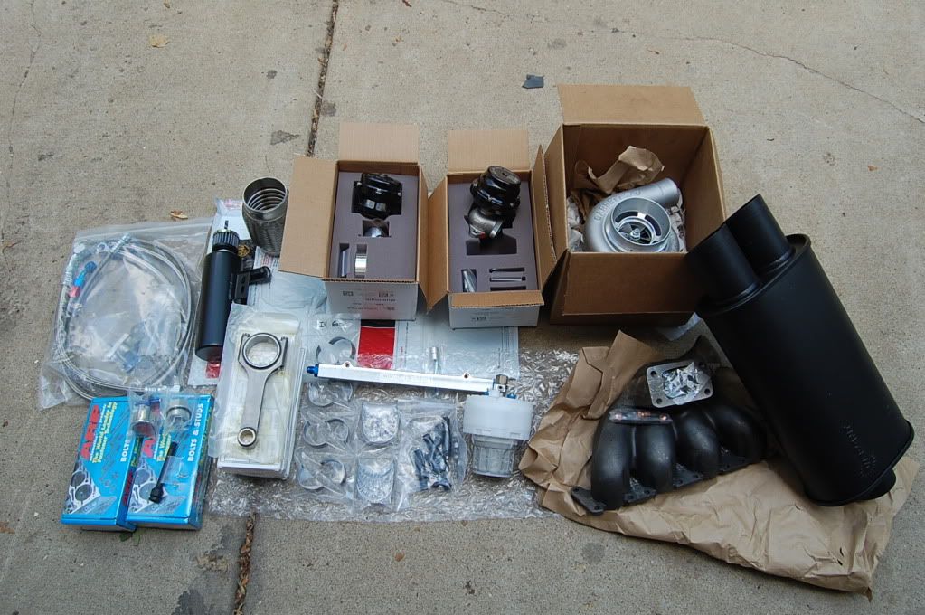

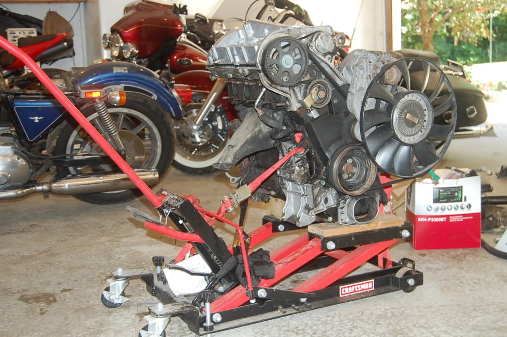

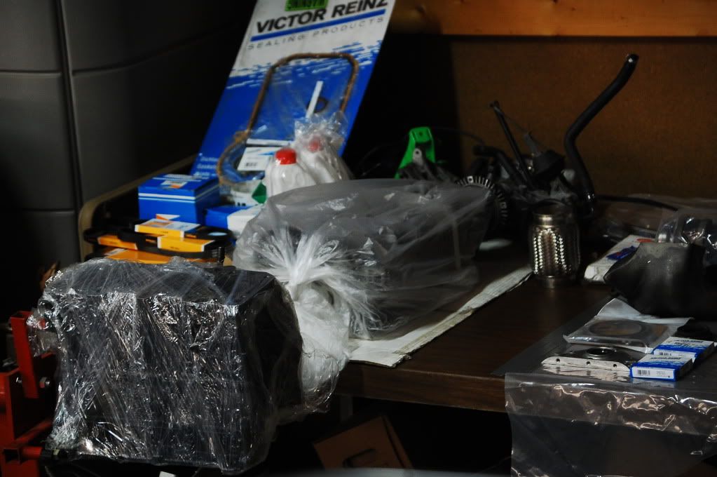

    Some Pards.
    The workstation.

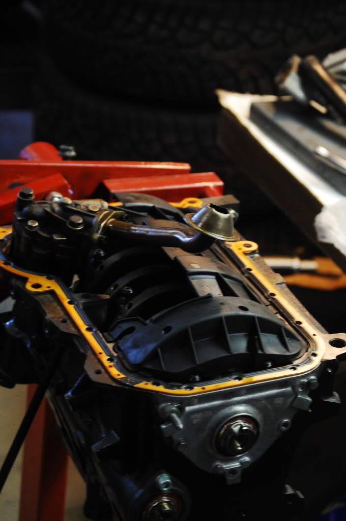

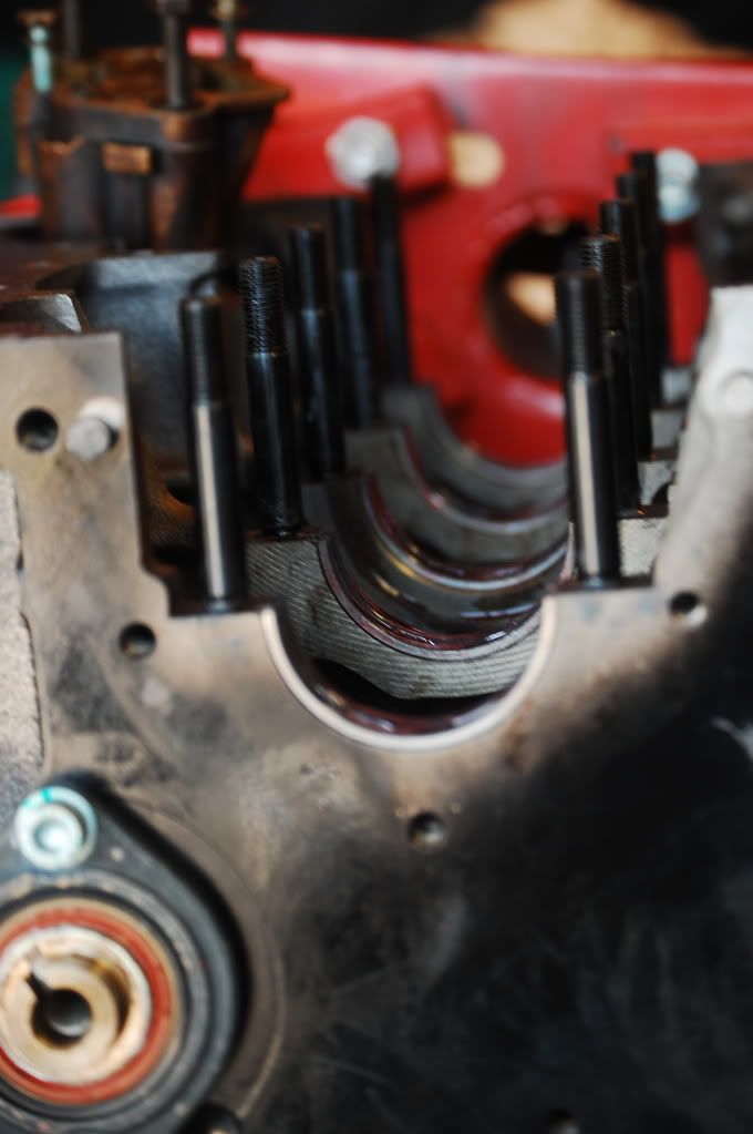

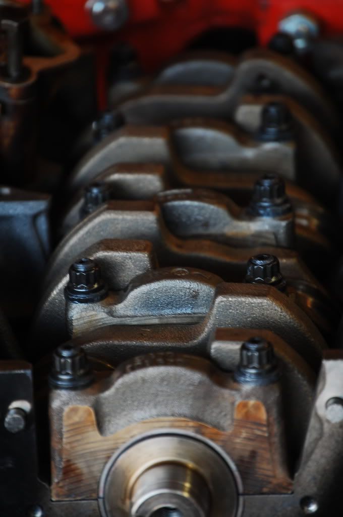

    Stock crank, polished and balanced.

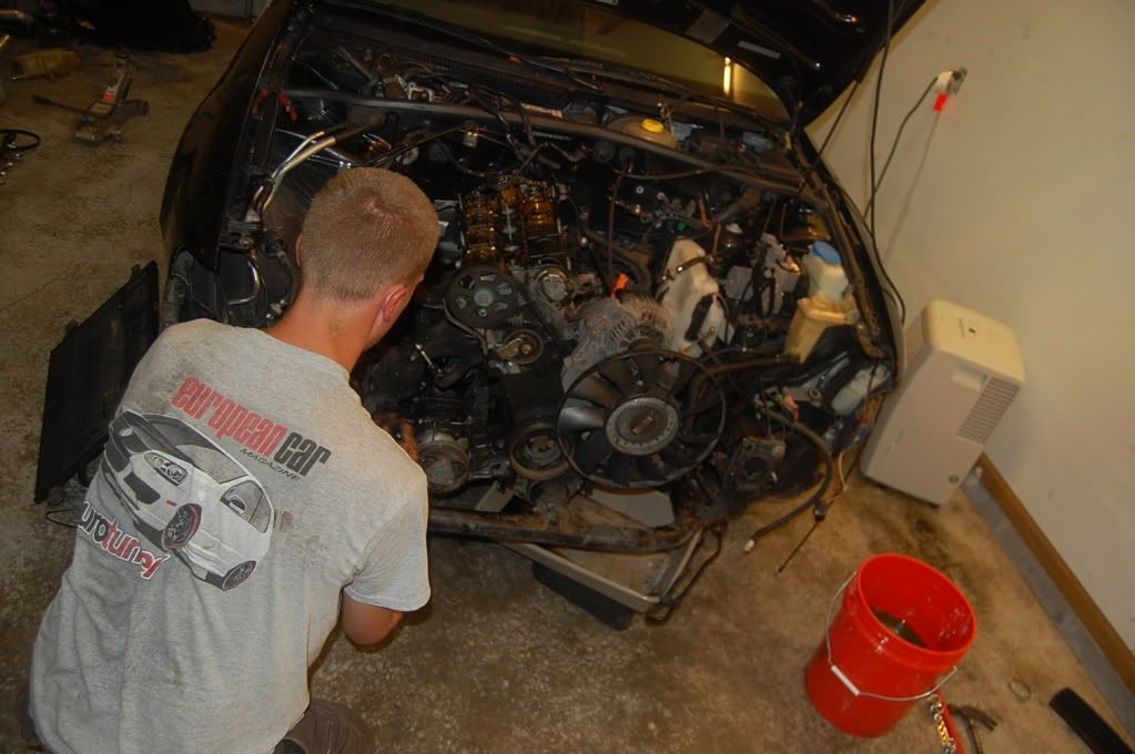

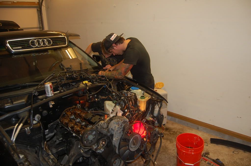

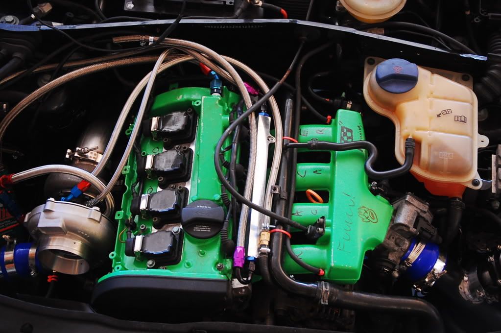

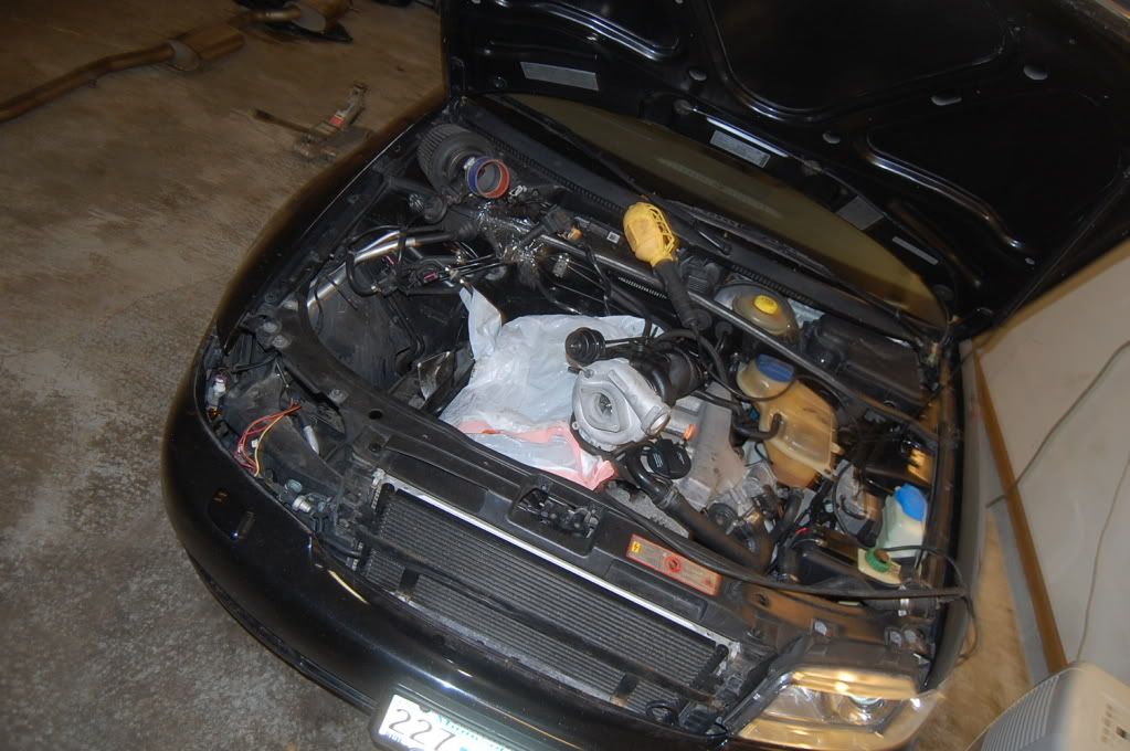

    okay so at first I quickly just threw everything into the car and ran lines so we could quickly get my friends lugtronic ecu in and start the car to make sure everything is okay before moving to cosmetics. This is what I ended up with.
    Intake
    Okay so now at this point we installed my buddies lugtronic ecu and the car ran great, so for some reason I thought I was try to save some money and go with Eurodyne for software. Horrible mistake.. What a POS that was, I gave the car to a local Eurodyne dealer and had them install Maestro, then they could not get the car to run properly on it. The fuel trims would peak from way too rich, to way too lean. my A/F was like a roller coaster going up and down. They kept the car for a month trying to fix it and nothing worked. So I told them to keep the tune, I got a refund, then I started doing my homework on standalone EMS's.

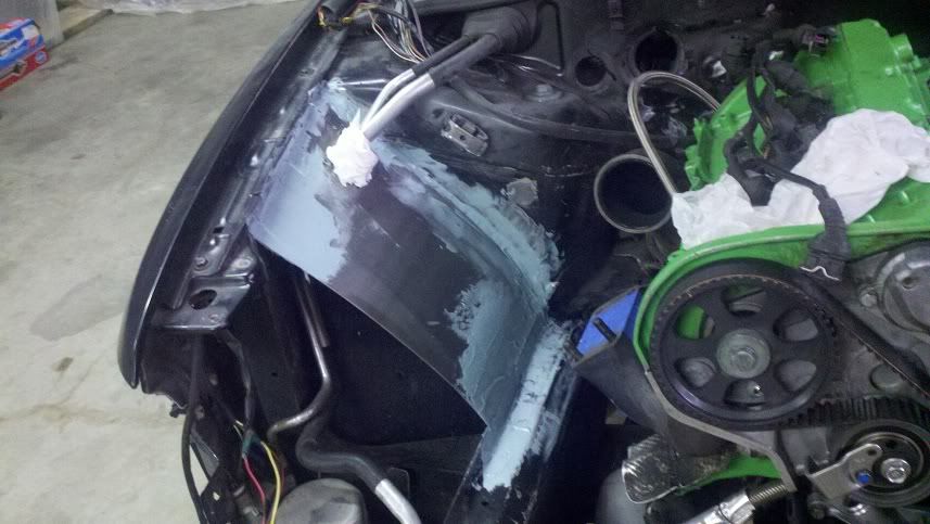

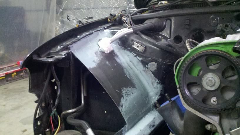

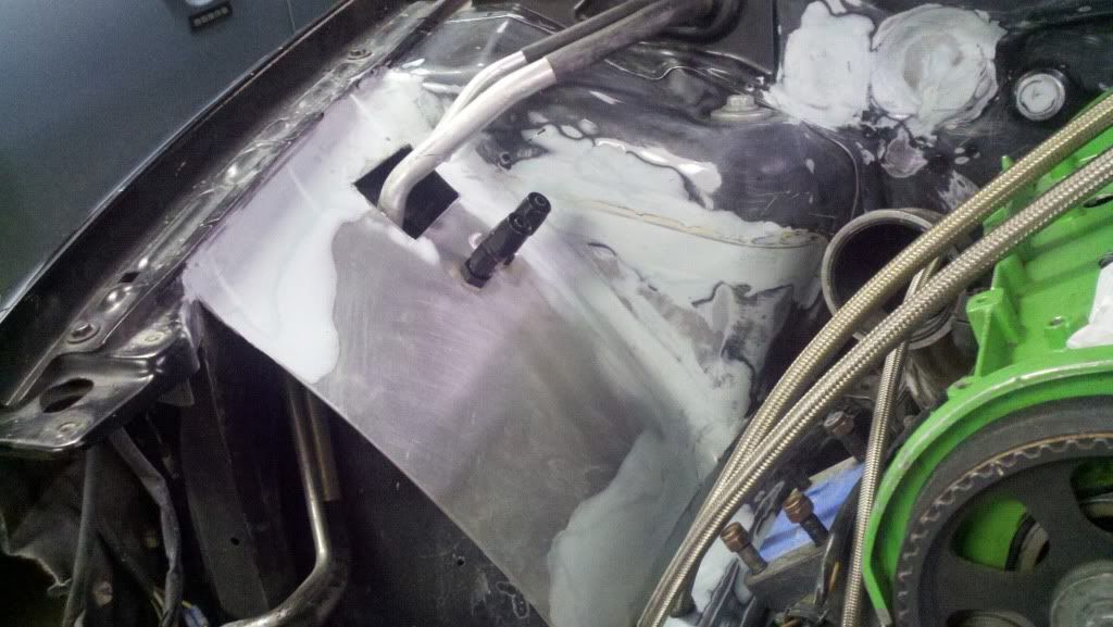

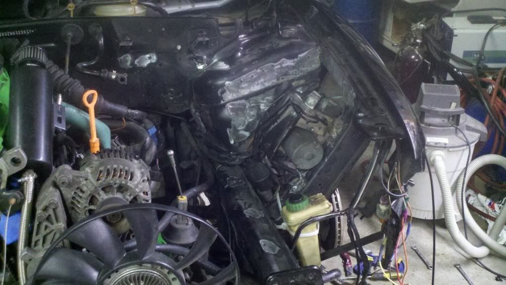

    Shave & Tuck.

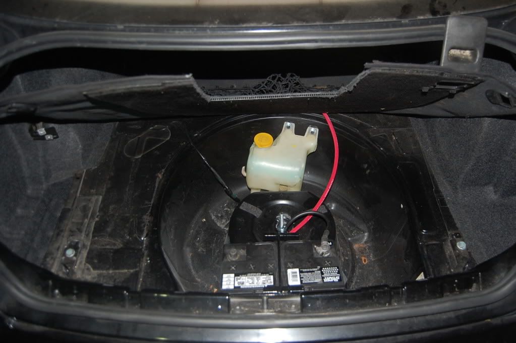

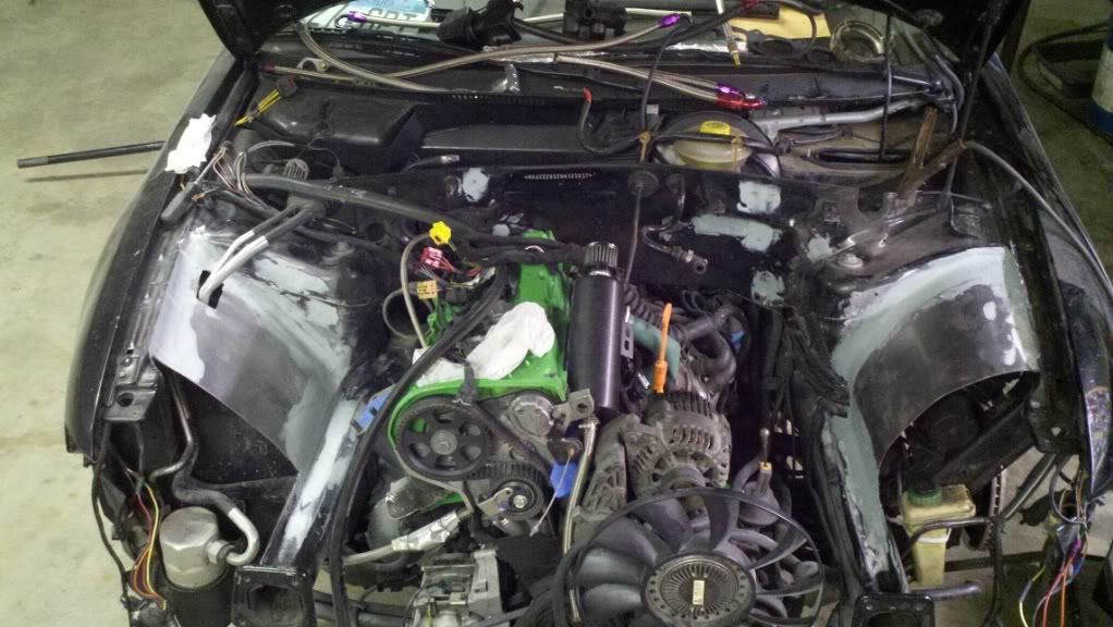

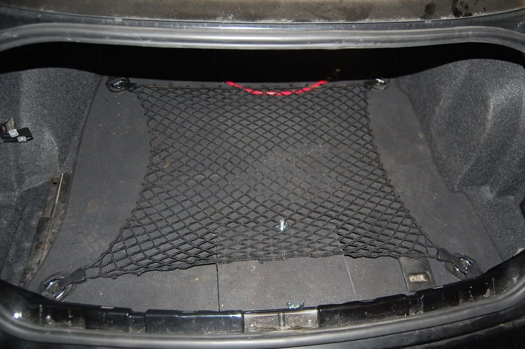

    Here I relocated my battery and washer tank to the trunk, Most people who shave the bay on our A4's move the ABS to the stock battery location, I decided against this due to something else needing to go in that location. So after some modifications to the stock ABS mounting bracket, and only two new brake lines I got it tucked away nicely.
    Why i needed to keep my ABS away from the battery location.

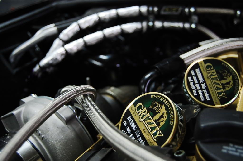

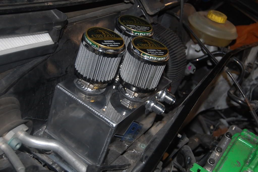

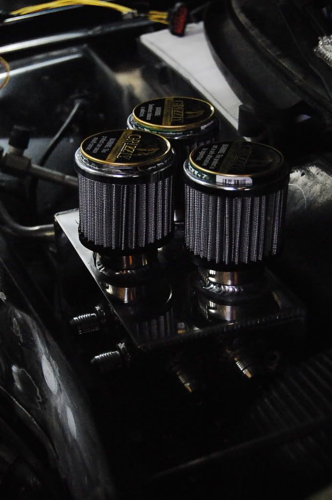

    GRIZzLY CATCH CAN YO

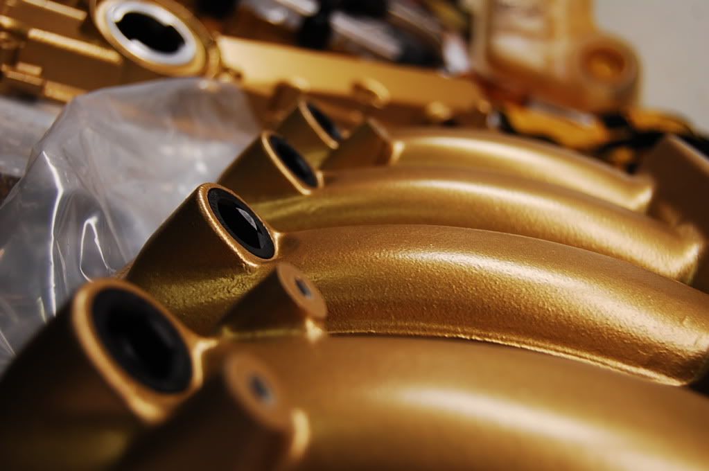

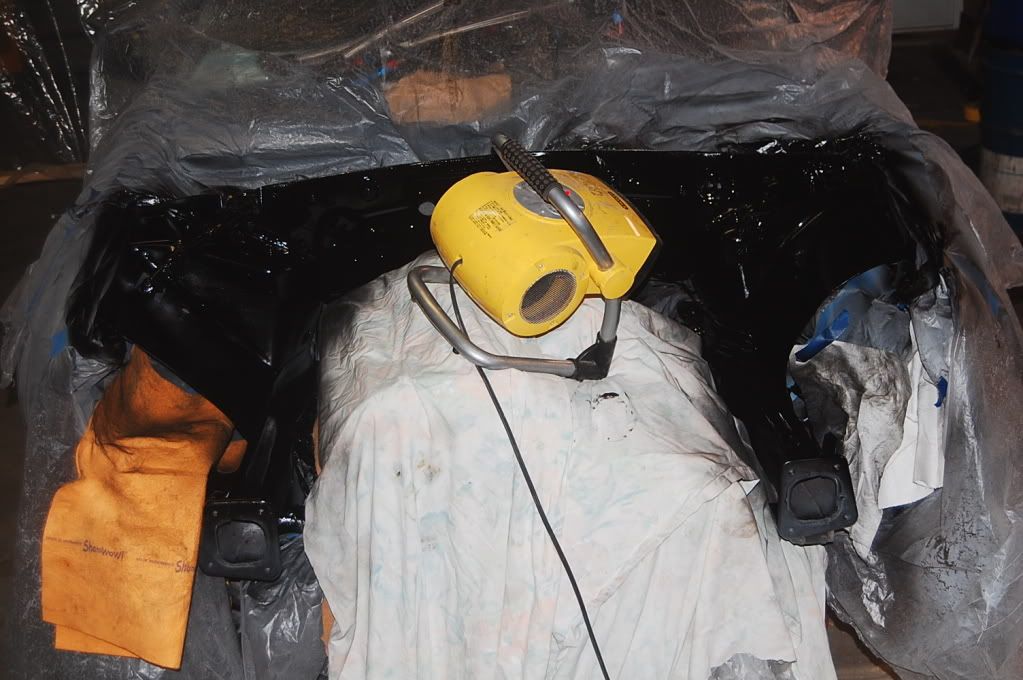

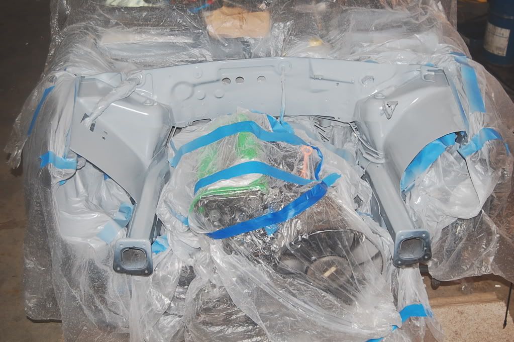

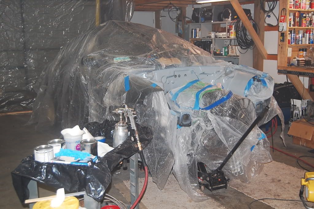

    PAINT!

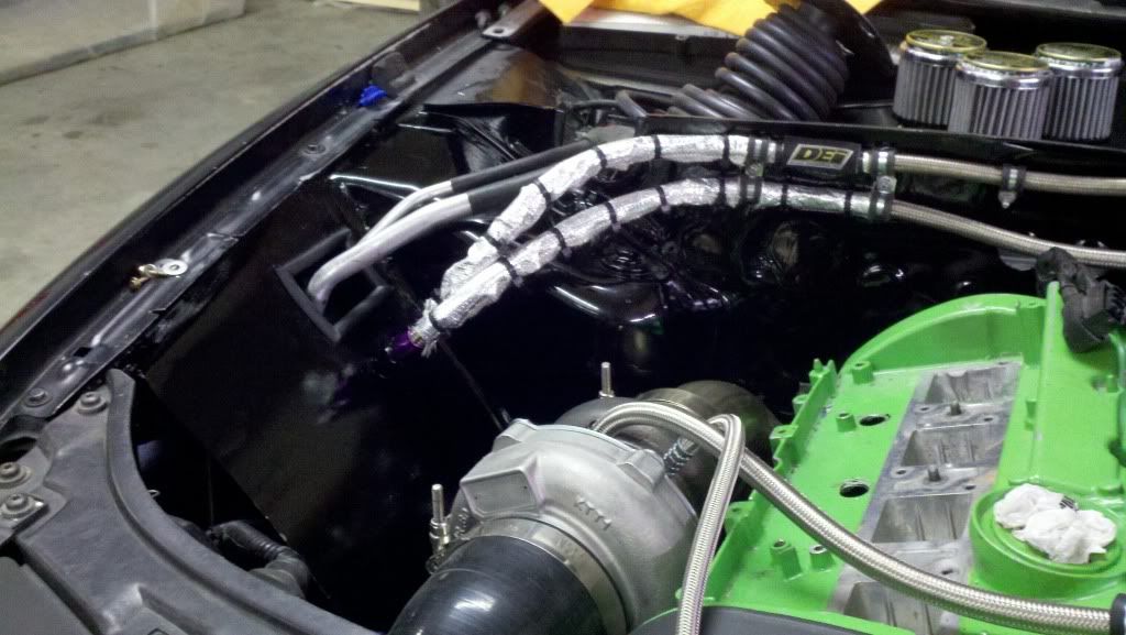

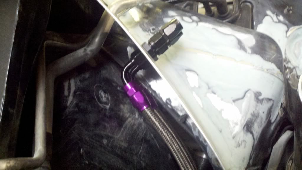

    fuel lines.

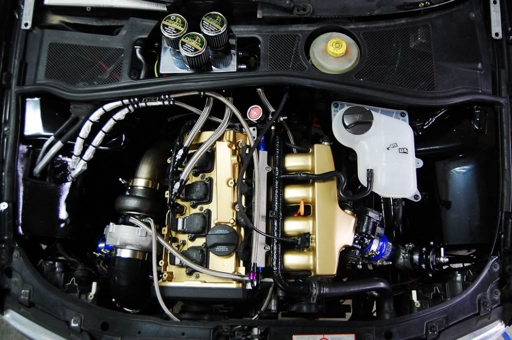

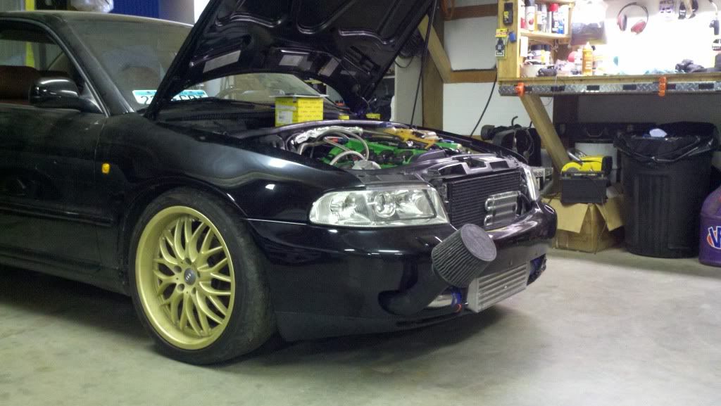

    Now the awesomeness, and how the car sits as we speak

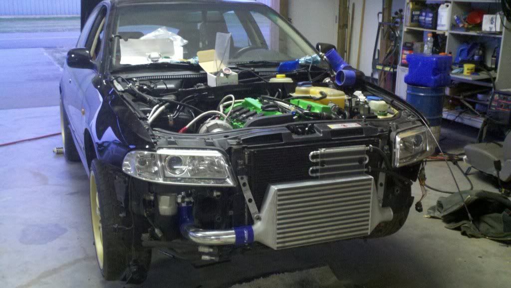

                  Can you post up some more exterior shots? Im about to cut up my front bumper for my FMIC and haven't found too much info on it. I like how yours looks.

                      Dalers08: The bumper was not bad If you have an angle grinder. I had to cut the shape of my core out of that aluminum support, then I chopped all the stock grill clips off, then cut room for the pipes.
                      Those are all the pictures I could find of the front bumper.

                              No problem, feel free to hack away at as much as you can from behind that bumper to lose front end weight. I swear mine must weigh under 5lb now.
                              Also, I will be at the shop tomorrow and my bumper is off at the moment, so I can snap a photo of the back of it for you.
