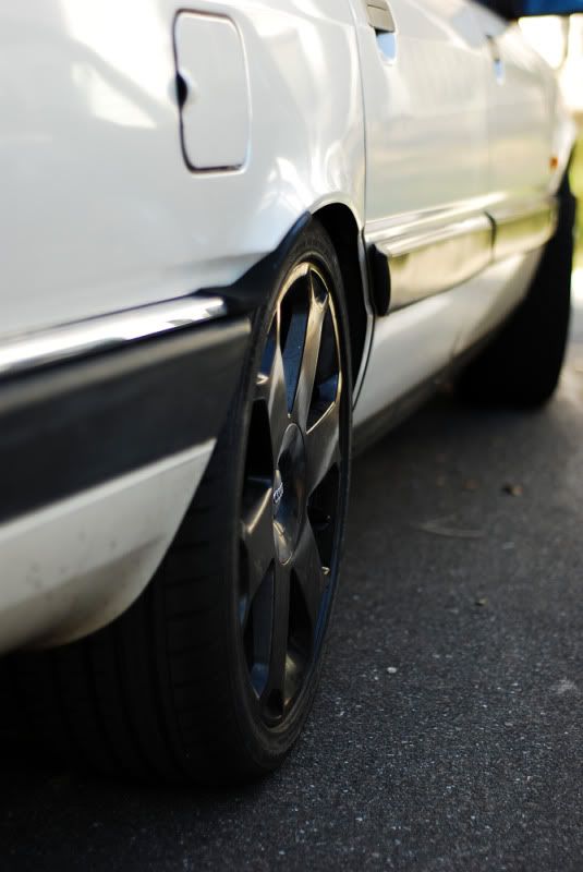

                          OK update time
                          shot the car with the Porsche wheels for the last time last night...here's one to remember them by
                          here is one of the sets I got in the trade...
                          Everyone who knows the car (including me) says it looks more rugged. I dig the look more than I thought I would. Obviously its just temporary though.
