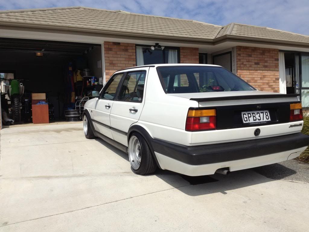

                            • Cleaned out the boot and gave the car a clean today. And repaired a bit of a hole on the new front valance. This one is cleaner.
                              Boot floor is so straight.
                              Also welded up the hole for the number plate.
                              In case I want to do this.
                              Still not sure if I should smooth off the rear VW badge so I can put an earlier one on the left side of the rear? I might get annoyed that is has later spec door moldings and doors though.
                              Instragram: @lukeybabes
