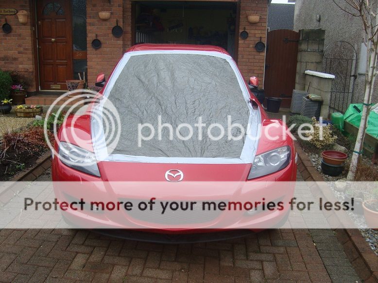

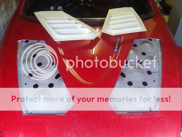

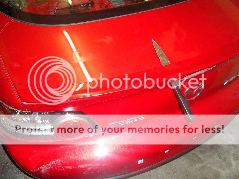

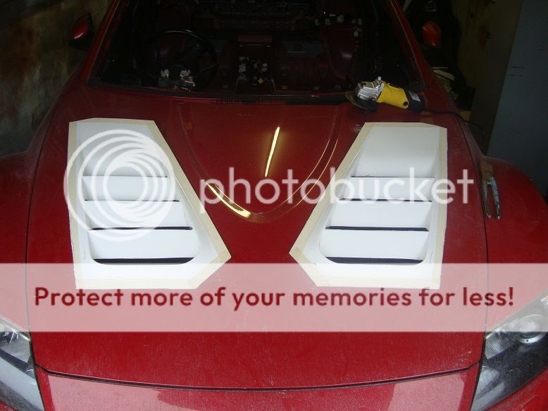

        Have the bonnet marked up ready for cutting tomorrow...
        How it should look...

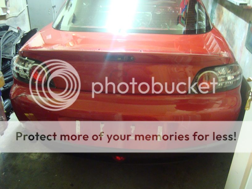

        Said I'd resort to using the Limerick method of removing the spoiler...
        Debadged and spoiler off, just getting the last few shitty bits done before she goes away Sunday...

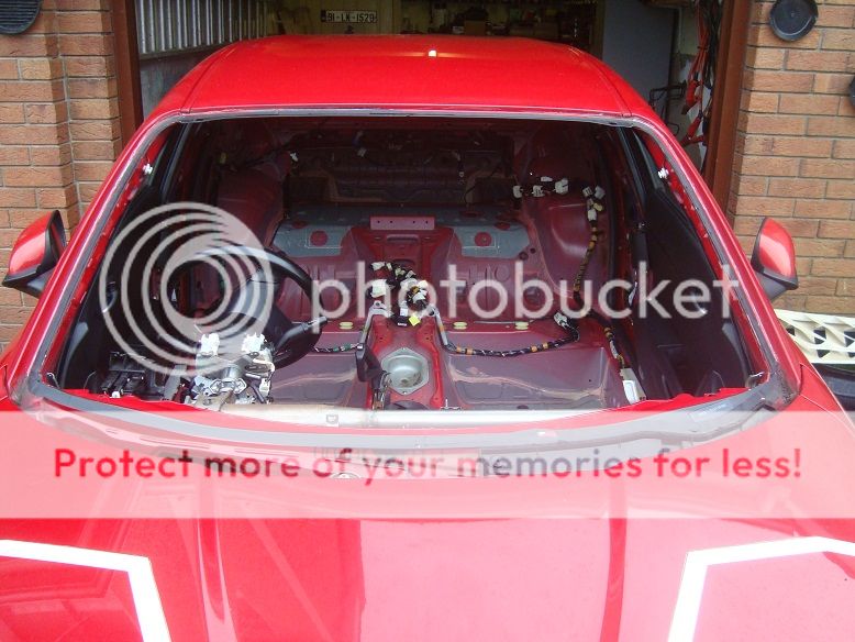

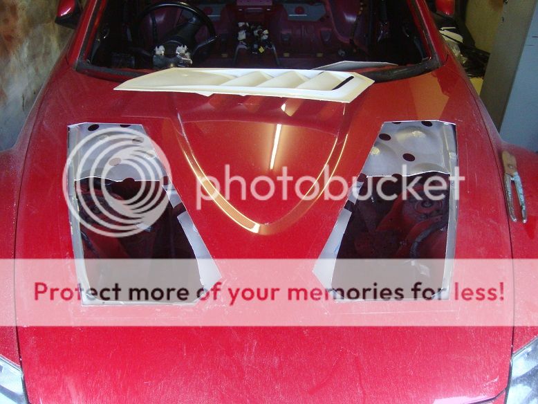

              Got the windscreen out this morning :

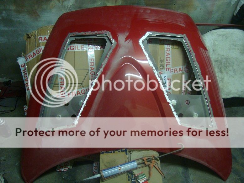

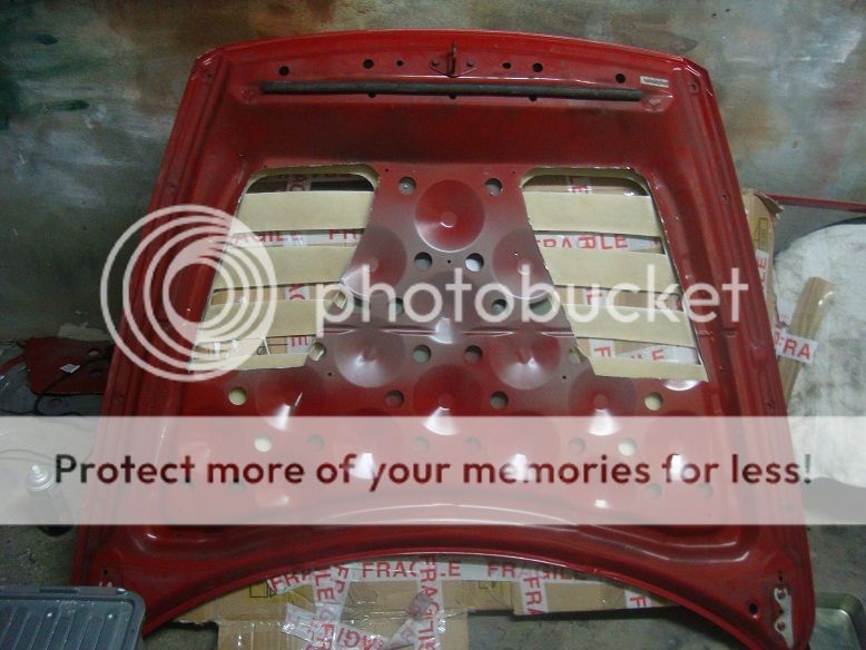

              Cut the outer skin and lined the vents up again :
              Matched the vents to the inner skin, chop, chop :
              Sorted :

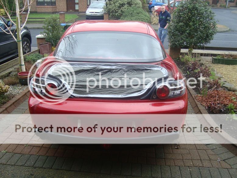

              Boot door off so I can work on it while the car is away :
              Will also build the bonnet up while she is being caged, almost ready for transport tomorrow :

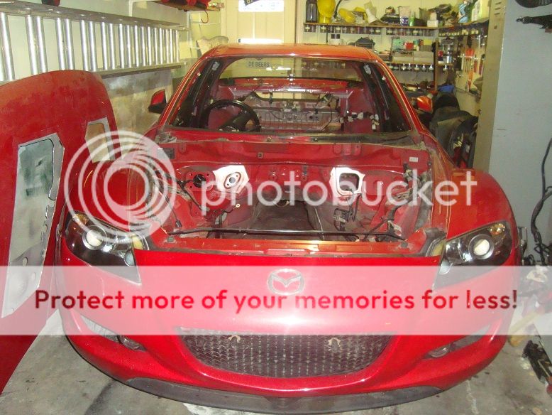

                    And she is gone, Bear collected her today and she is now sitting up in Mr. Stones. Next updates will be alot more exciting, rollcage baby

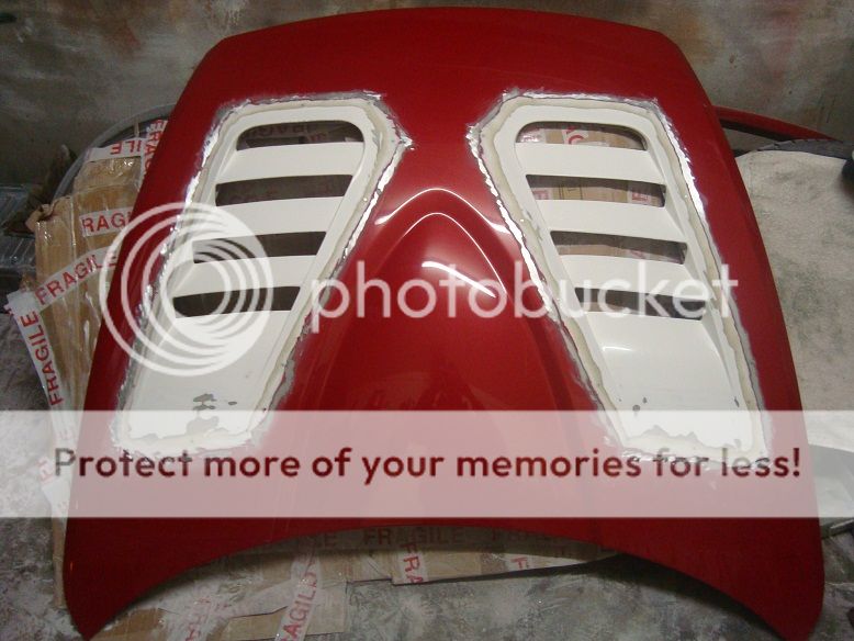

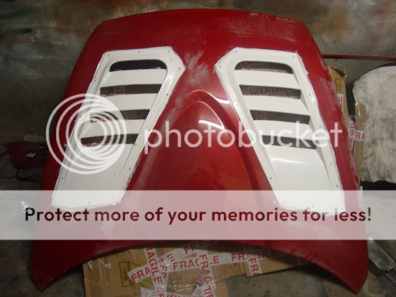

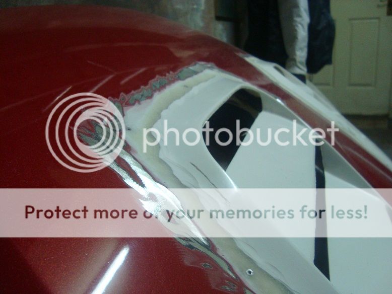

                        Well since the car is gone I decided to do a bit on the bonnet, ground down the edges of the bonnet and under the vents so they sealer could bite into something :
                        Used the usual pop rivets to hold them in place while the sealer set but looking good so far :
                        The underneath just needs the lines tidied up a bit so they are even but all in all I'm happy enough...
                        Time to make it look original using a sanding disc on the grinder :

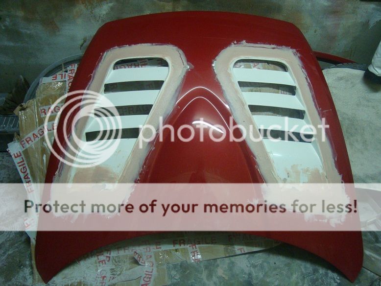

                        First coat used a 50/50 mix of filler and fibreglass, my poor garage, **** the stuff :
                        Will try get the outer skin finished off tonight and get to work on the underneath sometime this week...

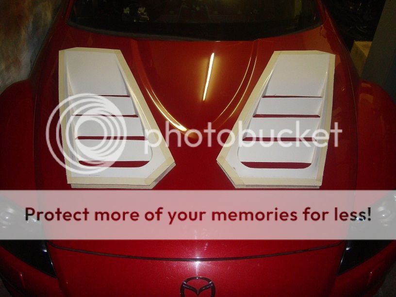

                                for teasers sake
                                u should put the 13's on now and take pic
                                serious work u put in this!
                                They are behing the bonnet in the last pic for teasers sake LoL Car is away now getting cage in a different part of the country. Bout 100miles or so away, should be back next month !
